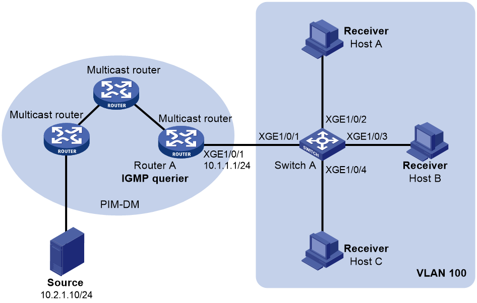

Example: Configuring multicast group policies
As shown in Figure 1:
·     Router A runs IGMP and acts as the IGMP querier.
·     Switch A runs IGMP snooping.
Configure multicast group policies on Switch A to meet the following requirements:
·     Host A receives only the multicast data addressed to multicast group 224.1.1.1.
·     Host B and Host C receive only the multicast data addressed to multicast group 225.1.1.1.
Figure 1 Network diagram
Analysis
To meet the network requirements, you must perform the following tasks:
·     IGMPv2 snooping cannot process IGMPv3 messages. It floods IGMPv3 messages in the VLAN to which the IGMPv3 messages belong. To avoid this problem, specify IGMP snooping version 3 for VLAN 100.
·     To avoid receiver hosts in VLAN 100 from receiving multicast data addressed to other groups, enable dropping unknown multicast data in VLAN 100.
·     To configure multicast group policies, specify a basic ACL and create ACL rules to define the groups that you want the receiver hosts to join.

When you configure multicast group polices, follow these restrictions and guidelines:
·     You must globally enable IGMP snooping in system view before you enable IGMP snooping for a VLAN in VLAN view.
·     You can configure multicast group policies for all ports in IGMP-snooping view or for the current port in interface view. The configuration made in interface view takes priority over the configuration made in IGMP-snooping view.
Procedures
1.     Assign an IP address and subnet mask to each interface on the routers in the PIM-DM domain. (Details not shown.)
2.     Configure a unicast routing protocol on the routers in the PIM-DM domain. (Details not shown.)
3.     Enable multicast routing globally on the routers in the PIM-DM domain. (Details not shown.)
4.     Enable PIM-DM for the interfaces through which routers connects with each other on the routers in the PIM-DM domain. (Details not shown.)
5.     Configure Router A:
# Enable IP multicast routing globally.
<RouterA> system-view
[RouterA] multicast routing
[RouterA-mrib] quit
# Enable IGMPv3 on Ten-GigabitEthernet 1/0/1.
[RouterA] interface ten-gigabitethernet 1/0/1
[RouterA-Ten-GigabitEthernet1/0/1] igmp enable
[RouterA-Ten-GigabitEthernet1/0/1] igmp version 3
[RouterA-Ten-GigabitEthernet1/0/1] quit
6.     Configure Switch A:
# Enable IGMP snooping globally.
<SwitchA> system-view
[SwitchA] igmp-snooping
[SwitchA-igmp-snooping] quit
# Create VLAN 100, and assign Ten-GigabitEthernet 1/0/1 through Ten-GigabitEthernet 1/0/4 to VLAN 100.
[SwitchA] vlan 100
[SwitchA-vlan100] port ten-gigabitethernet 1/0/1 to ten-gigabitethernet 1/0/4
# Enable IGMPv3 snooping and enable dropping unknown multicast data for VLAN 100.
[SwitchA-vlan100] igmp-snooping enable
[SwitchA-vlan100] igmp-snooping version 3
[SwitchA-vlan100] igmp-snooping drop-unknown
[SwitchA-vlan100] quit
# Configure a multicast group policy for VLAN 100 on Ten-GigabitEthernet 1/0/2 so that Host A can join only multicast group 224.1.1.1.
[SwitchA] acl basic 2000
[SwitchA-acl-ipv4-basic-2000] rule permit source 224.1.1.1 0
[SwitchA-acl-ipv4-basic-2000] quit
[SwitchA] interface ten-gigabitethernet 1/0/2
[SwitchA-Ten-GigabitEthernet1/0/2] igmp-snooping group-policy 2000 vlan 100
[SwitchA-Ten-GigabitEthernet1/0/2] quit
# Configure a multicast group policy globally for VLAN 100 so that Host B and Host C can join only multicast group 225.1.1.1.
[SwitchA] acl basic 2001
[SwitchA-acl-ipv4-basic-2001] rule permit source 225.1.1.1 0
[SwitchA-acl-ipv4-basic-2001] quit
[SwitchA-igmp-snooping] group-policy 2001 vlan 100
# Send IGMP reports from Host A, Host B, and Host C to join multicast groups 224.1.1.1, 224.2.2.2, and 225.1.1.1. (Details not shown.)
# Send multicast data from the source to the multicast groups. (Details not shown.)
# Display dynamic IGMP snooping group entries for VLAN 100 on Switch A.
[SwitchA] display igmp-snooping group vlan 100
Total 2 entries.
VLAN 100: Total 2 entries.
  (0.0.0.0, 224.1.1.1)
    Host ports (1 in total):
      XGE1/0/2                                     (00:03:09)
  (0.0.0.0, 225.1.1.1)
    Host ports (2 in total):
      XGE1/0/3                                     (00:04:04)
      XGE1/0/4                                     (00:02:38)
The output shows the following information:
·     Host A has joined multicast group 224.1.1.1 through Ten-GigabitEthernet 1/0/2, and it has not joined multicast groups 224.2.2.2 and 225.1.1.1.
·     Host B and Host C have joined multicast group 225.1.1.1 through Ten-GigabitEthernet 1/0/3 and Ten-GigabitEthernet 1/0/4, respectively. They have not joined multicast groups 224.1.1.1 and 224.2.2.2.
·     Multicast group policies have taken effect.

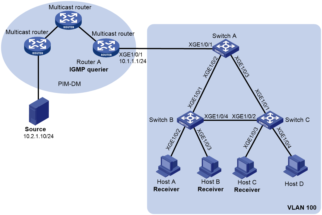

Example: Configuring IGMP snooping static ports
As shown in Figure 2:
·     All switches in VLAN 100 run IGMP snooping.
·     Router A runs IGMPv2 and acts as the IGMP querier.
·     STP runs in VLAN 100. The direct route between Switch A and Switch B or the route from Switch A to Switch B with Switch C as the intermediate device is blocked to avoid loops.
Configure IGMP snooping static ports to meet the following requirements:
·     Multicast data uninterruptedly flows to the receiver hosts after a link switchover occurs between Switch A and Switch B.
·     Host A, Host B, and Host C permanently receive the multicast data addressed to multicast group 224.1.1.1.
Figure 2 Network diagram
Analysis
·     By default, when a link switchover occurs, multicast data can flow along the new link after a minimum of one IGMP query-response cycle. Multicast delivery is interrupted during this process.
Configure Ten-GigabitEthernet 1/0/2 and Ten-GigabitEthernet 1/0/3 on Switch A, Ten-GigabitEthernet 1/0/4 on Switch B, and Ten-GigabitEthernet 1/0/2 on Switch C as static router ports. Then, multicast data will be forwarded to these ports.
·     Configure Ten-GigabitEthernet 1/0/2 and Ten-GigabitEthernet 1/0/3 on Switch B, and Ten-GigabitEthernet 1/0/3 on Switch C as static member ports of multicast group 224.1.1.1. Then, multicast data for the group will always be forwarded out of these ports, and Host A, Host B, and Host C can always receive the data.

When you configure IGMP snooping static ports, you must globally enable IGMP snooping in system view before you enable IGMP snooping for a VLAN in VLAN view.
Procedures
2.     Configure OSPF on the routers in the PIM-DM domain. (Details not shown.)
4.     Enable PIM-DM for the interfaces through which routers connects with each other in the PIM-DM domain. (Details not shown.)
# Enable IP multicast routing.
[RouterA-mrib] quit
# Enable IGMP on Ten-GigabitEthernet 1/0/1.
# Create VLAN 100, assign Ten-GigabitEthernet 1/0/1 through Ten-GigabitEthernet 1/0/4 to this VLAN, and enable IGMP snooping for this VLAN.
[SwitchA] vlan 100
# Configure Ten-GigabitEthernet 1/0/2 and Ten-GigabitEthernet 1/0/3 as static router ports.
[SwitchA-Ten-GigabitEthernet1/0/2] igmp-snooping static-router-port vlan 100
[SwitchA] interface ten-gigabitethernet 1/0/3
[SwitchA-Ten-GigabitEthernet1/0/3] igmp-snooping static-router-port vlan 100
[SwitchA-Ten-GigabitEthernet1/0/3] quit
7.     Configure Switch B:
<SwitchB> system-view
[SwitchB] igmp-snooping
[SwitchB-igmp-snooping] quit
# Create VLAN 100, assign Ten-GigabitEthernet 1/0/1 and Ten-GigabitEthernet 1/0/4 to this VLAN, and enable IGMP snooping for this VLAN.
[SwitchB] vlan 100
[SwitchB-vlan100] port ten-gigabitethernet 1/0/1 ten-gigabitethernet 1/0/4
[SwitchB-vlan100] igmp-snooping enable
[SwitchB-vlan100] quit
# Configure Ten-GigabitEthernet 1/0/4 as a static router port.
[SwitchB] interface ten-gigabitethernet 1/0/4
[SwitchB-Ten-GigabitEthernet1/0/4] igmp-snooping static-router-port vlan 100
[SwitchB-Ten-GigabitEthernet1/0/4] quit
# Configure Ten-GigabitEthernet 1/0/2 and Ten-GigabitEthernet 1/0/3 as static member ports for multicast group 224.1.1.1 in VLAN 100.
[SwitchB] interface ten-gigabitethernet 1/0/2
[SwitchB-Ten-GigabitEthernet1/0/2] igmp-snooping static-group 224.1.1.1 vlan 100
[SwitchB-Ten-GigabitEthernet1/0/2] quit
[SwitchB] interface ten-gigabitethernet 1/0/3
[SwitchB-Ten-GigabitEthernet1/0/3] igmp-snooping static-group 224.1.1.1 vlan 100
[SwitchB-Ten-GigabitEthernet1/0/3] quit
8.     Configure Switch C:
<SwitchC> system-view
[SwitchC] igmp-snooping
[SwitchC-igmp-snooping] quit
[SwitchC] vlan 100
[SwitchC-vlan100] port ten-gigabitethernet 1/0/1 to ten-gigabitethernet 1/0/4
[SwitchC-vlan100] igmp-snooping enable
[SwitchC-vlan100] quit
# Configure Ten-GigabitEthernet 1/0/2 as a static router port in VLAN 100.
[SwitchC] interface ten-gigabitethernet 1/0/2
[SwitchC-Ten-GigabitEthernet1/0/2] igmp-snooping static-router-port vlan 100
[SwitchC-Ten-GigabitEthernet1/0/2] quit
# Configure Ten-GigabitEthernet 1/0/3 as a static member port of multicast group 224.1.1.1 in VLAN 100.
[SwitchC] interface ten-gigabitethernet 1/0/3
[SwitchC-Ten-GigabitEthernet1/0/3] igmp-snooping static-group 224.1.1.1 vlan 100
[SwitchC-Ten-GigabitEthernet1/0/3] quit
Verify the configuration before hosts join any multicast groups.
# Display static router port information for VLAN 100 on Switch A.
[SwitchA] display igmp-snooping static-router-port vlan 100
VLAN 100:
  Router ports (2 in total):
    XGE1/0/2
    XGE1/0/3
The output shows that Ten-GigabitEthernet 1/0/2 and Ten-GigabitEthernet 1/0/3 on Switch A have become static router ports in VLAN 100.
# Display static router port information for VLAN 100 on Switch B.
[SwitchB] display igmp-snooping static-router-port vlan 100
VLAN 100:
  Router ports (1 in total):
    XGE1/0/4
The output shows that Ten-GigabitEthernet 1/0/4 on Switch B has become a static router port in VLAN 100.
# Display static IGMP snooping group entries for VLAN 100 on Switch B.
[SwitchB] display igmp-snooping static-group vlan 100
Total 1 entries.
VLAN 100: Total 1 entries.
      XGE1/0/2
      XGE1/0/3
The output shows that Ten-GigabitEthernet 1/0/2 and Ten-GigabitEthernet 1/0/3 on Switch B have become static member ports of multicast group 224.1.1.1 in VLAN 100.
# Display static router port information for VLAN 100 on Switch C.
[SwitchC] display igmp-snooping static-router-port vlan 100
VLAN 100:
    XGE1/0/2
The output shows that Ten-GigabitEthernet 1/0/2 on Switch C has become a static router port in VLAN 100.
# Display static IGMP snooping group entries for VLAN 100 on Switch C.
[SwitchC] display igmp-snooping static-group vlan 100
Total 1 entries.
      XGE1/0/3
The output shows that Ten-GigabitEthernet 1/0/3 on Switch C has become a static group member of multicast group 224.1.1.1.
