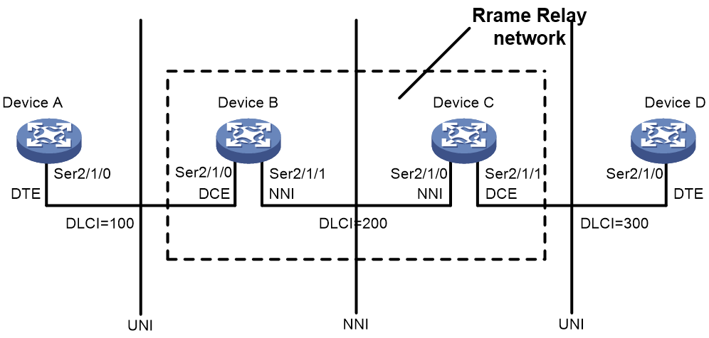

As shown in Figure 1:
·     Device B and Device C form a simple Frame Relay network.
·     DTE devices Device A and Device D are attached to the network.
The interface type DTE or DCE is identified only for the UNI interfaces. A virtual circuit between two DTE devices can be assigned different DLCIs on different segments.
Figure 1 Frame Relay network

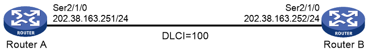

Typically, Frame Relay is used for Frame Relay access. Frame Relay access encapsulates upper-layer packets on a user device by using Frame Relay and connects the user device to a Frame Relay network.

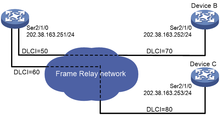

With Frame Relay, you can construct a public or private network as shown in Figure 2 and construct direct connections between data devices as shown in Figure 3.
Figure 2 Interconnecting LANs through a Frame Relay network

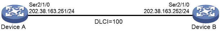

Figure 3 Interconnecting LANs through a dedicated line

Frame Relay configuration examples
Example: Interconnecting LANs through a dedicated line
As shown in Figure 4, configure Frame Relay so that Router A and Router B can communicate.
Figure 4 Network diagram
(Method 1) Using main interfaces:
1.     Configure Router A:
# Assign an IP address to Serial 2/1/0.
<RouterA> system-view
[RouterA] interface serial 2/1/0
[RouterA-Serial2/1/0] ip address 202.38.163.251 255.255.255.0
# Enable Frame Relay encapsulation on the interface.
[RouterA-Serial2/1/0] link-protocol fr
# Set the type of the interface to DCE.
[RouterA-Serial2/1/0] fr interface-type dce
# Configure a local virtual circuit.
[RouterA-Serial2/1/0] fr dlci 100
2.     Configure Router B:
<RouterB> system-view
[RouterB] interface serial 2/1/0
[RouterB-Serial2/1/0] ip address 202.38.163.252 255.255.255.0
[RouterB-Serial2/1/0] link-protocol fr
# Set the type of the interface to DTE.
[RouterB-Serial2/1/0] fr interface-type dte
[RouterB-Serial2/1/0] quit
(Method 2) Using subinterfaces:
# Enable Frame Relay encapsulation on Serial 2/1/0.
# Set the type of Serial 2/1/0 to DCE.
[RouterA-Serial2/1/0] quit
# Create a subinterface named Serial 2/1/0.1.
[RouterA] interface serial 2/1/0.1 p2p
# Configure the IP address and create a virtual circuit for Serial 2/1/0.1.
[RouterA-Serial2/1/0.1] ip address 202.38.163.251 255.255.255.0
[RouterA-Serial2/1/0.1] fr dlci 100
# Set the type of Serial 2/1/0 to DTE.
[RouterB] interface serial 2/1/0.1 p2p
[RouterB-Serial2/1/0.1] ip address 202.38.163.252 255.255.255.0
[RouterB-Serial2/1/0.1] fr dlci 100
[RouterB-Serial2/1/0.1] quit
This section verifies the configuration used in method 1.
# On Router B, verify that the PVC is active.
[RouterB] display fr pvc
PVC information for interface Serial2/1/0 (DTE, physically up)
  DLCI: 100  Type: Dynamic  Interface: Serial2/1/0
    Encapsulation: IETF  Broadcast
    Creation time: 2014/02/19 01:38:00  Status: Active
    Input: 2 packets, 60 bytes, 0 dropped
    Output: 2 packets, 60 bytes, 0 dropped
# Verify that Router A and Router B can ping each other.
[RouterB] ping 202.38.163.251
Ping 202.38.163.251 (202.38.163.251): 56 data bytes, press CTRL_C to break
56 bytes from 202.38.163.251: icmp_seq=0 ttl=255 time=76.007 ms
56 bytes from 202.38.163.251: icmp_seq=1 ttl=255 time=8.790 ms
56 bytes from 202.38.163.251: icmp_seq=2 ttl=255 time=1.630 ms
56 bytes from 202.38.163.251: icmp_seq=3 ttl=255 time=0.841 ms
56 bytes from 202.38.163.251: icmp_seq=4 ttl=255 time=1.012 ms
--- Ping statistics for 202.38.163.251 ---
5 packets transmitted, 5 packets received, 0.0% packet loss
round-trip min/avg/max/std-dev = 0.841/17.656/76.007/29.326 ms
