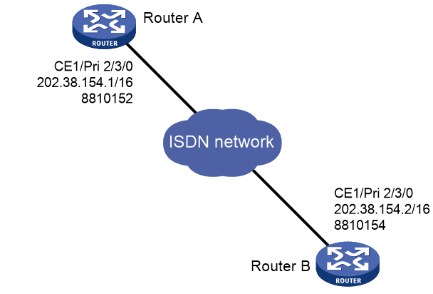

The following describes the functionality of the protocols in the D-channel protocol stack:
·     Q.921—Provides the following functions:
¡     A reliable transport for Layer 3 Q.931 signaling messages.
¡     Identification of frames.
¡     Flow control mechanisms for data transmission and reception.
·     Q.931—Provides call control and management. These functions include call setup, call disconnection, and request for services from Layer 2.
·     Call control (CC)—Forwards messages received by Q.931 from the network side to higher-layer applications such as the DDR or voice module for information conversion and call routing.
Figure 1 ISDN D-channel protocol stack

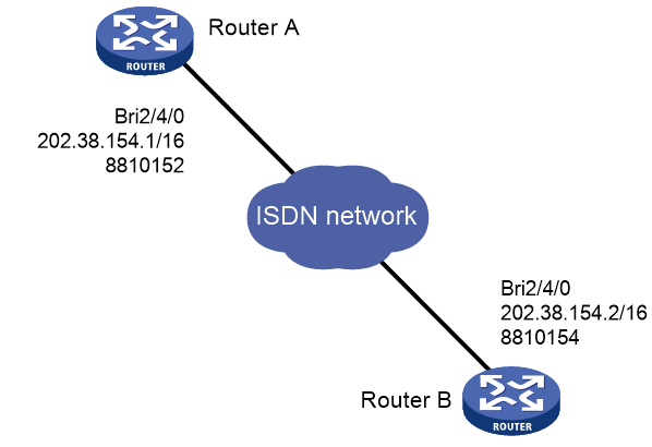

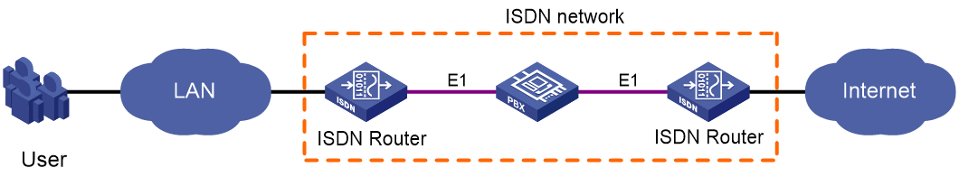

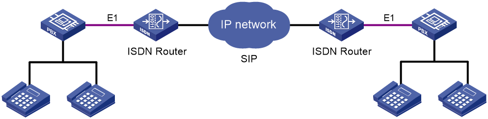

ISDN application scenarios
Figure 2 and Figure 3 show typical ISDN network diagrams for data services and voice services, respectively.
Figure 2 Data ISDN application scenario
Figure 3 Voice ISDN application scenario

Example: Configuring ISDN PRI
As shown in Figure 4, configure an ISDN PRI line between Router A and Router B for data transmission.
Figure 4 Network diagram
In this example, the ISDN PRI interfaces on Router A and Router B are operating as the user side (the default). You must configure the ISDN PRI interfaces as the network side on the service provider switches connected to the routers.
1.     Configure Router A:
# Bundle timeslots into a PRI set on CE1/PRI interface E1 2/3/0.
<RouterA> system-view
[RouterA] controller e1 2/3/0
[RouterA-E1 2/3/0] pri-set
[RouterA-E1 2/3/0] quit
# Configure dialer access group 1 to allow any IP packets to trigger a call setup.
[RouterA] dialer-group 1 rule ip permit
# Assign Serial 2/3/0:15 an IP address.
[RouterA] interface serial 2/3/0:15
[RouterA-Serial2/3/0:15] ip address 202.38.154.1 255.255.0.0
# Enable C-DDR on Serial 2/3/0:15, configure the route to Router B, and assign Serial 2/3/0:15 to dialer-group 1.
[RouterA-Serial2/3/0:15] dialer circular enable
[RouterA-Serial2/3/0:15] dialer route ip 202.38.154.2 8810154
[RouterA-Serial2/3/0:15] dialer-group 1
2.     Configure Router B:
<RouterB> system-view
[RouterB] controller e1 2/3/0
[RouterB-E1 2/3/0] pri-set
[RouterB-E1 2/3/0] quit

Example: Configuring NI-enabled ISDN BRI
As shown in Figure 5, configure an NI-enabled ISDN BRI line between Router A and Router B for data transmission.
Figure 5 Network diagram
In this example, the ISDN BRI interfaces on Router A and Router B are operating on the user side (the default). You must configure the ISDN PRI interfaces as the network side on the service provider switches connected to the routers.
# Configure dialer-group 1 to allow any IP packets to trigger a call setup.
# Assign an IP address to BRI 2/4/0.
[RouterA] interface bri 2/4/0
[RouterA-Bri2/4/0] ip address 202.38.154.1 255.255.0.0
# Enable C-DDR on BRI 2/4/0, configure the route to Router B, and assign BRI 2/4/0 to dialer-group 1.
[RouterA-Bri2/4/0] dialer circular enable
[RouterA-Bri2/4/0] dialer route ip 202.38.154.2 8810154
[RouterA-Bri2/4/0] dialer-group 1
# Set the switch type to NI on BRI 2/4/0.
[RouterA-Bri2/4/0] isdn protocol-type ni
# On BRI 2/4/0, assign SPID 54321 to the B1 channel and SPID 65432 to the B2 channel.
[RouterA-Bri2/4/0] isdn spid1 54321
[RouterA-Bri2/4/0] isdn spid2 65432
# On BRI 2/4/0, set the maximum number of INFORMATION retransmissions to 2.
[RouterA-Bri2/4/0] isdn spid resend 2
[RouterB] dialer-group 1 rule ip permit
[RouterB] interface bri 2/4/0
[RouterB-Bri2/4/0] ip address 202.38.154.2 255.255.0.0
# Enable C-DDR on BRI 2/4/0, configure the route to Router A, and assign BRI 2/4/0 to dialer-group 1.
[RouterB-Bri2/4/0] dialer circular enable
[RouterB-Bri2/4/0] dialer route ip 202.38.154.1 8810152
[RouterB-Bri2/4/0] dialer-group 1
[RouterB-Bri2/4/0] isdn protocol-type ni
# On BRI 2/4/0, assign SPID 12345 to the B1 channel and SPID 23456 to the B2 channel.
[RouterB-Bri2/4/0] isdn spid1 12345
[RouterB-Bri2/4/0] isdn spid2 23456
[RouterB-Bri2/4/0] isdn spid resend 2
Verify the configuration
# Ping 202.38.154.2 from Router A to verify that the state of a B-channel on BRI 2/4/0 changes to Line up.
# Ping 202.38.154.2 again to verify that the ISDN BRI line transfers data without any losses.
