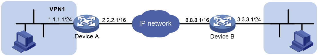

ACL for MPLS L3VPN IPsec protection
To use IPsec to protect the data of an MPLS L3VPN, you must specify the VPN instance for the protected data in the ACL.
As shown in Figure 7, to protect traffic of VPN1 by using IPsec, you must configure the ACL on Device A as follows:
acl advanced 3400
 rule 0 permit ip vpn-instance vpn1 source 1.1.1.0 0.0.0.255 destination 3.3.3.0 0.0.0.255
In addition, you must specify VPN1 as the inside VPN instance in the IKE profile.
ike profile vpn1
 keychain vpn1
 match remote identity address 8.8.8.1 255.255.255.255
 inside-vpn vpn-instance vpn1
Figure 7 IPsec for MPLS L3VPN

Configuring IPsec RRI
Enabling IPsec RRI for an IPsec policy deletes all existing IPsec SAs created by this IPsec policy. IPsec RRI creates static routes according to new IPsec SAs.
Disabling IPsec RRI for an IPsec policy deletes all existing IPsec SAs created by this IPsec policy and the associated static routes.
IPsec RRI is supported in both tunnel mode and transport mode.
If you change the preference value or tag value for an IPsec policy, the device deletes all IPsec SAs created by this IPsec policy, and the associated static routes. The change takes effect for future IPsec RRI-created static routes.
IPsec RRI does not generate a static route to a destination address to be protected if the destination address is not defined in the ACL used by an IPsec policy or an IPsec policy template. You must manually configure a static route to the destination address.
In an MPLS L3VPN network, IPsec RRI can add static routes to VPN instances' routing tables.

IPsec configuration examples
Example: Configuring a manual mode IPsec tunnel for IPv4 packets
As shown in Figure 8, establish an IPsec tunnel between Switch A and Switch B to protect data flows between the switches. Configure the tunnel as follows:
·     Specify the encapsulation mode as tunnel, the security protocol as ESP, the encryption algorithm as AES-CBC-192, and the authentication algorithm as HMAC-SHA1.
·     Manually set up IPsec SAs.
Figure 8 Network diagram
1.     Configure Switch A:
# Configure an IP address for VLAN-interface 1.
<SwitchA> system-view
[SwitchA] interface vlan-interface 1

Example: Configuring an IKE-based IPsec tunnel for IPv4 packets
As shown in Figure 9, establish an IPsec tunnel between Switch A and Switch B to protect data flows between them. Configure the IPsec tunnel as follows:
·     Set up SAs through IKE negotiation.
Figure 9 Network diagram

Example: Configuring IPsec RRI
As shown in Figure 11, branches access the enterprise center through an IPsec VPN.
Configure the IPsec VPN as follows:
·     Configure an IPsec tunnel between Switch A and each branch gateway (Switch B, Switch C, and Switch D) to protect traffic between subnets 4.4.4.0/24 and 5.5.5.0/24.
·     Configure the tunnels to use security protocol ESP, encryption algorithm DES, and authentication algorithm SHA1-HMAC-96. Use IKE for IPsec SA negotiation.
·     Configure IKE proposal to use the preshared key authentication method, encryption algorithm 3DES, and authentication algorithm HMAC-SHA1.
·     Configure IPsec RRI on Switch A to automatically create static routes to the branches based on the established IPsec SAs.
Figure 11 Network diagram
1.     Assign IPv4 addresses to the interfaces on the switches according to Figure 11. (Details not shown.)
2.     Configure Switch A:
# Create an IPsec transform set named tran1, and specify ESP as the security protocol, DES as the encryption algorithm, and HMAC-SHA-1-96 as the authentication algorithm.
[SwitchA] ipsec transform-set tran1
[SwitchA-ipsec-transform-set-tran1] encapsulation-mode tunnel
[SwitchA-ipsec-transform-set-tran1] protocol esp
[SwitchA-ipsec-transform-set-tran1] esp encryption-algorithm des
[SwitchA-ipsec-transform-set-tran1] esp authentication-algorithm sha1
[SwitchA-ipsec-transform-set-tran1] quit
# Create and configure the IKE profile named profile1.
[SwitchA] ike profile profile1
[SwitchA-ike-profile-profile1] keychain key1
[SwitchA-ike-profile-profile1] match remote identity address 2.2.2.2 255.255.255.0
[SwitchA-ike-profile-profile1] quit
# Create an IPsec policy template named temp1. Specify IPsec transform set tran1 and IKE profile profile1 for the IPsec policy template.
[SwitchA] ipsec policy-template temp1 1
[SwitchA-ipsec-policy-template-temp1-1] transform-set tran1
[SwitchA-ipsec-policy-template-temp1-1] ike-profile profile1
# Enable IPsec RRI, set the preference to 100 and the tag to 1000 for the static routes created by IPsec RRI.
[SwitchA-ipsec-policy-template-temp1-1] reverse-route dynamic
[SwitchA-ipsec-policy-template-temp1-1] reverse-route preference 100
[SwitchA-ipsec-policy-template-temp1-1] reverse-route tag 1000
[SwitchA-ipsec-policy-template-temp1-1] quit
# Create an IKE-based IPsec policy entry by using IPsec policy template temp1. Specify the policy name as map1 and set the sequence number to 10.
[SwitchA] ipsec policy map1 10 isakmp template temp1
# Create an IKE proposal named 1, and specify 3DES as the encryption algorithm, HMAC-SHA1 as the authentication algorithm, and pre-share as the authentication method.
[SwitchA] ike proposal 1
[SwitchA-ike-proposal-1] encryption-algorithm 3des-cbc
[SwitchA-ike-proposal-1] authentication-algorithm sha
[SwitchA-ike-proposal-1] authentication-method pre-share
[SwitchA-ike-proposal-1] quit
# Create an IKE keychain named key1 and specify 123 in plain text as the preshared key to be used with the remote peer at 2.2.2.2.
[SwitchA] ike keychain key1
[SwitchA-ike-keychain-key1] pre-shared-key address 2.2.2.2 key simple 123
[SwitchA-ike-keychain-key1] quit
# Apply IPsec policy map1 to VLAN-interface 100.
[SwitchA-Vlan-interface100] ipsec apply policy map1

IKE configuration examples
Example: Configuring main-mode IKE with preshared key authentication
As shown in Figure 15, configure an IKE-based IPsec tunnel between Switch A and Switch B to secure the communication between the switches.
·     Configure the two switches to use the default IKE proposal for the IKE negotiation.
·     Configure the two switches to use the preshared key authentication method for the IKE negotiation.
Figure 15 Network diagram
