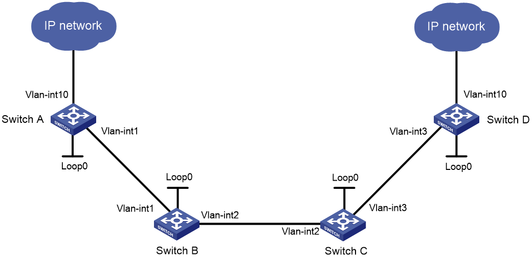

CRLSP setup procedure
As shown in Figure 1, a CRLSP is set up by using the following steps:
1.     The ingress LSR generates a Path message that carries LABEL_REQUEST, and then forwards the message along the path calculated by CSPF hop-by-hop towards the egress LSR.
2.     After receiving the Path message, the egress LSR generates a Resv message carrying the reservation information and the LABEL object. It forwards the Resv message to the ingress LSR along the reverse direction of the path that the Path message traveled.
The Resv message advertises labels, reserves resources, and creates a reserve state on each LSR it passes, so QoS can be guaranteed for services transmitted on the CRLSP.
3.     When the ingress LSR receives the Resv message, the CRLSP is established.
Figure 1 Setting up a CRLSP

RSVP configuration examples
Example: Establishing an MPLS TE tunnel with RSVP-TE
Switch A, Switch B, Switch C, and Switch D run IS-IS and all of them are Layer 2 switches.
Use RSVP-TE to establish an MPLS TE tunnel from Switch A to Switch D to transmit data between the two IP networks. The MPLS TE tunnel requires a bandwidth of 2000 kbps.
The maximum bandwidth of the link that the tunnel traverses is 10000 kbps.
Figure 2 Network diagram
Device
Interface
IP address
Device
Interface
IP address
Switch A
Loop0
1.1.1.9/32
Switch D
Loop0
4.4.4.9/32
Vlan-int1
10.1.1.1/24
Vlan-int3
30.1.1.2/24
Vlan-int10
100.1.1.1/24
Vlan-int10
100.1.2.1/24
Switch B
Loop0
2.2.2.9/32
Switch C
Loop0
3.3.3.9/32
Vlan-int1
10.1.1.2/24
Vlan-int3
30.1.1.1/24
Vlan-int2
20.1.1.1/24
Vlan-int2
20.1.1.2/24
1.     Configure IP addresses and masks for interfaces. (Details not shown.)
2.     Configure IS-IS to advertise interface addresses, including the loopback interface address:

# Execute the display ip routing-table command on Switch A to verify that a static route entry with interface Tunnel 1 as the output interface exists. (Details not shown.)

[SwitchA-Vlan-interface1] rsvp enable
[SwitchA-Vlan-interface1] rsvp hello enable
[SwitchA-Vlan-interface1] quit
# Configure Switch B.
<SwitchB> system-view
[SwitchB] mpls lsr-id 2.2.2.9
[SwitchB] mpls te
[SwitchB-te] quit
[SwitchB] rsvp
[SwitchB-rsvp] quit
[SwitchB-mpls] interface vlan-interface 1
[SwitchB-Vlan-interface1] mpls enable
[SwitchB-Vlan-interface1] mpls te enable
[SwitchB-Vlan-interface1] rsvp enable
[SwitchB-Vlan-interface1] rsvp hello enable
[SwitchB-Vlan-interface1] quit
[SwitchB-Vlan-interface2] mpls enable
[SwitchB-Vlan-interface2] mpls te enable
[SwitchB-Vlan-interface2] rsvp enable
[SwitchB-Vlan-interface2] rsvp hello enable
[SwitchB-Vlan-interface2] quit
# Configure Switch C.
<SwitchC> system-view
[SwitchC] mpls lsr-id 3.3.3.9
[SwitchC] mpls te
[SwitchC-te] quit
[SwitchC] rsvp
[SwitchC-rsvp] quit
[SwitchC] interface vlan-interface 2
[SwitchC-Vlan-interface2] mpls enable
[SwitchC-Vlan-interface2] mpls te enable
[SwitchC-Vlan-interface2] rsvp enable
[SwitchC-Vlan-interface2] rsvp hello enable
[SwitchC-Vlan-interface2] quit
4.     Configure IS-IS TE. (Details not shown.)
5.     Configure an MPLS TE tunnel. (Details not shown.)
6.     Configure RSVP GR:
# Configure Switch A.
[SwitchA] rsvp
[SwitchA-rsvp] graceful-restart enable
[SwitchB] rsvp
[SwitchB-rsvp] graceful-restart enable
[SwitchC] rsvp
[SwitchC-rsvp] graceful-restart enable
# After a tunnel is established from Switch A and Switch C, display detailed RSVP neighbor information on Switch A.
<SwitchA> display rsvp peer verbose
Peer: 10.1.1.2                            Interface: Vlan1
Hello state: Up                           Hello type: Active
P2P PSB count: 0                          P2P RSB count: 1
P2MP PSB count: 0                         P2MP RSB count: 0
Src instance: 0x1f08                      Dst instance: 0x22
Summary refresh: Disabled                 Graceful Restart state: Ready
Peer GR restart time: 120000 ms           Peer GR recovery time: 0 ms
The output shows that the neighbor's GR state is Ready.
