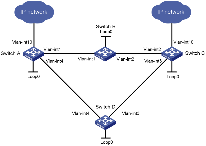

As shown in Figure 1, PCE 1 is the ABR that can calculate paths in Area 0 and Area 1. PCE 2 is the ABR that can calculate paths in Area 1 and Area 2. The CRLSP that PCC uses to reach a destination in Area 2 is established as follows:
1.     PCC sends a path calculation request to PCE 1 to request the path to the CRLSP destination.
2.     PCE 1 forwards the request to PCE 2.
PCE 1 cannot calculate paths in Area 2, so it forwards the request to PCE 2, the PCE responsible for Area 2 that contains the CRLSP destination.
3.     After receiving the request from PCE 1, PCE 2 calculates potential paths to the CRLSP destination and sends the path information back to PCE 1 in a reply.
4.     PCE 1 uses the local and received path information to select an end-to-end path for the PCC to reach the CRLSP destination, and sends the path to PCC as a reply.
5.     PCC uses the path calculated by PCEs to establish the CRLSP through RSVP-TE.
Figure 1 BRPC path calculation

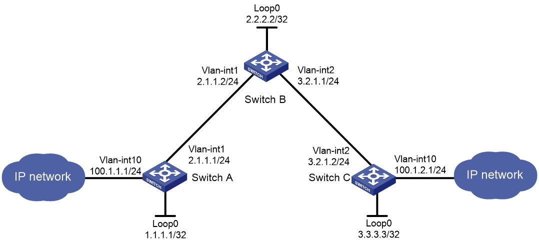

As shown in Figure 2, an MPLS TE tunnel exists from Device D to Device C. IGP shortcut enables only the ingress node Device D to use the MPLS TE tunnel in the IGP route calculation. Device A cannot use this tunnel to reach Device C. With forwarding adjacency enabled, Device A can learn this MPLS TE tunnel and transfer traffic to Device C by forwarding the traffic to Device D.
Figure 2 IGP shortcut and forwarding adjacency diagram

Route pinning
Route pinning enables CRLSPs to always use the original optimal path even if a new optimal route has been learned.
On a network where route changes frequently occur, you can use route pinning to avoid re-establishing CRLSPs upon route changes.
Tunnel reoptimization
Tunnel reoptimization allows you to manually or dynamically trigger the ingress node to recalculate a path. If the ingress node recalculates a better path, it creates a new CRLSP, switches traffic from the old CRLSP to the new, and then deletes the old CRLSP.
MPLS TE uses the tunnel reoptimization feature to implement dynamic CRLSP optimization. For example, if a link on the optimal path does not have enough reservable bandwidth, MPLS TE sets up the tunnel on another path. When the link has enough bandwidth, the tunnel optimization feature can switch the MPLS TE tunnel to the optimal path.

FRR
Fast reroute (FRR) protects CRLSPs from link and node failures. FRR can implement 50-millisecond CRLSP failover.
After FRR is enabled for an MPLS TE tunnel, once a link or node fails on the primary CRLSP, FRR reroutes the traffic to a bypass tunnel. The ingress node attempts to set up a new CRLSP. After the new CRLSP is set up, traffic is forwarded on the new CRLSP.
CRLSP backup provides end-to-end path protection for a CRLSP without time limitation. FRR provides quick but temporary protection for a link or node on a CRLSP.
Basic concepts
·     Primary CRLSP—Protected CRLSP.
·     Bypass tunnel—An MPLS TE tunnel used to protect a link or node of the primary CRLSP.
·     Point of local repair—A PLR is the ingress node of the bypass tunnel. It must be located on the primary CRLSP but must not be the egress node of the primary CRLSP.
·     Merge point—An MP is the egress node of the bypass tunnel. It must be located on the primary CRLSP but must not be the ingress node of the primary CRLSP.
Protection modes
FRR provides the following protection modes:
·     Link protection—The PLR and the MP are connected through a direct link and the primary CRLSP traverses this link. When the link fails, traffic is switched to the bypass tunnel. As shown in Figure 4, the primary CRLSP is Device A—Device B—Device C—Device D, and the bypass tunnel is Device B—Device F—Device C. This mode is also called next-hop (NHOP) protection.
Figure 4 FRR link protection
·     Node protection—The PLR and the MP are connected through a device and the primary CRLSP traverses this device. When the device fails, traffic is switched to the bypass tunnel. As shown in Figure 5, the primary CRLSP is Device A—Device B—Device C—Device D—Device E, and the bypass tunnel is Device B—Device F—Device D. Device C is the protected device. This mode is also called next-next-hop (NNHOP) protection.
Figure 5 FRR node protection

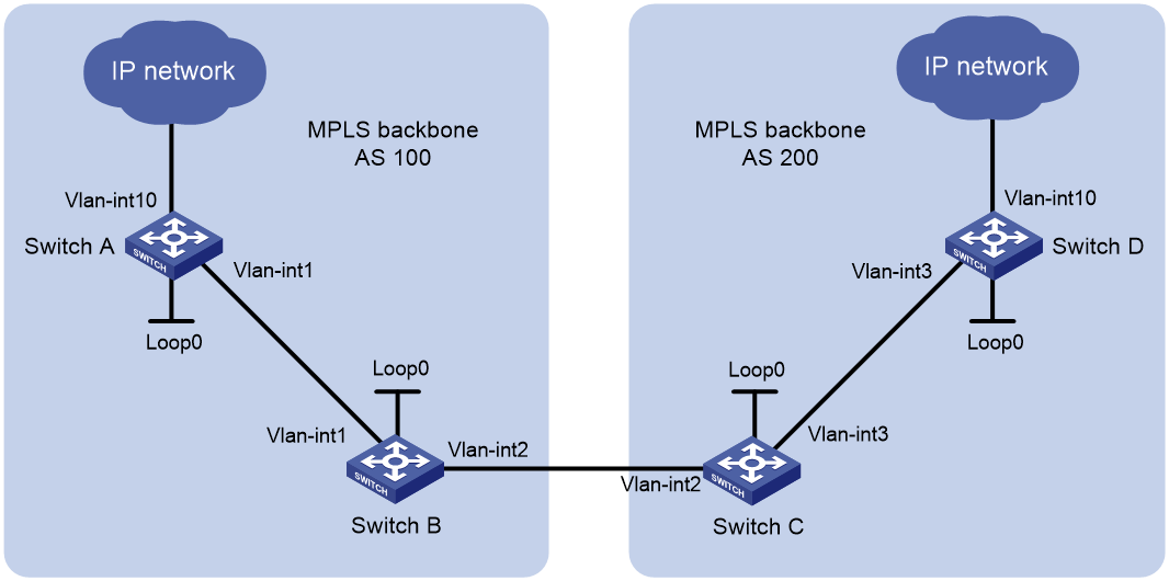

Example: Establishing an MPLS TE tunnel over a static CRLSP
Switch A, Switch B, and Switch C run IS-IS.
Establish an MPLS TE tunnel over a static CRLSP from Switch A to Switch C to transmit data between the two IP networks.
The MPLS TE tunnel requires a bandwidth of 2000 kbps. The maximum bandwidth of the link that the tunnel traverses is 10000 kbps.
Figure 6 Network diagram
1.     Configure IP addresses and masks for interfaces. (Details not shown.)
2.     Configure IS-IS to advertise interface addresses, including the loopback interface address:
# Configure Switch A.

5.     Configure an MPLS TE tunnel on Switch A:
# Configure MPLS TE tunnel interface Tunnel 1.
[SwitchA] interface tunnel 1 mode mpls-te
[SwitchA-Tunnel1] ip address 6.1.1.1 255.255.255.0
# Specify the tunnel destination address as the LSR ID of Switch C.
[SwitchA-Tunnel1] destination 3.3.3.3
# Configure MPLS TE to use a static CRLSP to establish the tunnel.
[SwitchA-Tunnel1] mpls te signaling static
[SwitchA-Tunnel1] quit
6.     Create a static CRLSP:
# Configure Switch A as the ingress node of the static CRLSP, and specify the next hop address as 2.1.1.2, outgoing label as 20, and bandwidth for the tunnel as 2000 kbps.
[SwitchA] static-cr-lsp ingress static-cr-lsp-1 nexthop 2.1.1.2 out-label 20 bandwidth 2000
# On Switch A, configure tunnel 1 to use static CRLSP static-cr-lsp-1.
[SwitchA] interface Tunnel1
[SwitchA-Tunnel1] mpls te static-cr-lsp static-cr-lsp-1
# Configure Switch B as the transit node of the static CRLSP, and specify the incoming label as 20, next hop address as 3.2.1.2, outgoing label as 30, and bandwidth for the tunnel as 2000 kbps.
[SwitchB] static-cr-lsp transit static-cr-lsp-1 in-label 20 nexthop 3.2.1.2 out-label 30 bandwidth 2000
# Configure Switch C as the egress node of the static CRLSP, and specify the incoming label as 30.
[SwitchC] static-cr-lsp egress static-cr-lsp-1 in-label 30
7.     Configure a static route on Switch A to direct traffic destined for subnet 100.1.2.0/24 to MPLS TE tunnel 1.
[SwitchA] ip route-static 100.1.2.0 24 tunnel 1 preference 1

Example: Establishing an MPLS TE tunnel with RSVP-TE
Switch A, Switch B, Switch C, and Switch D run IS-IS and all of them are Level-2 switches.
Use RSVP-TE to establish an MPLS TE tunnel from Switch A to Switch D to transmit data between the two IP networks. The MPLS TE tunnel requires a bandwidth of 2000 kbps.
Figure 7 Network diagram
Device
Interface
IP address
Device
Interface
IP address
Switch A
Loop0
1.1.1.9/32
Switch D
Loop0
4.4.4.9/32
Vlan-int1
10.1.1.1/24
Vlan-int3
30.1.1.2/24
Vlan-int10
100.1.1.1/24
Vlan-int10
100.1.2.1/24
Switch B
Loop0
2.2.2.9/32
Switch C
Loop0
3.3.3.9/32
Vlan-int1
10.1.1.2/24
Vlan-int3
30.1.1.1/24
Vlan-int2
20.1.1.1/24
Vlan-int2
20.1.1.2/24

Example: Establishing an inter-AS MPLS TE tunnel with RSVP-TE
Switch A and Switch B are in AS 100. Switch C and Switch D are in AS 200. AS 100 and AS 200 use OSPF as the IGP.
Establish an EBGP connection between ASBRs Switch B and Switch C. Redistribute BGP routes into OSPF and OSPF routes into BGP, so that a route is available between AS 100 and AS 200.
Use RSVP-TE to establish an MPLS TE tunnel from Switch A to Switch D to transmit data between the two IP networks. The tunnel requires a bandwidth of 2000 kbps. The maximum bandwidth of the link that the tunnel traverses is 10000 kbps.
Figure 8 Network diagram
Device
Interface
IP address
Device
Interface
IP address
Switch A
Loop0
1.1.1.9/32
Switch D
Loop0
4.4.4.9/32
Vlan-int1
10.1.1.1/24
Vlan-int3
30.1.1.2/24
Vlan-int10
100.1.1.1/24
Vlan-int10
100.1.2.1/24
Switch B
Loop0
2.2.2.9/32
Switch C
Loop0
3.3.3.9/32
Vlan-int1
10.1.1.2/24
Vlan-int3
30.1.1.1/24
Vlan-int2
20.1.1.1/24
Vlan-int2
20.1.1.2/24

Example: Establishing an inter-area MPLS TE tunnel over a CRLSP calculated by PCEs
Switch A, Switch B, Switch C, and Switch D support MPLS TE and run OSPF.
Configure Switch A and Switch B as PCEs, and configure Switch C as a PCC to automatically discover the PCEs.
Establish an MPLS TE tunnel over a CRLSP from Switch C to Switch D that uses the inter-area path calculated by PCEs.
Figure 9 Network diagram

Example: Configuring bidirectional MPLS TE tunnel
Switch A, Switch B, Switch C, and Switch D all run IS-IS and they are all level-2 switches.
Use RSVP-TE to establish a bidirectional MPLS TE tunnel between Switch A and Switch D.
Figure 10 Network diagram
Table 3 Interface and IP address assignment
Device
Interface
IP address
Device
Interface
IP address
Switch A
Loop0
1.1.1.9/32
Switch D
Loop0
4.4.4.9/32
Vlan-int1
10.1.1.1/24
Vlan-int3
30.1.1.2/24
Vlan-int10
100.1.1.1/24
Vlan-int10
100.1.2.1/24
Switch B
Loop0
2.2.2.9/32
Switch C
Loop0
3.3.3.9/32
Vlan-int1
10.1.1.2/24
Vlan-int3
30.1.1.1/24
Vlan-int2
20.1.1.1/24
Vlan-int2
20.1.1.2/24

Example: Configuring CRLSP backup
Switch A, Switch B, Switch C, and Switch D run IS-IS and IS-IS TE.
Use RSVP-TE to establish an MPLS TE tunnel from Switch A to Switch C to transmit data between the two IP networks. Enable CRLSP hot backup for the tunnel to simultaneously establish a primary CRLSP and a backup CRLSP. When the primary CRLSP fails, traffic is switched to the backup CRLSP.
Figure 11 Network diagram
Table 4 Interface and IP address assignment
Device
Interface
IP address
Device
Interface
IP address
Switch A
Loop0
1.1.1.9/32
Switch D
Loop0
4.4.4.9/32
Vlan-int1
10.1.1.1/24
Vlan-int4
30.1.1.2/24
Vlan-int4
30.1.1.1/24
Vlan-int3
40.1.1.1/24
Vlan-int10
100.1.1.1/24
Switch C
Loop0
3.3.3.9/32
Switch B
Loop0
2.2.2.9/32
Vlan-int2
20.1.1.2/24
Vlan-int1
10.1.1.2/24
Vlan-int3
40.1.1.2/24
Vlan-int2
20.1.1.1/24
Vlan-int10
100.1.2.1/24
