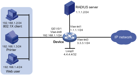

Triple authentication configuration examples
Triple authentication basic function configuration example
Network requirements
As shown in Figure 2, the terminals are connected to the device to access the IP network. Configure triple authentication on the device's Layer 2 interface that connects to the terminals. A terminal passing one of the three authentication methods, 802.1X authentication, Web authentication, and MAC authentication, can access the IP network.
·     Assign IP addresses on subnet 192.168.1.0/24 to the terminals.
·     Use the remote RADIUS server to perform authentication, authorization, and accounting. Configure the device to send usernames carrying no ISP domain names to the RADIUS server.
·     Configure the local Web authentication server on the device to use listening IP address 4.4.4.4. Configure the device to send a default authentication page to the Web user and forward authentication data by using HTTP.
Figure 2 Network diagram
Configuration prerequisites and restrictions
·     Make sure that the terminals, the server, and the device can reach each other.
·     Make sure the terminal of the Web user has a route to the listening IP address of the local Web authentication server.
·     Configure the RADIUS server to provide normal authentication, authorization, and accounting for users. In this example, configure the following on the RADIUS server:
?     An 802.1X user with username userdot.
?     A Web authentication user with username userpt.
?     A MAC authentication user with a username and password both being the MAC address of the printer f07d6870725f.
·     Edit authentication pages, compress the pages to a .zip file named abc, and upload the .zip file to the device by FTP.
Configuration procedure

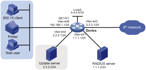

Triple authentication supporting authorization VLAN and authentication failure VLAN configuration example
Network requirement
As shown in Figure 3, the terminals are connected to the device to access the IP network. Configure triple authentication on the device's Layer 2 interface connected to the terminals. A terminal passing one of the three authentication methods, 802.1X authentication, Web authentication, and MAC authentication, can access the IP network.
·     The Web authentication terminal uses DHCP to get an IP address in 192.168.1.0/24 before authentication and in 3.3.3.0/24 after passing authentication. If the terminal fails authentication, it requests IP addresses in 2.2.2.0/24 through DHCP.
You can use the access device or an attached device as the DHCP server. In this example, the access device (the device) provides the DHCP service.
·     The 802.1X terminal uses DHCP to get an IP address in 192.168.1.0/24 before authentication and in 3.3.3.0/24 after passing authentication. If the terminal fails authentication, it requests IP addresses in 2.2.2.0/24 through DHCP.
·     After passing authentication, the printer obtains IP address 3.3.3.111/24 that is bound with its MAC address through DHCP.
·     Use the remote RADIUS server to perform authentication, authorization, and accounting. Configure the device to remove the ISP domain names from usernames sent to the RADIUS server.
·     Configure VLAN 3 as the authorization VLAN. Users passing authentication are added to this VLAN.
·     Configure VLAN 2 as the authentication failure VLAN. Users failing authentication are added to this VLAN.
Figure 3 Network diagram
Configuration prerequisites and guidelines
·     Make sure the terminals, the servers, and the device can reach each other.
1.     Configure DHCP:
# Configure VLANs and IP addresses for the VLAN interfaces, and add ports to specific VLANs. (Details not shown.)
