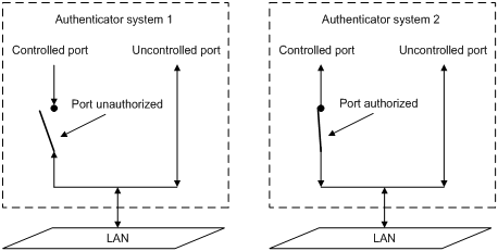

Controlled/uncontrolled port and port authorization status
802.1X defines two logical ports for the network access port: controlled port and uncontrolled port. Any packet arriving at the network access port is visible to both logical ports.
·     Uncontrolled port—Is always open to receive and transmit authentication packets.
·     Controlled port—Filters packets depending on the port state.
¡     Authorized state—The controlled port is in authorized state when the client has passed authentication. The port allows traffic to pass through.
¡     Unauthorized state—The port is in unauthorized state when the client has failed authentication. The port controls traffic by using one of the following methods:
-     Performs bidirectional traffic control to deny traffic to and from the client.
-     Performs unidirectional traffic control to deny traffic from the client. The H3C devices support only unidirectional traffic control.
Figure 2 Authorization state of a controlled port

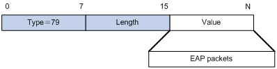

EAP-Message
RADIUS encapsulates EAP packets in the EAP-Message attribute, as shown in Figure 5. The Type field takes 79, and the Value field can be up to 253 bytes. If an EAP packet is longer than 253 bytes, RADIUS encapsulates it in multiple EAP-Message attributes.
Figure 5 EAP-Message attribute format

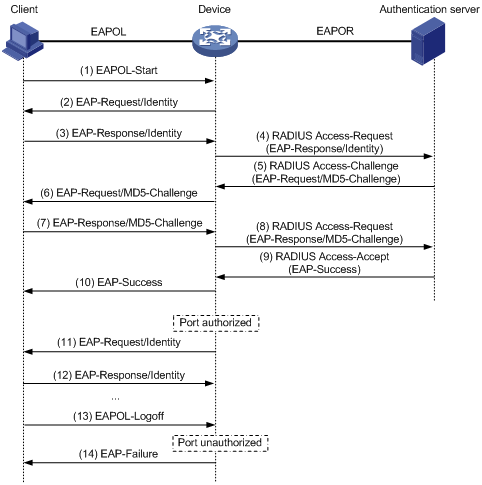

802.1X authentication has two methods: EAP relay and EAP termination. You choose either mode depending on support of the RADIUS server for EAP packets and EAP authentication methods.
·     EAP relay mode.
EAP relay is defined in IEEE 802.1X. In this mode, the network device uses EAPOR packets to send authentication information to the RADIUS server, as shown in Figure 7.
Figure 7 EAP relay
In EAP relay mode, the client must use the same authentication method as the RADIUS server. On the access device, you only need to use the dot1x authentication-method eap command to enable EAP relay.
·     EAP termination mode.
As shown in Figure 8, the access device performs the following operations in EAP termination mode:
a.     Terminates the EAP packets received from the client.
b.     Encapsulates the client authentication information in standard RADIUS packets.
c.     Uses PAP or CHAP to authenticate to the RADIUS server.
Figure 8 EAP termination
Comparing EAP relay and EAP termination

Figure 9 shows the basic 802.1X authentication procedure in EAP relay mode, assuming that EAP-MD5 is used.
Figure 9 802.1X authentication procedure in EAP relay mode
The following steps describe the 802.1X authentication procedure:
1.     When a user launches the 802.1X client and enters a registered username and password, the 802.1X client sends an EAPOL-Start packet to the access device.
2.     The access device responds with an EAP-Request/Identity packet to ask for the client username.
3.     In response to the EAP-Request/Identity packet, the client sends the username in an EAP-Response/Identity packet to the access device.
4.     The access device relays the EAP-Response/Identity packet in a RADIUS Access-Request packet to the authentication server.
5.     The authentication server uses the identity information in the RADIUS Access-Request to search its user database. If a matching entry is found, the server uses a randomly generated challenge (EAP-Request/MD5-Challenge) to encrypt the password in the entry. Then, the server sends the challenge in a RADIUS Access-Challenge packet to the access device.
6.     The access device transmits the EAP-Request/MD5-Challenge packet to the client.
7.     The client uses the received challenge to encrypt the password, and sends the encrypted password in an EAP-Response/MD5-Challenge packet to the access device.
8.     The access device relays the EAP-Response/MD5-Challenge packet in a RADIUS Access-Request packet to the authentication server.
9.     The authentication server compares the received encrypted password with the encrypted password it generated at step 5. If the two passwords are identical, the server considers the client valid and sends a RADIUS Access-Accept packet to the access device.
10.     Upon receiving the RADIUS Access-Accept packet, the access device performs the following operations:
a.     Sends an EAP-Success packet to the client.
b.     Sets the controlled port in authorized state.
The client can access the network.
11.     After the client comes online, the access device periodically sends handshake requests to check whether the client is still online. By default, if two consecutive handshake attempts fail, the device logs off the client.
12.     Upon receiving a handshake request, the client returns a response. If the client fails to return a response after a number of consecutive handshake attempts (two by default), the access device logs off the client. This handshake mechanism enables timely release of the network resources used by 802.1X users that have abnormally gone offline.
13.     The client can also send an EAPOL-Logoff packet to ask the access device for a logoff.
14.     In response to the EAPOL-Logoff packet, the access device changes the status of the controlled port from authorized to unauthorized. Then, the access device sends an EAP-Failure packet to the client.

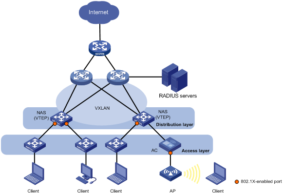

802.1X support for VXLANs
The device can act as a VTEP in a VXLAN network. As shown in Figure 11, when VTEPs in a VXLAN network act as NASs, users' VLANs cannot identify their service information. To resolve this issue, you must configure the RADIUS server to assign VSIs to authenticated 802.1X users. The VTEPs will map the users' traffic to the VXLANs that are associated with the users' respective authorization VSIs. The mapping criteria include the user access VLAN, access port, and MAC address.
For information about VSIs and VXLANs, see VXLAN Configuration Guide.
Figure 11 VXLAN network diagram for 802.1X authentication

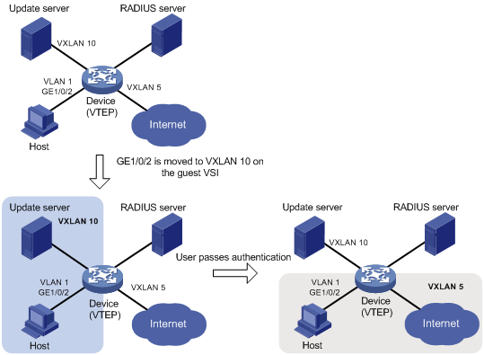

Guest VSI
The 802.1X guest VSI on a port accommodates users that have not performed 802.1X authentication. You can deploy a limited set of network resources in the VXLAN that is associated with the guest VSI. For example, deploy a software server for users to download anti-virus software and system patches. Once a user in the guest VSI passes 802.1X authentication, the user is removed from the guest VSI and can access authorized network resources.
The following table shows how the VTEP handles VSIs on an 802.1X-enabled port that performs MAC-based access control:
Authentication status
VSI manipulation
A user accesses the port and has not performed 802.1X authentication.
The VTEP maps the user's MAC address and access VLAN to the 802.1X guest VSI on the port. The user can access only resources in the VXLAN associated with the guest VSI.
A user in the 802.1X guest VSI fails 802.1X authentication.
If an 802.1X Auth-Fail VSI is available on the port, the VTEP remaps the user's MAC address and access VLAN to the Auth-Fail VSI. The user can access only resources in the VXLAN associated with the Auth-Fail VSI.
If no 802.1X Auth-Fail VSI is configured on the port, the user is removed from the 802.1X guest VSI.
A user in the 802.1X guest VSI passes 802.1X authentication.
The VTEP removes the user from the 802.1X guest VSI and remaps the user's MAC address and access VLAN to the authorization VSI.

Configuring an 802.1X guest VSI
You can configure only one 802.1X guest VSI on a port. The 802.1X guest VSIs on different ports can be different.
Only ports that perform MAC-based access control support the 802.1X guest VSI.
For the 802.1X guest VSI feature to work correctly, do not configure it together with EAD assistant.
Configuration prerequisites
Before you configure the 802.1X guest VSI on an 802.1X-enabled port, complete the following tasks:
·     Enable L2VPN.
·     Create the VSI to be specified as the 802.1X guest VSI, and create a VXLAN for the VSI.
·     Enable MAC-based traffic match mode for dynamic ACs.
For more information, see VXLAN Configuration Guide.
Configuration procedure
To configure the 802.1X guest VSI on a port:
Step
Remarks
N/A
2.     Enter interface view.
N/A
3.     Configure the 802.1X guest VSI on the port.
dot1x guest-vsi guest-vsi-name
By default, no 802.1X guest VSI exists.
Enabling 802.1X guest VSI assignment delay
Overview
This feature delays assigning an 802.1X-enabled port to the 802.1X guest VSI when 802.1X authentication is triggered on the port.
This feature applies only to situations where 802.1X authentication is triggered by EAPOL-Start packets from 802.1X clients or packets from unknown MAC addresses.
To use this feature, the 802.1X-enabled port must perform MAC-based access control.
When 802.1X authentication is triggered on a port, the device performs the following operations:
1.     Sends a unicast EAP-Request/Identity packet to the MAC address that triggers the authentication.
2.     Retransmits the packet if no response is received within the username request timeout interval set by using the dot1x timer tx-period command.
3.     Assigns the port to the 802.1X guest VSI after the maximum number of request attempts set by using the dot1x retry command is reached.
This feature can work with the parallel processing of MAC authentication and 802.1X authentication feature when a port performs a combination of 802.1X and MAC authentication. The collaboration facilitates the port to perform MAC authentication before it is assigned to the 802.1X guest VSI. For information about the parallel processing of MAC authentication and 802.1X authentication feature, see "Configuring MAC authentication."
To enable 802.1X guest VSI assignment delay on a port:
Step
Remarks
N/A
N/A
3.     Enable 802.1X guest VSI assignment delay on the port.
dot1x guest-vsi-delay { eapol | new-mac }
By default, 802.1X guest VSI assignment delay is disabled on a port.

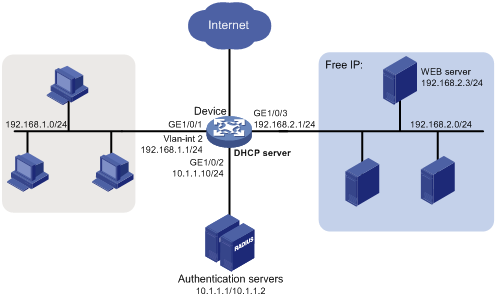

Configuring the EAD assistant feature
When you configure the EAD assistant feature, follow these restrictions and guidelines:
·     You must disable MAC authentication and port security globally before you enable the EAD assistant feature.
·     To make the EAD assistant feature take effect on an 802.1X-enabled port, you must set the port authorization mode to auto.
·     For the 802.1X guest VLAN or guest VSI feature to work correctly, do not enable EAD assistant together with the 802.1X guest VLAN or guest VSI feature.
·     When global MAC authentication or port security is enabled, the free IP does not take effect.
·     If you use the free IP and Auth-Fail VLAN features together, make sure the resources in the Auth-Fail VLAN are on the free IP segments.
·     To allow a user to obtain a dynamic IP address before it passes 802.1X authentication, make sure the DHCP server is on the free IP segment.
·     The server that provides the redirect URL must be on the free IP accessible to unauthenticated users.
·     To avoid using up ACL resources when a large number of EAD users exist, you can shorten the EAD rule timer.
To configure the EAD assistant feature:
Step
Remarks
N/A
2.     Enable the EAD assistant feature.
dot1x ead-assistant enable
By default, this feature is disabled.
3.     Configure a free IP.
dot1x ead-assistant free-ip ip-address { mask-length | mask-address }
By default, no free IPs exist.
4.     (Optional.) Configure the redirect URL.
dot1x ead-assistant url url-string
By default, no redirect URL exists.
Configure the redirect URL if users will use Web browsers to access the network.
To redirect the HTTPS requests of 802.1X users, specify the HTTPS redirect listening port on the device. For more information, see HTTP redirect in Layer 3IP Services Configuration Guide.
5.     (Optional.) Set the EAD rule timer.
dot1x timer ead-timeout ead-timeout-value
The default setting is 30 minutes.

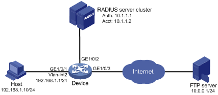

802.1X authentication configuration examples
Basic 802.1X authentication configuration example
Network requirements
As shown in Figure 12, the access device performs 802.1X authentication for users that connect to GigabitEthernet 1/0/1. Implement MAC-based access control on the port, so the logoff of one user does not affect other online 802.1X users.
Use RADIUS servers to perform authentication, authorization, and accounting for the 802.1X users. If RADIUS authentication fails, perform local authentication on the access device.
Configure the RADIUS server at 10.1.1.1/24 as the primary authentication and accounting server, and the RADIUS server at 10.1.1.2/24 as the secondary authentication and accounting server. Assign all users to the ISP domain bbb.
Set the shared key to name for packets between the access device and the authentication server. Set the shared key to money for packets between the access device and the accounting server.
Figure 12 Network diagram

6.     Configure 802.1X on the access device:
# Enable 802.1X on GigabitEthernet 1/0/1.
[Device-GigabitEthernet1/0/1] dot1x
# Enable MAC-based access control on the port. By default, the port uses MAC-based access control.
[Device-GigabitEthernet1/0/1] dot1x port-method macbased
# Specify ISP domain bbb as the mandatory domain.
[Device-GigabitEthernet1/0/1] dot1x mandatory-domain bbb
# Enable 802.1X globally.
[Device] dot1x
7.     Configure the 802.1X client. If an iNode client is used, do not select the Carry version info option in the client configuration. (Details not shown.)
# Verify the 802.1X configuration on GigabitEthernet 1/0/1.
[Device] display dot1x interface gigabitethernet 1/0/1
# Display the user connection information after an 802.1X user passes authentication.
[Device] display dot1x connection

802.1X with ACL assignment configuration example
As shown in Figure 14, the host that connects to GigabitEthernet 1/0/1 must pass 802.1X authentication to access the Internet.
Perform 802.1X authentication on GigabitEthernet 1/0/1. Use the RADIUS server at 10.1.1.1 as the authentication and authorization server, and the RADIUS server at 10.1.1.2 as the accounting server.
Configure ACL assignment on GigabitEthernet 1/0/1 to deny access of 802.1X users to the FTP server from 8:00 to 18:00 on weekdays.
Figure 14 Network diagram
For information about the RADIUS commands used on the access device in this example, see Security Command Reference.
1.     Configure the RADIUS servers to provide authentication, authorization, and accounting services. Add user accounts and specify the ACL (ACL 3000 in this example) for the users. (Details not shown.)
2.     Assign an IP address to each interface, as shown in Figure 14. (Details not shown.)
3.     Configure a RADIUS scheme on the access device:
# Create RADIUS scheme 2000 and enter RADIUS scheme view.
<Device> system-view
[Device] radius scheme 2000
# Specify the server at 10.1.1.1 as the primary authentication server, and set the authentication port to 1812.
[Device-radius-2000] primary authentication 10.1.1.1 1812
# Specify the server at 10.1.1.2 as the primary accounting server, and set the accounting port to 1813.
[Device-radius-2000] primary accounting 10.1.1.2 1813
# Set the shared key to abc in plain text for secure communication between the authentication server and the device.
[Device-radius-2000] key authentication simple abc
# Set the shared key to abc in plain text for secure communication between the accounting server and the device.
[Device-radius-2000] key accounting simple abc
# Exclude the ISP domain names from the usernames sent to the RADIUS server.
[Device-radius-2000] user-name-format without-domain
[Device-radius-2000] quit
4.     Configure an ISP domain on the access device:
# Create ISP domain bbb and enter ISP domain view.
[Device] domain bbb
# Apply RADIUS scheme 2000 to the ISP domain for authentication, authorization, and accounting.
[Device-isp-bbb] authentication lan-access radius-scheme 2000
[Device-isp-bbb] authorization lan-access radius-scheme 2000
[Device-isp-bbb] accounting lan-access radius-scheme 2000
[Device-isp-bbb] quit
5.     Configure a time range named ftp from 8:00 to 18:00 on weekdays on the access device.
[Device] time-range ftp 8:00 to 18:00 working-day
6.     Configure ACL 3000 to deny packets destined for the FTP server at 10.0.0.1 during the specified time range on the access device.
[Device] acl advanced 3000
[Device-acl-ipv4-adv-3000] rule 0 deny ip destination 10.0.0.1 0 time-range ftp
[Device-acl-ipv4-adv-3000] quit
7.     Configure 802.1X on the access device:
[Device] dot1x
8.     Configure the 802.1X client. Make sure the client is able to update its IP address after the access port is assigned to the 802.1X guest VLAN or an authorization VLAN. (Details not shown.)
# Use the user account to pass authentication. (Details not shown.)
# Verify that the user cannot ping the FTP server at any time from 8:00 to 18:00 on any weekday.
C:\>ping 10.0.0.1
Pinging 10.0.0.1 with 32 bytes of data:
Request timed out.
Request timed out.
Request timed out.
Request timed out.
Ping statistics for 10.0.0.1:
    Packets: Sent = 4, Received = 0, Lost = 4 (100% loss),
The output shows that ACL 3000 is active on the user, and the user cannot access the FTP server.
802.1X guest VSI and authorization VSI configuration example
As shown in Figure 15:
·     The device acts as both a VXLAN VTEP and a network access device. It uses the RADIUS server to perform authentication, authorization, and accounting for 802.1X users that connect to GigabitEthernet 1/0/2.
·     GigabitEthernet 1/0/2 uses MAC-based access control and is configured with the 802.1X guest VSI. VXLAN 10 is created on the guest VSI. Users in the guest VSI can access the update server in VXLAN 10 and download the 802.1X client software.
·     The RADIUS server assigns an authorization VSI to the host. The VSI is associated with VXLAN 5 on the device. After passing authentication, the host can access the Internet.
Figure 15 Network diagram
1.     Configure the RADIUS server to provide authentication, authorization, and accounting services. Configure user accounts and authorization VSI (VSI vpn5 in this example) for the users. (Details not shown.)
If an H3C ADCAM server is used for authentication and authorization, configure VSIs on the server. The server will assign these VSIs to the device. You do not need to configure VSIs on the device.
2.     Enable L2VPN on the access device.
[Device] l2vpn enable
3.     Create VSIs and the corresponding VXLANs on the access device.
[Device] vsi vpn10
[Device-vsi-vpn10] vxlan 10
[Device-vsi-vpn10-vxlan-10] quit
[Device-vsi-vpn10] quit
[Device] vsi vpn5
[Device-vsi-vpn5] vxlan 5
[Device-vsi-vpn5-vxlan-5] quit
[Device-vsi-vpn5] quit
4.     Configure a RADIUS scheme on the access device:
# Specify the server at 10.11.1.1 as the primary authentication server, and set the authentication port to 1812.
[Device-radius-2000] primary authentication 10.11.1.1 1812
# Specify the server at 10.11.1.1 as the primary accounting server, and set the accounting port to 1813.
[Device-radius-2000] primary accounting 10.11.1.1 1813
# Exclude the ISP domain names from the usernames sent to the authentication and accounting servers.
5.     Configure an ISP domain on the access device:
[Device] domain bbb
# Apply RADIUS scheme 2000 to the ISP domain for authentication, authorization, and accounting of LAN users.
# Enable 802.1X on GigabitEthernet 1/0/2.
[Device] interface gigabitethernet 1/0/2
[Device-GigabitEthernet1/0/2] dot1x
# Set the port authorization mode to auto. By default, the port uses the auto mode.
[Device-GigabitEthernet1/0/2] dot1x port-control auto
# Enable MAC-based traffic match mode for dynamic Ethernet service instances on GigabitEthernet 1/0/2.
[Device-GigabitEthernet1/0/2] mac-based ac
# Enable 802.1X unicast trigger on GigabitEthernet 1/0/2.
[Device-GigabitEthernet1/0/2] dot1x unicast-trigger
# Specify VSI vpn10 as the 802.1X guest VSI on GigabitEthernet 1/0/2.
[Device-GigabitEthernet1/0/2] dot1x guest-vsi vpn10
[Device-GigabitEthernet1/0/2] quit
[Device] dot1x
7.     Configure the 802.1X client. Make sure the 802.1X client can update its IP address after the access port is assigned to the guest VSI or an authorization VSI. (Details not shown.)
# Verify that GigabitEthernet 1/0/2 is assigned to VSI vpn10 if no responses are received from the client after 802.1X authentication is triggered.
[Device] display l2vpn forwarding ac verbose
# Verify that GigabitEthernet 1/0/2 is assigned to VSI vpn5 after a user passes authentication on the port.

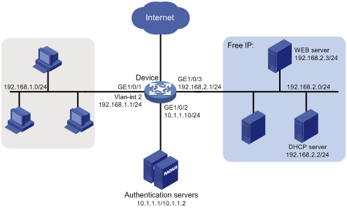

802.1X with EAD assistant configuration example (with DHCP relay agent)
As shown in Figure 16:
·     The intranet 192.168.1.0/24 is attached to GigabitEthernet 1/0/1 of the access device.
·     The hosts use DHCP to obtain IP addresses.
·     A DHCP server and a Web server are deployed on the 192.168.2.0/24 subnet for users to obtain IP addresses and download client software.
Deploy an EAD solution for the intranet to meet the following requirements:
·     Allow unauthenticated users and users that have failed 802.1X authentication to access 192.168.2.0/24. The users can obtain IP addresses and download software.
·     If these users use a Web browser to access a network other than 192.168.2.0/24, redirect them to the Web server for 802.1X client downloading.
·     Allow authenticated 802.1X users to access the network.
Figure 16 Network diagram
1.     Make sure the DHCP server, the Web server, and the authentication servers have been configured correctly. (Details not shown.)
2.     Configure an IP address for each interface. (Details not shown.)
3.     Configure DHCP relay:
# Enable DHCP.
[Device] dhcp enable
# Enable the DHCP relay agent on VLAN-interface 2.
[Device] interface vlan-interface 2
[Device-Vlan-interface2] dhcp select relay
# Specify the DHCP server 192.168.2.2 on the relay agent interface VLAN-interface 2.
[Device-Vlan-interface2] dhcp relay server-address 192.168.2.2
[Device-Vlan-interface2] quit
4.     Configure a RADIUS scheme:
5.     Configure an ISP domain:
[Device] domain bbb
6.     Configure 802.1X:
# Configure the free IP.
[Device] dot1x ead-assistant free-ip 192.168.2.0 24
# Configure the redirect URL for client software download.
[Device] dot1x ead-assistant url http://192.168.2.3
# Enable the EAD assistant feature.
[Device] dot1x ead-assistant enable
[Device] dot1x
# Verify the 802.1X configuration.
# Verify that you can ping an IP address on the free IP subnet from a host.
C:\>ping 192.168.2.3
Pinging 192.168.2.3 with 32 bytes of data:
Reply from 192.168.2.3: bytes=32 time<1ms TTL=128
Ping statistics for 192.168.2.3:
    Minimum = 0ms, Maximum = 0ms, Average = 0ms
The output shows that you can access the free IP subnet before passing 802.1X authentication.
# Verify that you are redirected to the Web server when you enter in your Web browser an IP address not on the free IP. (Details not shown.)
802.1X with EAD assistant configuration example (with DHCP server)
As shown in Figure 17:
·     A Web server is deployed on the 192.168.2.0/24 subnet for users to download client software.
·     Allow unauthenticated users and users that have failed 802.1X authentication to access 192.168.2.0/24. The users can download software.
Figure 17 Network diagram
1.     Make sure the Web server and the authentication servers have been configured correctly. (Details not shown.)
3.     Configure the DHCP server:
# Enable DHCP.
# Enable the DHCP server on VLAN-interface 2.
[Device-Vlan-interface2] dhcp select server
# Create DHCP address pool 0.
[Device] dhcp server ip-pool 0
# Specify subnet 192.168.1.0/24 in DHCP address pool 0.
[Device-dhcp-pool-0] network 192.168.1.0 mask 255.255.255.0
# Specify the gateway address 192.168.1.1 in DHCP address pool 0.
[Device-dhcp-pool-0] gateway-list 192.168.1.1
[Device-dhcp-pool-0] quit
[Device] domain bbb
[Device] dot1x
