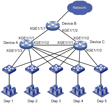

Example: Configuring link layer attack protection
As shown in Figure 1, Device A, Device B, and Device C run MSTP. Device B acts as the root bridge, and Ten-GigabitEthernet 1/1/1 on Device C is blocked.
Configure the following features to prevent link layer attacks:
·          Configure root guard on Ten-GigabitEthernet 1/1/1 and Ten-GigabitEthernet 1/1/2 of Device B for Device B to act as the root bridge.
·          Configure loop guard on Ten-GigabitEthernet 1/1/2 of Device C to prevent temporary loops. The loop guard feature keeps the port in Discarding state in all MSTIs when it receives no BPDU.
·          Configure BPDU guard on ports at the access side of Device A and Device C. The BPDU guard feature prevents the ports from performing spanning tree calculations when it receives forged BPDUs with a higher priority.
·          Enable TC-BPDU guard on Device A, Device B, and Device C. The TC-BPDU guard feature prevents a large number of TC-BPDUs from affecting the network in a short time.
·          Set the maximum number of MAC addresses that can be learned by ports at the access side of Device A and Device C. This configuration protects the devices from a large number of attack packets that have different source MAC addresses. The attack packets might cause a large MAC table and low forwarding performance.
·          Configure broadcast and multicast suppression on the designated ports of Device B and all ports on Device A and Device C. When incoming broadcast or multicast traffic exceeds the threshold, an interface discards broadcast or multicast packets until the traffic drops below the threshold.
Figure 1 Network diagram
Analysis
For the ports at the access side of Device A and Device C to rapidly transit to the forwarding state, use the stp edged-port command to configure these ports as edge ports.
This example uses Ten-GigabitEthernet 1/1/3 to illustrate the configuration on the ports at the access side on Device A and Device C.
When you configure link layer attack protection, follow these restrictions and guidelines:
·          On a port, the loop guard feature is mutually exclusive with the root guard feature or the edge port setting.
·          Do not configure the loop guard feature on ports at the access side. Otherwise, the ports stay in Discarding state in all MSTIs because they cannot receive BPDUs.
Procedures
Configuring Device B
# Specify IP addresses for interfaces. (Details not shown.)
# Configure root guard on Ten-GigabitEthernet 1/1/1 and Ten-GigabitEthernet 1/1/2.
<DeviceB> system-view
[DeviceB] interface range Ten-GigabitEthernet 1/1/1 to Ten-GigabitEthernet 1/1/2
[DeviceB-if-range] stp root-protection
[DeviceB-if-range] quit
# Configure TC-BPDU guard.
[DeviceB] stp tc-protection
[DeviceB] stp tc-protection threshold 10
# Configure broadcast and multicast suppression on Ten-GigabitEthernet 1/1/1 and Ten-GigabitEthernet 1/1/2.
[DeviceB-if-range] broadcast-suppression pps 6400
[DeviceB-if-range] multicast-suppression pps 6400
Configuring Device A
# Configure STP BPDU guard.
<DeviceA> system-view
[DeviceA] stp bpdu-protection
# Configure Ten-GigabitEthernet 1/1/3 as an edge port.
[DeviceA] interface Ten-GigabitEthernet 1/1/3
[DeviceA-Ten-GigabitEthernet1/1/3] stp edged-port
[DeviceA-Ten-GigabitEthernet1/1/3] quit
[DeviceA] stp tc-protection
[DeviceA] stp tc-protection threshold 10
# Set the maximum number of MAC addresses that Ten-GigabitEthernet 1/1/3 can learn.
[DeviceA-Ten-GigabitEthernet1/1/3] mac-address max-mac-count 1024
# Configure broadcast and multicast suppression on all ports.
[DeviceA] interface range Ten-GigabitEthernet 1/1/1 to Ten-GigabitEthernet 1/1/3
[DeviceA-if-range] broadcast-suppression pps 6400
[DeviceA-if-range] multicast-suppression pps 6400
[DeviceA-if-range] quit
Configuring Device C
<DeviceC> system-view
[DeviceC] stp bpdu-protection
[DeviceC] interface Ten-GigabitEthernet 1/1/3
[DeviceC-Ten-GigabitEthernet1/1/3] stp edged-port
[DeviceC-Ten-GigabitEthernet1/1/3] quit
# Configure root guard on Ten-GigabitEthernet 1/1/1.
[DeviceC] interface Ten-GigabitEthernet 1/1/1
[DeviceC-Ten-GigabitEthernet1/1/1] stp root-protection
[DeviceC-Ten-GigabitEthernet1/1/1] quit
# Configure loop guard on Ten-GigabitEthernet 1/1/2.
[DeviceC] interface Ten-GigabitEthernet 1/1/2
[DeviceC-Ten-GigabitEthernet1/1/2] stp loop-protection
[DeviceC-Ten-GigabitEthernet1/1/2] quit
[DeviceC] stp tc-protection
[DeviceC] stp tc-protection threshold 10
[DeviceC-Ten-GigabitEthernet1/1/3] mac-address max-mac-count 1024
[DeviceC] interface range Ten-GigabitEthernet 1/1/1 to Ten-GigabitEthernet 1/1/3
[DeviceC-if-range] broadcast-suppression pps 6400
[DeviceC-if-range] multicast-suppression pps 6400
[DeviceC-if-range] quit
# Verify that the edge ports go down after they receives STP BPDUs. (Details not shown.)
# Bring the edge ports up by using the undo shutdown command. (Details not shown.)
# Verify that the root ports do not change and that the STP topology remains stable after STP BPDUs with higher priority are sent to the designated ports. (Details not shown.)
# Verify that the devices do not refresh the FIB table frequently and that no serious packet loss occurs after a large number of various TC BPDUs are sent to the devices. (Details not shown.)
# Verify that the uplink ports are not flooded after a large number of broadcasts are sent to the edge ports on device A and Device C. (Details not shown.)

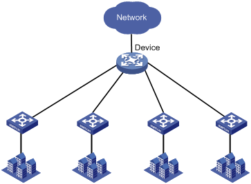

Example: Configuring ARP attack protection
As shown in Figure 2, the device is the gateway for the internal network. Configure ARP attack protection on the device to prevent ARP attacks.
Figure 2 Network diagram
Procedures
# Enable ARP source suppression.
<Device> system-view
[Device] arp source-suppression enable
# Configure the device to accept a maximum of 8 unresolvable packets per source IP address in 5 seconds.
[Device] arp source-suppression limit 8
# Enable ARP black hole routing to prevent unresolvable IP packet attacks.
[Device] arp resolving-route enable
# Enable ARP active acknowledgment to prevent user spoofing.
[Device] arp active-ack enable
# Configure source MAC-based ARP attack detection to prevent ARP packet attacks from the same source MAC.
[Device] arp source-mac filter
[Device] arp source-mac threshold 25
# Enable ARP packet source MAC address consistency check to prevent attacks from ARP packets with different source MAC addresses in the Ethernet header and in the message body.
[Device] arp valid-check enable

As shown in Figure 4, the device is the gateway for the internal network. Configure SYN Cookie protection on the device to protect against SYN flood attacks. With this feature enabled, the device responds to a SYN packet with a SYN ACK packet without establishing a TCP semi-connection. The device establishes a TCP connection only when it receives an ACK packet from the sender.
Figure 4 Network diagram
Procedures
# Enable SYN Cookie.
[Device] tcp syn-cookie enable
# Verify that the device does not have any TCP semi-connections. The state "SYN_RECEIVED" represents semi-connections.
[Device] display tcp
 *: TCP Connection with authentication
 Local Addr:port       Foreign Addr:port     State       Slot  Cpu PCB
 0.0.0.0:21            0.0.0.0:0             LISTEN      1     0   0xfffffffffff
fff9d
 0.0.0.0:23            0.0.0.0:0             LISTEN      1     0   0xfffffffffff
fff9f
 192.168.2.88:23       192.168.2.79:2197     ESTABLISHED 1     0   0xfffffffffff
fffa3
 192.168.2.88:23       192.168.2.89:2710     ESTABLISHED 1     0   0xfffffffffff
fffa2
 192.168.2.88:23       192.168.2.110:50199   ESTABLISHED 1     0   0xfffffffffff
fff
Configuration files
