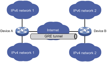

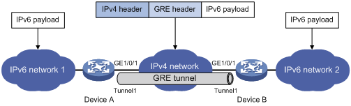

GRE tunnel operating principle
As shown in Figure 2, an IPv6 protocol packet traverses an IPv4 network through a GRE tunnel as follows:
1.        After receiving an IPv6 packet from the interface connected to IPv6 network 1, Device A processes the packet as follows:
a.    Looks up the routing table to identify the outgoing interface for the IPv6 packet.
b.    Submits the IPv6 packet to the outgoing interface—the GRE tunnel interface Tunnel 1.
2.        Upon receiving the packet, the tunnel interface encapsulates the packet with GRE and then with IPv4. In the IPv4 header:
¡  The source address is the tunnel's source address (the IP address of interface GigabitEthernet 1/0/1 of Device A).
¡  The destination address is the tunnel's destination address (the IP address of interface GigabitEthernet 1/0/1 of Device B).
3.        Device A looks up the routing table according to the destination address in the IPv4 header, and forwards the IPv4 packet out of the physical interface (GigabitEthernet 1/0/1) of the GRE tunnel.
4.        When the IPv4 arrives at the GRE tunnel destination Device B, Device B checks the destination address. Because the destination is Device B itself and the protocol number in the IP header is 47 (the protocol number for GRE), Device B submits the packet to GRE for de-encapsulation.
5.        GRE first removes the IPv4 header, and then checks the packet sequence number. After GRE finishes the checking, it removes the GRE header, and submits the payload to the IPv6 protocol for forwarding.
GRE encapsulation and de-encapsulation can decrease the forwarding efficiency of tunnel-end devices.
Figure 2 IPv6 networks interconnected through a GRE tunnel

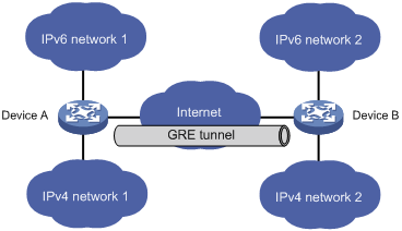

Connecting networks running different protocols over a single backbone
As shown in Figure 3, IPv6 network 1 and IPv6 network 2 are IPv6 networks, and IPv4 network 1 and IPv4 network 2 are IPv4 networks. Through the GRE tunnel between Device A and Device B, IPv6 network 1 can communicate with IPv6 network 2 and IPv4 network 1 can communicate with IPv4 network 2, without affecting each other.
Figure 3 Network diagram

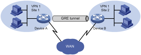

Constructing VPN
As shown in Figure 5, Site 1 and Site 2 both belong to VPN 1 and are located in different cities. Using a GRE tunnel can connect the two VPN sites across the WAN.
Figure 5 Network diagram

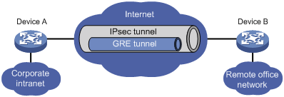

Operating with IPsec
As shown in Figure 6, GRE can be used together with IPsec to form a GRE over IPsec tunnel. Packets (for example, routing protocol packets, voice data, and video data) are first encapsulated with GRE and then with IPsec. GRE over IPsec delivers the following benefits:
·          Improves transmission security.
·          Allows IPsec to protect not only unicast packets. GRE supports encapsulating multicast, broadcast, and non-IP packets. After GRE encapsulation, these packets become common unicast packets, which can be protected by IPsec.
·          Simplifies IPsec configuration. Packets are first encapsulated by GRE. You can define the packets to be protected by IPsec according to the GRE tunnel's source and destination addresses, without considering the source and destination addresses of the original packets.
GRE and IPsec can also form IPsec over GRE tunnels. As a best practice, use GRE over IPsec tunnels instead of IPsec over GRE tunnels.
For more information about IPsec, see Security Configuration Guide.
Figure 6 Network diagram

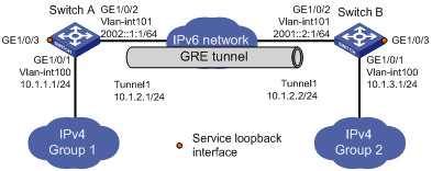

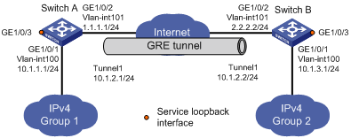

GRE configuration examples
Configuring an IPv4 over IPv4 GRE tunnel
Network requirements
As shown in Figure 7, Group 1 and Group 2 are two private IPv4 networks. The two networks both use private network addresses and belong to the same VPN. Establish a GRE tunnel between Switch A and Switch B to interconnect the two private IPv4 networks Group 1 and Group 2.
Figure 7 Network diagram
Configuration procedure
Before performing the following configuration, configure an IP address for each interface, and make sure Switch A and Switch B can reach each other.
1.        Configure Switch A:
# Create service loopback group 1, and configure the service type as tunnel.
<SwitchA> system-view
[SwitchA] service-loopback group 1 type tunnel
# Add port GigabitEthernet 1/0/3 to service loopback group 1.
[SwitchA] interface gigabitethernet 1/0/3
[SwitchA-GigabitEthernet1/0/3] port service-loopback group 1
[SwitchA-GigabitEthernet1/0/3] quit
# Create a tunnel interface Tunnel 1, and specify the tunnel mode as GRE/IPv4.
[SwitchA] interface tunnel 1 mode gre
# Configure an IP address for the tunnel interface.
[SwitchA-Tunnel1] ip address 10.1.2.1 255.255.255.0
# Configure the source address of tunnel interface as the IP address of VLAN-interface 101 on Switch A.
[SwitchA-Tunnel1] source vlan-interface 101
# Configure the destination address of the tunnel interface as the IP address of VLAN-interface 101 on Switch B.
[SwitchA-Tunnel1] destination 2.2.2.2
[SwitchA-Tunnel1] quit
# Configure a static route from Switch A through the tunnel interface to Group 2.
[SwitchA] ip route-static 10.1.3.0 255.255.255.0 tunnel 1
2.        Configure Switch B:
<SwitchB> system-view
[SwitchB] service-loopback group 1 type tunnel
[SwitchB] interface gigabitethernet 1/0/3
[SwitchB-GigabitEthernet1/0/3] port service-loopback group 1
[SwitchB-GigabitEthernet1/0/3] quit
[SwitchB] interface tunnel 1 mode gre
[SwitchB-Tunnel1] ip address 10.1.2.2 255.255.255.0
# Configure the source address of tunnel interface as the IP address of VLAN-interface 101 on Switch B.
[SwitchB-Tunnel1] source vlan-interface 101
# Configure the destination address of the tunnel interface as the IP address of VLAN-interface 101 on Switch A.
[SwitchB-Tunnel1] destination 1.1.1.1
[SwitchB-Tunnel1] quit
# Configure a static route from Switch B through the tunnel interface to Group 1.
[SwitchB] ip route-static 10.1.1.0 255.255.255.0 Tunnel 1
# Display tunnel interface information on Switch A.
[SwitchA] display interface tunnel 1
Tunnel1
Current state: UP
Line protocol state: UP
Description: Tunnel1 Interface
Bandwidth: 64kbps
Maximum transmission unit: 1476
Internet address: 10.1.2.1/24 (primary)
Tunnel source 1.1.1.1, destination 2.2.2.2
Tunnel keepalive disabled
Tunnel TTL 255
Tunnel protocol/transport GRE/IP
    GRE key disabled
    Checksumming of GRE packets disabled
Output queue - Urgent queuing: Size/Length/Discards 0/100/0
Output queue - Protocol queuing: Size/Length/Discards 0/500/0
Output queue - FIFO queuing: Size/Length/Discards 0/75/0
Last clearing of counters: Never
Last 300 seconds input rate: 0 bytes/sec, 0 bits/sec, 0 packets/sec
Last 300 seconds output rate: 0 bytes/sec, 0 bits/sec, 0 packets/sec
Input: 0 packets, 0 bytes, 0 drops
Output: 0 packets, 0 bytes, 0 drops
# Display tunnel interface information on Switch B.
[SwitchB] display interface tunnel 1
Tunnel1
Current state: UP
Bandwidth: 64kbps
Internet address: 10.1.2.2/24 (primary)
Tunnel source 2.2.2.2, destination 1.1.1.1
Tunnel TTL 255
    GRE key disabled
# From Switch B, ping the IP address of VLAN-interface 100 on Switch A.
[SwitchB] ping -a 10.1.3.1 10.1.1.1
Ping 10.1.1.1 (10.1.1.1) from 10.1.3.1: 56 data bytes, press CTRL_C to break
56 bytes from 10.1.1.1: icmp_seq=0 ttl=255 time=11.000 ms
56 bytes from 10.1.1.1: icmp_seq=1 ttl=255 time=1.000 ms
56 bytes from 10.1.1.1: icmp_seq=2 ttl=255 time=0.000 ms
56 bytes from 10.1.1.1: icmp_seq=3 ttl=255 time=0.000 ms
56 bytes from 10.1.1.1: icmp_seq=4 ttl=255 time=0.000 ms
--- Ping statistics for 10.1.1.1 ---
round-trip min/avg/max/std-dev = 0.000/2.400/11.000/4.317 ms
The output shows that Switch B can successfully ping Switch A.
Configuring an IPv4 over IPv6 GRE tunnel
As shown in Figure 8, two IPv4 subnets Group 1 and Group 2 are connected to an IPv6 network. Create a GRE/IPv6 tunnel between Switch A and Switch B, so the two IPv4 subnets can communicate with each other through the GRE tunnel over the IPv6 network.
Figure 8 Network diagram
# Create a tunnel interface Tunnel 1, and specify the tunnel mode as GRE/ IPv6.
[SwitchA] interface tunnel 1 mode gre ipv6
# Configure the source address of the tunnel interface as the IPv6 address of VLAN-interface 101 on Switch A.
[SwitchA-Tunnel1] source 2002::1:1
# Configure the destination address of the tunnel interface as the IPv6 address of VLAN-interface 101 on Switch B.
[SwitchA-Tunnel1] destination 2001::2:1
# Create a tunnel interface Tunnel 1, and specify the tunnel mode as GRE/IPv6.
[SwitchB] interface tunnel 1 mode gre ipv6
# Configure the source address of tunnel interface as the IPv6 address of VLAN-interface 101 on Switch B.
[SwitchB-Tunnel1] source 2001::2:1
# Configure the destination address of the tunnel interface as the IPv6 address of VLAN-interface 101 on Switch A.
[SwitchB-Tunnel1] destination 2002::1:1
[SwitchB] ip route-static 10.1.1.0 255.255.255.0 tunnel 1
Tunnel1
Current state: UP
Bandwidth: 64kbps
Maximum transmission unit: 1456
Tunnel source 2002::1:1, destination 2001::2:1
Tunnel TTL 255
Tunnel protocol/transport GRE/IPv6
    GRE key disabled
Tunnel1
Current state: UP
Bandwidth: 64kbps
Tunnel source 2001::2:1, destination 2002::1:1
Tunnel TTL 255
    GRE key disabled
56 bytes from 10.1.1.1: icmp_seq=0 ttl=255 time=2.000 ms
56 bytes from 10.1.1.1: icmp_seq=2 ttl=255 time=1.000 ms
56 bytes from 10.1.1.1: icmp_seq=4 ttl=255 time=1.000 ms
round-trip min/avg/max/std-dev = 0.000/1.000/2.000/0.632 ms
