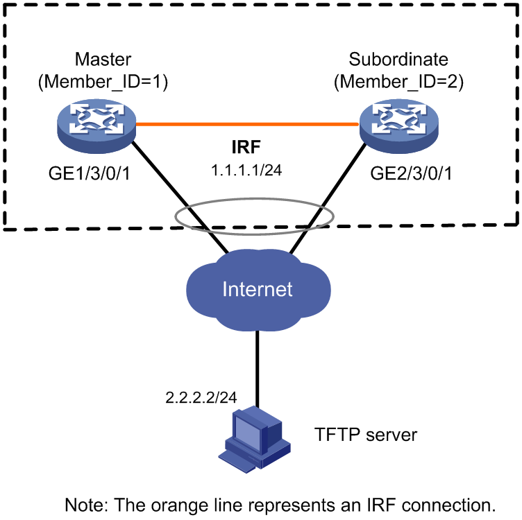

Examples of using issu commands for ISSU on a dual-member IRF fabric
Feature upgrade to a compatible version
Upgrade requirements
As shown in Figure 1, the IRF fabric has two members. Each member has one active MPU (slot 6) and one standby MPU (slot 7).
Upgrade the feature1 feature from R0201 to R0202. The two versions are compatible.
Figure 1 Network diagram
Upgrade procedure

Feature upgrade to an incompatible version
As shown in Figure 2, the IRF fabric has two members. Each member has one MPU in slot 6 (active MPU) and one MPU in slot 7 (standby MPU).
Upgrade the feature1 feature from R0201 to R0202. The two versions are incompatible.
Figure 2 Network diagram
Upgrade procedure
# Download the image file that contains the R0202 feature from the TFTP server.
<Sysname> tftp 2.2.2.2 get feature1-r0202.bin
  % Total    % Received % Xferd  Average Speed   Time    Time     Time  Current
                                 Dload  Upload   Total   Spent    Left  Speed
100   256  100  256     0     0    764      0 --:--:-- --:--:-- --:--:--   810
# Display active software images.
<Sysname> display install active
Active packages on chassis 1 slot 6:
  flash:/boot-r0201.bin
  flash:/system-r0201.bin
  flash:/feature1-r0201.bin
Active packages on chassis 1 slot 7:
Active packages on chassis 2 slot 6:
Active packages on chassis 2 slot 7:
# Identify the ISSU methods and possible impact of the upgrade.
<Sysname> display version comp-matrix file feature flash:/feature1-r0202.bin
Verifying the file flash:/feature1-r0202.bin on Chassis 1 slot 6...Done.
Incompatible upgrade.
The output shows that the two versions are incompatible. The cards will be rebooted for the upgrade.
# Enable the IRF bridge MAC address to be permanent.
[Sysname] irf mac-address persistent always
# Set the physical state change suppression interval to 0 on the interfaces.
[Sysname] interface gigabitethernet1/3/0/1
[Sysname-GigabitEthernet1/3/0/1] link-delay 0 mode updown
[Sysname-GigabitEthernet1/3/0/1] quit
[Sysname] interface gigabitethernet2/3/0/1
[Sysname-GigabitEthernet2/3/0/1] link-delay 0 mode updown
[Sysname-GigabitEthernet2/3/0/1] quit
[Sysname] quit
# Upgrade the feature on the subordinate member. After the upgrade, the subordinate member will leave the original IRF fabric and form a new IRF fabric by itself.
<Sysname> issu load file feature flash:/feature1-r0202.bin chassis 2
This operation will delete the rollback point information for the previous upgrade and maybe get unsaved configuration lost. Continue? [Y/N]:y
Copying file flash:/feature1-r0202.bin to chassis2#slot6#flash:/feature1-r0202.bin......Done.
Verifying the file flash:/feature1-r0202.bin on Chassis 2 slot 6...Done.
Copying file flash:/feature1-r0202.bin to chassis2#slot7#flash:/feature1-r0202.bin......Done.
Verifying the file flash:/feature1-r0202.bin on Chassis 2 slot 7...Done.
Upgrade summary according to following table:
  Running Version             New Version
  Alpha 0201                  Alpha 0202
  Chassis   Slot              Upgrade Way
  2         6                 Reboot
  2         7                 Reboot
Upgrading software images to incompatible versions. Continue? [Y/N]: y
This operation might take several minutes, please wait...Done.
# Perform a master/subordinate switchover to upgrade the original master. The original master will reboot and join the new IRF fabric.
<Sysname> issu run switchover
Copying file flash:/feature1-r0202.bin to chassis1#slot7#flash:/feature1-r0202.bin......Done.
Verifying the file flash:/feature1-r0202.bin on Chassis 1 slot 7...Done.
  1         6                 Reboot
  1         7                 Reboot
# Verify that both members are running the new feature image.

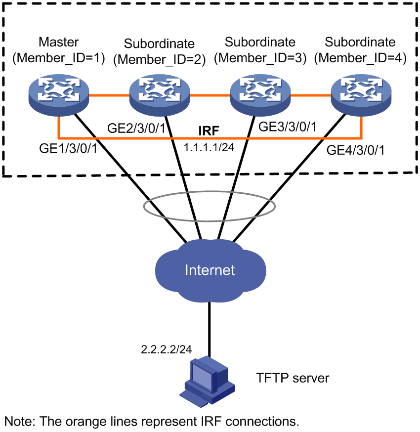

Examples of using issu commands for ISSU on a four-member IRF fabric
As shown in Figure 3, the IRF fabric has four members. Each member has one active MPU (slot 6), one standby MPU (slot 7), and one LPU (slot 3).
Upgrade a feature from soft-version1 to soft-version2 on the IRF fabric. The two versions are compatible.
Figure 3 Network diagram
Upgrade procedure
# Download the upgrade image file from the TFTP server.
<Sysname> tftp 2.2.2.2 get soft-version2.bin
Press CTRL+C to abort.
100 13312    0 13312    0     0   295k      0 --:--:-- --:--:-- --:--:--  309k
Active packages on chassis 1 slot 3:
  flash:/cmw710-boot-test.bin
  flash:/cmw710-system-test.bin
  flash:/soft-version1.bin
Active packages on chassis 2 slot 3:
Active packages on chassis 3 slot 3:
Active packages on chassis 3 slot 6:
Active packages on chassis 3 slot 7:
Active packages on chassis 4 slot 3:
Active packages on chassis 4 slot 6:
Active packages on chassis 4 slot 7:
<Sysname> display version comp-matrix file feature flash:/soft-version2.bin
Verifying the file flash:/soft-version2.bin on chassis 1 slot 6...Done.
  1         3                 Service Upgrade
  1         6                 Service Upgrade
  1         7                 Service Upgrade
  2         3                 Service Upgrade
  2         6                 Service Upgrade
  2         7                 Service Upgrade
  3         3                 Service Upgrade
  3         6                 Service Upgrade
  3         7                 Service Upgrade
  4         3                 Service Upgrade
  4         6                 Service Upgrade
  4         7                 Service Upgrade
The output shows that service upgrade is recommended. The feature module will be rebooted during the upgrade.
# Disable automatic rollback.
<Sysname> system-view
[Sysname] issu rollback-timer 0
[Sysname] interface gigabitethernet3/3/0/1
[Sysname-GigabitEthernet3/3/0/1] link-delay 0 mode updown
[Sysname-GigabitEthernet3/3/0/1] quit
[Sysname] interface gigabitethernet4/3/0/1
[Sysname-GigabitEthernet4/3/0/1] link-delay 0 mode updown
[Sysname-GigabitEthernet4/3/0/1] quit
[Sysname] quit
# Upgrade the feature on subordinate member 2.
<Sysname> issu load file feature flash:/soft-version2.bin chassis 2
Copying file flash:/soft-version2.bin to chassis2#slot6#flash:/soft-version2.bin
...Done.
Verifying the file flash:/soft-version2.bin on chassis 2 slot 6...Done
Copying file flash:/soft-version2.bin to chassis2#slot7#flash:/soft-version2.bin
...Done.
Verifying the file flash:/soft-version2.bin on chassis 2 slot 7...Done.
  None                        Release 7168
  2         3                 Service Upgrade
  2         6                 Service Upgrade
  2         7                 Service Upgrade
Upgrading software images to compatible versions. Continue? [Y/N]:y
This operation might take several minutes, please wait.....Done.
# Perform a main/backup feature process switchover.
  None                        Release 7168
  Chassis   Slot              Switchover Way
  1         6                 Active standby process switchover
# Upgrade the feature on the original master and the other subordinate members.
<Sysname> issu commit chassis 1
Copying file flash:/soft-version2.bin to chassis1#slot7#flash:/soft-version2.bin
...Done.
Verifying the file flash:/soft-version2.bin on chassis 1 slot 7...Done.
  None                        Release 7168
  1         3                 Service Upgrade
  1         6                 Service Upgrade
  1         7                 Service Upgrade
This operation might take several minutes, please wait........Done.
<Sysname> issu commit chassis 3
Copying file flash:/soft-version2.bin to chassis3#slot6#flash:/soft-version2.bin
...Done.
Verifying the file flash:/soft-version2.bin on chassis 3 slot 6...Done
Copying file flash:/soft-version2.bin to chassis3#slot7#flash:/soft-version2.bin
...Done.
Verifying the file flash:/soft-version2.bin on chassis 3 slot 7...Done.

Feature upgrade to an incompatible version (upgrading one subordinate member first)
As shown in Figure 4, the IRF fabric has four members. Each member has one active MPU (slot 6), one standby MPU (slot 7), and one LPU (slot 3).
Upgrade a feature from soft-version1 to soft-version2 on the IRF fabric. The two versions are incompatible.
Figure 4 Network diagram
Upgrade procedure

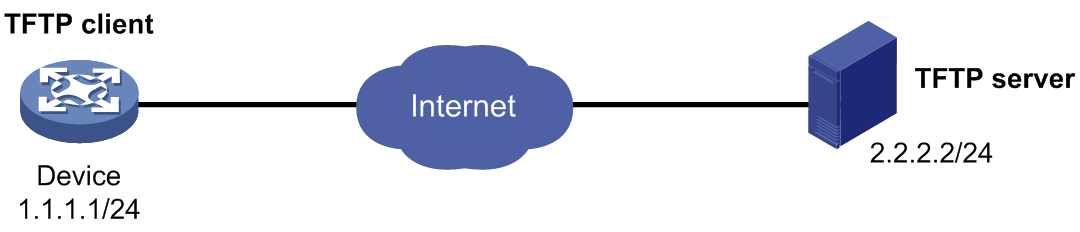

Examples of using install commands for ISSU on a standalone device
Feature upgrade example
As shown in Figure 5, the device has two MPUs. The active MPU is in slot 6. The standby MPU is in slot 7.
Figure 5 Network diagram

Examples of using install commands for ISSU on an IRF fabric
As shown in Figure 6, the IRF fabric has two members. Each member has one MPU in slot 6 (active MPU) and one MPU in slot 7 (standby MPU).
Figure 6 Network diagram
Upgrade procedure
# Download the .ipe file that contains the R0202 feature image from the TFTP server.
<Sysname> tftp 2.2.2.2 get feature1-r0202.ipe
# Decompress the .ipe file.
<Sysname> install add flash:/feature1-r0202.ipe flash:
Verifying the file flash:/feature1-r0202.ipe on chassis 1 slot 6...Done.
Decompressing file feature1-r0202.bin to flash:/feature1-r0202.bin.......................Done.
# Identify the recommended ISSU methods for the upgrade and view the possible impact of the upgrade.
<Sysname> install activate feature flash:/feature1-r0202.bin chassis 2 slot 7 test
Verifying the file flash:/feature1-r0202.bin on chassis 2 slot 7...Done.
  2         6                 Service Upgrade
  2         7                 Service Upgrade
Influenced service according to following table on chassis 2 slot 6:
         feature1      CFA
Influenced service according to following table on chassis 2 slot 7:
         feature1      CFA
<Sysname> install activate feature flash:/feature1-r0202.bin chassis 2 slot 6 test
Verifying the file flash:/feature1-r0202.bin on chassis 2 slot 6...Done.
  2         6                 Service Upgrade
         feature1      CFA
<Sysname> install activate feature flash:/feature1-r0202.bin chassis 1 slot 7 test
Verifying the file flash:/feature1-r0202.bin on chassis 1 slot 7...Done.
  1         6                 Service Upgrade
  1         7                 Service Upgrade
Influenced service according to following table on chassis 1 slot 6:
         feature1      CFA
Influenced service according to following table on chassis 1 slot 7:
         feature1      CFA
<Sysname> install activate feature flash:/feature1-r0202.bin chassis 1 slot 6 test
Verifying the file flash:/feature1-r0202.bin on chassis 1 slot 6...Done.
  1         6                 Service Upgrade
         feature1      CFA
The output shows that all the MPUs need a service upgrade. The feature and its related modules might reboot during the upgrade.
# Activate the new feature image to upgrade the feature.
flash:/feature1-r0202.bin already exists on chassis 2 slot 7.
Overwrite it?[Y/N]:y
  2         6                 Service Upgrade
  2         7                 Service Upgrade
Upgrading software images to compatible versions. Continue? [Y/N]: y
This operation might take several minutes, please wait......................Done.
flash:/feature1-r0202.bin already exists on chassis 2 slot 6.
  2         6                 Service Upgrade
flash:/feature1-r0202.bin already exists on chassis 1 slot 7.
  1         6                 Service Upgrade
  1         7                 Service Upgrade
  1         6                 Service Upgrade
# Verify that the new feature image has been activated.
# Commit the software changes.
<Sysname> install commit
This operation will take several minutes, please wait...........................Done.
