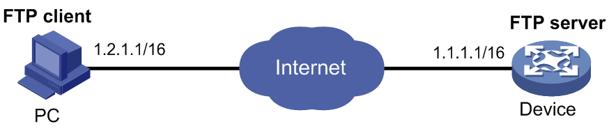

File Transfer Protocol (FTP) is an application layer protocol for transferring files from one host to another over an IP network. It uses TCP port 20 to transfer data and TCP port 21 to transfer control commands. For more information about FTP, see RFC 959.
FTP is based on the client/server model. The device can act as the FTP server or FTP client. Make sure the FTP server and the FTP client can reach each other before establishing the FTP connection.
Figure 1 FTP application scenario
FTP supports the following transfer modes:

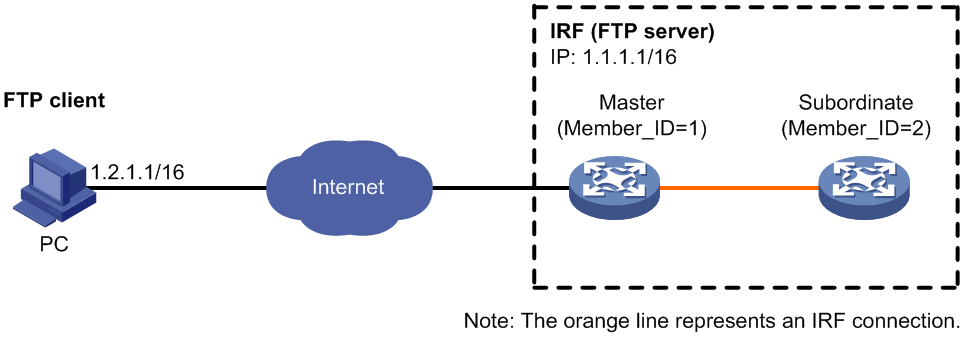

FTP server configuration example in IRF mode
Network requirements
·          Configure the IRF fabric as an FTP server.
·          Create a local user account named abc on the FTP server. Set the password to 123456.
·          Use the user account to log in to the FTP server from the FTP client.
·          Upload the temp.bin file from the FTP client to the FTP server.
·          Download configuration file config.cfg from the FTP server to the FTP client for backup.
Figure 3 Network diagram
Configuration procedure
1.        Configure IP addresses as shown in Figure 3. Make sure the IRF fabric and the PC can reach each other. (Details not shown.)
2.        Configure the FTP server:

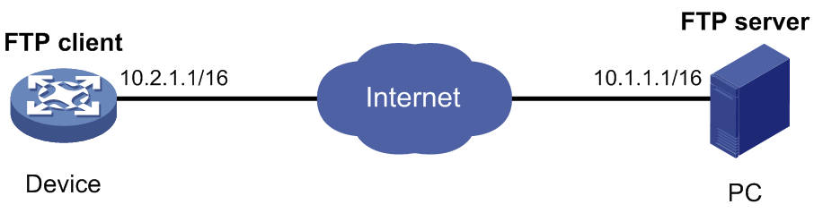

Using the device as an FTP client
Establishing an FTP connection
To access an FTP server, you must establish a connection from the FTP client to the FTP server.

FTP client configuration example in IRF mode
As shown in Figure 5, the PC is acting as an FTP server. A user account with the username abc and password 123456 has been created on the PC.
·          Use the IRF fabric as an FTP client to log in to the FTP server.
·          Download the temp.bin file from the FTP server to the FTP client.
·          Upload configuration file config.cfg from the FTP client to the FTP server for backup.
Figure 5 Network diagram
# Configure IP addresses as shown in Figure 5. Make sure the IRF fabric and PC can reach each other. (Details not shown.)
# Examine the storage space on the member devices. If the free space is insufficient, use the delete/unreserved file-url command to delete unused files. (Details not shown.)
# Log in to the FTP server using username abc and password 123456.
<Sysname> ftp 10.1.1.1
Press CTRL+C to abort.
Connected to 10.1.1.1 (10.1.1.1).
220 WFTPD 2.0 service (by Texas Imperial Software) ready for new user
User (10.1.1.1:(none)): abc
331 Give me your password, please
Password:
230 Logged in successfully
Remote system type is MSDOS.
ftp>
# Set the file transfer mode to binary.
ftp> binary
200 TYPE is now 8-bit binary
# Download the temp.bin file from the PC to the root directory of the flash memory on the global active MPU.
ftp> get temp.bin
local: temp.bin remote: temp.bin
150 Connecting to port 47457
226 File successfully transferred
23951480 bytes received in 95.399 seconds (251.0 kbyte/s)
# Download the temp.bin file from the PC to the root directory of the flash memory on the global standby MPUs.
ftp> get temp.bin chassis1#slot1#flash:/temp.bin
ftp> get temp.bin chassis2#slot0#flash:/temp.bin
ftp> get temp.bin chassis2#slot1#flash:/temp.bin
# Use the ASCII mode to upload configuration file config.cfg from the IRF fabric to the PC for backup.
ftp> ascii
200 TYPE is now ASCII
ftp> put config.cfg back-config.cfg
local: config.cfg remote: back-config.cfg
150 Connecting to port 47461
3494 bytes sent in 5.646 seconds (618.00 kbyte/s)
ftp> bye
221-Goodbye. You uploaded 2 and downloaded 2 kbytes.
221 Logout.
<Sysname>
Configuring TFTP
Trivial File Transfer Protocol (TFTP) is a simplified version of FTP for file transfer over secure reliable networks. TFTP uses UDP port 69 for data transmission. In contrast to TCP-based FTP, TFTP does not require authentication or complex message exchanges, and is easier to deploy. TFTP is suited for reliable network environments.
The device can only act as a TFTP client. You can upload a file from the device to the TFTP server or download a file from the TFTP server to the device. If you download a file with a file name that exists in the target directory, the device deletes the existing file and saves the new one. If file download fails due to network disconnection or other reasons, the original file cannot be restored. Therefore, use a nonexistent file name instead.
Figure 6 TFTP application scenario
