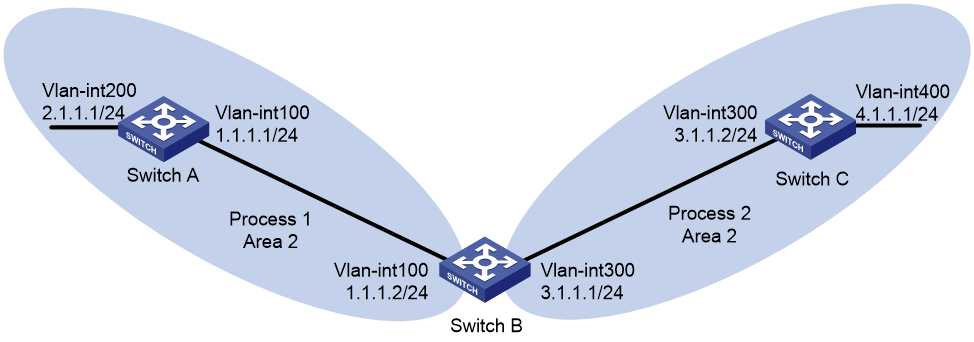

OSPF route summarization on an ASBR configuration example
Network requirements
As shown in Figure 9:
1.     Configure OSPF on Switch A, Switch B, and Switch C in Area 2.
2.     Enable OSPF process 1 and process 2 on Switch B. Switch B uses OSPF process 1 to exchange routing information with Switch A, and uses OSPF process 2 to exchange routing information with Switch C.
3.     Assign IP addresses 2.1.2.1/24, 2.1.3.1/24, and 2.1.4.1/24 to VLAN-interface 200 of Switch A. To enable Switch C to learn routes destined for 2.1.2.0/24, 2.1.3.0/24, 2.1.4.0/24, configure OSPF process 2 on Switch B to redistribute routes from process 1 and direct routes.
4.     To minimize the size of the routing table on Switch C, configure ASBR route summarization on Switch B. Switch B advertises only the summary route 2.0.0.0/8.
Figure 9 Network diagram
Configuration procedure
1.     Configure IP addresses for interfaces. (Details not shown.)
2.     Configure OSPF:

4.     Configure OSPF to summarize routes on the ASBR:
# Configure OSPF process 2 on Switch B to advertise summary route 2.0.0.0/8.
[SwitchB] ospf 2
[SwitchB-ospf-2] asbr-summary 2.0.0.0 8
[SwitchB-ospf-2] quit
# Display routing table information on Switch C.
[SwitchC]display ip routing-table
Destinations : 26       Routes : 26
Destination/Mask   Proto   Pre Cost        NextHop         Interface
0.0.0.0/32         Direct  0   0           127.0.0.1       InLoop0
1.1.1.0/24         OSPF    150 1           3.1.1.1         Vlan300
2.0.0.0/8          OSPF    150 1           3.1.1.1         Vlan300
3.1.1.0/24         Direct  0   0           3.1.1.2         Vlan300
3.1.1.0/32         Direct  0   0           3.1.1.2         Vlan300
3.1.1.2/32         Direct  0   0           127.0.0.1       InLoop0
3.1.1.255/32       Direct  0   0           3.1.1.2         Vlan300
4.1.1.0/24         Direct  0   0           4.1.1.1         Loop101
4.1.1.0/32         Direct  0   0           4.1.1.1         Loop101
4.1.1.1/32         Direct  0   0           127.0.0.1       InLoop0
4.1.1.255/32       Direct  0   0           4.1.1.1         Loop101
4.1.2.0/24         Direct  0   0           4.1.2.1         Loop102
4.1.2.0/32         Direct  0   0           4.1.2.1         Loop102
4.1.2.1/32         Direct  0   0           127.0.0.1       InLoop0
4.1.2.255/32       Direct  0   0           4.1.2.1         Loop102
4.1.3.0/24         Direct  0   0           4.1.3.1         Loop103
4.1.3.0/32         Direct  0   0           4.1.3.1         Loop103
4.1.3.1/32         Direct  0   0           127.0.0.1       InLoop0
4.1.3.255/32       Direct  0   0           4.1.3.1         Loop103
127.0.0.0/8        Direct  0   0           127.0.0.1       InLoop0
127.0.0.0/32       Direct  0   0           127.0.0.1       InLoop0
127.0.0.1/32       Direct  0   0           127.0.0.1       InLoop0
127.255.255.255/32 Direct  0   0           127.0.0.1       InLoop0
224.0.0.0/4        Direct  0   0           0.0.0.0         NULL0
224.0.0.0/24       Direct  0   0           0.0.0.0         NULL0
255.255.255.255/32 Direct  0   0           127.0.0.1       InLoop0
