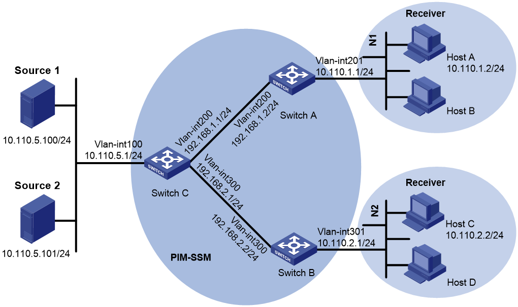

As shown in Figure 1:
· OSPF and PIM-DM run on the network.
· VOD streams are sent in multicast. Hosts of different organizations form stub networks N1 and N2.
· IGMPv2 runs between Switch A and N1, and between the other two switches and N2. Switch A acts as the IGMP querier in N1. Switch B acts as the IGMP querier in N2 because it has a lower IP address.
Configure basic IGMP features on the switches to meet the following requirements:
· Hosts in N1 can join any multicast groups.
· Hosts in N2 can join only multicast group 224.1.1.1.

Example: Configuring IGMP static group members
As shown in Figure 2:
Configure the switches to meet the following requirements:
· Hosts in N1 can join any multicast groups, and Host A can permanently receive multicast data addressed to multicast group 224.1.1.2.

Example: Configuring IGMP SSM mappings
As shown in Figure 3:
· The SSM group range for the PIM-SSM domain is 232.1.1.0/24.
· Switch A and Switch B in the PIM-SSM domain run IGMPv3.
· Host A in N1 and Host B in N2 run IGMPv2, and they do not support IGMPv3. The other hosts in N1 and N2 run IGMPv3.
Configure IGMP SSM mappings on Switch A and Switch B to meet the following requirements:
· Hosts in N1 receive multicast data only from Source 1.
· Hosts in N2 receive multicast data only from Source 2.

Procedures
1. Assign an IP address and subnet mask to each interface, as shown in Figure 3. (Details not shown.)
2. Configure OSPF on the switches in the PIM-SSM domain. (Details not shown.)
3. Enable IP multicast routing and enable PIM-SM:
# On Switch A, enable IP multicast routing, and enable PIM-SM on VLAN-interface 200.
<SwitchA> system-view
[SwitchA] multicast routing
[SwitchA-mrib] quit
[SwitchA] interface vlan-interface 200
[SwitchA-Vlan-interface200] pim sm
[SwitchA-Vlan-interface200] quit

5. Configure IGMPv3 on the receiver-side interfaces:
# On Switch A, enable IGMP, and specify IGMP version 3 on VLAN-interface 201.
[SwitchA] interface vlan-interface201
[SwitchA-Vlan-interface201] igmp enable
[SwitchA-Vlan-interface201] igmp version 3
[SwitchA-Vlan-interface201] quit
# Configure Switch B in the same way Switch A is configured. (Details not shown.)
6. Configure the SSM group range:
# On Switch A, configure the SSM group range as 232.1.1.0/24.
[SwitchA] acl basic 2000
[SwitchA-acl-ipv4-basic-2000] rule permit source 232.1.1.0 0.0.0.255
[SwitchA-acl-ipv4-basic-2000] quit
[SwitchA] pim
[SwitchA-pim] ssm-policy 2000
[SwitchA-pim] quit
# Configure Switch B and Switch C in the same way Switch A is configured. (Details not shown.)
7. Configure IGMP SSM mappings:
# On Switch A, configure an IGMP SSM mapping with multicast source 10.110.5.100 and multicast group range 232.1.1.0/24 specified in ACL 2000.
[SwitchA] igmp
[SwitchA-igmp] ssm-mapping 10.110.5.100 2000
[SwitchA-igmp] quit
# On Switch B, configure an IGMP SSM mapping with multicast source 10.110.5.101 and multicast group range 232.1.1.0/24 specified in ACL 2000.
[SwitchB] igmp
[SwitchB-igmp] ssm-mapping 10.110.5.101 2000
[SwitchB-igmp] quit
# Send IGMPv2 reports from Host A and Host C to join multicast group 232.1.1.1. (Details not shown.)
# Send multicast data from Source 1 and Source 2 to multicast group 232.1.1.1. (Details not shown.)
