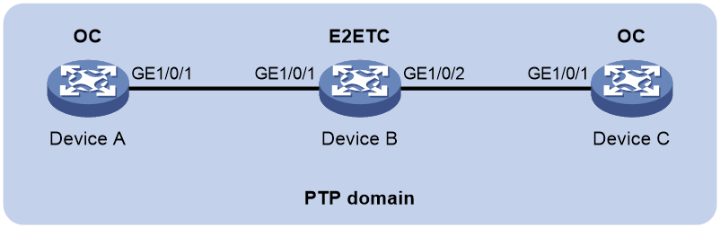

Example: Configuring PTP configuration (IEEE 1588 version 2, IEEE 802.3/Ethernet encapsulation)
As shown in Figure 4, a PTP domain contains Device A, Device B, and Device C.
·     Configure all devices to use the IEEE 1588 version 2 PTP profile.
·     Configure PTP messages to be encapsulated in IEEE 802.3/Ethernet packets.
·     Specify the OC clock node type for Device A and Device C, and E2ETC clock node type for Device B. All clock nodes elect a GM through BMC based on their respective default GM attributes.
Figure 4 Network diagram
1.     Configure Device A:
# Specify the IEEE 1588 version 2 PTP profile.
<DeviceA> system-view
[DeviceA] ptp profile 1588v2
# Specify the OC clock node type.
[DeviceA] ptp mode oc
# Specify PTP for obtaining the time.
[DeviceA] clock protocol ptp
# Enable PTP on GigabitEthernet 1/0/1.
[DeviceA-GigabitEthernet1/0/1] ptp enable
[DeviceA-GigabitEthernet1/0/1] quit
2.     Configure Device B:
<DeviceB> system-view
[DeviceB] ptp profile 1588v2
# Specify the E2ETC clock node type.
[DeviceB] ptp mode e2etc
[DeviceB] clock protocol ptp
[DeviceB-GigabitEthernet1/0/1] ptp enable
[DeviceB-GigabitEthernet1/0/1] quit
# Enable PTP on GigabitEthernet 1/0/2.
[DeviceB] interface gigabitethernet 1/0/2
[DeviceB-GigabitEthernet1/0/2] ptp enable
[DeviceB-GigabitEthernet1/0/2] quit
3.     Configure Device C:
<DeviceC> system-view
[DeviceC] ptp profile 1588v2
[DeviceC] ptp mode oc
[DeviceC] clock protocol ptp
[DeviceC] interface gigabitethernet 1/0/1
[DeviceC-GigabitEthernet1/0/1] ptp enable
[DeviceC-GigabitEthernet1/0/1] quit
When the network is stable, perform the following tasks to verify that Device A is elected as the GM, GigabitEthernet1/0/1 on Device A is the master port, and Device B has synchronized to Device A:
·     Use the display ptp clock command to display PTP clock information.
·     Use the display ptp interface brief command to display brief PTP statistics on an interface.
# Display PTP clock information on Device A.
[DeviceA] display ptp clock
PTP profile         : IEEE 1588 Version 2
PTP mode            : OC
Slave only          : No
Clock ID            : 000FE2-FFFE-FF0000
Clock type          : Local
Clock domain        : 0
Number of PTP ports : 1
Priority1     : 128
Priority2     : 128
Clock quality :
 Class                 : 248
 Accuracy              : 254
 Offset (log variance) : 65535
Offset from master : 0 (ns)
Mean path delay    : 0 (ns)
Steps removed      : 0
Local clock time   : Sun Jan 15 20:57:29 2011
# Display brief PTP statistics on Device A.
[DeviceA] display ptp interface brief
Name         State         Delay mechanism  Clock step  Asymmetry correction
GE1/0/1      Master        E2E              Two         0
# Display PTP clock information on Device B.
[DeviceB] display ptp clock
PTP mode            : E2ETC
Slave only          : No
Clock ID            : 000FE2-FFFE-FF0001
Clock type          : Local
Clock domain        : 0
Number of PTP ports : 2
Priority1     : 128
Priority2     : 128
Clock quality :
 Class                 : 248
 Accuracy              : 254
Offset from master : N/A
Mean path delay    : N/A
Steps removed      : N/A
# Display brief PTP statistics on Device B.
[DeviceB] display ptp interface brief
GE1/0/1      N/A           E2E              Two         0
GE1/0/2      N/A           E2E              Two         0

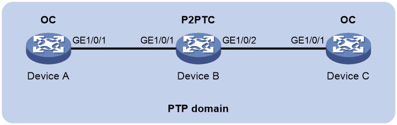

Example: Configuring PTP (IEEE 1588 version 2, multicast transmission)
As shown in Figure 5, a PTP domain contains Device A, Device B, and Device C.
·     Configure the source IP address for multicast PTP message transmission over UDP.
·     Specify the OC clock node type for Device A and Device C, and the P2PTC clock node type for Device B. All clock nodes elect a GM through BMC based on their respective default GM attributes.
·     Configure the peer delay measurement mechanism (p2p) for Device A and Device C.
Figure 5 Network diagram
# Configure the source IP address for multicast PTP message transmission over UDP.
[DeviceA] ptp source 10.10.10.1
# On GigabitEthernet 1/0/1, specify the PTP transport protocol as UDP, specify the delay measurement mechanism as p2p, and enable PTP.
[DeviceA-GigabitEthernet1/0/1] ptp transport-protocol udp [DeviceA-GigabitEthernet1/0/1] ptp delay-mechanism p2p
# Specify the P2PTC clock node type.
[DeviceB] ptp mode p2ptc
[DeviceB] ptp source 10.10.10.2
# On GigabitEthernet 1/0/1, specify the PTP transport protocol as UDP and enable PTP.
DeviceB-GigabitEthernet1/0/1] ptp transport-protocol udp
# On GigabitEthernet 1/0/2, specify the PTP transport protocol as UDP and enable PTP.
[DeviceB-GigabitEthernet1/0/2] ptp transport-protocol udp
[DeviceC] ptp source 10.10.10.3
[DeviceC-GigabitEthernet1/0/1] ptp transport-protocol udp [DeviceC-GigabitEthernet1/0/1] ptp delay-mechanism p2p
PTP mode            : OC
Slave only          : No
Clock type          : Local
Clock domain        : 0
Priority1     : 128
Priority2     : 128
Clock quality :
 Class                 : 248
 Accuracy              : 254
Steps removed      : 0
GE1/0/1      Master        P2P              Two         0
PTP mode            : P2PTC
Slave only          : No
Clock type          : Local
Clock domain        : 0
Priority1     : 128
Priority2     : 128
Clock quality :
 Class                 : 248
 Accuracy              : 254
Steps removed      : N/A
GE1/0/1      N/A           P2P              Two         0
GE1/0/2      N/A           P2P              Two         0

Local clock time   : Sun Jan 15 20:57:29 2019
# Device B上显示PTP的简要运行信息。
# Display brief PTP running information for all PTP interfaces on Device B.
The output shows that Device A is elected as the GM and GigabitEthernet1/0/1 on Device A sends time synchronization information to its downstreams as a master port.
