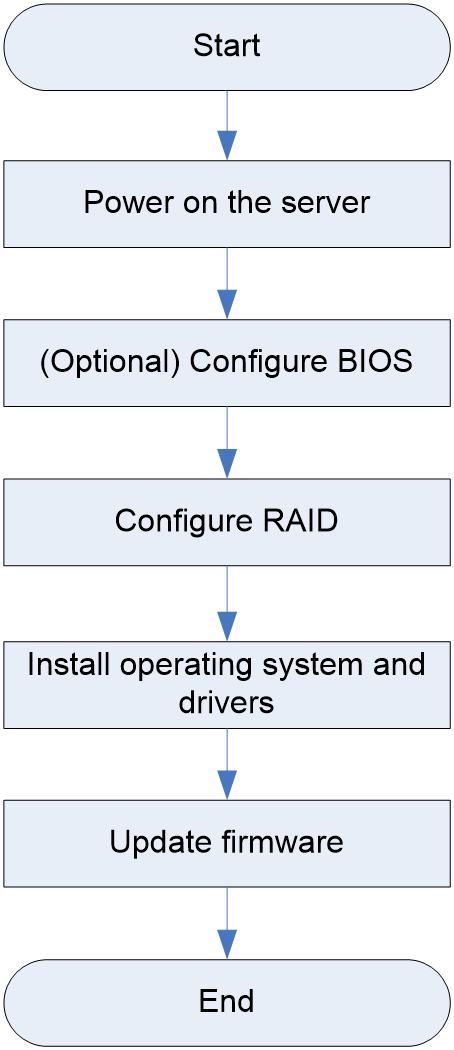

Configuring the server 24
Configuration flowchart 24
Powering on the server 24
Configuring basic BIOS settings· 25
Setting the server boot order 25
Setting the BIOS passwords· 25
Configuring RAID·· 25
Installing the operating system and hardware drivers· 25
Installing the operating system·· 25
Installing hardware drivers· 26
Updating firmware· 26

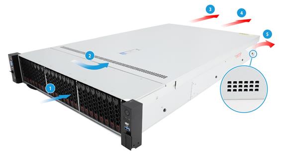

Airflow direction of the server
Figure 2 Airflow direction of the server
(1) and (2) Directions of the airflow into the chassis and power supply
(3) Directions of the airflow out of the power supply
(4) and (5) Direction of the airflow out of the chassis

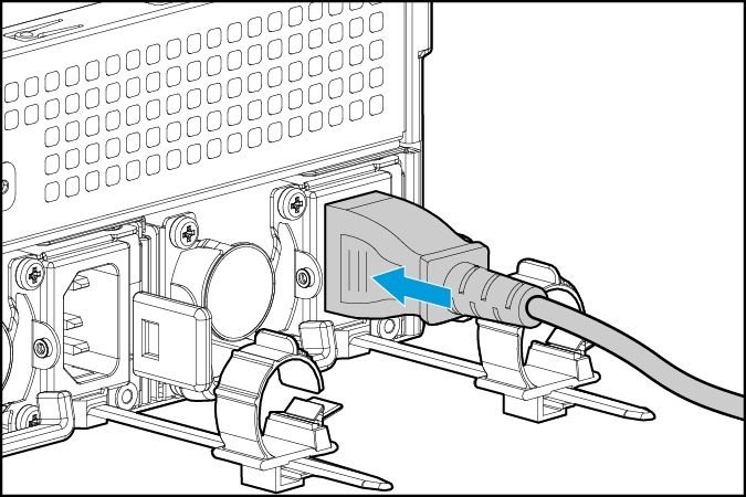

Connecting the power cord
Guidelines
WARNING
WARNING!
To avoid damage to the equipment or even bodily injury, use the power cord that ships with the server.
Before connecting the power cord, make sure the server and components are installed correctly.
1.     Insert the power cord plug into the power receptacle of a power supply at the rear panel, as shown in Figure 8.
Figure 8 Connecting the power cord
2.     Connect the other end of the power cord to the power source, for example, the power strip on the rack.
3.     Secure the power cord to avoid unexpected disconnection of the power cord.
Multiple types of wire fasteners can be used for securing the power cord. In this procedure, a cable clamp is used.
a.     If the cable clamp is positioned too near the power cord that it blocks the power cord plug connection, press down the tab on the cable mount and slide the clip backward.
Figure 9 Sliding the cable clamp backward
b.     Open the cable clamp, place the power cord through the opening in the cable clamp, and then close the cable clamp, as shown by callouts 1, 2, 3, and 4 in Figure 10.
Figure 10 Securing the AC power cord
c.     Slide the cable clamp forward until it is flush against the edge of the power cord plug, as shown in Figure 11.
Figure 11 Sliding the cable clamp forward
Figure 14 Configuration flowchart
1.     Power on the server. For information about the procedures, see "Powering on the server."
2.     Verify that the health LED on the front panel is steady green, which indicates that the system is operating correctly. For more information about the health LED status, see "LEDs and buttons."

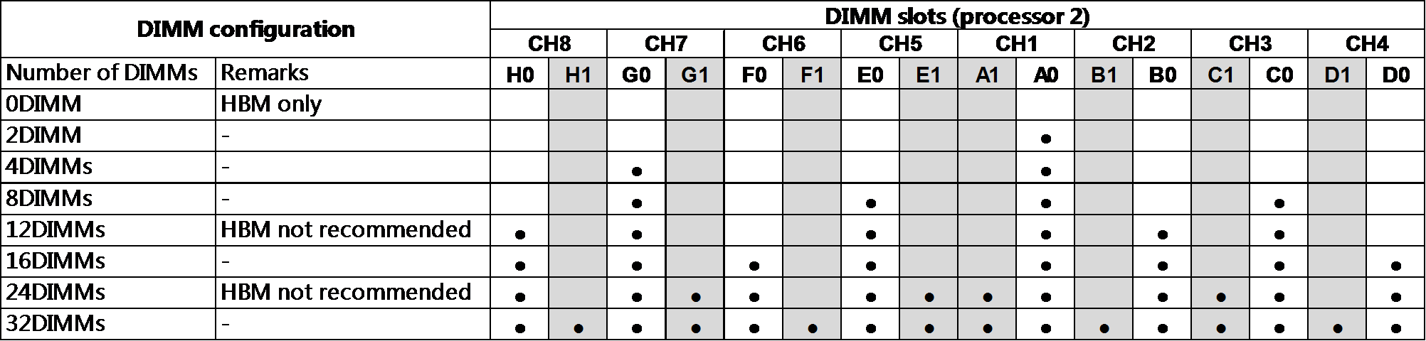

Installation guidelines
When you install only DDR5 DIMMs, follow these restrictions and guidelines:
·     Make sure their corresponding processors are present before powering on the server.
·     As a best practice, install DDR5 DIMMs that have the same product code and DIMM specification (type, capacity, rank, and frequency). For information about DIMM product codes, use the component compatibility lookup tool at http://www.h3c.com/en/home/qr/default.htm?id=66. To install components or replace faulty DIMMs of other specifications, contact Technical Support.
·     For the configured memory mode to take effect, make sure the following installation requirements are met:
Memory mode
DIMM population requirements
Independent
·     If one processor is present, see Figure 15.
·     If two processors are present, see Figure 16 and Figure 17.
Mirror
·     If one processor is present, this mode is supported only when 8 DIMMs or 16 DIMMs are installed. For more information, see Figure 15.
·     If two processors are present, this mode is supported only when 16 DIMMs or 32 DIMMs are installed. For more information, see Figure 16 and Figure 17.
·     If the DIMM configuration does not meet the requirements for the configured memory mode, the system uses the default memory mode (Independent mode).
·     In Figure 15, Figure 16, and Figure 17, the black DIMM slots (for example, the D1 slot) are grey colored, and the white DIMM slots (for example, the D0 slot) are not colored.

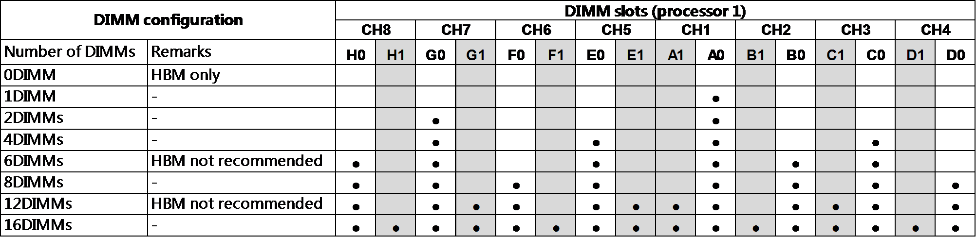

Figure 15 DDR5 DIMM population scheme for one processor
Figure 16 DDR5 DIMM population scheme for two processors (1)
Figure 17 DDR5 DIMM population schemes for two processors (2)

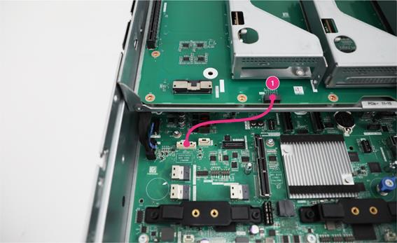

N/A
AUX
AUX connector
Connector to connector AUX7 on the system board.
N/A
N/A
N/A

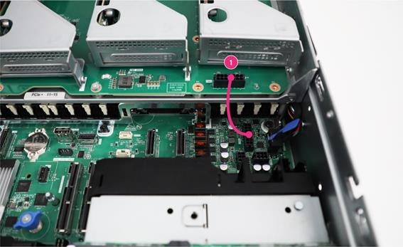

PWR
Power connector
Connected to connector PWR6 on the system board.

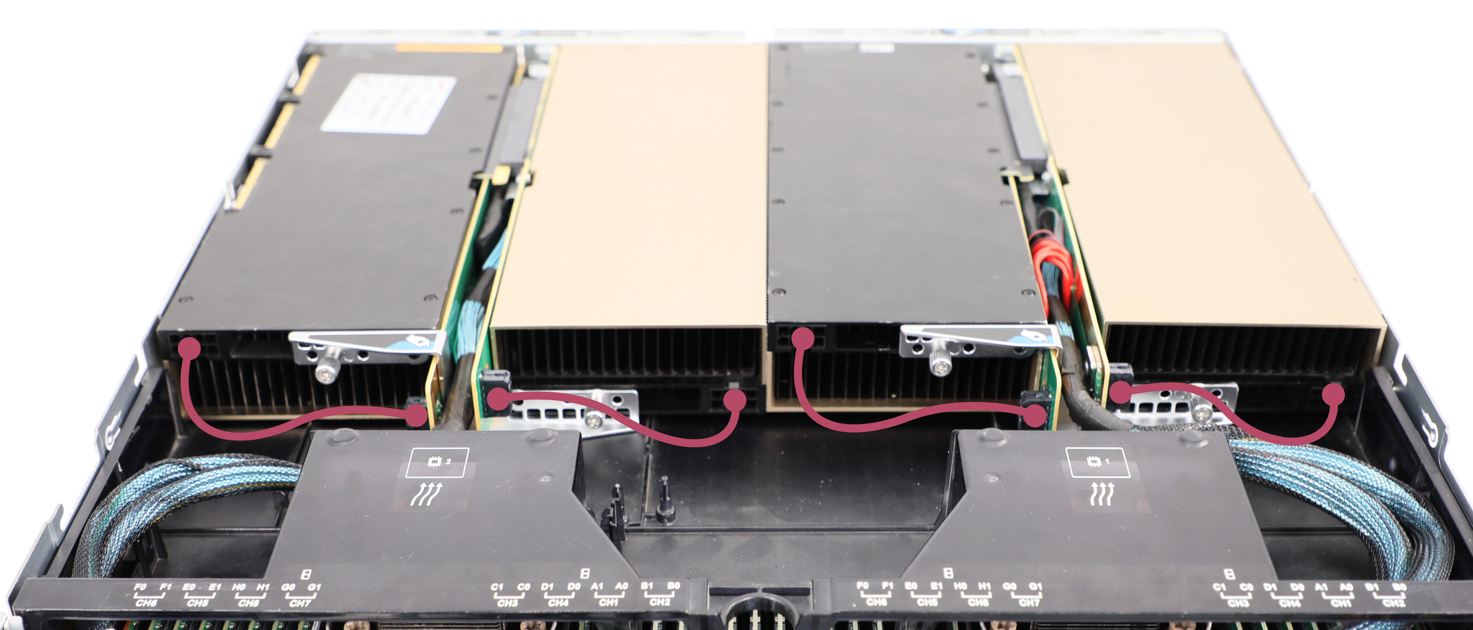

1.     Install a GPU module on the riser card:
a.     Insert the GPU module into the PCIe slot along the guide rails, and then close the retaining latch on the riser card.
b.     (Optional.) Connect the GPU module power cord according to the cable label.
2.     Reconnect other cables to the riser card.

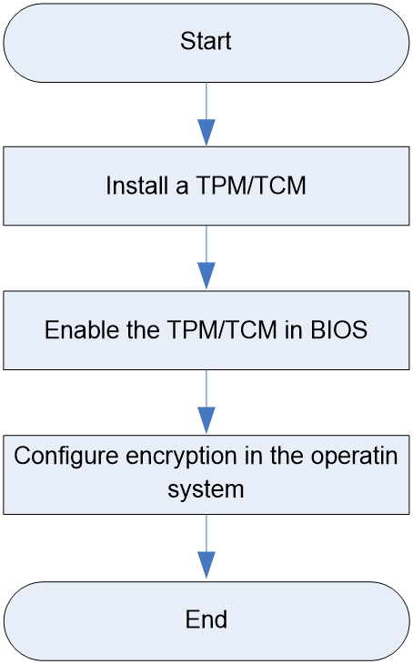

Installation and setup flowchart
Figure 18 TCM/TPM installation and setup flowchart

3.     Remove the power cord from the power supply:
a.     Press the tab to disengage the ratchet from the tie mount, slide the cable clamp outward, and then release the tab.
b.     Open the cable clamp and remove the power cord out of the clamp.
c.     Unplug the power cord.

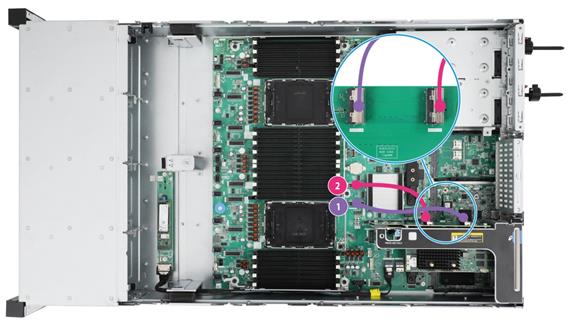

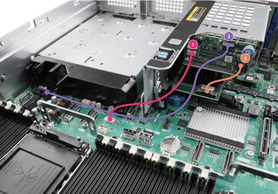

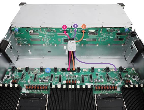

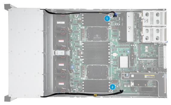

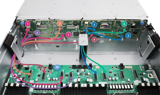

Connecting internal cables
Compared with the signal cables and power cords, more data cables (including SAS/SATA and NVMe data cables) are required and the cabling methods are more complicated. This section provides code information for data cables and you can use the information to identify cables and their connection methods.
Guidelines
Follow these guidelines when connecting the internal cables:
·     Do not route the cables above the removable components, such as DIMMs.
·     Route the internal cables without hindering installation or removal of other components or hindering other internal components.
·     Route the cables neat and tidy in their own fixed spaces. Make sure the cables will not be squeezed or scratched by other internal components.
·     Do not pull the connectors when routing the cables.
·     Do not use a cable tie to bundle an excessive number of cables.
·     Appropriately bind long cables. Coil and use cable ties to secure unused cables.
·     Connect the drive cables until they click into place.
·     Remove the cap (if any) from the target cable connector before connecting a cable to it.
·     If you cannot identify the cables by labels provided with the cables, apply new labels to cables for easy identification.
Connecting drive cables
Drive cables include SAS/SATA data cables, NVMe data cables, power cords, and signal cables. The server supports multiple drive configurations. This section takes the following eight typical drive configurations as examples to help users understand the cabling schemes for drives. For cabling schemes for other drive configurations, contact technical support.

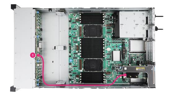

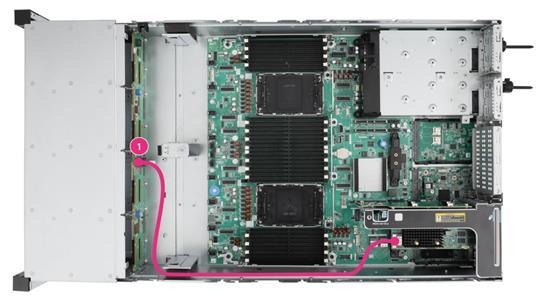

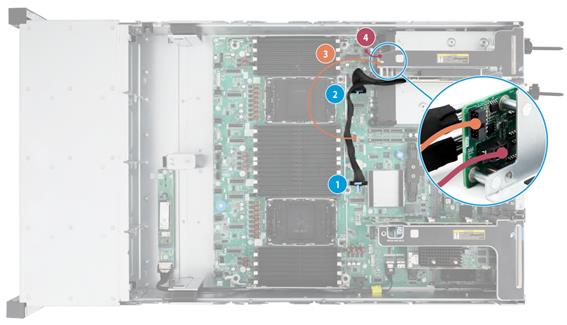

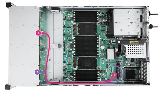

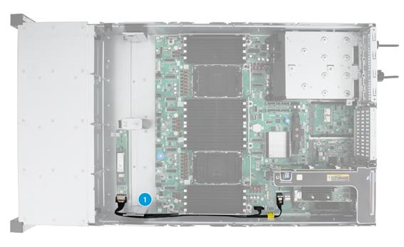

8LFF SAS/SATA drives at the front
1.     Connect SAS/SATA data cables for the 8LFF drives at the front.
Figure 19 Connecting SAS/SATA data cables for the 8LFF drives at the front
No.
Cable type
Cable code
Description
1
SAS/SATA data cable
0404A1KT
From connector SAS PORT on the front backplane to connector C0 on the storage controller.
To use this cabling scheme, you can install the storage controller in slots 1 to 8. In this example, the storage controller is installed in slot 1.

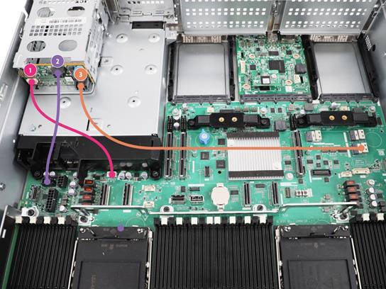

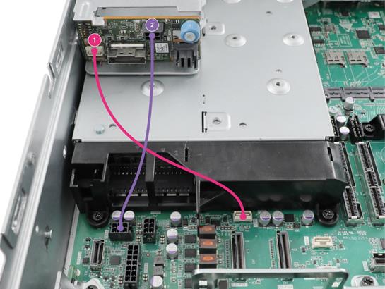

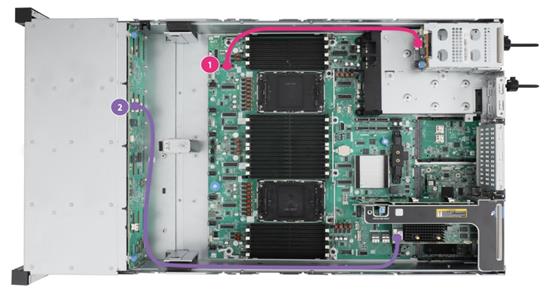

2.     Connect an AUX cable and power cord for 8LFF drives at the front.
Figure 20 Connecting an AUX cable and power cord for the 8LFF drives at the front
No.
Cable type
Description
1
AUX cable
From connector AUX on the front drive backplane to connector AUX1 on the system board
2
Power cord
From connector PWR on the front drive backplane to connector PWR1 on the system board

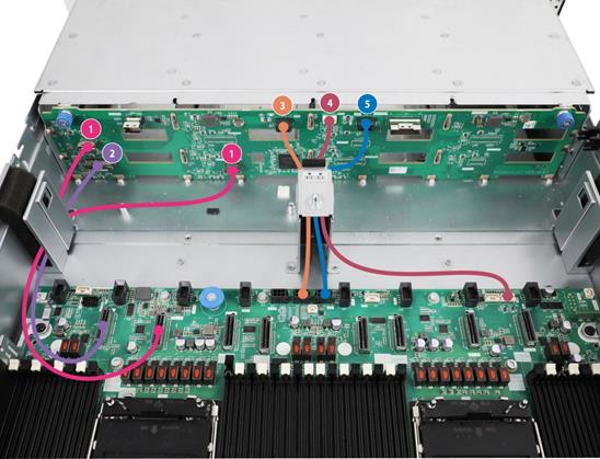

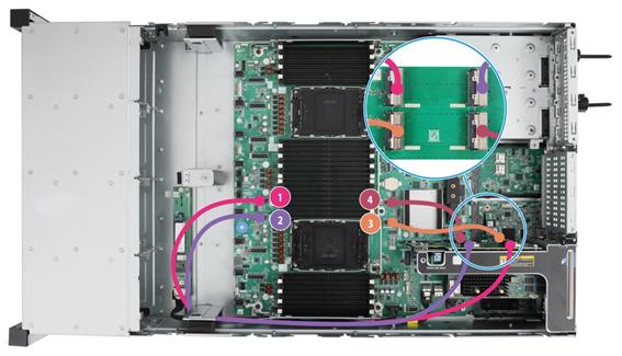

12LFF (8 SAS/SATA + 4 UniBay) drives at the front
1.     Connect SAS/SATA data cables for the 12LFF drives at the front.
Figure 21 Connecting SAS/SATA data cables for the 12LFF drives at the front
No.
Cable type
Cable code
Description
1
SAS/SATA data cable
0404A1QM
From connector SAS PORT1 on the front backplane to connector C0 on the storage controller.
2
SAS/SATA data cable
0404A1RG
From connector SAS PORT2 on the front backplane to connector C1 on the storage controller.
To use this cabling scheme, you can install the storage controller in slots 1 to 6. In this example, the storage controller is installed in slot 1.

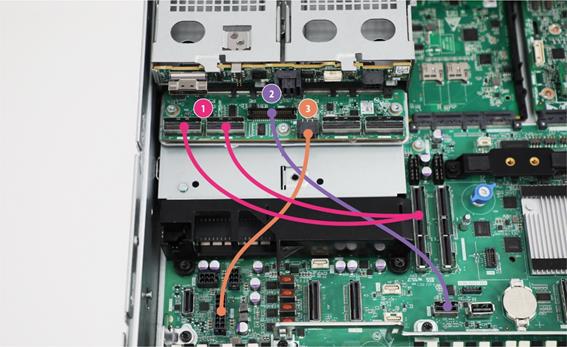

2.     Connect power cords, AUX cable, and NVMe cables for 12LFF drives at the front.
Figure 22 Connecting power cords, AUX cable, and NVMe cables for 12LFF drives at the front
No.
Cable type
Cable code
Description
1
NVMe data cable
0404A209
From connectors NVME A3 and NVME A4 on the front drive backplane to connector C1-P4C on the system board
2
NVMe data cable
0404A1WS
From connector NVME A1/A2 on the front drive backplane to connector C1-P4A on the system board
3
Power cord
From connector PWR2 on the front drive backplane to connector PWR2 on the system board
4
AUX cable
5
Power cord
From connector PWR1 on the front drive backplane to connector PWR1 on the system board

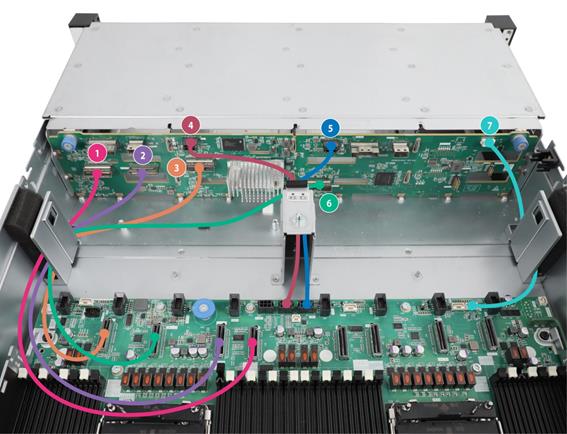

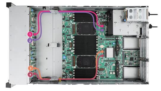

12LFF (4 SAS/SATA + 8 UniBay) drives at the front
1.     Connect an SAS/SATA data cable for the 12LFF drives at the front.
Figure 23 Connecting an SAS/SATA data cable for the 12LFF drives at the front
No.
Cable type
Cable code
Description
1
SAS/SATA data cable
0404A1QM
Figure 24 Connecting power cords, AUX cable, and NVMe cables for 12LFF drives at the front
No.
Cable type
Cable code
Description
1
NVMe data cable
0404A1WS
From connector NVME A1/A2 on the front drive backplane to connector C1-P3A on the system board
2
NVMe data cable
0404A1PY
From connector NVME A3/A4 on the front drive backplane to connector C1-P3C on the system board
3
NVMe data cable
0404A1WS
From connector NVME B1/B2 on the front drive backplane to connector C1-P4A on the system board
4
Power cord
5
Power cord
6
NVMe data cable
0404A1WT
From connector NVME B3/B4 on the front drive backplane to connector C1-P4C on the system board
7
AUX cable

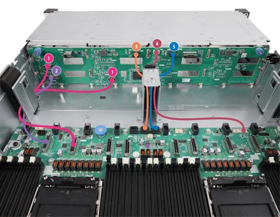

12LFF UniBay drives at the front

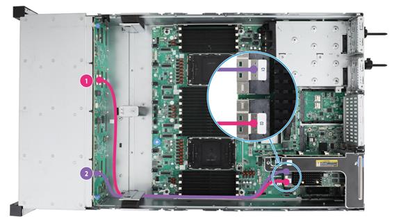

Figure 25 Connecting SAS/SATA data cables for the 12LFF drives at the front
No.
Cable type
Cable code
Description
1
SAS/SATA data cable
0404A1RE
From connector SAS PORT1 on the front backplane to connectors M.2&SATA PORT1 and M.2&SATA PORT1 on the system board
2
SAS/SATA data cable
0404A1RF
From connector SAS PORT2 on the front backplane to connector SATA PORT3 on the system board
2.     Connect power cords and AUX cable for 12LFF drives at the front.
Figure 26 Connecting power cords and AUX cable for 12LFF drives at the front
No.
Cable type
Description
1
Power cord
2
AUX cable
3
Power cord

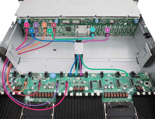

2.     Connect NVMe data cables, power cords, and AUX cable for 25SFF drives at the front.
Figure 29 Connecting NVMe data cables, power cords, and AUX cable for 25SFF drives at the front
No.
Cable type
Cable code
Description
1
NVMe data cable
0404A1PY
From connector NVME 1 on the front drive backplane to connector C1-P3A on the system board
2
NVMe data cable
0404A1PY
From connector NVME 2 on the front drive backplane to connector C1-P3C on the system board
3
NVMe data cable
0404A1PY
From connector NVME 3 on the front drive backplane to connector C1-P4A on the system board
4
NVMe data cable
0404A1PY
From connector NVME 4 on the front drive backplane to connector C1-P4C on the system board
5
Power cord
From connector PWR3 on the front drive backplane to connector PWR3 on the system board
6
AUX cable
7
Power cord
8
Power cord

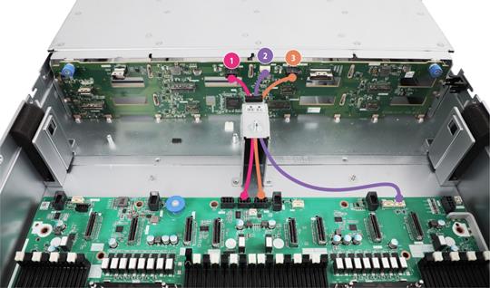

Figure 30 Connecting power cords and AUX cables for the 8SFF UniBay+8SFF UniBay+8SFF UniBay drives at the front
No.
Cable type
Description
1
AUX cable
From connector AUX on the drive backplane in front bay 3 to connector AUX3 on the system board
2
Power cord
From connector PWR on the drive backplane in front bay 3 to connector AUX3 on the system board
3
AUX cable
From connector AUX on the drive backplane in front bay 2 to connector AUX2 on the system board
4
Power cord
From connector PWR on the drive backplane in front bay 2 to connector PWR2 on the system board
5
Power cord
From connector PWR on the drive backplane in front bay 1 to connector PWR1 on the system board
6
AUX cable
From connector AUX on the drive backplane in front bay 1 to connector AUX1 on the system board

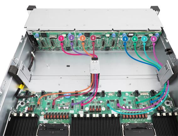

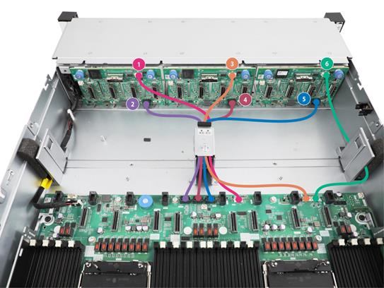

2.     Connect NVMe cables for 8SFF UniBay+8SFF UniBay+8SFF UniBay drives at the front.
Figure 31 Connecting NVMe cables for 8SFF UniBay+8SFF UniBay+8SFF UniBay drives at the front (1)
No.
Cable type
Cable code
Description
1
NVMe data cable
0404A1Q2
From connector NVME B1/B2 on the drive backplane in front bay 3 to connector C1-P3A on the system board
2
NVMe data cable
0404A1Q2
From connector NVME B3/B4 on the drive backplane in front bay 3 to connector C1-P3C on the system board
3
NVMe data cable
0404A1PY
From connector NVME A1/A2 on the drive backplane in front bay 2 to connector C1-P4A on the system board
4
NVMe data cable
0404A1WT
From connector NVME A3/A4 on the drive backplane in front bay 2 to connector C1-P4C on the system board
5
NVMe data cable
0404A2WS
From connector NVME A1/A2 on the drive backplane in front bay 1 to connector C2-P3A on the system board
6
NVMe data cable
0404A1WS
From connector NVME A3/A4 on the drive backplane in front bay 1 to connector C2-P3C on the system board
7
NVMe data cable
0404A1Q2
From connector NVME B1/B2 on the drive backplane in front bay 1 to connector C2-P4A on the system board
8
NVMe data cable
0404A1WS
From connector NVME B3/B4 on the drive backplane in front bay 1 to connector C2-P4C on the system board

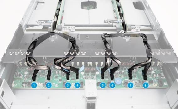

Figure 32 Connecting NVMe cables for 8SFF UniBay+8SFF UniBay+8SFF UniBay drives at the front (2)
No.
Cable type
Cable code
Description
1
NVMe data cable
0404A1PW
From connector NVME B1/B2 on the drive backplane in front bay 2 to connector C2-P2A on the system board
2
NVMe data cable
0404A1PW
From connector NVME B3/B4 on the drive backplane in front bay 2 to connector C2-P2C on the system board
3
NVMe data cable
0404A1PW
From connector NVME A1/A2 on the drive backplane in front bay 3 to connector C1-P2A on the system board
4
NVMe data cable
0404A1PW
From connector NVME A3/A4 on the drive backplane in front bay 3 to connector C1-P2C on the system board

3
NVMe data cable
0404A1RP
From connector SAS PORT on the rear drive backplane to connector M.2&SATA PORT1 on the system board
12LFF SAS/SATA drives at the front + 2SFF SAS/SATA+x16 drives at the rear
4.     Connect SAS/SATA data cables for the 12LFF drives at the front.
Figure 34 Connecting SAS/SATA data cables for the 12LFF drives at the front
No.
Cable type
Cable code
Description
1
SAS/SATA data cable
0404A1RE
From connector SAS PORT1 on the front drive backplane to connectors M.2&SATA PORT1 and SATA PORT2 on the system board
2
SAS/SATA data cable
0404A1RF
From connector SAS PORT2 on the front drive backplane to connector SATA PORT3 on the system board
To use this cabling scheme, you can only install the storage controller in slot 6.
5.     Connect an AUX cable and power cords for the 12LFF drives at the front.
Figure 35 Connecting an AUX cable and power cords for the 12LFF drives at the front
No.
Cable type
Description
1
Power cord
2
AUX cable
3
Power cord

12LFF (8 SAS/SATA + 4 UniBay) drives at the front + 2SFF UniBay drives at the rear
1.     Connect an SAS/SATA cable for 12LFF drives at the front and an NVMe data cable for 2SFF UniBay drives at the rear.
Figure 37 Connecting an SAS/SATA cables for 12LFF drives at the front and an NVMe data cable for 2SFF UniBay drives at the rear
No.
Cable type
Cable code
Description
1
NVMe data cable
0404A1Q3
From connector NVME on the rear drive backplane to connector C2-P3A on the system board
2
SAS/SATA data cable
0404A1QM
From connector SAS PORT1 on the front drive backplane to connector C0 on the storage controller
Figure 38 Connecting power cords, AUX cable, and NVMe cables for 12LFF drives at the front
No.
Cable type
Cable code
Description
1
NVMe data cable
0404A209
2
NVMe data cable
0404A1WS
3
Power cord
4
AUX cable
5
Power cord

Connecting cables for the OCP network adapter
Figure 40 Connecting cables for the OCP network adapter
No.
Cable type
Cable code
Description
1
PCIe data cable
0404A1SB
From MCIO connector 1 (PCIe port1) and MCIO connector 2 (PCIe port 2) on the OCP network adapter to riser connector 3 (RISER3 PCIe X16) on the system board
2
AUX cable
From connector AUX on the OCP network adapter to connector AUX8 on the system board
3
Power cord
From connector AUX on the OCP network adapter to connector PWR6 on the system board

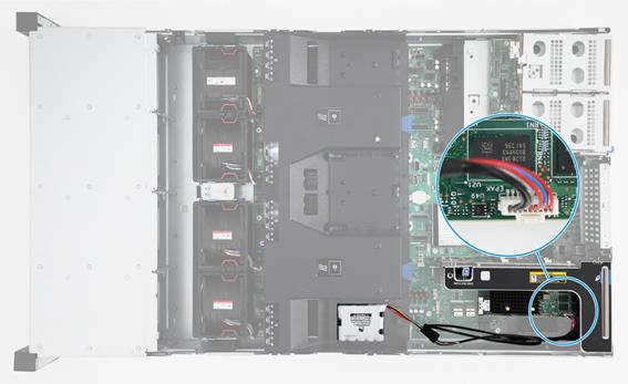

Connecting the supercapacitor cable
Connecting cables for the mid GPU module
Figure 41 Connecting an AUX cable for the mid GPU module
No.
Cable type
Description
1
Aux cable
From connector AUX on the mid GPU module to connector AUX7 on the system board
Figure 42 Connecting data cables for the mid GPU module
No.
Cable type
Cable code
Description
1
PCIe data cable
0404A1RJ
From connector PCIe port5 on the mid-position GPU module to connector C2-P4C on the system board
2
PCIe data cable
0404A1RJ
From connector PCIe port4 on the mid-position GPU module to connector C2-P4A on the system board
3
PCIe data cable
0404A1RJ
From connector PCIe port3 on the mid-position GPU module to connector C1-P3A on the system board
4
PCIe data cable
0404A1RJ
From connector PCIe port2 on the mid-position GPU module to connector C1-P3C on the system board
Figure 43 Connecting a power cord for the mid-position GPU module
No.
Cable type
Description
1
Power cord
From connector PWR on the mid-position GPU module to connector PWR6 on the system board
Connecting cables for the rear 4GPU module
Figure 44 Connecting data cables for the rear 4GPU module
No.
Cable type
Cable code
Description
1
PCIe data cable
0404A1Y8
From rear GPU module S3 in slot 14 to connector C2-P3A on the system board
2
PCIe data cable
0404A1Y8
From rear GPU module S4 in slot 14 to connector C2-P3C on the system board
3
PCIe data cable
0404A1Y8
From rear GPU module S2 in slot 13 to connector C2-P4C on the system board
4
PCIe data cable
0404A1Y8
From rear GPU module S1 in slot 13 to connector C2-P4A on the system board
5
PCIe data cable
0404A1Y9
From rear GPU module S3 in slot 12 to connector C1-P3A on the system board
6
PCIe data cable
0404A1Y9
From rear GPU module S4 in slot 12 to connector C1-P3C on the system board
7
PCIe data cable
0404A1Y9
From rear GPU module S2 in slot 11 to connector C1-P4C on the system board
8
PCIe data cable
0404A1Y9
From GPU module S1 in slot 11 to connector C1-P4A on the system board
Figure 45 Connecting power cords for the rear 4GPU module

Connecting chassis ear cables
Figure 51 Connecting chassis ear cables
(1) Left chassis ear cable
(2) Right chassis ear cable
