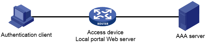

Web authentication system
A typical Web authentication system consists of four basic components: authentication client, access device, local portal Web server, and AAA server.
Figure 1 Web authentication system using the local portal server
Authentication client
An authentication client is a Web browser that runs HTTP or HTTPS.
Access device
An access device has the following functions:
· Redirects all user HTTP or HTTPS requests that do not match authentication-free rules to the Web authentication page before authentication.
· Interacts with the AAA server to complete authentication, authorization, and accounting. For more information about AAA, see "Configuring AAA."
· Allows users that pass authentication to access authorized network resources.
Local portal Web server
The access device acts as the local portal Web server. The local portal Web server pushes the Web authentication page to authentication clients and obtains user authentication information (username and password).
AAA server
An AAA server interacts with the access device to implement user authentication, authorization, and accounting. A RADIUS server can perform authentication, authorization, and accounting for Web authentication users. An LDAP server can perform authentication for Web authentication users.

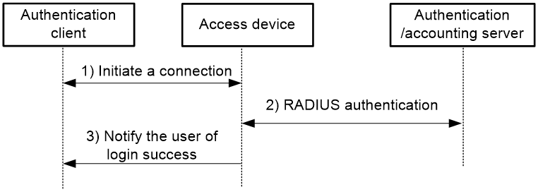

Web authentication process
Figure 2 Web authentication process
The Web authentication process is as follows:
1. An unauthenticated user sends an HTTP or HTTPS request. When the access device receives the HTTP or HTTPS request on a Layer 2 Ethernet interface enabled with Web authentication, it redirects the request to the Web authentication page. The user enters the username and password on the Web authentication page.
If the user requests the Web authentication page or free Web resources, the access device permits the request. No Web authentication is performed.
2. The access device and the AAA server exchange RADIUS packets to authenticate the user.
3. If the user passes RADIUS authentication, the local portal Web server pushes a login success page to the authentication client.
If the user fails RADIUS authentication, the local portal Web server pushes a login failure page to the authentication client.

Figure 3 Web authentication for non-directly connected users

Example: Configuring Web authentication by using the local authentication method
As shown in Figure 4, the host is directly connected to the device through Ten-GigabitEthernet 1/0/1.
Configure Web authentication on Ten-GigabitEthernet 1/0/1, and use local authentication and authorization for the users.
Configure the device to push customized Web authentication pages to users and use HTTP to transfer the authentication data.
1. Customize the authentication pages, compress them to a file, and upload the file to the root directory of the storage medium of the device. In this example, the file is abc.zip. (Details not shown.)
2. Assign IP addresses to the host and the device as shown in Figure 4, and make sure the host and the device can reach each other.

Example: Configuring Web authentication by using the RADIUS authentication method
As shown in Figure 5, the host is directly connected to the device through Ten-GigabitEthernet 1/0/1.
Configure Web authentication on Ten-GigabitEthernet 1/0/1, and use a RADIUS server to perform authentication and authorization for the users.
1. Configure the RADIUS server properly to provide authentication and accounting functions for users. In this example, the username is configured as user1 on the RADIUS server. (Details not shown.)
2. Customize the authentication pages, compress them to a file, and upload the file to the root directory of the storage medium of the switch. In this example, the file is abc.zip.
3. Create VLANs, assign IP addresses to the VLAN interfaces, and assign interfaces to the VLANs. Make sure the host, the RADIUS server, and the device can reach each other. (Details not shown.)
