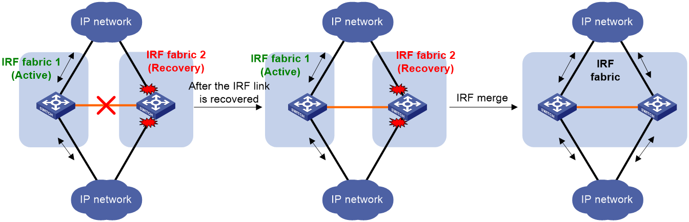

IRF merge occurs when two split IRF fabrics reunite or when two independent IRF fabrics are united, as shown in Figure 4.
Figure 4 IRF merge

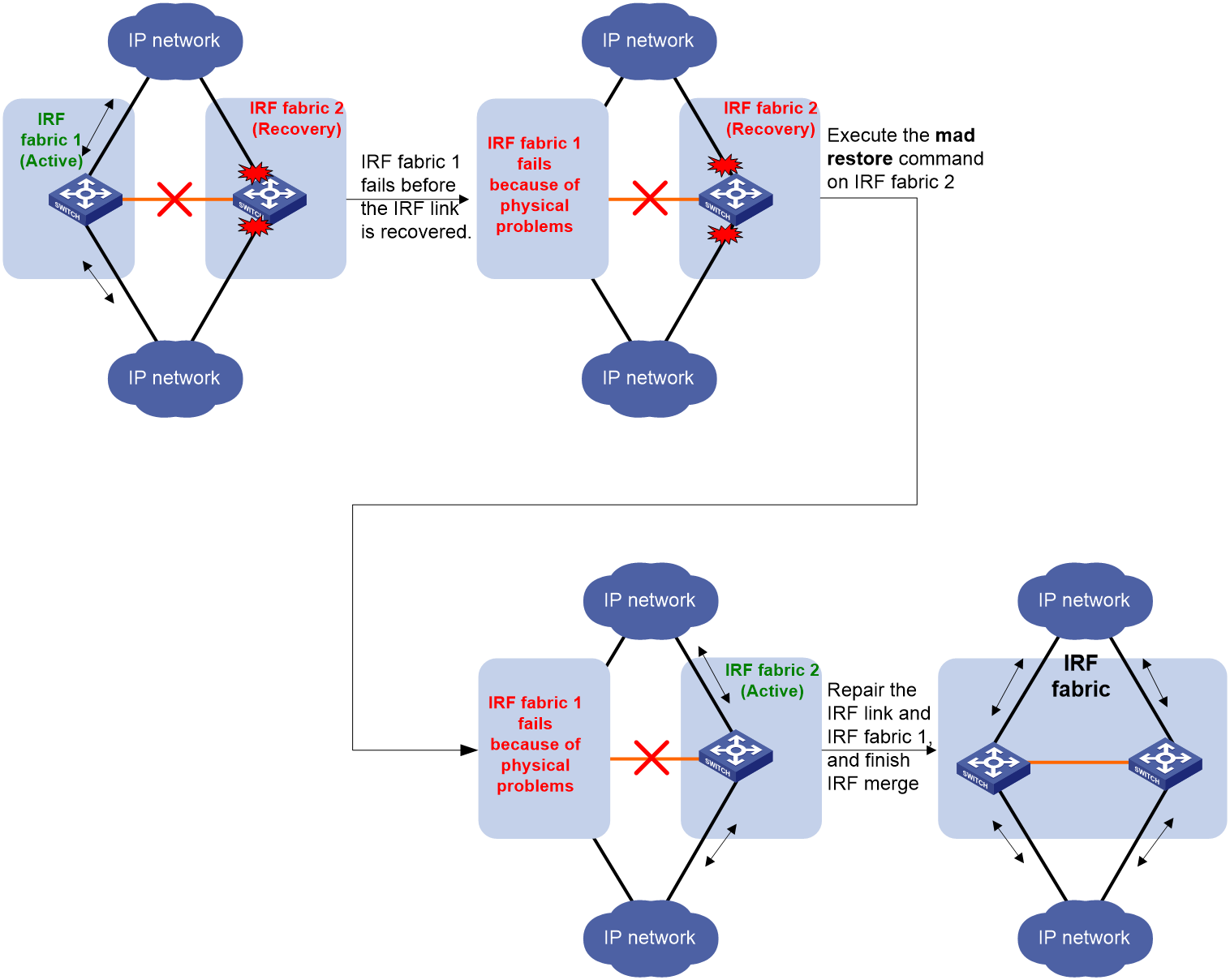

An IRF link failure causes an IRF fabric to split in two IRF fabrics operating with the same Layer 3 settings, including the same IP address. To avoid IP address collision and network problems, IRF uses multi-active detection (MAD) mechanisms to detect the presence of multiple identical IRF fabrics, handle collisions, and recover from faults.

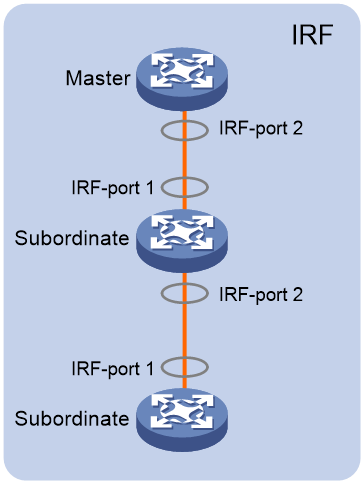

In the current software version, an S7500X-G IRF fabric can only use a daisy-chain topology as shown in Figure 6.
Figure 6 Daisy-chain topology

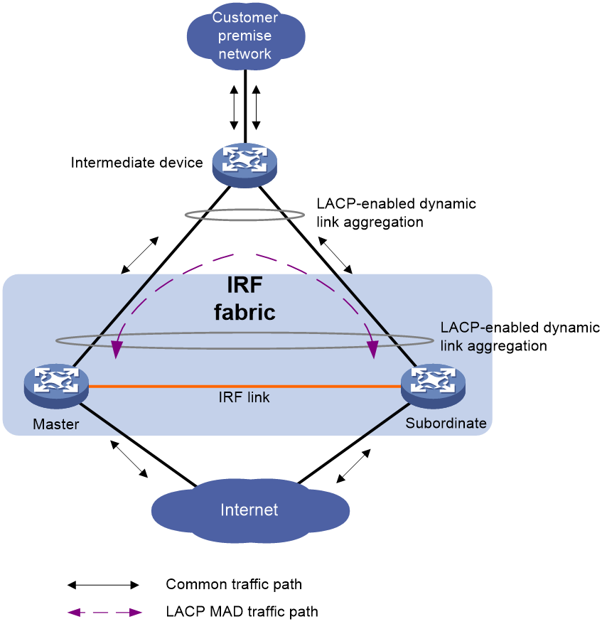

IRF provides MAD mechanisms by extending LACP, BFD, ARP, and IPv6 ND to detect multi-active collisions. As a best practice, configure a minimum of one MAD mechanism on an IRF fabric. For more information about the MAD mechanisms and their application scenarios, see "MAD mechanisms."
For information about LACP, see Ethernet link aggregation in Layer 2—LAN Switching Configuration Guide. For information about BFD, see High Availability Configuration Guide. For information about ARP, see Layer 3—IP Services Configuration Guide. For information about ND, see IPv6 basics in Layer 3—IP Services Configuration Guide.

When detecting a multi-active collision, MAD disables all IRF fabrics except one from forwarding data traffic by placing them in Recovery state. The IRF fabrics placed in Recovery state are called inactive IRF fabrics. The IRF fabric that continues to forward traffic is called the active IRF fabric.
BFD MAD and LACP MAD use the following process to handle a multi-active collision:
1.     Compare the health states of split fabrics.‍ To view their health states, use the display system health command. For more information about this command, see device management in Fundamentals Command Reference.
2.     Set all fabrics to the Recovery state except the healthiest one.
3.     Compare the number of members in each fabric if all IRF fabrics are in the same health state.
4.     Set all fabrics to the Recovery state except the one that has the most members.
5.     Compare the member IDs of their masters if all IRF fabrics have the same number of members.
6.     Set all fabrics to the Recovery state except the one that has the lowest numbered master.
7.     Shut down all common network interfaces in the Recovery-state fabrics except for the following interfaces:
¡     Interfaces automatically excluded from being shut down by the system.
¡     Interfaces specified by using the mad exclude interface command.

Failure recovery
To merge two split IRF fabrics, first repair the failed IRF link and remove the IRF link failure.
After the failed IRF link between two split IRF fabrics is recovered, log in to the inactive IRF fabric to reboot its member devices if the system requires you to do so. After these member devices join the active IRF fabric as subordinate devices, the IRF merge is complete, as shown in Figure 7. The network interfaces that have been shut down by MAD automatically restore their original state.
CAUTION
CAUTION:
If you inadvertently reboot the active IRF fabric after the failed IRF link recovers, its member devices will join the inactive IRF fabric with their network interfaces being shut down by MAD. To restore the original states of the network interfaces in the merged IRF fabric, use the mad restore command.
If the IRF auto-merge feature is enabled, the inactive IRF member devices will automatically reboot after the failed IRF link recovers and a manual reboot is typically not required.
Figure 7 Recovering the IRF fabric
If the active IRF fabric fails before the IRF link is recovered (see Figure 8), use the mad restore command on the inactive IRF fabric to recover the inactive IRF fabric. This command brings up all network interfaces that were shut down by MAD. After the IRF link is repaired, merge the two parts into a unified IRF fabric.
Figure 8 Active IRF fabric fails before the IRF link is recovered

LACP MAD
As shown in Figure 9, LACP MAD has the following requirements:
·     Every IRF member must have a link with an intermediate device.
·     All the links form a dynamic link aggregation group.
·     The intermediate device must be a device that supports extended LACP for MAD.
The IRF member devices send extended LACPDUs that convey a domain ID and an active ID (the member ID of the master). The intermediate device transparently forwards the extended LACPDUs received from one member device to all the other member devices.
·     If the domain IDs and active IDs sent by all the member devices are the same, the IRF fabric is integrated.
·     If the extended LACPDUs convey the same domain ID but different active IDs, a split has occurred. LACP MAD handles this situation as described in "Collision handling."
Figure 9 LACP MAD scenario

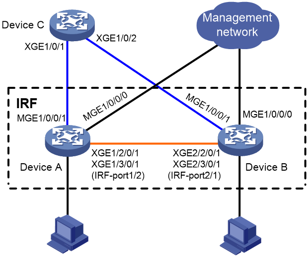

BFD MAD
BFD MAD detects multi-active collisions by using BFD.
You can use common or management Ethernet ports for BFD MAD.
If management Ethernet ports are used, BFD MAD has the following requirements:
·     Use an intermediate device and make sure each IRF member device has a BFD MAD link to the intermediate device.
·     Assign each member device a MAD IP address on the master's management Ethernet port.
If common Ethernet ports are used, BFD MAD has the following requirements:
·     If an intermediate device is used, each member device must have a BFD MAD link to the intermediate device. If no intermediate device is used, all member devices must have a BFD MAD link to each other.
·     Assign all ports on the BFD MAD links to the same VLAN. Assign each member device a MAD IP address on the VLAN interface.
When you use BFD MAD, follow these restrictions and guidelines:
·     As a best practice, use an intermediate device to connect IRF member devices if the IRF fabric has more than two member devices. A full mesh of IRF members might cause broadcast loops.
·     As a best practice to avoid failure of service modules that provide BFD MAD ports from affecting BFD MAD, preferentially use management Ethernet ports for BFD MAD.
·     The BFD MAD links and BFD MAD VLAN must be dedicated. Do not use the BFD MAD links or BFD MAD VLAN for any other purposes.
·     The MAD addresses identify the member devices and must belong to the same subnet.
·     Of all management Ethernet ports on an IRF fabric, only the master's management Ethernet port is accessible.
Figure 10 shows a typical BFD MAD scenario that uses an intermediate device. On the intermediate device, assign the ports on the BFD MAD links to the same VLAN.
Figure 11 shows a typical BFD MAD scenario that does not use an intermediate device.
With BFD MAD, the master attempts to establish BFD sessions with other member devices by using its MAD IP address as the source IP address.
·     If the IRF fabric is integrated, only the MAD IP address of the master takes effect. The master cannot establish a BFD session with any other member. If you execute the display bfd session command, the state of the BFD sessions is Down.
·     When the IRF fabric splits, the IP addresses of the masters in the split IRF fabrics take effect. The masters can establish a BFD session. If you execute the display bfd session command, the state of the BFD session between the two devices is Up.

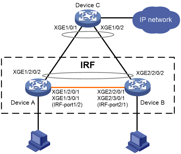

ARP MAD
ARP MAD detects multi-active collisions by using extended ARP packets that convey the IRF domain ID and the active ID.
You can use common or management Ethernet ports for ARP MAD.
If management Ethernet ports are used, ARP MAD must work with an intermediate device. Make sure the following requirements are met:
·     Connect a management Ethernet port on each member device to the intermediate device.
·     On the intermediate device, you must assign the ports used for ARP MAD to the same VLAN.
If common Ethernet ports are used, ARP MAD can work with or without an intermediate device. Make sure the following requirements are met:
·     If an intermediate device is used, connect each IRF member device to the intermediate device, as shown in Figure 12. Run the spanning tree feature between the IRF fabric and the intermediate device. In this situation, data links can be used.
·     If no intermediate device is used, connect each IRF member device to all other member devices. In this situation, IRF links cannot be used for ARP MAD.
Each IRF member compares the domain ID and the active ID (the member ID of the master) in incoming extended ARP packets with its domain ID and active ID.
·     If the domain IDs are different, the extended ARP packet is from a different IRF fabric. The device does not continue to process the packet with the MAD mechanism.
·     If the domain IDs are the same, the device compares the active IDs.
¡     If the active IDs are different, the IRF fabric has split.
¡     If the active IDs are the same, the IRF fabric is integrated.
Figure 12 ARP MAD scenario

IRF port connection
When you connect two neighboring IRF members, follow these restrictions and guidelines:
·     You must connect the physical interfaces of IRF-port 1 on one member to the physical interfaces of IRF-port 2 on the other.
·     For high availability, bind multiple physical interfaces to an IRF port. You can bind a maximum of 16 physical interfaces to an IRF port. The IRF port binding operation will fail after the maximum number is reached. A maximum of seven physical interfaces on the same card can be bound to the same IRF port. As a best practice, bind a minimum of two physical interfaces to each IRF port. For high availability, make sure the physical interfaces bound to one IRF port are located on multiple interface modules.
Figure 14 Connecting IRF physical interfaces

Binding physical interfaces to IRF ports
In standalone mode, IRF port binding operations do not affect the current configuration of the interface. However, when the operating mode changes to IRF mode, the default configuration is restored on the physical interface.
You can bind IRF physical interfaces to only one IRF port on each IRF member device.
2.     Enter IRF port view in standalone mode.
irf-port irf-port-number
3.     Bind a physical interface to the IRF port.
port group interface interface-type interface-number [ mode enhanced ]
By default, no physical interfaces are bound to an IRF port.
Repeat this step to assign multiple physical interfaces to the IRF port.

Configuring LACP MAD
2.     Assign a domain ID to the IRF fabric.
irf domain domain-id
The default IRF domain ID is 0.
CAUTION
CAUTION:
Changing the IRF domain ID of an IRF member device will remove that member device from the IRF fabric. This member device will be unable to exchange IRF protocol packets with the remaining member devices in the IRF fabric.
1.     Create a Layer 2 aggregate interface and enter its view.
Perform this step also on the intermediate device.
2.     Configure the aggregation group to operate in dynamic aggregation mode.
link-aggregation mode dynamic
By default, an aggregation group operates in static aggregation mode.
LACP MAD takes effect only on dynamic aggregate interfaces.
3.     Enable LACP MAD.
mad enable
By default, LACP MAD is disabled.
4.     Return to system view.
5.     Enter Ethernet interface view or interface range view.
¡     Enter Ethernet interface view.
¡     Enter interface range view. Choose one of the following commands:
interface range { interface-type interface-number [ to interface-type interface-number ] } &<1-24>
interface range name name [ interface { interface-type interface-number [ to interface-type interface-number ] } &<1-24> ]
To assign a range of ports to the aggregation group, enter interface range view.
To assign one port to the aggregation group, enter Ethernet interface view.
6.     Assign the Ethernet port or the range of Ethernet ports to the specified aggregation group.
port link-aggregation group group-id
Multichassis link aggregation is allowed.

Example: Configuring a two-chassis IRF fabric with LACP MAD enabled on an aggregate interface
As shown in Figure 15, set up a two-chassis IRF fabric at the access layer of the enterprise network.
Configure LACP MAD on the multichassis aggregation to Device C, which supports extended LACP.
Figure 15 Network diagram
Analysis
To reduce the device reboot times when you set up an IRF fabric, use the following steps:
1.     In standalone mode, complete IRF port configuration and other settings required for IRF setup.
2.     Change the operating mode to IRF. Before the devices finish reboot, connect IRF physical interfaces. After the devices finish reboot, the IRF fabric is set up.
3.     Configure MAD settings.
If you change the operating mode to IRF before binding IRF physical interfaces to IRF ports, use the following steps to ensure successful IRF setup:
1.     Configure IRF port settings and other required settings.
2.     Execute the save command to save the running configuration.
3.     Execute the irf-port-configuration active command to activate the IRF port settings.
1.     Configure settings for IRF setup on Device A:
# Assign member ID 1 to Device A, and bind Ten-GigabitEthernet 2/0/1 and Ten-GigabitEthernet 3/0/1 to IRF-port 2.
<Sysname> system-view
[Sysname] irf member 1
[Sysname] irf-port 2
[Sysname-irf-port2] port group interface ten-gigabitethernet 2/0/1
[Sysname-irf-port2] port group interface ten-gigabitethernet 3/0/1
[Sysname-irf-port2] quit
# Save the configuration.
[Sysname] quit
<Sysname> save
# Enable IRF mode.
[Sysname] chassis convert mode irf
The device will switch to IRF mode and reboot. Continue? [Y/N]:y
You are recommended to save the current running configuration and specify the configuration file for the next startup. Continue? [Y/N]:y
Please input the file name(*.cfg)[flash:/startup.cfg]
(To leave the existing filename unchanged, press the enter key):
flash:/startup.cfg exists, overwrite? [Y/N]:y
Validating file. Please wait...
Saved the current configuration to mainboard device successfully.
Slot 1:
Save next configuration file successfully.
Do you want to convert the content of the next startup configuration file flash:/startup.cfg to make it available in IRF mode? [Y/N]:y
Now rebooting, please wait...
2.     Configure settings for IRF setup on Device B:
# Assign member ID 2 to Device B, and bind Ten-GigabitEthernet 2/0/1 and Ten-GigabitEthernet 3/0/1 to IRF-port 1.
[Sysname] irf member 2
[Sysname] irf-port 1
[Sysname-irf-port1] port group interface ten-gigabitethernet 2/0/1
[Sysname-irf-port1] port group interface ten-gigabitethernet 3/0/1
[Sysname-irf-port1] quit
[Sysname] quit
<Sysname> save
# Connect the two devices as shown in Figure 15.
# Log in to Device B. (Details not shown.)
# Enable IRF mode.
Slot 1:
Device B and Device A form an IRF fabric after Device B reboots.
3.     Configure LACP MAD on the IRF fabric:
# Assign domain ID 1 to the IRF fabric.
[Sysname] irf domain 1
# Create a dynamic aggregate interface and enable LACP MAD.
[Sysname] interface bridge-aggregation 2
[Sysname-Bridge-Aggregation2] link-aggregation mode dynamic
[Sysname-Bridge-Aggregation2] mad enable
You need to assign a domain ID (range: 0-4294967295)
[Current domain ID is: 1]:
The assigned domain ID is: 1
[Sysname-Bridge-Aggregation2] quit
# Assign Ten-GigabitEthernet 1/2/0/2 and Ten-GigabitEthernet 2/2/0/2 to the aggregate interface.
[Sysname] interface ten-gigabitethernet 1/2/0/2
[Sysname-Ten-GigabitEthernet1/2/0/2] port link-aggregation group 2
[Sysname-Ten-GigabitEthernet1/2/0/2] quit
[Sysname] interface ten-gigabitethernet 2/2/0/2
[Sysname-Ten-GigabitEthernet2/2/0/2] port link-aggregation group 2

As shown in Figure 17, set up a two-chassis IRF fabric at the distribution layer of the enterprise network.
·     Configure ARP MAD for the IRF fabric and use Device C as an intermediate device. Device C can come from any vendor.
·     To prevent loops, enable the spanning tree feature between the IRF fabric and Device C.
Figure 17 Network diagram
Analysis

Example: Configuring a two-chassis IRF fabric with ARP MAD and management IP configured on the same management Ethernet port
IMPORTANT
IMPORTANT:
This example is also applicable to a two-chassis IRF fabric running ND MAD, except that you must configure ND MAD differently.
As shown in Figure 19, use Device A and Device B to set up a two-chassis IRF fabric.
Use management Ethernet port M-GigabitEthernet 1/0/0/1 to perform ARP MAD for IRF split detection and to provide device access for management purposes.
Configure management IP addresses for the IRF fabric and each member device on the management port to meet the following requirements:
·     The administrator can use the same management IP address to access the IRF fabric before and after an active/subordinate switchover.
·     The administrator can access each member device for failure recovery through their respective management IP addresses after the IRF fabric splits.
Figure 19 Network diagram
