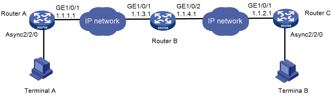

TCP or UDP one-to-one transparent transmission
Figure 1 shows a typical network diagram for the one-to-one transparent transmission. Router A initiates a monitoring request to access the data on the monitored terminal. Router B receives the monitoring request and sends the data of the monitored terminal to Router A. TCP RTC transparent transmission can ensure high reliability of the data transmitted, but it has a certain forwarding delay. Because voice service does not require high reliability, the UDP RTC transparent transmission is mainly applied to voice transmission.
Figure 1 Network diagram

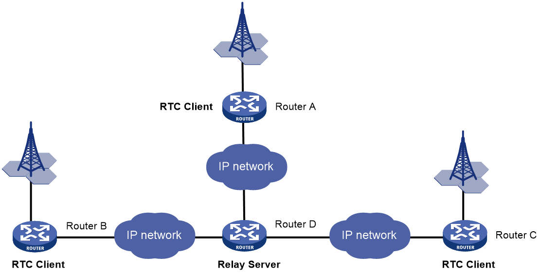

TCP many-to-one transparent transmission
Some terminal devices, such as radars, need to share data with one another. RTC terminal access provides many-to-one relay forwarding based on TCP. Routers connecting these terminals are connected to one relay server, which forwards data received from a router to other routers in the same group.
Figure 2 Network diagram

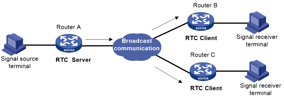

UDP one-to-many transparent transmission
UDP one-to-many transparent transmission is mainly applied to signal synchronization for unidirectional broadcast communication links. Figure 3 shows a typical network diagram for this type of transmission.
The UDP one-to-many transparent transmission procedure takes the following steps:
1.     The signal source terminal sends data.
2.     The RTC server sends the data to all RTC clients.
3.     The RTC clients forward the data to the signal receiver terminals and do not respond to the RTC server.
Figure 3 Network diagram

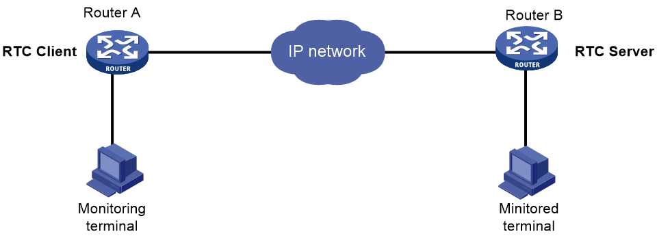

RTC terminal access configuration examples
Example: Configuring asynchronous TCP RTC one-to-one
As shown in Figure 4, the RTC client and the RTC server are connected to the central terminal device and the remote terminal device through Async 2/2/0.
Configure the RTC client and the RTC server to enable the central terminal to monitor the remote terminal:
·     Set the listening number of the RTC server to 9000.
·     Set the terminal number to 1 on both the RTC client and the RTC server.
Figure 4 Network diagram
1.     Configure the RTC server:
# Enable terminal access.
<Sysname> system-view
[Sysname] rta server enable
# Set the listening port of the server.
[Sysname] rta rtc-server listen-port 9000
# Create a terminal template and enter terminal template view.
[Sysname] rta template rtcserver
# Configure the VTY.
[Sysname-rta-template-rtcserver] vty 0 rtc-server remote 10.111.0.12 1
[Sysname-rta-template-rtcserver] vty 0 password simple 123
[Sysname-rta-template-rtcserver] quit
# Apply the template to the interface.
[Sysname] interface async 2/2/0
[Sysname-Async2/2/0] async mode flow
[Sysname-Async2/2/0] rta terminal rtcserver 1
[Sysname-Async2/2/0] quit

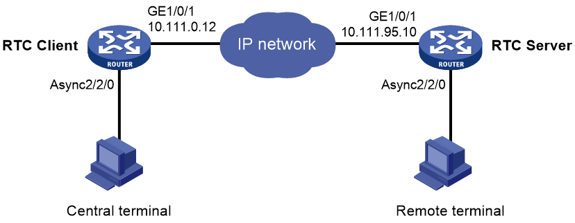

Example: Configuring synchronous TCP RTC one-to-one
As shown in Figure 5, the RTC client and the RTC server are connected to the central terminal device and the remote terminal device through synchronous serial interface Serial 2/2/0.
Figure 5 Network diagram
[Sysname] interface serial 2/2/0
[Sysname-Serial2/2/0] link-protocol stlp
[Sysname-Serial2/2/0] rta terminal rtcserver 1
[Sysname-Serial2/2/0] quit

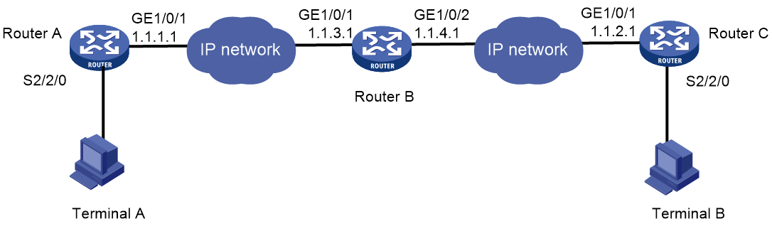

Example: Configuring synchronous TCP RTC many-to-one relay
As shown in Figure 8, Router A and Router C act as TCP_11_Clients and Router B acts as the relay server TCP_N1_Server. The TCP_11_Clients are connected to the terminal devices through synchronous serial interface Serial 2/2/0.
Configure the TCP_11_Clients and TCP_N1_Server to enable Terminal A and Terminal B to share data:
·     Set the RTC listening number to 2000.
·     Set the terminal number to 1 on both Router A and the Router C.
Figure 8 Network diagram
1.     Configure TCP_11_Client Router A:
[Sysname] rta template rtcclient
[Sysname-rta-template-rtcclient] vty 0 rtc-client remote 1.1.3.1 2000
[Sysname-rta-template-rtcclient] quit
[Sysname-Serial2/2/0] rta terminal rtcclient 1
2.     Configure TCP_11_Client Router C:
[Sysname-rta-template-rtcclient] vty 0 rtc-client remote 1.1.4.1 2000
3.     Configure the relay server Router B:
# Enable terminal access relay.
[Sysname] rta relay enable
# Configure a listening port.
[Sysname] rta relay listen-port 2000
# Check that Terminal A and Terminal B can receive data from each other.
Example: Configuring UDP RTC one-to-one backup link
As shown in Figure 9, Router A acts as a UDP_11_Client, and Router B acts as a UDP_11_Server. Router A is connected to Terminal A through synchronous serial interface Serial 2/1/0 and Terminal B through synchronous serial interface Serial 2/1/1.
Configure the UDP RTC backup link function on the routers to enable Terminal A and its backup terminal B to monitor the remote terminal C:
·     Configure Serial 2/1/0 as the primary interface and Serial 2/1/1 as the backup interface.
·     Configure the RTC server to use a UDP port number of 3000 and the RTC client to use a UDP port number of 3001.
·     Set the same terminal number to 1 on both the RTC client and the RTC server.
Figure 9 Network diagram
1.     Configure the UDP_11_Client Router A:
[Sysname-rta-template-rtcclient] vty 0 rtc-client remote 10.111.21.13 remote-port 3000 udp local-port 3001 source 10.111.0.12
# Apply the template to the primary interface.
[Sysname] interface serial 2/1/0
[Sysname-Serial2/1/0] link-protocol stlp
[Sysname-Serial2/1/0] rta terminal rtcclient 1
[Sysname-Serial2/1/0] quit
# Apply the template to the backup interface.
[Sysname] interface serial 2/1/1
[Sysname-Serial2/1/1] link-protocol stlp
[Sysname-Serial2/1/1] rta terminal rtcclient 1 backup
[Sysname-Serial2/1/1] quit
2.     Configure the UDP_11_Server Router B:
[Sysname-rta-template-rtcserver] vty 0 rtc-server remote 10.111.0.12 remote-port 3001 udp local-port 3000 source 10.111.21.13
[Sysname-Serial2/1/0] rta terminal rtcserver 1
To verify the backup link function, follow these steps:
1.     Send a connection request from Terminal A and Terminal B to Terminal C when both Serial 2/1/0 and Serial 2/1/1 on Router A are in up state.
Expected result: Terminal A can receive data from Terminal C. Terminal B cannot receive data from Terminal C.
2.     Shut down Serial 2/1/0 on Router A and send a connection request from Terminal A and Terminal B.
Expected result: Terminal A cannot receive data from Terminal C. Terminal B can receive data from Terminal C.
3.     Bring up Serial 2/1/0 on router A and send a connection request from Terminal A and Terminal B.
Example: Configuring UDP RTC one-to-many
As shown in Figure 10, Router A and Router C act as UDP_11_Clients, and Router B acts as a UDP_1N_Server.
Configure Router A, Router B, and Router C to enable both Terminal A and Terminal C to receive data from Terminal B:
Figure 10 Network diagram
2.     Configure the UDP_11_Client Router C:
[Sysname-rta-template-rtcclient] vty 0 rtc-client remote 10.111.21.13 remote-port 3000 udp local-port 3001 source 10.111.33.12
[Sysname] interface Serial 2/1/0
3.     Configure the UDP_1N_Server (Router B):
[Sysname-rta-template-rtcserver] vty 0 rtc-multipeer 10.111.21.13 3000
# Configure the IP addresses and port numbers of the two initiators.
[Sysname-rta-template-rtcserver] rtc-multipeer 0 remote 10.111.0.12 3001
[Sysname-rta-template-rtcserver] rtc-multipeer 0 remote 10.111.33.12 3001
# Send data from Terminal B to Terminal A and Terminal C.
# Check that both Terminal A and Terminal C can receive the data.
