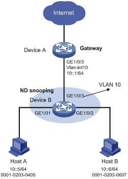

ND attack detection configuration example
Network requirements
As shown in Figure 1, configure ND attack detection on Device B to check user validity for ND messages from Host A and Host B.
Figure 1 Network diagram
Configuration procedure
1.      Configure Device A:
# Create VLAN 10.
<DeviceA> system-view
[DeviceA] vlan 10
[DeviceA-vlan10] quit
# Configure GigabitEthernet 1/0/3 to trunk VLAN 10.
[DeviceA] interface gigabitethernet 1/0/3
[DeviceA-GigabitEthernet1/0/3] port link-type trunk
[DeviceA-GigabitEthernet1/0/3] port trunk permit vlan 10
[DeviceA-GigabitEthernet1/0/3] quit
# Assign IPv6 address 10::1/64 to VLAN-interface 10.
[DeviceA] interface vlan-interface 10
[DeviceA-Vlan-interface10] ipv6 address 10::1/64
[DeviceA-Vlan-interface10] quit
2.      Configure Device B:
# Create VLAN 10.
<DeviceB> system-view
[DeviceB] vlan 10
[DeviceB-vlan10] quit
# Configure GigabitEthernet 1/0/1, GigabitEthernet 1/0/2, and GigabitEthernet 1/0/3 to trunk VLAN 10.
[DeviceB-GigabitEthernet1/0/1] port link-type access
[DeviceB-GigabitEthernet1/0/1] port access vlan 10
[DeviceB-GigabitEthernet1/0/1] quit
[DeviceB] interface gigabitethernet 1/0/2
[DeviceB-GigabitEthernet1/0/2] port link-type access
[DeviceB-GigabitEthernet1/0/2] port access vlan 10
[DeviceB-GigabitEthernet1/0/2] quit
[DeviceB] interface gigabitethernet 1/0/3
[DeviceB-GigabitEthernet1/0/3] port link-type trunk
[DeviceB-GigabitEthernet1/0/3] port trunk permit vlan 10
[DeviceB-GigabitEthernet1/0/3] quit
# Enable ND attack detection for VLAN 10.
[DeviceB] vlan 10
[DeviceB-vlan10] ipv6 nd detection enable
# Enable ND snooping for IPv6 global unicast addresses and ND snooping for IPv6 link-local addresses in VLAN 10.
[DeviceB-vlan10] ipv6 nd snooping enable global
[DeviceB-vlan10] ipv6 nd snooping enable link-local
# Configure GigabitEthernet 1/0/3 as ND trusted interface.
[DeviceB-GigabitEthernet1/0/3] ipv6 nd detection trust
The configuration allows Device B to inspect all ND messages received by GigabitEthernet 1/0/1 and GigabitEthernet 1/0/2 based on the ND snooping entries.

RA guard configuration example
As shown in Figure 2, GigabitEthernet 1/0/1, GigabitEthernet 1/0/2, and GigabitEthernet 1/0/3 of Device B are in VLAN 10.
Configure RA guard on Device B to filter forged and unwanted RA messages.
·           Configure an RA policy in VLAN 10 for GigabitEthernet 1/0/2 to filter all RA messages received from the unknown device.
·           Specify host as the role of the host. All RA messages received on GigabitEthernet 1/0/1 are dropped.
·           Specify router as the role of the Device A. All RA messages received on GigabitEthernet 1/0/3 are forwarded.
Figure 2 Network diagram
# Create an RA guard policy named policy1.
[DeviceB] ipv6 nd raguard policy policy1
# Set the maximum router preference to high for the RA guard policy.
[DeviceB-raguard-policy-policy1] if-match router-preference maximum high
# Specify on as the M flag match criterion for the RA guard policy.
[DeviceB-raguard-policy-policy1] if-match autoconfig managed-address-flag on
# Specify on as the O flag match criterion for the RA guard policy.
[DeviceB-raguard-policy-policy1] if-match autoconfig other-flag on
# Set the maximum advertised hop limit to 120 for the RA guard policy.
[DeviceB-raguard-policy-policy1] if-match hop-limit maximum 120
# Set the minimum advertised hop limit to 100 for the RA guard policy.
[DeviceB-raguard-policy-policy1] if-match hop-limit minimum 100
[DeviceB-raguard-policy-policy1] quit
# Assign GigabitEthernet 1/0/1 and GigabitEthernet 1/0/2 to VLAN 10.
# Apply the RA guard policy policy1 to VLAN 10.
[DeviceB] vlan 10
[DeviceB-vlan10] ipv6 nd raguard apply policy policy1
# Specify host as the role of the device attached to GigabitEthernet 1/0/1.
[DeviceB-GigabitEthernet1/0/1] ipv6 nd raguard role host
# Specify router as the role of the device attached to GigabitEthernet 1/0/3.
[DeviceB-GigabitEthernet1/0/3] ipv6 nd raguard role router
# Verify that the device forwards or drops RA messages received on GigabitEthernet 1/0/2 based on the RA guard policy. (Details not shown.)
# Verify that the device drops RA messages received on GigabitEthernet 1/0/1. (Details not shown.)
# Verify that the device forwards RA messages received on GigabitEthernet 1/0/3 to other ports in VLAN 10. (Details not shown.)
