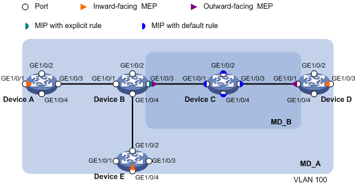

Figure 3 demonstrates a grading example of the CFD module. Four levels of MDs (0, 2, 3, and 5) are designed. The bigger the number, the higher the level and the larger the area covered. MPs are configured on the ports of Device A through Device F. Port 1 of Device B is configured with the following MPs:
·     A level 5 MIP.
·     A level 3 inward-facing MEP.
·     A level 2 inward-facing MEP.
·     A level 0 outward-facing MEP.
Figure 3 CFD grading example

CFD configuration example
Network requirements
As shown in Figure 4:
·     The network comprises five devices and is divided into two MDs: MD_A (level 5) and MD_B (level 3). All ports belong to VLAN 100, and the MAs in the two MDs all serve VLAN 100. Assume that the MAC addresses of Device A through Device E are 0010-FC01-6511, 0010-FC02-6512, 0010-FC03-6513, 0010-FC04-6514, and 0010-FC05-6515, respectively.
·     MD_A has three edge ports: GigabitEthernet 1/0/1 on Device A, GigabitEthernet 1/0/3 on Device D, and GigabitEthernet 1/0/4 on Device E. They are all inward-facing MEPs. MD_B has two edge ports: GigabitEthernet 1/0/3 on Device B and GigabitEthernet 1/0/1 on Device D. They are both outward-facing MEPs.
·     In MD_A, Device B is designed to have MIPs when its port is configured with low level MEPs. Port GigabitEthernet 1/0/3 is configured with MEPs of MD_B, and the MIPs of MD_A can be configured on this port. You must configure the MIP generation rule of MD_A as explicit.
·     The MIPs of MD_B are designed on Device C, and are configured on all ports. You must configure the MIP generation rule as default.
·     Configure CC to monitor the connectivity among all the MEPs in MD_A and MD_B. Configure LB to locate link faults, and use the AIS and EAIS functions to suppress the error alarms that are reported.
·     After the status information of the entire network is obtained, use LT, LM, one-way DM, two-way DM, and TST to detect link faults.
Figure 4 Network diagram

1.     Configure a VLAN and assign ports to it:
On each device shown in Figure 4, create VLAN 100 and assign ports GigabitEthernet 1/0/1 through GigabitEthernet 1/0/4 to VLAN 100.
2.     Enable CFD:
# Enable CFD on Device A.
<DeviceA> system-view
[DeviceA] cfd enable
# Configure Device B through Device E in the same way Device A is configured. (Details not shown.)
3.     Configure Ethernet service instances:
# Create MD_A (level 5) on Device A, and create Ethernet service instance 1 (in which the MA is identified by a VLAN and serves VLAN 100).
[DeviceA] cfd md MD_A level 5
[DeviceA] cfd service-instance 1 ma-id vlan-based md MD_A vlan 100
# Configure Device E in the same way Device A is configured. (Details not shown.)
# Create MD_A (level 5) on Device B, and create Ethernet service instance 1 (in which the MA is identified by a VLAN and serves VLAN 100).
[DeviceB] cfd md MD_A level 5
[DeviceB] cfd service-instance 1 ma-id vlan-based md MD_A vlan 100
# Create MD_B (level 3), and create Ethernet service instance 2 (in which the MA is identified by a VLAN and serves VLAN 100).
[DeviceB] cfd md MD_B level 3
[DeviceB] cfd service-instance 2 ma-id vlan-based md MD_B vlan 100
# Configure Device D in the same way Device B is configured. (Details not shown.)
# Create MD_B (level 3) on Device C, and create Ethernet service instance 2 (in which the MA is identified by a VLAN and serves VLAN 100).
[DeviceC] cfd md MD_B level 3
[DeviceC] cfd service-instance 2 ma-id vlan-based md MD_B vlan 100
4.     Configure MEPs:
# On Device A, configure a MEP list in Ethernet service instance 1, and create inward-facing MEP 1001 in Ethernet service instance 1 on GigabitEthernet 1/0/1.
[DeviceA] cfd meplist 1001 4002 5001 service-instance 1
[DeviceA-GigabitEthernet1/0/1] cfd mep 1001 service-instance 1 inbound
[DeviceA-GigabitEthernet1/0/1] quit
# On Device B, configure a MEP list in Ethernet service instances 1 and 2.
[DeviceB] cfd meplist 1001 4002 5001 service-instance 1
[DeviceB] cfd meplist 2001 4001 service-instance 2
# Create outward-facing MEP 2001 in Ethernet service instance 2 on GigabitEthernet 1/0/3.
[DeviceB] interface gigabitethernet 1/0/3
[DeviceB-GigabitEthernet1/0/3] cfd mep 2001 service-instance 2 outbound
[DeviceB-GigabitEthernet1/0/3] quit
# On Device D, configure a MEP list in Ethernet service instances 1 and 2.
[DeviceD] cfd meplist 1001 4002 5001 service-instance 1
[DeviceD] cfd meplist 2001 4001 service-instance 2
# Create outward-facing MEP 4001 in Ethernet service instance 2 on GigabitEthernet 1/0/1.
[DeviceD] interface gigabitethernet 1/0/1
[DeviceD-GigabitEthernet1/0/1] cfd mep 4001 service-instance 2 outbound
[DeviceD-GigabitEthernet1/0/1] quit
# Create inward-facing MEP 4002 in Ethernet service instance 1 on GigabitEthernet 1/0/3.
[DeviceD] interface gigabitethernet 1/0/3
[DeviceD-GigabitEthernet1/0/3] cfd mep 4002 service-instance 1 inbound
[DeviceD-GigabitEthernet1/0/3] quit
# On Device E, configure a MEP list in Ethernet service instance 1.
[DeviceE] cfd meplist 1001 4002 5001 service-instance 1
# Create inward-facing MEP 5001 in Ethernet service instance 1 on GigabitEthernet 1/0/4.
[DeviceE] interface gigabitethernet 1/0/4
[DeviceE-GigabitEthernet1/0/4] cfd mep 5001 service-instance 1 inbound
[DeviceE-GigabitEthernet1/0/4] quit
5.     Configure MIPs:
# Configure the MIP generation rule in Ethernet service instance 1 on Device B as explicit.
[DeviceB] cfd mip-rule explicit service-instance 1
# Configure the MIP generation rule in Ethernet service instance 2 on Device C as default.
[DeviceC] cfd mip-rule default service-instance 2
6.     Configure CC:
# On Device A, enable the sending of CCM frames for MEP 1001 in Ethernet service instance 1 on GigabitEthernet 1/0/1.
[DeviceA-GigabitEthernet1/0/1] cfd cc service-instance 1 mep 1001 enable
# On Device B, enable the sending of CCM frames for MEP 2001 in Ethernet service instance 2 on GigabitEthernet 1/0/3.
[DeviceB-GigabitEthernet1/0/3] cfd cc service-instance 2 mep 2001 enable
# On Device D, enable the sending of CCM frames for MEP 4001 in Ethernet service instance 2 on GigabitEthernet 1/0/1.
[DeviceD-GigabitEthernet1/0/1] cfd cc service-instance 2 mep 4001 enable
# Enable the sending of CCM frames for MEP 4002 in Ethernet service instance 1 on GigabitEthernet 1/0/3.
[DeviceD-GigabitEthernet1/0/3] cfd cc service-instance 1 mep 4002 enable
# On Device E, enable the sending of CCM frames for MEP 5001 in Ethernet service instance 1 on GigabitEthernet 1/0/4.
[DeviceE-GigabitEthernet1/0/4] cfd cc service-instance 1 mep 5001 enable
7.     Configure AIS:
# Enable AIS on Device B. Configure the AIS frame transmission level as 5 and AIS frame transmission interval as 1 second in Ethernet service instance 2.
[DeviceB] cfd ais enable
[DeviceB] cfd ais level 5 service-instance 2
[DeviceB] cfd ais period 1 service-instance 2
8.     Configure EAIS:
# Enable port status-AIS collaboration on Device B.
[DeviceB] cfd ais-track link-status global
# On GigabitEthernet 1/0/3 of Device B, configure the EAIS frame transmission level as 5 and the EAIS frame transmission interval as 60 seconds. Specify the VLANs where the EAIS frames can be transmitted as VLAN 100.
[DeviceB-GigabitEthernet1/0/3] cfd ais-track link-status level 5
[DeviceB-GigabitEthernet1/0/3] cfd ais-track link-status period 60
[DeviceB-GigabitEthernet1/0/3] cfd ais-track link-status vlan 100
