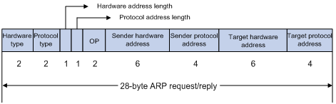

ARP message format
ARP uses two types of messages: ARP request and ARP reply. Figure 1 shows the format of ARP request/reply messages. Numbers in the figure refer to field lengths.
Figure 1 ARP message format
·     Hardware type—Hardware address type. The value 1 represents Ethernet.
·     Protocol type—Type of the protocol address to be mapped. The hexadecimal value 0x0800 represents IP.
·     Hardware address length and protocol address length—Length, in bytes, of a hardware address and a protocol address. For an Ethernet address, the value of the hardware address length field is 6. For an IPv4 address, the value of the protocol address length field is 4.
·     OP—Operation code, which describes the type of ARP message. The value 1 represents an ARP request, and the value 2 represents an ARP reply.
·     Sender hardware address—Hardware address of the device sending the message.
·     Sender protocol address—Protocol address of the device sending the message.
·     Target hardware address—Hardware address of the device to which the message is being sent.
·     Target protocol address—Protocol address of the device to which the message is being sent.

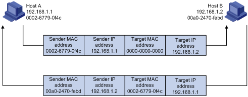

ARP operating mechanism
As shown in Figure 2, Host A and Host B are on the same subnet. Host A sends a packet to Host B as follows:
1.     Host A looks through the ARP table for an ARP entry for Host B. If one entry is found, Host A uses the MAC address in the entry to encapsulate the IP packet into a data link layer frame. Then Host A sends the frame to Host B.
2.     If Host A finds no entry for Host B, Host A buffers the packet and broadcasts an ARP request. The payload of the ARP request contains the following information:
¡     Sender IP address and sender MAC address—Host A's IP address and MAC address.
¡     Target IP address—Host B's IP address.
¡     Target MAC address—An all-zero MAC address.
All hosts on this subnet can receive the broadcast request, but only the requested host (Host B) processes the request.
3.     Host B compares its own IP address with the target IP address in the ARP request. If they are the same, Host B operates as follows:
a.     Adds the sender IP address and sender MAC address into its ARP table.
b.     Encapsulates its MAC address into an ARP reply.
c.     Unicasts the ARP reply to Host A.
4.     After receiving the ARP reply, Host A operates as follows:
a.     Adds the MAC address of Host B into its ARP table.
b.     Encapsulates the MAC address into the packet and sends the packet to Host B.
Figure 2 ARP address resolution process

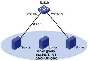

·     Multiport ARP entry—It contains the IP address, MAC address, and VLAN.
The device can use a multiport ARP entry that has the same MAC address and VLAN as a multicast or multiport unicast MAC address entry for packet forwarding. A multiport ARP entry is manually configured. It does not age out and cannot be overwritten by any dynamic ARP entry. For more information about multicast MAC, see IP Multicast Configuration Guide.
To communicate with a host by using a fixed IP-to-MAC mapping, configure a short static ARP entry on the device. To communicate with a host by using a fixed IP-to-MAC mapping through an interface in a VLAN, configure a long static ARP entry on the device.

A multiport ARP entry contains an IP address, MAC address, and VLAN ID. To make the multiport ARP entry effective for packet forwarding, you must configure a multicast or multiport unicast MAC address entry to specify multiple output interfaces. The output interfaces cannot contain aggregate interfaces. The MAC address entry must have the same MAC address and VLAN ID as the multiport ARP entry. In addition, the IP address in the multiport ARP entry must reside on the same subnet as the VLAN interface of the specified VLAN.
A multiport ARP entry can overwrite a dynamic, short static or long static ARP entry. Conversely, a short static or long static ARP entry can overwrite a multiport ARP entry.
To configure a multiport ARP entry:
Step
Remarks
N/A
2.     Configure a multicast or multiport unicast MAC address entry.
·     Configure a multiport unicast MAC address entry:
mac-address multiport
mac-address interface interface-list vlan vlan-id
·     Configure a multicast MAC address entry:
mac-address multicast mac-address interface interface-list vlan vlan-id
By default, no multicast or multiport unicast MAC address entries are configured.
For more information about the mac-address multiport command, see Layer 2—LAN Switching Command Reference. For more information about the mac-address multicast command, see IP Multicast Command Reference.
3.     Configure a multiport ARP entry.
arp multiport ip-address mac-address vlan-id [ vpn-instance vpn-instance-name ]
By default, no multiport ARP entries are configured.

Multiport ARP entry configuration example
Network requirements
As shown in Figure 5, a switch connects to three servers through interfaces Ten-GigabitEthernet 1/1/1, Ten-GigabitEthernet 1/1/2, and Ten-GigabitEthernet 1/1/3 in VLAN 10. The servers share the IP address 192.168.1.1/24 and MAC address 00e0-fc01-0000.
Configure a multiport ARP entry so that the switch sends IP packets with the destination IP address 192.168.1.1 to the three servers.
Figure 5 Network diagram
Configuration procedure
# Create VLAN 10.
<Switch> system-view
[Switch] vlan 10
[Switch-vlan10] quit
# Add Ten-GigabitEthernet 1/1/1, Ten-GigabitEthernet 1/1/2, and Ten-GigabitEthernet 1/1/3 to VLAN 10.
[Switch] interface ten-gigabitethernet 1/1/1
[Switch-Ten-GigabitEthernet1/1/1] port access vlan 10
[Switch-Ten-GigabitEthernet1/1/1] quit
[Switch] interface ten-gigabitethernet 1/1/2
[Switch-Ten-GigabitEthernet1/1/2] port access vlan 10
[Switch-Ten-GigabitEthernet1/1/2] quit
[Switch] interface ten-gigabitethernet 1/1/3
[Switch-Ten-GigabitEthernet1/1/3] port access vlan 10
[Switch-Ten-GigabitEthernet1/1/3] quit
# Create VLAN-interface 10 and specify its IP address.
[Switch] interface vlan-interface 10
[Switch-vlan-interface10] ip address 192.168.1.2 24
[Switch-vlan-interface10] quit
# Configure a multiport unicast MAC address entry that has MAC address 00e0-fc01-0000, and output interfaces Ten-GigabitEthernet 1/1/1, Ten-GigabitEthernet 1/1/2, and Ten-GigabitEthernet 1/1/3 in VLAN 10.
[Switch] mac-address multiport 00e0-fc01-0000 interface ten-gigabitethernet 1/1/1 to ten-gigabitethernet 1/1/3 vlan 10
# Configure a multiport ARP entry with IP address 192.168.1.1 and MAC address 00e0-fc01-0000.
[Switch] arp multiport 192.168.1.1 00e0-fc01-0000 10
# Verify that the switch has a multiport ARP entry with IP address 192.168.1.1 and MAC address 00e0-fc01-0000.
[Switch] display arp
  Type: S-Static   D-Dynamic   O-Openflow   M-Multiport  I-Invalid
IP address       MAC address     VLAN     Interface              Aging Type
192.168.1.1      00e0-fc01-0000  10       N/A                    N/A   M

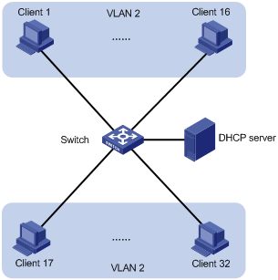

ARP fast-reply configuration example
As shown in Figure 7, all clients are in VLAN 2, and access the network through the switch. They have obtained IP addresses through DHCP.
Enable ARP snooping and ARP fast-reply for VLAN 2. The switch directly returns an ARP reply without broadcasting received ARP requests in the VLAN.
Figure 7 Network diagram
# Enable ARP snooping for VLAN 2 on the switch.
[Switch] vlan 2
[Switch-vlan2] arp snooping enable
# Enable ARP fast-reply for VLAN 2 on the switch.
[Switch-vlan2] arp fast-reply enable
[Switch-vlan2] quit
