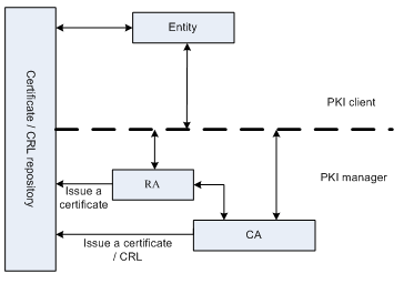

A PKI system consists of entities, a CA, a registration authority (RA) and a PKI repository, as shown in Figure 1-1.
Figure 1-1 PKI architecture
Entity
An entity is an end user of PKI products or services, such as a person, an organization, a device like a switch, or a process running on a computer.
CA
A CA is a trusted entity responsible for issuing and managing digital certificates. A CA issues certificates, specifies the validity period of a certificate, and revokes a certificate as needed by publishing CRLs.
RA
A registration authority (RA) is an extended part of a CA or an independent authority. An RA can implement functions including identity authentication, CRL management, key pair generation and key pair backup. The PKI standard recommends that an independent RA be used for registration management to achieve higher security of application systems.
PKI repository
A PKI repository includes a Lightweight Directory Access Protocol (LDAP) server and some common databases that stores and manages information like certificate requests, certificates, keys, CRLs and logs while providing a simple query function.
LDAP is a protocol for accessing and managing PKI information. An LDAP server stores user information and digital certificates from the RA server and provides directory navigation service. From an LDAP server, an entity can retrieve local and CA certificates of its own as well as certificates of other entities.

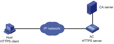

Configuring a Certificate Attribute-Based Access Control Policy
Network requirements
l          The client accesses the remote HTTPS server through the HTTP Security (HTTPS) protocol.
l          SSL is configured to ensure that only legal clients log into the HTTPS server.
l          Create a certificate attribute-based access control policy to control access to the HTTPS server.
Networking diagram
Figure 1-3 Diagram for configuring a certificate attribute-based access control policy
Configuration procedure
l          For detailed information about SSL configuration, refer to SSL-HTTPS in H3C WX6103 Access Controller Switch Interface Board Configuration Guide.
l          For detailed information about HTTPS configuration, refer to SSL-HTTPS in H3C WX6103 Access Controller Switch Interface Board Configuration Guide.
l          The PKI domain to be referenced by the SSL policy must be created in advance. For detailed configuration of the PKI domain, refer to Configure the PKI domain.
1)        Configure the HTTPS server
# Configure the SSL policy for the HTTPS server to use.
<AC> system-view
[AC] ssl server-policy myssl
[AC-ssl-server-policy-myssl] pki-domain 1
[AC-ssl-server-policy-myssl] client-verify enable
[AC-ssl-server-policy-myssl] quit
2)        Configure the certificate attribute group
# Create certificate attribute group mygroup1 and add two attribute rules. The first rule defines that the DN of the subject name includes the string aabbcc, and the second rule defines that the IP address of the certificate issuer is 10.0.0.1.
[AC] pki certificate attribute-group mygroup1
[AC-pki-cert-attribute-group-mygroup1] attribute 1 subject-name dn ctn aabbcc
[AC-pki-cert-attribute-group-mygroup1] attribute 2 issuer-name ip equ 10.0.0.1
[AC-pki-cert-attribute-group-mygroup1] quit
# Create certificate attribute group mygroup2 and add two attribute rules. The first rule defines that the FQDN of the alternative subject name does not include the string of apple, and the second rule defines that the DN of the certificate issuer name includes the string aabbcc.
[AC] pki certificate attribute-group mygroup2
[AC-pki-cert-attribute-group-mygroup2] attribute 1 alt-subject-name fqdn nctn apple
[AC-pki-cert-attribute-group-mygroup2] attribute 2 issuer-name dn ctn aabbcc
[AC-pki-cert-attribute-group-mygroup2] quit
3)        Configure the certificate attribute-based access control policy
# Create the certificate attribute-based access control policy of myacp and add two access control rules.
[AC] pki certificate access-control-policy myacp
[AC-pki-cert-acp-myacp] rule 1 deny mygroup1
[AC-pki-cert-acp-myacp] rule 2 permit mygroup2
[AC-pki-cert-acp-myacp] quit
4)        Apply the SSL server policy and certificate attribute-based access control policy to HTTPS service and enable HTTPS service.
# Apply SSL server policy myssl to HTTPS service.
[AC] ip https ssl-server-policy myssl
# Apply the certificate attribute-based access control policy of myacp to HTTPS service.
[AC] ip https certificate access-control-policy myacp
# Enable HTTPS service.
[AC] ip https enable
