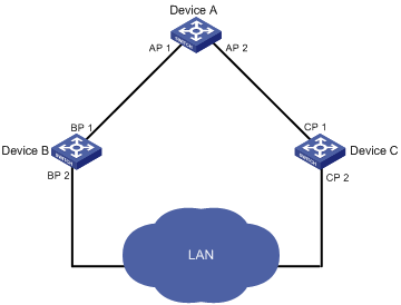

The following is an example of how the STP algorithm works. The specific network diagram is shown in Figure 1-2. In the feature, the priority of Device A is 0, the priority of Device B is 1, the priority of Device C is 2, and the path costs of these links are 5, 10 and 4 respectively.
Figure 1-2 Network diagram for the STP algorithm
l          Initial state of each device
The following table shows the initial state of each device.
Table 1-4 Initial state of each device
Device
Port name
BPDU of port
Device A
AP1
{0, 0, 0, AP1}
AP2
{0, 0, 0, AP2}
Device B
BP1
{1, 0, 1, BP1}
BP2
{1, 0, 1, BP2}
Device C
CP1
{2, 0, 2, CP1}
CP2
{2, 0, 2, CP2}
l          Comparison process and result on each device
The following table shows the comparison process and result on each device.
Table 1-5 Comparison process and result on each device
Device
Comparison process
BPDU of port after comparison
Device A
l      Port AP1 receives the configuration BPDU of Device B {1, 0, 1, BP1}. Device A finds that the configuration BPDU of the local port {0, 0, 0, AP1} is superior to the configuration received message, and discards the received configuration BPDU.
l      Port AP2 receives the configuration BPDU of Device C {2, 0, 2, CP1}. Device A finds that the BPDU of the local port {0, 0, 0, AP2} is superior to the received configuration BPDU, and discards the received configuration BPDU.
l      Device A finds that both the root bridge and designated bridge in the configuration BPDUs of all its ports are Device A itself, so it assumes itself to be the root bridge. In this case, it does not make any change to the configuration BPDU of each port, and starts sending out configuration BPDUs periodically.
AP1: {0, 0, 0, AP1}
AP2: {0, 0, 0, AP2}
Device B
l      Port BP1 receives the configuration BPDU of Device A {0, 0, 0, AP1}. Device B finds that the received configuration BPDU is superior to the configuration BPDU of the local port {1, 0, 1, BP1}, and updates the configuration BPDU of BP1.
l      Port BP2 receives the configuration BPDU of Device C {2, 0, 2, CP2}. Device B finds that the configuration BPDU of the local port {1, 0, 1, BP2} is superior to the received configuration BPDU, and discards the received configuration BPDU.
BP1: {0, 0, 0, AP1}
BP2: {1, 0, 1, BP2}
l      Device B compares the configuration BPDUs of all its ports, and determines that the configuration BPDU of BP1 is the optimum configuration BPDU. Then, it uses BP1 as the root port, the configuration BPDUs of which will not be changed.
l      Based on the configuration BPDU of BP1 and the path cost of the root port (5), Device B calculates a designated port configuration BPDU for BP2 {0, 5, 1, BP2}.
l      Device B compares the calculated configuration BPDU {0, 5, 1, BP2} with the configuration BPDU of BP2. If the calculated BPDU is superior, BP2 will act as the designated port, and the configuration BPDU on this port will be replaced with the calculated configuration BPDU, which will be sent out periodically.
Root port BP1:
{0, 0, 0, AP1}
Designated port BP2:
{0, 5, 1, BP2}
Device C
l      Port CP1 receives the configuration BPDU of Device A {0, 0, 0, AP2}. Device C finds that the received configuration BPDU is superior to the configuration BPDU of the local port {2, 0, 2, CP1}, and updates the configuration BPDU of CP1.
l      Port CP2 receives the configuration BPDU of port BP2 of Device B {1, 0, 1, BP2} before the message was updated. Device C finds that the received configuration BPDU is superior to the configuration BPDU of the local port {2, 0, 2, CP2}, and updates the configuration BPDU of CP2.
CP1: {0, 0, 0, AP2}
CP2: {1, 0, 1, BP2}
By comparison:
l      The configuration BPDU of CP1 is elected as the optimum configuration BPDU, so CP1 is identified as the root port, the configuration BPDUs of which will not be changed.
l      Device C compares the calculated designated port configuration BPDU {0, 10, 2, CP2} with the configuration BPDU of CP2, and CP2 becomes the designated port, and the configuration BPDU of this port will be replaced with the calculated configuration BPDU.
Root port CP1:
{0, 0, 0, AP2}
Designated port CP2:
{0, 10, 2, CP2}
l      Next, port CP2 receives the updated configuration BPDU of Device B {0, 5, 1, BP2}. Because the received configuration BPDU is superior to its old one, Device C launches a BPDU update process.
l      At the same time, port CP1 receives configuration BPDUs periodically from Device A. Device C does not launch an update process after comparison.
CP1: {0, 0, 0, AP2}
CP2: {0, 5, 1, BP2}
By comparison:
l      Because the root path cost of CP2 (9) (root path cost of the BPDU (5) plus path cost corresponding to CP2 (4)) is smaller than the root path cost of CP1 (10) (root path cost of the BPDU (0) + path cost corresponding to CP2 (10)), the BPDU of CP2 is elected as the optimum BPDU, and CP2 is elected as the root port, the messages of which will not be changed.
l      After comparison between the configuration BPDU of CP1 and the calculated designated port configuration BPDU, port CP1 is blocked, with the configuration BPDU of the port remaining unchanged, and the port will not receive data from Device A until a spanning tree calculation process is triggered by a new condition, for example, the link from Device B to Device C becomes down.
Blocked port CP2:
{0, 0, 0, AP2}
Root port CP2:
{0, 5, 1, BP2}

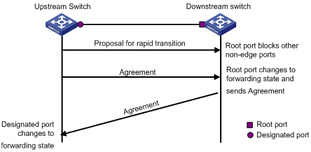

The rapid spanning tree protocol (RSTP) is an optimized version of STP. RSTP allows a newly elected root port or designated port to enter the forwarding state much quicker under certain conditions than in STP. As a result, it takes a shorter time for the network to reach the final topology stability.
l          In RSTP, a newly elected root port can enter the forwarding state rapidly if this condition is met: The old root port on the device has stopped forwarding data and the upstream designated port has started forwarding data.
l          In RSTP, a newly elected designated port can enter the forwarding state rapidly if this condition is met: The designated port is an edge port or a port connected with a point-to-point link. If the designated port is an edge port, it can enter the forwarding state directly; if the designated port is connected with a point-to-point link, it can enter the forwarding state immediately after the device undergoes handshake with the downstream device and gets a response.

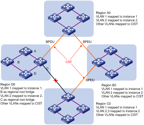

Assume that all the four switches in Figure 1-4 are running MSTP. In light with the diagram, the following paragraphs will present some basic concepts of MSTP.
Figure 1-4 Basic concepts in MSTP
1)        MST region
A multiple spanning tree region (MST region) is composed of multiple devices in a switched network and network segments among them. These devices have the following characteristics:
l          All are MSTP-enabled,
l          They have the same region name,
l          They have the same VLAN-to-instance mapping configuration,
l          They have the same MSTP revision level configuration, and
l          They are physically linked with one another.
For example, all the devices in region A0 in Figure 1-4 have the same MST region configuration:
l          The same region name,
l          The same VLAN-to-instance mapping (VLAN 1 is mapped to MST instance 1, VLAN 2 to MST instance 2, and the rest to the command and internal spanning tree (CIST). CIST refers to MST instance 0), and
l          The same MSTP revision level (not shown in the figure).
Multiple MST regions can exist in a switched network. You can use an MSTP command to group multiple devices to the same MST region.
2)        VLAN-to-instance mapping table
As an attribute of an MST region, the VLAN-to-instance mapping table describes the mapping relationships between VLANs and MST instances. In Figure 1-4, for example, the VLAN-to-instance mapping table of region A0 describes that the same region name, the same VLAN-to-instance mapping (VLAN 1 is mapped to MST instance 1, VLAN 2 to MST instance 2, and the rest to CIST). MSTP achieves load balancing by means of the VLAN-to-instance mapping table.
3)        IST
Internal spanning tree (IST) is a spanning tree that runs in an MST region.
ISTs in all MST regions and the common spanning tree (CST) jointly constitute the common and internal spanning tree (CIST) of the entire network. An IST is a section of the CIST in the given MST region.
In Figure 1-4, for example, the CIST has a section in each MST region, and this section is the IST in the respective MST region.
4)        CST
The CST is a single spanning tree that connects all MST regions in a switched network. If you regard each MST region as a “device”, the CST is a spanning tree calculated by these devices through STP or RSTP. For example, the red lines in Figure 1-4 describe the CST.
5)        CIST
Jointly constituted by ISTs and the CST, the CIST is a single spanning tree that connects all devices in a switched network.
In Figure 1-4, for example, the ISTs in all MST regions plus the inter-region CST constitute the CIST of the entire network.
6)        MSTI
Multiple spanning trees can be generated in an MST region through MSTP, one spanning tree being independent of another. Each spanning tree is referred to as a multiple spanning tree instance (MSTI). In Figure 1-4, for example, multiple spanning tree can exist in each MST region, each spanning tree corresponding to a VLAN. These spanning trees are called MSTIs.
7)        Regional root bridge
The root bridge of the IST or an MSTI within an MST region is the regional root bridge of the MST or that MSTI. Based on the topology, different spanning trees in an MST region may have different regional roots.
For example, in region D0 in Figure 1-4, the regional root of instance 1 is device B, while that of instance 2 is device C.
8)        Common root bridge
The common root bridge is the root bridge of the CIST.
In Figure 1-4, for example, the common root bridge is a device in region A0.

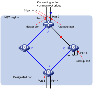

10)    Roles of ports
In the MSTP calculation process, port roles include root port, designated port, master port, alternate port, backup port, and so on.
l          Root port: a port responsible for forwarding data to the root bridge.
l          Designated port: a port responsible for forwarding data to the downstream network segment or device.
l          A master port connects an MST region to the common root. The path from the master port to the common root is the shortest path between the MST region and the common root. In the CST, the master port is the root port of the region, which is considered as a node. The master port is a special boundary port. It is a root port in the IST/CIST while a master port in the other MSTIs.
l          Alternate port: The standby port for the root port or master port. When the root port or master port is blocked, the alternate port becomes the new root port or master port.
l          Backup port: The backup port of designated ports. When a designated port is blocked, the backup port becomes a new designated port and starts forwarding data without delay. When a loop occurs while two ports of the same MSTP device are interconnected, the device will block either of the two ports, and the backup port is that port to be blocked.
A port can assume different roles in different MST instances.
Figure 1-5 Port roles
Figure 1-4 helps understand these concepts. Where,
l          Devices A, B, C, and D constitute an MST region.
l          Port 1 and port 2 of device A connect to the common root bridge.
l          Port 5 and port 6 of device C form a loop.
l          Port 3 and port 4 of device D connect downstream to other MST regions.
11)    Port states
In MSTP, port states fall into the following tree:
l          Forwarding: the port learns MAC addresses and forwards user traffic;
l          Learning: the port learns MAC addresses but does not forward user traffic;
l          Discarding: the port neither learns MAC addresses nor forwards user traffic.
When in different MST instances, a port can be in different states.
l          The role a boundary port plays in an MSTI is consistent with the role it plays in the CIST. The master port, which is a root port in the CIST while a master port in the other MSTIs, is an exception.
l          For example, in Figure 1-5, port 1 on switch A is a boundary port. It is a root port in the CIST while a master port in all the other MSTIs in the region.

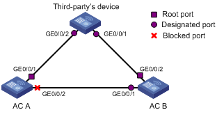

Configuration Example
Network requirements
l          AC A and AC B connect to a third-party device and all the devices are in the same region.
l          Enable Digest Snooping on AC A and AC B so that the three devices can communicate with one another.
Network diagram
Figure 1-6 Digest Snooping configuration
Configuration procedure
1)        Enable Digest Snooping on AC A
# Enable Digest Snooping on GigabitEthernet 0/0/1.
<AC A> system-view
[AC A] interface GigabitEthernet 0/0/1
[AC A-GigabitEthernet0/0/1] stp config-digest-snooping
# Enable global Digest Snooping.
[AC A-GigabitEthernet0/0/1] quit
[AC A] stp config-digest-snooping
2)        Enable Digest Snooping on AC B (the same as above, omitted)

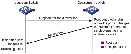

Two types of messages are used for rapid state transition on designated RSTP and MSTP ports:
l          Proposal: sent by designated ports to request rapid transition
l          Agreement: used to acknowledge rapid transition requests
Both RSTP and MSTP switches can perform rapid transition operation on a designated port only when the port receives an agreement packet from the downstream switch. The differences between RSTP and MSTP switches are:
l          For MSTP, the downstream device’s root port sends an agreement packet only after it receives an agreement packet from the upstream device.
l          For RSTP, the down stream device sends an agreement packet regardless of whether an agreement packet from the upstream device is received.
Figure 1-7 and Figure 1-8 show the rapid state transition mechanism on MSTP and RSTP designated ports.
Figure 1-7 Rapid state transition of a designated port in MSTP
Figure 1-8 Rapid state transition of a designated port in RSTP
If the upstream device comes from another vendor, the rapid state transition implementation may be limited. For example, when the upstream device adopts RSTP, the downstream device adopts MSTP and does not support RSTP mode, the root port on the downstream device receives no agreement packet from the upstream device and thus sends no agreement packets to the upstream device. As a result, the designated port of the upstream switch fails to transit rapidly and can only change to the forwarding state after a period twice the Forward Delay.
In this case, you can enable the No Agreement Check feature on the downstream device’s port to perform rapid state transition.

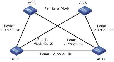

Configure MSTP so that packets of different VLANs are forwarded along different spanning trees. The specific configuration requirements are as follows:
l          All devices on the network are in the same MST region.
l          Packets of VLAN 10 are forwarded along MST region 1, those of VLAN 30 are forwarded along MST instance 3, those of VLAN 40 are forwarded along MST instance 4, and those of VLAN 20 are forwarded along MST instance 0.
l          AC A and AC B are convergence layer devices, while AC C and AC D are access layer devices. VLAN 10 and VLAN 30 are terminated on the convergence layer devices, and VLAN 40 is terminated on the access layer devices, so the root bridges of MST instance 1 and MST instance 3 are AC A and AC B respectively, while the root bridge of MST instance 4 is AC C.
Network diagram
Figure 1-10 Network diagram for MSTP configuration
“Permit:“ beside each link in the figure is followed by the VLANs the packets of which are permitted to pass this link.
1)        Configuration on AC A
# Enter MST region view.
<AC A> system-view
[AC A] stp region-configuration
# Configure the region name, VLAN-to-instance mappings and revision level of the MST region.
[AC A-mst-region] region-name example
[AC A-mst-region] instance 1 vlan 10
[AC A-mst-region] instance 3 vlan 30
[AC A-mst-region] instance 4 vlan 40
[AC A-mst-region] revision-level 0
# Activate MST region configuration manually.
[AC A-mst-region] active region-configuration
[AC A-mst-region] quit
# Define AC A as the root bridge of MST instance 1.
[AC A] stp instance 1 root primary
# View the MST region configuration information that has taken effect.
[AC A] display stp region-configuration
 Oper configuration
   Format selector    :0
   Region name        :example
   Revision level     :0
   Instance   Vlans Mapped
      0       1 to 9, 11 to 29, 31 to 39, 41 to 4094
      1       10
      3       30
      4       40
2)        Configuration on AC B
<AC B> system-view
[AC B] stp region-configuration
[AC B-mst-region] region-name example
[AC B-mst-region] instance 1 vlan 10
[AC B-mst-region] instance 3 vlan 30
[AC B-mst-region] instance 4 vlan 40
[AC B-mst-region] revision-level 0
[AC B-mst-region] active region-configuration
[AC B-mst-region] quit
# Define AC B as the root bridge of MST instance 3.
[AC B] stp instance 3 root primary
[AC B] display stp region-configuration
 Oper configuration
   Format selector    :0
   Revision level     :0
      1       10
      3       30
      4       40
3)        Configuration on AC C
<AC C> system-view
[AC C] stp region-configuration
[AC C-mst-region] region-name example
[AC C-mst-region] instance 1 vlan 10
[AC C-mst-region] instance 3 vlan 30
[AC C-mst-region] instance 4 vlan 40
[AC C-mst-region] revision-level 0
[AC C-mst-region] active region-configuration
[AC C-mst-region] quit
# Define AC C as the root bridge of MST instance 4.
[AC C] stp instance 4 root primary
[AC C] display stp region-configuration
 Oper configuration
   Format selector    :0
   Revision level     :0
      1       10
      3       30
      4       40
4)        Configuration on AC D
<AC D> system-view
[AC D] stp region-configuration
[AC D-mst-region] region-name example
[AC D-mst-region] instance 1 vlan 10
[AC D-mst-region] instance 3 vlan 30
[AC D-mst-region] instance 4 vlan 40
[AC D-mst-region] revision-level 0
[AC D-mst-region] active region-configuration
[AC D-mst-region] quit
[AC D] display stp region-configuration
 Oper configuration
   Format selector    :0
   Revision level     :0
      1       10
      3       30
      4       40
