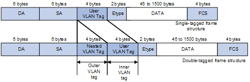

Figure 1-1 shows the structure of 802.1Q-tagged and double-tagged Ethernet frames. The QinQ feature enables a device to support up to 4,094 x 4,094 VLANs to satisfy the requirement for the amount of VLANs in the MAN.
Figure 1-1 Single-tagged frame structure vs. double-tagged Ethernet frame structure

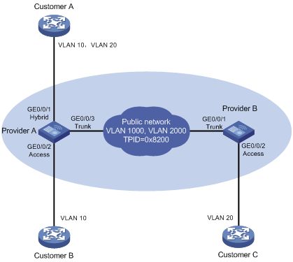

Network requirements
l          Provider A and Provider B are service provider network access devices.
l          Customer A, Customer B and Customer C are customer network access devices.
l          Provider A and Provider B are interconnected through a configured trunk port. Provider A belongs to VLAN 1000 of the service provider network, and Provider B belongs to VLAN 2000 of the service provider network.
l          Third-party devices are deployed between Provider A and Provider B, with a TPID value of 0x8200.
After configuration, the network should satisfy the following requirement:
l          Frames of VLAN 10 of Customer A and frames of VLAN 10 of Customer B can be forwarded to each other through VLAN 1000 of the provider network;
l          Frames of VLAN 20 of Customer A and frames of VLAN 20 of Customer C can be forwarded to each other through VLAN 2000 of the provider network.
Network diagram
Figure 1-3 Network diagram for QinQ configuration
Configuration procedure
With this configuration, the user can allow the QinQ packets to pass between the devices of the service providers.

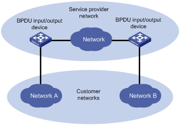

As shown in Figure 2-1, the upper part is the service provider network, and the lower part represents the customer networks. The customer networks include network A and network B. Enabling the BPDU tunneling function on the BPDU input/output devices across the service provider network allows BPDUs of the customer networks to be transparently transmitted in the service provider network, and allows each customer network to implement independent spanning tree calculation, without affecting each other. Refer to Configuring BPDU Transparent Transmission.
Figure 2-1 Network hierarchy of BPDU tunneling
l          At the BPDU input side, the device changes the destination MAC address of a BPDU from a customer network from 0x0180-C200-0000 to a special multicast MAC address, 0x010F-E200-0003 by default. In the service provider’s network, the modified BPDUs are forwarded as data packets in the user VLAN.
l          At the packet output side, the device recognizes the BPDU with the destination MAC address of 0x010F-E200-0003 and restores its original destination MAC address 0x0180-C200-0000. Then, the device removes the outer tag, and sends the BPDU to the destination customer network.
Make sure, through configuration, that the VLAN tag of the BPDU is neither changed nor removed during its transparent transmission in the service provider network; otherwise, the system will fail to transparently transmit the customer network BPDU correctly.

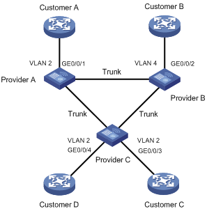

BPDU Tunneling Configuration Example
l          Customer A, Customer B, Customer C, and Customer D are customer network access devices.
l          Provider A, Provider B, and Provider C are service provider network access devices, which are interconnected through configured trunk ports.
The configuration is required to satisfy the following requirements:
l          Geographically dispersed customer network devices Customer A, Customer C and Customer D can implement consistent spanning tree calculation across the service provider network.
l          BPDU packets from Customer B are isolated so it does not take part in the spanning tree calculation.
Network diagram
Figure 2-2 Network diagram for BPDU tunneling configuration
1)        Configuration on Provider A
# Configure BPDU transparent transmission on GigabitEthernet 0/0/1.
<ProviderA> system-view
[ProviderA] interface GigabitEthernet 0/0/1
[ProviderA-GigabitEthernet0/0/1] port access vlan 2
[ProviderA-GigabitEthernet0/0/1] stp disable
[ProviderA-GigabitEthernet0/0/1] undo ntdp enable
[ProviderA-GigabitEthernet0/0/1] bpdu-tunnel dot1q enable
[ProviderA-GigabitEthernet0/0/1] bpdu-tunnel dot1q stp
2)        Configuration on Provider B
# Configure BPDU isolation on GigabitEthernet 0/0/2.
<ProviderB> system-view
[ProviderB] interface GigabitEthernet 0/0/2
[ProviderB-GigabitEthernet0/0/2] port access vlan 4
[ProviderB-GigabitEthernet0/0/2] undo ntdp enable
[ProviderB-GigabitEthernet0/0/2] bpdu-tunnel dot1q enable
3)        Configuration on Provider C
# Configure BPDU transparent transmission on GigabitEthernet 0/0/3.
<ProviderC> system-view
[ProviderC] interface GigabitEthernet 0/0/3
[ProviderC-GigabitEthernet0/0/3] port access vlan 2
[ProviderC-GigabitEthernet0/0/3] stp disable
[ProviderC-GigabitEthernet0/0/3] undo ntdp enable
[ProviderC-GigabitEthernet0/0/3] bpdu-tunnel dot1q enable
[ProviderC-GigabitEthernet0/0/3] bpdu-tunnel dot1q stp
# Configure BPDU transparent transmission on GigabitEthernet 0/0/4.
[ProviderC-GigabitEthernet0/0/3] quit
[ProviderC] interface GigabitEthernet 0/0/4
[ProviderC-GigabitEthernet0/0/4] port access vlan 2
[ProviderC-GigabitEthernet0/0/4] stp disable
[ProviderC-GigabitEthernet0/0/4] undo ntdp enable
[ProviderC-GigabitEthernet0/0/4] bpdu-tunnel dot1q enable
[ProviderC-GigabitEthernet0/0/4] bpdu-tunnel dot1q stp
When STP works stably on the customer network, if Customer A acts as the root bridge, the ports of Customer C and Customer D connected with Provider C can receive BPDUs from Customer A. Since BPDU isolation is enabled on Customer B, the port that connects Customer B to Provider B cannot receive BPDUs from Customer A.
