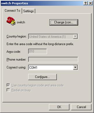

Following are configurations on PC. Take the HyperTerminal in Windows 2000 as an example.

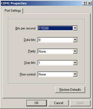

Step 4: Choose [File/Properties] in HyperTerminal, click <Configure> in the pop-up dialog box, and then select the baudrate of 115200 bps in the Console port configuration dialog box that appears, as shown in Figure 1-1, Figure 1-2.
Figure 1-1 Properties dialog box
Figure 1-2 Console port configuration dialog box
Step 5: Click the <Disconnect> button to disconnect the HyperTerminal from the switch and then click the <Connect> button to reconnect the HyperTerminal to the switch, as shown in Figure 1-3.

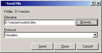

Step 7: Choose [Transfer/Send File] in HyperTerminal, and click <Browse> in pop-up dialog box, as shown in Figure 1-4. Select the software file that you need to load to the switch, and set the protocol to XModem.
Figure 1-4 Send file dialog box

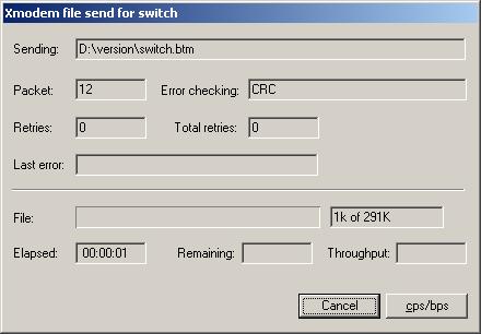

Step 8: Click <Send>. The system displays the page, as shown in Figure 1-5.
Figure 1-5 Sending file page
Step 9: After the sending process completes, the system displays the following information:
Loading ...CCCCCCCCCC done!

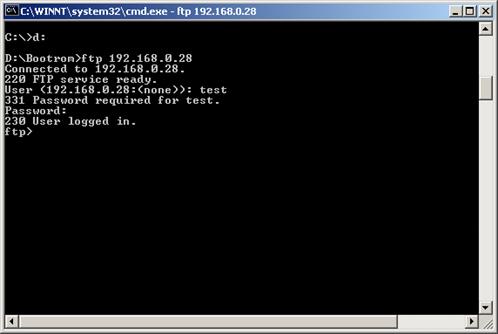

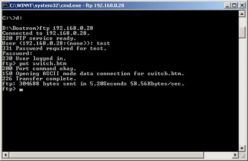

Step 1: As shown in Figure 1-7, connect the switch through an Ethernet port to the FTP server, and connect the switch through the Console port to the configuration PC.
You can use one computer as both configuration device and FTP server.
Step 2: Run the FTP server program on the FTP server, configure an FTP user name and password, and copy the program file to the specified FTP directory.
Step 3: Run the HyperTerminal program on the configuration PC. Start the switch. Then enter the BOOT Menu.

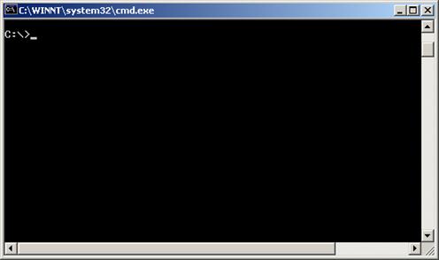

Step 4: Enable FTP client software on the PC. Refer to Figure 1-10 for the command line interface in Windows operating system.
Figure 1-10 Command line interface

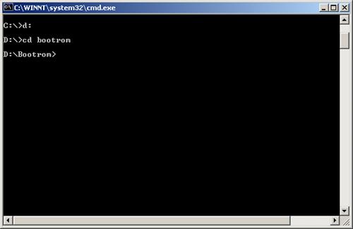

Step 5: Use the cd command on the interface to enter the path that the Boot ROM upgrade file is to be stored. Assume the name of the path is D:\Bootrom, as shown in Figure 1-11.
Figure 1-11 Enter Boot ROM directory
Step 6: Enter ftp 192.168.0.28 and enter the user name test, password pass, as shown in Figure 1-12, to log on to the FTP server.
Figure 1-12 Log on to the FTP server
Step 7: Use the put command to upload the file switch.btm to the switch, as shown in Figure 1-13.
Figure 1-13 Upload file switch.btm to the switch

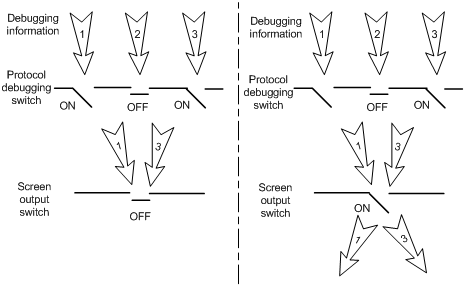

Debugging the System
Enabling/Disabling System Debugging
The device provides various debugging functions. For the majority of protocols and features supported, the system provides corresponding debugging information to help users diagnose errors.
The following two switches control the display of debugging information:
l          Protocol debugging switch, which controls protocol-specific debugging information
l          Screen output switch, which controls whether to display the debugging information on a certain screen.
Figure 2-1 illustrates the relationship between the protocol debugging switch and the screen output switch. Assume that the device can output debugging information to module 1, 2 and 3. Only when both are turned on can debugging information be output on a terminal.
Figure 2-1 The relationship between the protocol and screen debugging switch
Displaying debugging information on the terminal is the most commonly used way to output debugging information. You can also output debugging information to other directions. For details, refer to Information Center Operation.
You can use the following commands to enable the two switches.

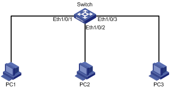

Network requirements
Configure Switch so that the PC connected to the port of Switch is available from eight AM to six PM from Monday to Friday.
Figure 5-1 Network diagram for scheduled task configuration
Configuration procedure
<Switch> system-view
# Create scheduled task pc1, and enter scheduled task view.
[Switch] job pc1
# Configure the view where the specified command to be executed as Ethernet interface view.
[Switch-job-pc1] view Ethernet1/0/1
# Configure the scheduled task so that the Ethernet port can be enabled on Switch at eight AM from Monday to Friday.
[Switch-job-pc1] time 1 repeating at 8:00 week-day Mon Tue Wed Thu Fri command undo shutdown
# Configure the scheduled task so that the Ethernet port can be disabled on Switch at six PM from Monday to Friday.
[Switch-job-pc1] time 2 repeating at 18:00 week-day Mon Tue Wed Thu Fri command shutdown
[Switch-job-pc1] quit
# Create scheduled task phone2, phone3, and Configure the scheduled task so that the Ethernet port can be enabled on Switch at eight AM from Monday to Friday.
[Switch] job pc2
[Switch-job-pc2] view Ethernet1/0/2
[Switch-job-pc2] time 1 repeating at 8:00 week-day Mon Tue Wed Thu Fri command undo shutdown
[Switch-job-pc2] time 2 repeating at 18:00 week-day Mon Tue Wed Thu Fri command shutdown
[Switch-job-pc2] quit
[Switch] job pc3
[Switch-job-pc3] view Ethernet1/0/3
[Switch-job-pc3] time 1 repeating at 8:00 week-day Mon Tue Wed Thu Fri command undo shutdown
[Switch-job-pc3] time 2 repeating at 18:00 week-day Mon Tue Wed Thu Fri command shutdown
[Switch-job-pc3] quit
# Display the information about the scheduled task.
[Switch] display job
Job name: pc1
  Specified view: Ethernet1/0/1
  Time 1: Execute command undo shutdown at 08:00 Mondays Tuesdays Wednesdays Thursdays Fridays
  Time 2: Execute command shutdown at 18:00 Mondays Tuesdays Wednesdays Thursdays Fridays
Job name: pc3
  Specified view: Ethernet1/0/3
