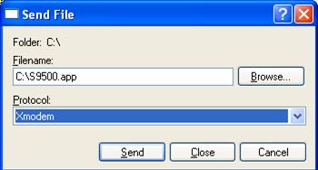

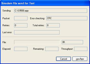

5.3.1 Recommended Upgrade Procedure
5.3.2 Local Loading through Boot Menu
5.3.3 Local or Remote Loading through CLI
5.3.4 Troubleshooting Software Upgrade

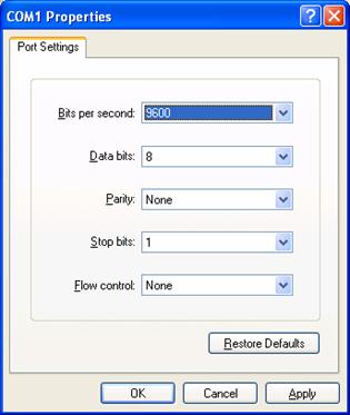

l The Console cable is not connected to the right serial port, that is, the port in use is not the one configured on the terminal.
l There are Console terminal parameter errors. (According to the parameter setting requirements, you should set the baud rate to 9600, data bits to 8, parity to None, stop bits to 1, flow control to None, and select VT100 as terminal emulation.)
l The Console cable is not in good condition.
II. The terminal gives illegible characters.
This symptom is very likely caused by a Console terminal setting error. In this case, check that you have set the baud rate to 9600, data bits to 8, parity to None, stop bits to 1, flow control to None, and select VT100 as terminal emulation.

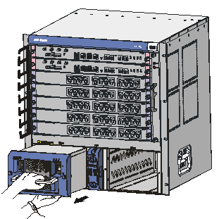

I. Removing a PSU other than NEPS3500-A
The following procedure applies to all NEPS PSUs except NEPS3500-A.
1) Move the power switch on the PSU to the OFF position if it is in the ON position. Disconnect the power source and unplug the power cord.
2) Remove the captive screws on the both sides of the PSU panel with a Phillips screwdriver.
3) Grasp the air filter cover by the upper and lower edges with your index finger and the thumb, and gently remove the air filter cover.
4) Pull the PSU gently along the guides out of the chassis, as shown in Figure 5-1.

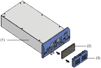

5.2.2 Replacing and Cleaning the PSU Air Filter
The air filters on the AC PSUs and DC PSUs can be replaced in a similar way even though they have different shapes.
Caution:
You are strongly recommended to clean the air filter semi-monthly to guarantee adequate ventilation.

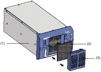

I. Removing and cleaning the PSU air filter
1) Clutch the air filter by the upper and lower edges with your index finger and the thumb, and pull the air filter out gently.
2) Take the black air filter mesh off.
3) Wash the mesh using clean water and air-dry it, taking care not to rub it.
(1) PSU |
(2) Air filter mesh |
(3) Air filter cover |
Figure 5-3 Remove the air filter from the DC PSU
(1) PSU |
Figure 5-4 Remove the air filter from the AC PSU
II. Installing the PSU air filter
1) Check that the black mesh has been nested in the air filter cover, as shown in Figure 5-5.
Figure 5-5 Install the PSU air filter (1)
2) Clutch the air filter cover by the upper and lower edges with your index finger and thumb and push it inside the PSU with an even force, as shown in Figure 5-6.
Figure 5-6 Install the PSU air filter (II)

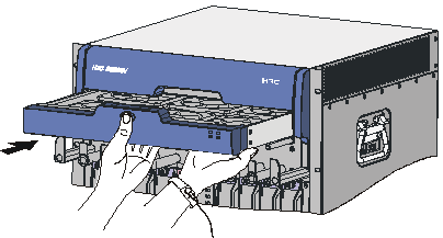

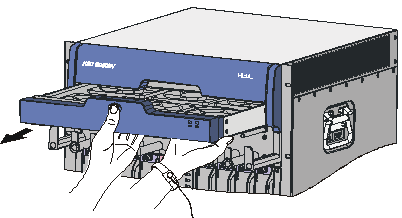

II. Removing, cleaning and installing the chassis air filter of the S9508V
l To remove and clean the chassis air filter, follow the procedure below:
1) Remove the captive screws at the left and right sides of the air filter using a Phillips screwdriver.
2) Clutch the air filter cover by the upper and lower edges using your index finger and the thumb, and remove the air filter cover gently.
3) Pull out the nested black air filter mesh.
4) Wash the air filter mesh using water, and then air-dry it. Take care not to rub the air filter mesh when you wash it.
l To install the chassis air filter, follow the procedure below:
1) Nest the black air filter mesh into the air filter cover.
2) Hold the air filter by the front end using one hand, and support the bottom using the other hand, place it horizontally, and slide it into the chassis along the guide rails.
3) Fasten the captive screws at the left and right sides of the air filter using a Phillips screwdriver, thus installing the air filter completely.

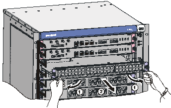

The SRPU, LPUs and service boards of the S9500 series are all hot swappable. They can be installed and removed almost in the same way. This section describes the general procedures for removing and installing these cards.
I. Removing a card
1) Wear the ESD-preventive wrist strap and loosen the captive screws on the card with a Phillips screwdriver.
2) Hold the ejector levers on the card with both hands and pull them outward to separate the locking pin of the card from the backplate.
3) Gently pull the card out of the slot along the guides.

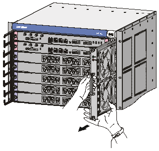

5.2.5 Replacing the Fan Tray
Caution:
l Do not touch exposed wires, terminals or the switch parts where dangerous voltage warning is given to avoid bodily injury.
l Install a new fan tray soon after removing the old one to ensure the normal working of the switch.
For the S9500 series except the S9508V, the procedure for replacing/installing the fan tray is the same.
& Note:
l The fan tray is delivered together with the switch and you do not need to install it. The following only describes how to replace the fan tray.
l The fan tray is hot-swappable.
I. Replacing the fan tray of S9505/S9508/S9512
1) Wear the ESD-preventive wrist strap. Remove the captive screws on both sides of the fan tray. Gently pull the fan tray out of the slot along the guide rails, as shown in Figure 5-8.
Caution:
When you replace the fan tray on an operating switch, pull the fan tray half way out of the chassis to disconnect the power, and wait till the fans stop rotating before pulling it out completely. Considering that the fans may be still rotating, avoid stretching your hands into the fan tray.
Figure 5-8 Replace the fan tray (1)
2) Slide the new fan tray smoothly along the guide rails until it fits into the chassis, with its plug fully touching the socket inside the chassis.
Caution:
Do not turn the fan tray upside down. Otherwise, you will not be able to fully insert it into the chassis due to the mis-plug prevention design of the chassis.
Figure 5-9 Replace the fan tray (2)
3) Fasten the captive screws on both sides of the fan tray.
II. Replacing the fan tray of S9508V
1) Wear an ESD-preventive wrist strap.
Caution:
2) Press the button using your thumb, and slide the fan tray out of the chassis along the slot, as shown in Figure 5-10.
Figure 5-10 Replace the S9508V fan tray (1)
3) Slide a new fan tray smoothly along the guide rails until it fits into the chassis, with its plug fully touching the socket inside the chassis.
Figure 5-11 Replace the S9508V fan tray (2)
& Note:
The S9508V fan tray has no captive screws and is fixed by two locks.

& Note:
You must ensure the upgraded host program is compatible with the existing Boot ROM program of the LPU. Otherwise, you have to upgrade it during host program upgrade.
When loading the host program through the Boot menu, you must configure correct attributes of the serial interface (as shown in Figure 5-12). Otherwise, the HyperTerminal does not respond.
Figure 5-12 Attribute settings of HyperTerminal serial interface

6) Select Transfer > Send File in the terminal window. Click Browse in the pop-up dialog box (shown as the following figure), select the desired application, and change the protocol used for downloading to XModem.
Figure 5-13 Send File dialog box
7) Click Send and the following interface pops up.
8) After downloading the program successfully, the system begins to write the data into the CF card. The downloading operation will end upon a successful write operation. Then, the system will access the serial interface submenu again, and the user can make selection as needed. The details will not be covered here.
