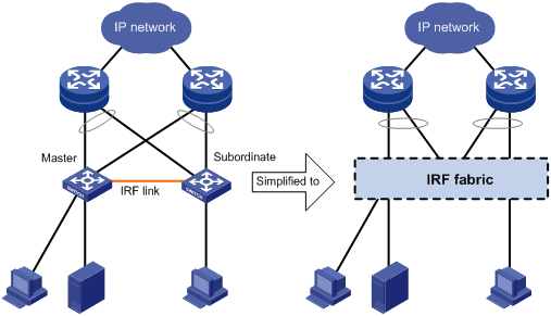

The Intelligent Resilient Framework (IRF) technology virtualizes multiple physical devices at the same layer into one virtual fabric to provide data center class availability and scalability. IRF virtualization technology offers processing power, interaction, unified management, and uninterrupted maintenance of multiple devices.
Figure 1 shows an IRF fabric that has two member devices, which appear as a single node to the upper-layer and lower-layer devices.
Figure 1 IRF application scenario
IRF provides the following benefits:
·     Simplified topology and easy management—An IRF fabric appears as one node and is accessible at a single IP address on the network. You can use this IP address to log in at any member device to manage all the members of the IRF fabric. In addition, you do not need to run the spanning tree feature among the IRF members.

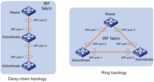

Network topology
The device supports daisy-chain or ring topology for IRF fabrics. IRF does not support the full mesh topology. For information about connecting IRF member devices, see "Connecting IRF physical interfaces."

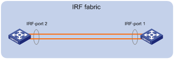

IRF port
An IRF port is a logical interface that connects IRF member devices. Every IRF-capable device has two IRF ports. The IRF ports are named IRF-port n/1 and IRF-port n/2, where n is the member ID of the device. The two IRF ports are referred to as IRF-port 1 and IRF-port 2 in this book.
To use an IRF port, you must bind a minimum of one physical interface to it. The physical interfaces assigned to an IRF port automatically form an aggregate IRF link. An IRF port goes down when all its IRF physical interfaces are down.

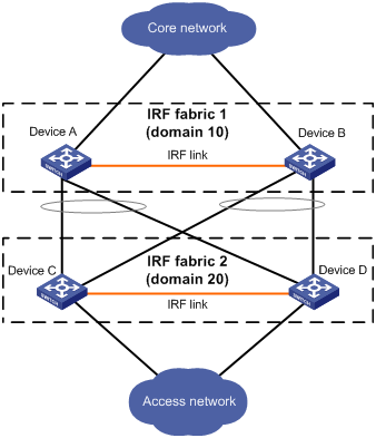

IRF domain ID
One IRF fabric forms one IRF domain. IRF uses IRF domain IDs to uniquely identify IRF fabrics and prevent IRF fabrics from interfering with one another.
As shown in Figure 2, IRF fabric 1 contains Device A and Device B, and IRF fabric 2 contains Device C and Device D. Both fabrics use the LACP aggregate links between them for MAD. When a member device receives an extended LACPDU for MAD, it checks the domain ID to see whether the packet is from the local IRF fabric. Then, the device can handle the packet correctly.
Figure 2 A network that contains two IRF domains

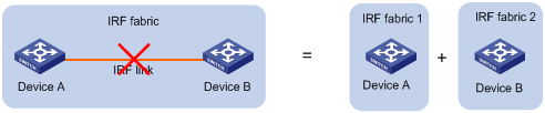

IRF split
IRF split occurs when an IRF fabric breaks up into multiple IRF fabrics because of IRF link failures, as shown in Figure 3. The split IRF fabrics operate with the same IP address. IRF split causes routing and forwarding problems on the network. To quickly detect a multi-active collision, configure a minimum of one MAD mechanism (see "Configuring MAD").
Figure 3 IRF split

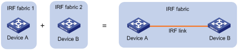

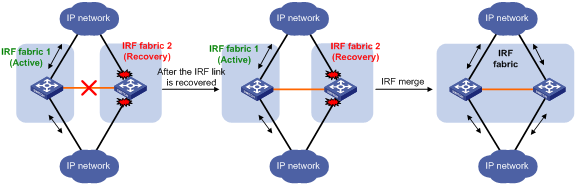

IRF merge
IRF merge occurs when two split IRF fabrics reunite or when two independent IRF fabrics are united, as shown in Figure 4.
Figure 4 IRF merge

When MAD detects a multi-active collision, it sets all IRF fabrics except one to the Recovery state. The fabric that is not placed in Recovery state can continue to forward traffic. The Recovery-state IRF fabrics are inactive and cannot forward traffic.
LACP MAD and BFD MAD use the following process to handle a multi-active collision:
1.     Compare the number of members in each fabric.
2.     Set all fabrics to the Recovery state except the one that has the most members.
3.     Compare the member IDs of their masters if all IRF fabrics have the same number of members.
4.     Set all fabrics to the Recovery state except the one that has the lowest numbered master.
5.     Shut down all service interfaces in the Recovery-state fabrics except for the following service interfaces:
?     Service interfaces automatically excluded from being shut down by the system.
?     Service interfaces specified by using the mad exclude interface command.
In contrast, ARP MAD and ND MAD do not compare the number of members in fabrics. These MAD mechanisms use the following process to handle a multi-active collision:
1.     Compare the member IDs of the masters in the IRF fabrics.
2.     Set all fabrics to the Recovery state except the one that has the lowest numbered master.
3.     Take the same action on the service interfaces in Recovery-state fabrics as LACP MAD and BFD MAD.

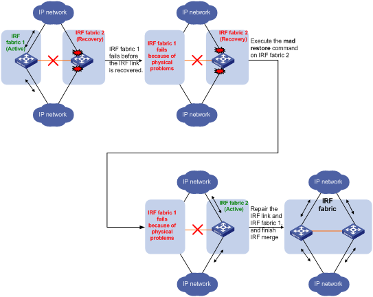

Failure recovery
To merge two split IRF fabrics, first repair the failed IRF link and remove the IRF link failure.
·     If the IRF fabric in Recovery state fails before the failure is recovered, repair the failed IRF fabric and the failed IRF link.
·     If the active IRF fabric fails before the failure is recovered, enable the inactive IRF fabric to take over the active IRF fabric. Then, recover the MAD failure.

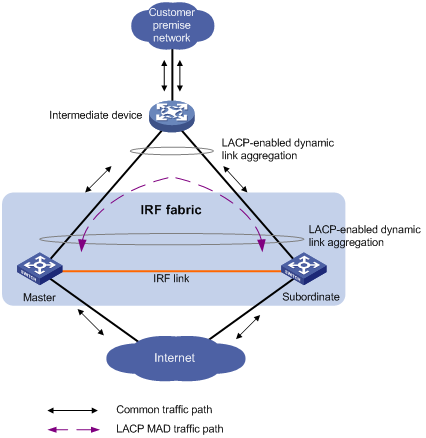

LACP MAD
As shown in Figure 5, LACP MAD has the following requirements:
·     Every IRF member must have a link with an intermediate device.
·     All the links form a dynamic link aggregation group.
·     The intermediate device must be a device that supports extended LACP for MAD.
The IRF member devices send extended LACPDUs that convey a domain ID and an active ID. The intermediate device transparently forwards the extended LACPDUs received from one member device to all the other member devices.
·     If the domain IDs and active IDs sent by all the member devices are the same, the IRF fabric is integrated.
·     If the extended LACPDUs convey the same domain ID but different active IDs, a split has occurred. LACP MAD handles this situation as described in "Collision handling."
Figure 5 LACP MAD scenario

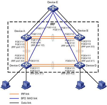

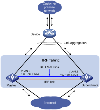

BFD MAD
On a two-chassis IRF fabric, BFD MAD can work with or without intermediate devices. On an IRF fabric that has more than two member devices, BFD MAD must work with an intermediate device.
Figure 6 shows a typical BFD MAD application scenario.
To use BFD MAD:
·     Set up dedicated BFD MAD link between each pair of IRF members or between each IRF member and the intermediate device. Do not use the BFD MAD links for any other purposes.
·     Perform the following tasks to configure BFD MAD on a VLAN interface:
?     Assign the ports connected by BFD MAD links to the same VLAN.
?     Create a VLAN interface for the VLAN, and assign a MAD IP address to each member on the VLAN interface.
On the intermediate device (if any), you must create the VLAN and assign the ports on the BFD MAD links to the VLAN.
The MAD IP addresses identify the member devices and must belong to the same subnet.
With BFD MAD, the master attempts to establish BFD sessions with other member devices by using its MAD IP address as the source IP address.
·     If the IRF fabric is integrated, only the MAD IP address of the master takes effect. The master cannot establish a BFD session with any other member. If you execute the display bfd session command, the state of the BFD sessions is Down.
·     When the IRF fabric splits, the IP addresses of the masters in the split IRF fabrics take effect. The masters can establish a BFD session. If you execute the display bfd session command, the state of the BFD session between the two devices is Up.
Figure 6 BFD MAD scenario

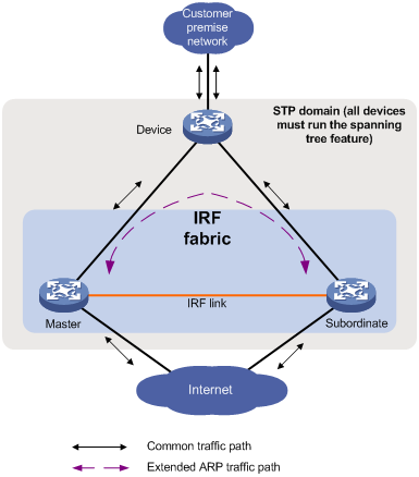

ARP MAD
ARP MAD detects multi-active collisions by using extended ARP packets that convey the IRF domain ID and the active ID.
On a two-chassis IRF fabric, ARP MAD can work with or without an intermediate device. On an IRF fabric that has more than two member devices, ARP MAD must work with an intermediate device.
Figure 7 shows a typical ARP MAD scenario that uses an intermediate device.
To use ARP MAD:
·     Set up ARP MAD links.
?     If an intermediate device is used, connect each IRF member device to the intermediate device. Run the spanning tree feature between the IRF fabric and the intermediate device. In this situation, data links can be used.
?     If no intermediate device is used, connect each IRF member device to all other member devices. In this situation, IRF links cannot be used for ARP MAD.
·     Perform the following tasks to configure ARP MAD on a VLAN interface:
?     Assign the ports connected by ARP MAD links to the same VLAN.
?     Create a VLAN interface for the VLAN, and assign an IP address to the VLAN interface.
On the intermediate device (if any), you must create the VLAN and assign the ports on the ARP MAD links to the VLAN.
Each IRF member compares the domain ID and the active ID in incoming extended ARP packets with its domain ID and active ID.
·     If the domain IDs are different, the extended ARP packet is from a different IRF fabric. The device does not continue to process the packet with the MAD mechanism.
·     If the domain IDs are the same, the device compares the active IDs.
?     If the active IDs are different, the IRF fabric has split.
?     If the active IDs are the same, the IRF fabric is integrated.
Figure 7 ARP MAD scenario

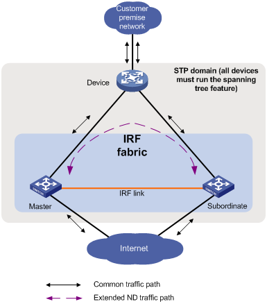

ND MAD
ND MAD detects multi-active collisions by using NS packets to transmit the IRF domain ID and the active ID.
You can set up ND MAD links between neighbor IRF member devices or between each IRF member device and an intermediate device (see Figure 8). If an intermediate device is used, you must also run the spanning tree protocol between the IRF fabric and the intermediate device.
Each IRF member device compares the domain ID and the active ID in incoming NS packets with its domain ID and active ID:
·     If the domain IDs are different, the NS packet is from a different IRF fabric. The device does not continue to process the packet with the MAD mechanism.
·     If the domain IDs are the same, the device compares the active IDs:
Figure 8 ND MAD scenario

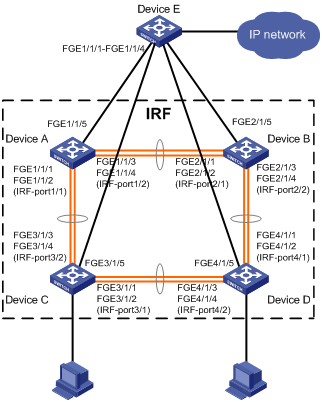

When you connect two neighboring IRF members, follow these restrictions and guidelines:
·     You must connect the physical interfaces of IRF-port 1 on one member to the physical interfaces of IRF-port 2 on the other.
·     Do not connect physical interfaces of both IRF ports on one member device to the physical interfaces of both IRF ports on the other device.
·     Make sure the two ends of an aggregate IRF link have the same number of IRF physical interfaces.
When you connect two neighboring IRF members, connect the physical interfaces of IRF-port 1 on one member to the physical interfaces of IRF-port 2 on the other (see Figure 9).
For example, you have four chassis: A, B, C, and D. IRF-port 1 and IRF-port 2 are represented by A1 and A2 on chassis A, represented by B1 and B2 on chassis B, and so on. To connect the four chassis into a ring topology of A-B-C-D(A), the IRF link cabling scheme must be one of the following:
·     A1-B2, B1-C2, C1-D2, and D1-A2.
·     A2-B1, B2-C1, C2-D1, and D2-A1.
IMPORTANT
IMPORTANT:
No intermediate devices are allowed between neighboring members.
Figure 9 Connecting IRF physical interfaces
Connect the devices into a daisy-chain topology or a ring topology. A ring topology is more reliable (see Figure 10). In ring topology, the failure of one IRF link does not cause the IRF fabric to split as in daisy-chain topology. Rather, the IRF fabric changes to a daisy-chain topology without interrupting network services.
To use the ring topology, you must have a minimum of three member devices.
Figure 10 Daisy-chain topology vs. ring topology

Configuring LACP MAD
When you use LACP MAD, follow these guidelines:
·     If the intermediate device is also an IRF fabric, assign the two IRF fabrics different domain IDs for correct split detection.
·     Use dynamic link aggregation mode. MAD is LACP dependent. Even though LACP MAD can be configured on both static and dynamic aggregate interfaces, it takes effect only on dynamic aggregate interfaces.
·     Configure link aggregation settings on the intermediate device.
To configure LACP MAD:
Step
Remarks
N/A
2.     Assign a domain ID to the IRF fabric.
irf domain domain-id
The default IRF domain ID is 0.
3.     Create an aggregate interface and enter aggregate interface view.
·     Enter Layer 2 aggregate interface view:
·     Enter Layer 3 aggregate interface view:
interface route-aggregation interface-number
Perform this step also on the intermediate device.
4.     Configure the aggregation group to operate in dynamic aggregation mode.
link-aggregation mode dynamic
By default, an aggregation group operates in static aggregation mode.
5.     Enable LACP MAD.
mad enable
By default, LACP MAD is disabled.
6.     Return to system view.
N/A
7.     Enter Ethernet interface view or interface range view.
·     Enter interface range view:
?     Method 1:
interface range { interface-type interface-number [ to interface-type interface-number ] } &<1-
24>
?     Method 2:
interface range name name [ interface { interface-type interface-number [ to interface-type interface-number ] } &<1-
24> ]
·     Enter Ethernet interface view:
To assign a range of ports to the aggregation group, enter interface range view.
To assign one port to the aggregation group, enter Ethernet interface view.
8.     Assign the Ethernet port or the range of Ethernet ports to the specified aggregation group.
port link-aggregation group group-id
Multichassis link aggregation is allowed.
Configuring BFD MAD
Before you configure BFD MAD, choose a BFD MAD link scheme as described in "BFD MAD."
As a best practice, connect the BFD MAD links after you finish the BFD MAD configuration.
When you configure BFD MAD settings, follow these restrictions and guidelines:
Category
BFD MAD VLAN
·     Do not enable BFD MAD on VLAN-interface 1.
·     If you are using an intermediate device, create the VLAN and VLAN interface on both the IRF fabric and the intermediate device. Assign the ports of BFD MAD links to the BFD MAD VLAN on both the IRF fabric and the intermediate device.
·     Make sure the IRF fabrics on the network use different BFD MAD VLANs.
·     Make sure the BFD MAD VLAN contains only ports on the BFD MAD links. Exclude a port from the BFD MAD VLAN if the port is not on the BFD MAD link. For example, if you have assigned the port to all VLANs by using the port trunk permit vlan all command, use the undo port trunk permit command to exclude the port from the BFD MAD VLAN.
BFD MAD VLAN and feature compatibility
Do not use the BFD MAD VLAN for any purpose other than configuring BFD MAD.
·     Use only the mad bfd enable and mad ip address commands on the BFD MAD-enabled VLAN interface. If you configure other features, both BFD MAD and other features on the interface might run incorrectly.
·     Disable the spanning tree feature on any Layer 2 Ethernet ports in the BFD MAD VLAN. The MAD feature is mutually exclusive with the spanning tree feature.
·     Do not bind a BFD MAD-enabled VLAN interface to a VPN instance. The MAD feature is mutually exclusive with VPN.
MAD IP address
·     To avoid network issues, only use the mad ip address command to configure IP addresses on the BFD MAD-enabled VLAN interface. Do not configure an IP address by using the ip address command or configure a VRRP virtual address on the BFD MAD-enabled VLAN interface.
·     Make sure all the MAD IP addresses are on the same subnet.
·     MAD IP addresses must be unique among all IP addresses on the IRF fabric.
BFD MAD and IRF link down report delay restrictions
Set the IRF link down report delay to 0 seconds to avoid unnecessary recalculations.
Configuration procedure
To configure BFD MAD:
Step
Remarks
N/A
2.     (Optional.) Assign a domain ID to the IRF fabric.
By default, the domain ID of an IRF fabric is 0.
3.     Set the IRF link down report delay to 0 seconds.
irf link-delay 0
The default IRF link down report delay is 1 second.
4.     Create a VLAN dedicated to BFD MAD.
vlan vlan-id
The default VLAN on the device is VLAN 1.
5.     Return to system view.
N/A
6.     Enter interface view or interface range view.
?     Method 1:
24>
?     Method 2:
24> ]
·     Enter interface view:
To assign a range of ports to the BFD MAD VLAN, enter interface range view.
To assign one port to the BFD MAD VLAN, enter Ethernet interface view.
7.     Assign the port or the range of ports to the BFD MAD VLAN.

Configuring ARP MAD
Before you configure ARP MAD, choose an ARP MAD link scheme as described in "ARP MAD."
As a best practice, connect the ARP MAD links after you finish the ARP MAD configuration if you are not using existing data links as ARP MAD links.
When you configure ARP MAD settings, follow these restrictions and guidelines:
Category
ARP MAD VLAN
·     Do not enable ARP MAD on VLAN-interface 1.
·     If you are using an intermediate device, perform the following tasks on both the IRF fabric and the intermediate device:
?     Create a VLAN and VLAN interface for ARP MAD.
?     Assign the ports of ARP MAD links to the ARP MAD VLAN.
·     Do not use the ARP MAD VLAN for any other purposes.
ARP MAD and feature configuration
If an intermediate device is used, make sure the following requirements are met:
·     Run the spanning tree feature between the IRF fabric and the intermediate device to ensure that there is only one ARP MAD link in forwarding state. For more information about the spanning tree feature and its configuration, see Layer 2—LAN Switching Configuration Guide.
·     Enable the IRF fabric to change its bridge MAC address as soon as the address owner leaves.
To configure ARP MAD:
Step
Remarks
N/A

·     If an intermediate device is used, you can use common data links as ND MAD links. If no intermediate device is used, set up dedicated ND MAD links between IRF member devices.
·     If an intermediate device is used, make sure the following requirements are met:
?     Run the spanning tree feature between the IRF fabric and the intermediate device. Make sure there is only one ND MAD link in forwarding state. For more information about the spanning tree feature and its configuration, see Layer 2—LAN Switching Configuration Guide.
?     Enable the IRF fabric to change its bridge MAC address as soon as the bridge MAC owner leaves.
?     Create an ND MAD VLAN and assign the ports on the ND MAD links to the VLAN.
?     If the intermediate device is also an IRF fabric, assign the two IRF fabrics different domain IDs for correct split detection.

Recovering an IRF fabric
After the failed IRF link between two split IRF fabrics is recovered, the member devices on the inactive IRF fabric automatically reboot. After these member devices join the active IRF fabric as subordinates, IRF merge is complete, as shown in Figure 11.
Figure 11 Recovering the IRF fabric
If the active IRF fabric fails before the IRF link is recovered (see Figure 12), use the mad restore command on the inactive IRF fabric to recover the inactive IRF fabric. The command brings up all service interfaces that were shut down by MAD. After you repair the IRF link, the two parts merge into a unified IRF fabric.
Figure 12 Active IRF fabric fails before the IRF link is recovered
To manually recover an inactive IRF fabric:
Step
2.     Recover the inactive IRF fabric.
mad restore
After the IRF fabric is recovered, all service interfaces that have been shut down by MAD come up automatically.

LACP MAD-enabled IRF configuration example
Network requirements
As shown in Figure 13, set up a four-chassis IRF fabric at the access layer of the enterprise network.
Configure LACP MAD on the multichassis aggregation to Device E, an H3C device that supports extended LACP.
Figure 13 Network diagram
1.     Configure Device A:
# Shut down the physical interfaces used for IRF links in batch. For information about bulk Ethernet port configuration, see Layer 2—LAN Switching Configuration Guide.
<Sysname> system-view
[Sysname] interface range fortygige 1/1/1 to fortygige 1/1/4
[Sysname-if-range] shutdown
[Sysname-if-range] quit
# Bind FortyGigE 1/1/1 and FortyGigE 1/1/2 to IRF-port 1/1.
[Sysname] irf-port 1/1
[Sysname-irf-port1/1] port group interface fortygige 1/1/1
[Sysname-irf-port1/1] port group interface fortygige 1/1/2
[Sysname-irf-port1/1] quit
# Bind FortyGigE 1/1/3 and FortyGigE 1/1/4 to IRF-port 1/2.
[Sysname] irf-port 1/2
[Sysname-irf-port1/2] port group interface fortygige 1/1/3
[Sysname-irf-port1/2] port group interface fortygige 1/1/4
[Sysname-irf-port1/2] quit
# Bring up the physical interfaces and save the configuration.
[Sysname-if-range] undo shutdown
[Sysname] save
# Activate the IRF port configuration.
[Sysname] irf-port-configuration active
2.     Configure Device B:
# Change the member ID of Device B to 2 and reboot the device to have the change take effect.
[Sysname] irf member 1 renumber 2
Renumbering the member ID may result in configuration change or loss. Continue? [Y/N]:y
[Sysname] quit
<Sysname> reboot
# Connect Device B to Device A as shown in Figure 13, and log in to Device B.
# Shut down the physical interfaces used for IRF links.
[Sysname] interface range fortygige 2/1/1 to fortygige 2/1/4
# Bind FortyGigE 2/1/1 and FortyGigE 2/1/2 to IRF-port 2/1.
[Sysname] irf-port 2/1
[Sysname-irf-port2/1] port group interface fortygige 2/1/1
[Sysname-irf-port2/1] port group interface fortygige 2/1/2
[Sysname-irf-port2/1] quit
# Bind FortyGigE 2/1/3 and FortyGigE 2/1/4 to IRF-port 2/2.
[Sysname] irf-port 2/2
[Sysname-irf-port2/2] port group interface fortygige 2/1/3
[Sysname-irf-port2/2] port group interface fortygige 2/1/4
[Sysname-irf-port2/2] quit
[Sysname] save
The two devices perform master election, and the one that has lost the election reboots to form an IRF fabric with the master.
3.     Configure Device C:
# Change the member ID of Device C to 3 and reboot the device to have the change take effect.
[Sysname] irf member 1 renumber 3
[Sysname] quit
<Sysname> reboot
# Connect Device C to Device A as shown in Figure 13, and log in to Device C.
[Sysname] interface range fortygige 3/1/1 to fortygige 3/1/4
# Bind FortyGigE 3/1/1 and FortyGigE 3/1/2 to IRF-port 3/1.
[Sysname] irf-port 3/1
[Sysname-irf-port3/1] port group interface fortygige 3/1/1
[Sysname-irf-port3/1] port group interface fortygige 3/1/2
[Sysname-irf-port3/1] quit
# Bind FortyGigE 3/1/3 and FortyGigE 3/1/4 to IRF-port 3/2.
[Sysname] irf-port 3/2
[Sysname-irf-port3/2] port group interface fortygige 3/1/3
[Sysname-irf-port3/2] port group interface fortygige 3/1/4
[Sysname-irf-port3/2] quit
[Sysname] save
Device C reboots to join the IRF fabric.
4.     Configure Device D:
# Change the member ID of Device D to 4 and reboot the device to have the change take effect.
[Sysname] irf member 1 renumber 4
[Sysname] quit
<Sysname> reboot
# Connect Device D to Device B and Device C as shown in Figure 13, and log in to Device D.
[Sysname] interface range fortygige 4/1/1 to fortygige 4/1/4
# Bind FortyGigE 4/1/1 and FortyGigE 4/1/2 to IRF-port 4/1.
[Sysname] irf-port 4/1
[Sysname-irf-port4/1] port group interface fortygige 4/1/1
[Sysname-irf-port4/1] port group interface fortygige 4/1/2
[Sysname-irf-port4/1] quit
# Bind FortyGigE 4/1/3 and FortyGigE 4/1/4 to IRF-port 4/2.
[Sysname] irf-port 4/2
[Sysname-irf-port4/2] port group interface fortygige 4/1/3
[Sysname-irf-port4/2] port group interface fortygige 4/1/4
[Sysname-irf-port4/2] quit
[Sysname] save
Device D reboots to join the IRF fabric. A four-chassis IRF fabric is formed.
5.     Configure LACP MAD on the IRF fabric:
# Set the domain ID of the IRF fabric to 1.
[Sysname] irf domain 1
# Create a dynamic aggregate interface and enable LACP MAD.
[Sysname] interface bridge-aggregation 2
[Sysname-Bridge-Aggregation2] link-aggregation mode dynamic
[Sysname-Bridge-Aggregation2] mad enable
You need to assign a domain ID (range: 0-4294967295)
[Current domain is: 1]:
The assigned domain ID is: 1
Info: MAD LACP only enable on dynamic aggregation interface.
[Sysname-Bridge-Aggregation2] quit
# Assign FortyGigE 1/1/5, FortyGigE 2/1/5, FortyGigE 3/1/5, and FortyGigE 4/1/5 to the aggregate interface.
[Sysname] interface range fortygige 1/1/5 fortygige 2/1/5 fortygige 3/1/5 fortygige 4/1/5
[Sysname-if-range] port link-aggregation group 2
6.     Configure Device E as the intermediate device:
CAUTION
CAUTION:
If the intermediate device is also an IRF fabric, assign the two IRF fabrics different domain IDs for correct split detection. False detection causes IRF split.
# Create a dynamic aggregate interface.
# Assign FortyGigE 1/1/1 through FortyGigE 1/1/4 to the aggregate interface.
BFD MAD-enabled IRF configuration example
As shown in Figure 14, set up an IRF fabric at the distribution layer of the network.
·     Configure BFD MAD in the IRF fabric and set up BFD MAD links between Device E and each member device.
·     Disable the spanning tree feature on the ports used for BFD MAD, because the two features conflict with each other.
Figure 14 Network diagram

5.     Configure BFD MAD:
# Set the IRF link down report delay to 0 seconds.
[Sysname] irf link-delay 0
# Create VLAN 3, and add FortyGigE 1/1/5, FortyGigE 2/1/5, FortyGigE 3/1/5, and FortyGigE 4/1/5 to VLAN 3.
[Sysname] vlan 3
[Sysname-vlan3] port fortygige 1/1/5 fortygige 2/1/5 fortygige 3/1/5 fortygige 4/1/5
[Sysname-vlan3] quit
# Create VLAN-interface 3, and configure a MAD IP address for each member device on the VLAN interface.
[Sysname] interface vlan-interface 3
[Sysname-Vlan-interface3] mad bfd enable
[Sysname-Vlan-interface3] mad ip address 192.168.2.1 24 member 1
[Sysname-Vlan-interface3] mad ip address 192.168.2.2 24 member 2
[Sysname-Vlan-interface3] mad ip address 192.168.2.3 24 member 3
[Sysname-Vlan-interface3] mad ip address 192.168.2.4 24 member 4
[Sysname-Vlan-interface3] quit
# Disable the spanning tree feature on FortyGigE 1/1/5, FortyGigE 2/1/5, FortyGigE 3/1/5, and FortyGigE 4/1/5.
[Sysname-if-range] undo stp enable
CAUTION
CAUTION:
# Create VLAN 3.
<DeviceE> system-view
[DeviceE] vlan 3
# Assign FortyGigE 1/1/1 through FortyGigE 1/1/4 to the VLAN.
[DeviceE-vlan3] port fortygige 1/1/1 to fortygige 1/1/4
[DeviceE-vlan3] quit
ARP MAD-enabled IRF configuration example
As shown in Figure 15, set up a four-chassis IRF fabric at the distribution layer of the enterprise network.
·     Configure ARP MAD for the IRF fabric and use Device E as an intermediate device. Device E can come from any vendor.
·     To prevent loops, enable the spanning tree feature between the IRF fabric and Device E.
Figure 15 Network diagram

5.     Configure ARP MAD on the IRF fabric:
# Enable the spanning tree feature globally, and map the ARP MAD VLAN to MSTI 1 in the MST region.
[Sysname] stp global enable
[Sysname] stp region-configuration
[Sysname-mst-region] region-name arpmad
[Sysname-mst-region] instance 1 vlan 3
[Sysname-mst-region] active region-configuration
[Sysname-mst-region] quit
# Configure the bridge MAC address of the IRF fabric to change as soon as the bridge MAC owner leaves.
[Sysname] undo irf mac-address persistent
[Sysname] vlan 3
# Create VLAN-interface 3, assign it an IP address, and enable ARP MAD on the interface.
[Sysname-Vlan-interface3] ip address 192.168.2.1 24
[Sysname-Vlan-interface3] mad arp enable
CAUTION
CAUTION:
[DeviceE] stp global enable
[DeviceE] stp region-configuration
[DeviceE-mst-region] region-name arpmad
[DeviceE-mst-region] instance 1 vlan 3
[DeviceE-mst-region] active region-configuration
[DeviceE-mst-region] quit
# Create VLAN 3, and add FortyGigE 1/1/1 through FortyGigE 1/1/4 to VLAN 3.
[DeviceE] vlan 3
[Sysname] save
[Sysname] quit
<Sysname> reboot
# Connect Device B to Device A as shown in Figure 16, and log in to Device B.
[Sysname] save
[Sysname] quit
<Sysname> reboot
# Connect Device C to Device A as shown in Figure 16, and log in to Device C.
[Sysname] save
[Sysname] quit
<Sysname> reboot
# Connect Device D to Device B and Device C as shown in Figure 16, and log in to Device D.
[Sysname] save
5.     Configure ND MAD on the IRF fabric:
# Enable the spanning tree feature globally, and map the ND MAD VLAN to MSTI 1 in the MST region.
[Sysname-mst-region] region-name ndmad
[Sysname] vlan 3
# Create VLAN-interface 3, assign it an IP address, and enable ND MAD on the interface.
[Sysname-Vlan-interface3] ipv6 address 2001::1 64
[Sysname-Vlan-interface3] mad nd enable
CAUTION
CAUTION:
[DeviceE-mst-region] region-name ndmad
[DeviceE] vlan 3

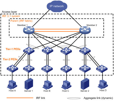

Configuring an IRF 3.1 system
Overview
IRF 3.1 integrates multiple lower-layer devices with a higher-layer IRF fabric to provide high-density, low-cost connectivity at the access layer. IRF 3.1 is implemented based on IEEE 802.1BR.
In an IRF 3.1 system, the higher-layer IRF fabric is called the parent fabric and the lower-layer devices are called bridge port extenders (PEXs). You manage and configure the PEXs from the parent fabric as if they were interface modules on the parent fabric.
IRF 3.1 network model
Typically, IRF 3.1 works at the access layer of data centers and large-scale enterprise networks. As shown in Figure 17, the access layer of a network is virtualized into an IRF 3.1 system. The system contains one parent fabric (a two-chassis IRF fabric) and multiple PEXs to provide connectivity for servers and hosts.
Figure 17 IRF 3.1 application scenario
IRF 3.1 benefits
IRF 3.1 provides the following benefits:
·     Simplified topology—Devices in an IRF 3.1 system appear as one node. For redundancy and load balancing, a downstream or upstream device can connect to the IRF 3.1 system through multichassis link aggregation. Together with link aggregation, IRF 3.1 creates a loop-free Layer 2 network. The spanning tree feature is not needed among devices in the IRF 3.1 system or on the link aggregations. IRF 3.1 also simplifies the Layer 3 network topology because it reduces the number of routing peers. The network topology does not change when a device is added to or removed from the IRF 3.1 system.
·     Single point of management—An IRF 3.1 system is accessible at a single IP address on the network. You can use this IP address to log in through any network port to manage all the devices in the system. For an SNMP NMS, an IRF 3.1 system is one managed network node.
·     Network scalability and resiliency—You can increase the number of ports in an IRF 3.1 system by adding PEXs without changing network topology.
·     High availability—Each PEX has multiple high-speed physical ports for uplink connectivity to the parent fabric. The links on these ports are aggregated and load balanced automatically.
·     Decreased TCO—IRF 3.1 decreases hardware investments and management costs. In an IRF 3.1 system, the parent fabric performs all the management and routing functions, and the PEXs only forward traffic. You can add low-performance devices as PEXs to an IRF 3.1 system for network scalability.
·     High software compatibility—The software versions of the parent fabric and PEXs are highly compatible. You can independently upgrade software for the parent and PEXs.
Network topology

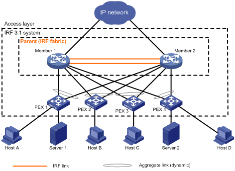

One tier of PEXs
As shown in Figure 18, you can set up an IRF 3.1 system that contains one tier of PEXs. In this topolocy, connect each PEX to the parent fabric through a Layer 2 aggregate interface in dynamic aggregation mode.
In this topology, you cannot connect one PEX to another PEX.
Figure 18 IRF 3.1 network topology with one tier of PEXs

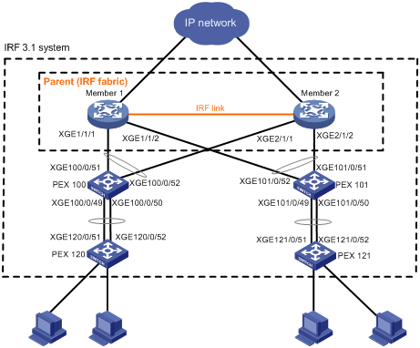

Multiple tiers of PEXs
An IRF 3.1 system can have a maximum of two tiers of PEXs.
·     The PEXs directly attached to the parent fabric are tier-1 PEXs.
·     The PEXs attached to tier-1 PEXs are tier-2 PEXs.
In this topology, connect each PEX to the parent fabric or to an upper-tier PEX through a Layer 2 aggregate interface in dynamic aggregation mode.
As shown in Figure 19, follow these guidelines when you connect PEXs:
·     A tier-2 PEX can be attached to only one tier-1 PEX.
·     No links except cascade links are allowed between PEXs.
Figure 19 IRF 3.1 network topology with two tiers of PEXs

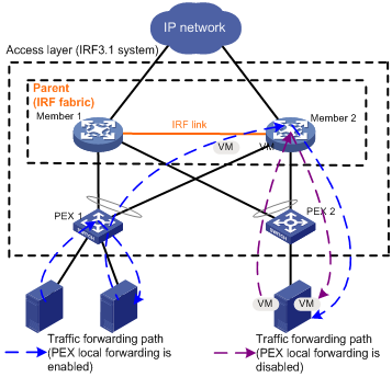

Data forwarding
When PEX local forwarding is enabled for a PEX, the PEX performs local forwarding for Layer 2 unicast packets with known MAC addresses. For other packets, the PEX forwards them to the parent fabric for processing.
When PEX local forwarding is disabled for a PEX, the PEX sends any incoming traffic to the parent fabric. The parent fabric makes forwarding decisions and sends the traffic to the outgoing interfaces (see Figure 20).
When the PEX receives a packet, it tags the packet with an E-tag. The E-tag carries the ECID of the interface that receives the packet. IRF 3.1 forwards the packet based on the ECID within the IRF 3.1 system. When the packet leaves the IRF 3.1 system, the E-tag is removed.
Figure 20 Data forwarding model

IRF 3.1 configuration task list
An IRF 3.1 system can be set up with automatically configured PEXs or manually configured PEXs.
For PEXs to come online or operate correctly, do not manually configure PEXs when the PEX autoconfiguration feature is enabled on the IRF 3.1 system.
Configuring an IRF 3.1 system with manually configured PEXs
To configure an IRF 3.1 system with manually configured PEXs:
Tasks at a glance
Remarks
1.     Setting up the parent fabric
N/A
2.     Configuring tier-1 PEXs on the parent fabric:
a.     Creating a PEX group
b.     Configuring cascade ports for tier-1 PEXs
c.     Assigning virtual slot numbers to PEXs
d.     Connecting the PEXs to the upper-tier device
N/A
3.     Configuring tier-2 PEXs on the parent fabric:
a.     Configuring cascade ports for tier-2 PEXs
b.     Assigning virtual slot numbers to PEXs
c.     Connecting the PEXs to the upper-tier device
The tasks are required when you set up an IRF 3.1 system with two tiers of PEXs.
Before you configure a tier-2 PEX, make sure its tier-1 PEX has been online.
4.     (Optional.) Maintaining an IRF 3.1 system:
?     Enabling PEX local forwarding
?     Enabling PEX persistent forwarding
?     Logging in to a PEX from the parent fabric
?     Configuring and saving PEX-specific feature settings
?     Deleting idle cascade ports
?     Changing the cascade link rate
PEX-specific features must be configured from the CLI of a PEX.
Configuring an IRF 3.1 system with automatically configured PEXs
To configure an IRF 3.1 system with automatically configured PEXs:
Tasks at a glance
Remarks
N/A
2.     Enabling PEX autoconfiguration
N/A
3.     Connecting the PEXs to the upper-tier device
N/A
Planning the IRF 3.1 system setup
Consider the following items when you plan an IRF 3.1 system:
·     Hardware compatibility and restrictions.
·     IRF 3.1 system size.
·     Parent devices, PEXs, and tiers of PEXs.
·     Cascade ports, cascade member interfaces, upstream member interfaces, and cabling scheme.
·     Virtual slot assignment for PEXs.
The plan must meet the requirements described in "General IRF 3.1 configuration restrictions and guidelines."
For more information about hardware and cabling, see the installation guide for the device.
Overview
The cascade ports for tier-1 PEXs are Layer 2 aggregate interfaces in dynamic aggregation mode. The member interfaces in each cascade port are physical interfaces that connect the parent fabric to a tier-1 PEX.
The system automatically places a Layer 2 aggregate interface in dynamic aggregation mode after you enable its PEX connection capability. In addition, the system automatically configures the aggregate interface as an edge port of the spanning tree feature for the PEX to quickly come online.
Make sure all physical interfaces assigned to a cascade port connect to the same tier-1 PEX.
For PEXs to come online successfully, do not execute any other commands on cascade ports except for the IRF 3.1 commands, the shutdown command, and the description command. In addition, do not execute any other commands on the cascade member interfaces except for the lldp enable command.
Before you disable PEX connection capability or change the PEX group on a cascade port, make sure the attached tier-1 PEX does not have cascade ports configured for tier-2 PEXs.
Disabling PEX connection capability on a cascade port causes the attached PEX to go offline. When you assign a cascade port to a new PEX group, its attached PEX goes offline and then comes online again. When the PEX goes offline in either situation, all settings issued from the parent fabric are automatically removed from the PEX, including the cascade-port settings for connecting tier-2 PEXs. The PEX will run with the factory defaults and any tier-2 PEXs attached to the PEX will go offline. To have the tier-2 PEXs come online again, you must reconfigure their cascade port settings.
To configure a cascade port for a tier-1 PEX:
Step
Remarks
N/A
2.     Enable LLDP globally.
lldp global enable
By default, LLDP is disabled globally.
3.     Create a Layer 2 aggregate interface and enter Layer 2 aggregate interface view.
When you create a Layer 2 aggregate interface, the system automatically creates a Layer 2 aggregation group with the same number. The aggregation group operates in static aggregation mode by default.
4.     Enable PEX connection capability on the Layer 2 aggregate interface and assign it to a PEX group.
pex-capability enable group group-id
By default, an aggregate interface cannot connect PEXs.
N/A
6.     Enter Layer 2 Ethernet interface view or Layer 2 Ethernet interface range view.
·     Enter interface view.
·     Enter interface range view.
interface range { interface-type interface-number [ to interface-type interface-number ] } &<1-24>
7.     Assign Layer 2 Ethernet ports to the aggregation group.
All physical interfaces assigned to the aggregate interface must be connected to the same PEX.
8.     Enable LLDP on the ports.
lldp enable
By default, LLDP is enabled on a port.
Overview
The cascade ports for tier-2 PEXs are Layer 2 extended-link aggregate interfaces in dynamic aggregation mode. The member interfaces in each cascade port are physical interfaces that connect a tier-1 PEX to a tier-2 PEX.
The system automatically places a Layer 2 extended-link aggregate interface in dynamic aggregation mode after you enable its PEX connection capability. In addition, the system automatically configures the aggregate interface as an edge port of the spanning tree feature for the PEX to quickly come online.
You must assign member interfaces to the aggregation group before enabling PEX connection capability on a Layer 2 extended-link aggregate interface. Make sure all its aggregation member interfaces connect to the same tier-2 PEX.
As a best practice, select the high-speed ports on a PEX as cascade member interfaces.
For PEXs to come online correctly, do not execute any other commands on the cascade ports except for the IRF 3.1 commands, the shutdown command, and the description command. In addition, do not execute any other commands on the cascade member interfaces except for the lldp enable command.
Disabling PEX connection capability on a cascade port causes its attached PEX to go offline with all settings issued from the parent fabric automatically removed. The PEX will run with the factory defaults.
You must assign a tier-2 PEX to the same PEX group as its tier-1 PEX. To change the PEX group of a tier-2 PEX, you must first disable PEX connection capability on its cascade port and change the PEX group of its tier-1 PEX.
Configuration prerequisites
Make sure you have completed the configuration for the tier-1 PEX. Execute the display pex interface brief command on the parent fabric to verify that the tier-1 PEX has come online.
To configure a cascade port for a tier-2 PEX:
Step
Remarks
N/A
2.     Create a Layer 2 extended-link aggregate interface and enter Layer 2 extended-link aggregate interface view.
interface bridge-aggregation interface-number pex
When you create a Layer 2 extended-link aggregate interface, the system automatically creates a Layer 2 extended-link aggregation group with the same number as the aggregate interface. The aggregation group operates in static aggregation mode by default.
3.     Return to system view.
N/A
4.     Enter Layer 2 Ethernet interface view or Layer 2 Ethernet interface range view.
To assign one port to the extended-link aggregation group, enter Ethernet interface view.
To assign a range of ports to the extended-link aggregation group, enter interface range view.
5.     Assign Layer 2 Ethernet ports to the extended-link aggregation group.
N/A
6.     Enable LLDP on the ports.
lldp enable
7.     Return to system view.
N/A
8.     Enter Layer 2 extended-link aggregate interface view.
N/A
9.     Enable PEX connection capability on the interface and assign the interface to a PEX group.
This feature enables a PEX to perform local forwarding for Layer 2 unicast packets with known MAC addresses. The PEX reports other packets to the parent fabric for processing.
If PEX local forwarding is disabled for a PEX, the PEX sends any incoming traffic to the parent fabric. The parent fabric makes forwarding decisions and sends the traffic to the outgoing interfaces.
When you enable or disable PEX local forwarding on a cascade port, the PEX and its lower-tier PEXs will go offline and then come online again.
To enable PEX local forwarding for a PEX:
Step
Remarks
N/A
2.     Enter Layer 2 aggregate interface view of a cascade port.
N/A
3.     Enable PEX local forwarding.
pex local-forwarding
By default, PEX local forwarding is disabled.

Configuration example for setting up an IRF 3.1 system with two tiers of PEXs
As shown in Figure 21, set up an IRF 3.1 system that contains a two-chassis S7500E-XS parent fabric, two S5130S-52S-HI tier-1 PEXs, and two S5560X-54C-EI tier-2 PEXs.
Figure 21 Network diagram
# Set up a two-chassis IRF fabric with Member 1 and Member 2, as described in "Setting up an IRF fabric." (Details not shown.)
Configuring cascade ports for tier-1 PEXs on the parent fabric

Configuring cascade ports for tier-2 PEXs on the parent fabric
# Create Layer 2 extended-link aggregate interface Bridge-Aggregation 120. The aggregate interface will act as the cascade port to the PEX in slot 120.
[Sysname] interface bridge-aggregation 120 pex
[Sysname-Bridge-Aggregation120] quit
# Enable LLDP on Ten-GigabitEthernet 100/0/49 and Ten-GigabitEthernet 100/0/50 in interface range view, and assign the ports to aggregation group 120. The ports will act as the cascade member interfaces.
[Sysname] interface range ten-gigabitethernet 100/0/49 ten-gigabitethernet 100/0/50
[Sysname-if-range] lldp enable
[Sysname-if-range] port link-aggregation group 120
# Enable PEX connection capability on Bridge-Aggregation 120 and assign the interface to PEX group 1.
[Sysname-Bridge-Aggregation120] pex-capability enable group 1
# Assign virtual slot number 120 to the PEX.
[Sysname-Bridge-Aggregation120] pex associate slot 120
# Create Layer 2 extended-link aggregate interface Bridge-Aggregation 121. The aggregate interface will act as the cascade port to the PEX in slot 121.
[Sysname] interface bridge-aggregation 121 pex
[Sysname-Bridge-Aggregation121] quit
# Enable LLDP on Ten-GigabitEthernet 101/0/49 and Ten-GigabitEthernet 101/0/50 in interface range view, and assign the ports to aggregation group 121. The ports will act as the cascade member interfaces.
[Sysname] interface range ten-gigabitethernet 101/0/49 ten-gigabitethernet 101/0/50
[Sysname-if-range] port link-aggregation group 121
# Enable PEX connection capability on Bridge-Aggregation 121 and assign the interface to PEX group 1.
[Sysname-Bridge-Aggregation121] pex-capability enable group 1
# Assign virtual slot number 121 to the PEX.
[Sysname-Bridge-Aggregation121] pex associate slot 121
