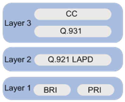

The following describes the functionality of the protocols in the D-channel protocol stack:
·     Q.921—Provides the following functions:
¡     A reliable transport for Layer 3 Q.931 signaling messages.
¡     Identification of frames.
¡     Flow control mechanisms for data transmission and reception.
·     Q.931—Provides call control and management. These functions include call setup, call disconnection, and request for services from Layer 2.
·     Call control (CC)—Forwards messages received by Q.931 from the network side to higher-layer applications such as the DDR or voice module for information conversion and call routing.
Figure 1 ISDN D-channel protocol stack

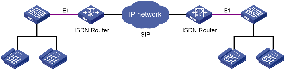

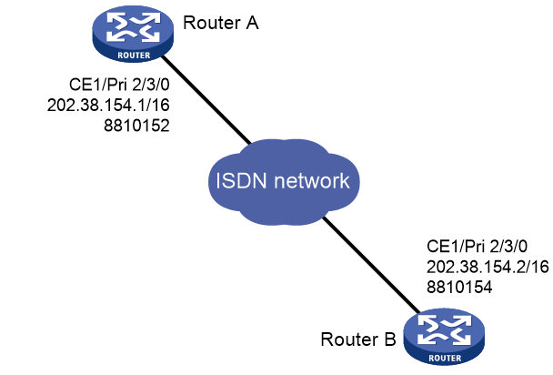

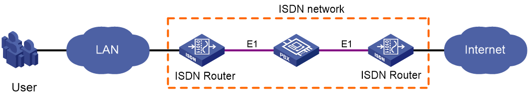

ISDN application scenarios
Figure 2 and Figure 3 show typical ISDN network diagrams for data services and voice services, respectively.
Figure 2 Data ISDN application scenario
Figure 3 Voice ISDN application scenario

As shown in Figure 4, configure an ISDN PRI line between Router A and Router B for data transmission.
Figure 4 Network diagram
In this example, the ISDN PRI interfaces on Router A and Router B are operating as the user side (the default). You must configure the ISDN PRI interfaces as the network side on the service provider switches connected to the routers.
