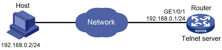

As shown in Figure 1, use a host with IP address 192.168.0.2/24 to log in to the device through Telnet.
Figure 1 Network diagram
·     Make sure the host and the device can communicate with each other. Enable Telnet service port number 23.
·     Enable the Telnet client feature on the host.
·     By default, the Telnet server is disabled on the device. You must log in to the device through the console port and enable the Telnet server.
Figure 6 Network diagram
·     By default, the Telnet server is disabled on the device. You must log in to the Web interface of the device and enable the Telnet server.

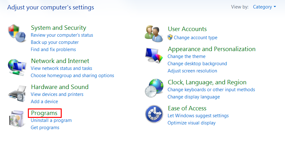

2.     Click Programs.
Figure 8 Control panel

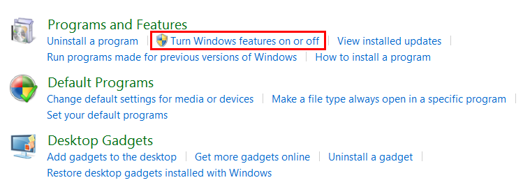

3.     Click Turn Windows features on or off.
Figure 9 Program

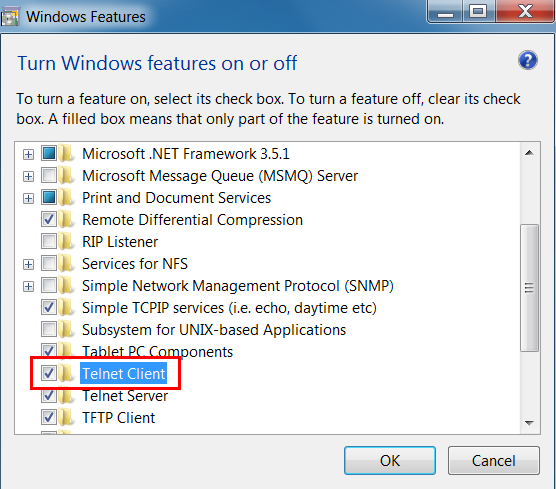

4.     Select Telnet Client, and then click OK.
Figure 10 Windows features

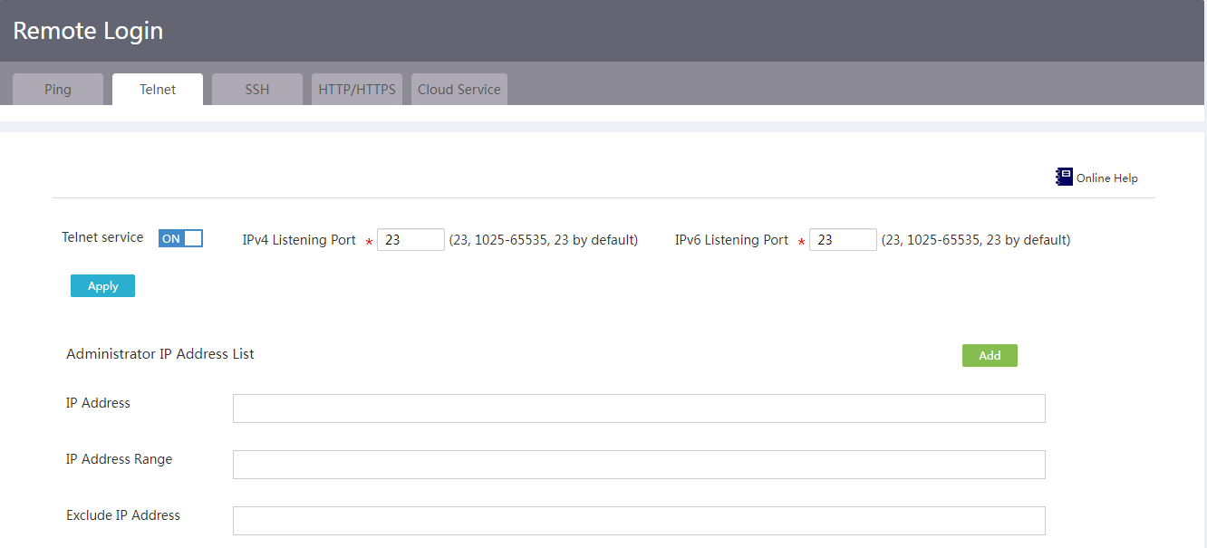

1.     From the navigation pane, select System Tools > Remote Login.
2.     Click the Telnet tab, enable the Telnet service, and then click Apply.
Figure 11 Remote Login page

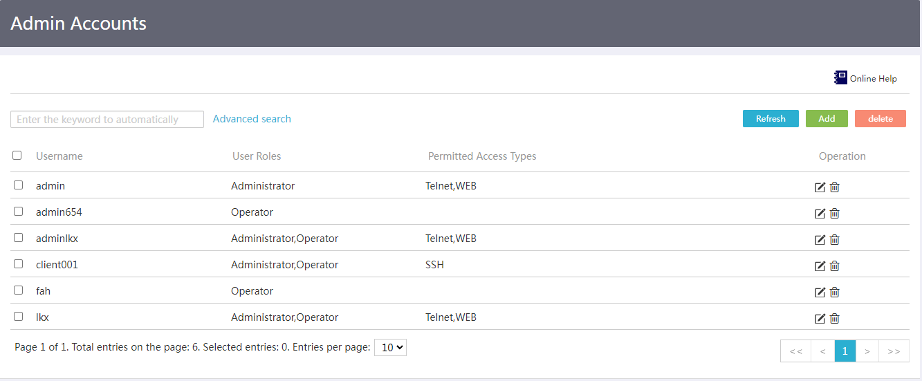

3.     From the navigation pane, select System Tools > Admin Accounts.
Figure 12 Admin Accounts page

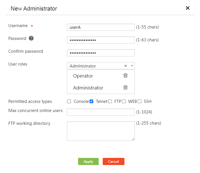

4.     Click Add.
5.     In the Username field, enter userA.
6.     In the Password field, enter 123456TESTplat&!.
7.     In the Confirm Password field, enter 123456TESTplat&!.
8.     In the User roles field, select Administrator.
9.     In the Permitted access types field, select Telnet.
10.     Use the default settings for the other parameters. Click Apply.
Figure 13 Add Administrator
