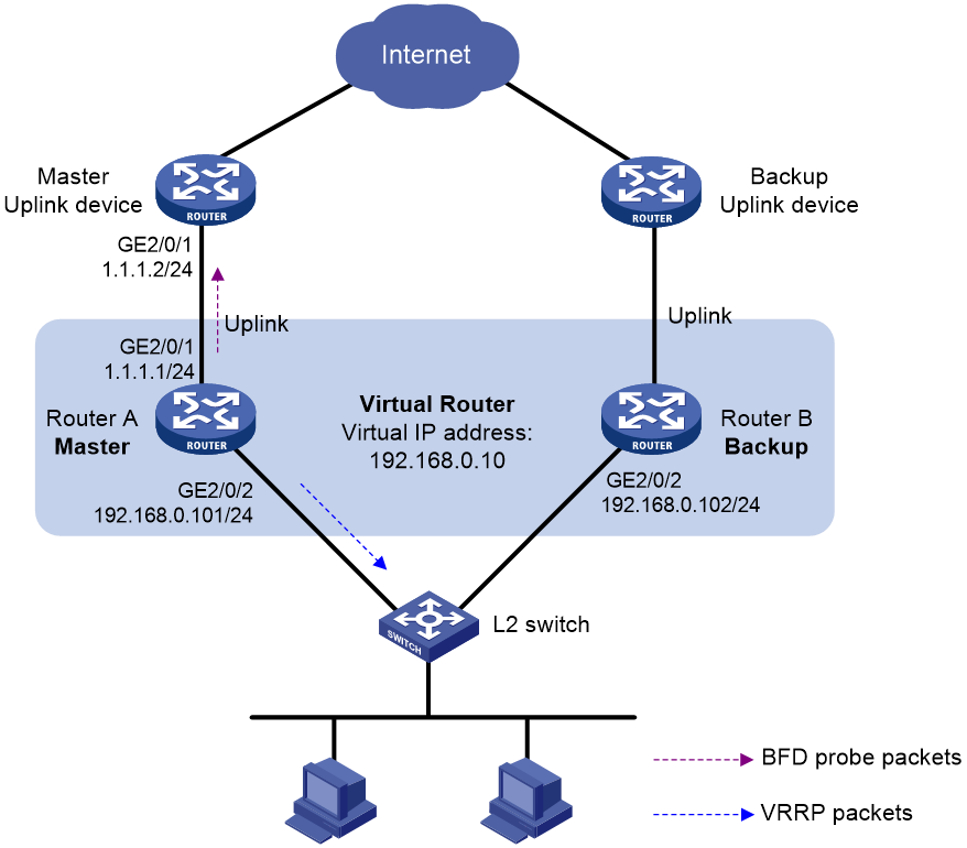

Example: Configuring VRRP-Track-NQA collaboration
As shown in Figure 2:
·     Host A requires access to Host B. The default gateway of Host A is 10.1.1.10/24.
·     Router A and Router B belong to VRRP group 1. The virtual IP address of VRRP group 1 is 10.1.1.10.
Configure VRRP-Track-NQA collaboration to monitor the uplink on the master and meet the following requirements:
·     When Router A operates correctly, it forwards packets from Host A to Host B.
·     When NQA detects a fault on the uplink of Router A, Router B forwards packets from Host A to Host B.
Figure 2 Network diagram
1.     Configure the IP address of each interface, as shown in Figure 2. (Details not shown.)
2.     Configure an NQA operation on Router A:
# Create an NQA operation with administrator name admin and operation tag test.
<RouterA> system-view
[RouterA] nqa entry admin test
# Specify the ICMP echo operation type.
[RouterA-nqa-admin-test] type icmp-echo
# Specify 10.1.2.2 as the destination address of ICMP echo requests.
[RouterA-nqa-admin-test-icmp-echo] destination ip 10.1.2.2
# Configure the ICMP echo operation to repeat every 100 milliseconds.
[RouterA-nqa-admin-test-icmp-echo] frequency 100
# Configure reaction entry 1 so that five consecutive probe failures will trigger collaboration with the Track module.
[RouterA-nqa-admin-test-icmp-echo] reaction 1 checked-element probe-fail threshold-type consecutive 5 action-type trigger-only
[RouterA-nqa-admin-test-icmp-echo] quit
# Start the NQA operation.
[RouterA] nqa schedule admin test start-time now lifetime forever
3.     On Router A, configure track entry 1, and associate it with reaction entry 1 of the NQA operation.
[RouterA] track 1 nqa entry admin test reaction 1
[RouterA-track-1] quit
4.     Configure VRRP on Router A:
# Specify VRRPv2 to run on GigabitEthernet 2/0/1.
[RouterA] interface gigabitethernet 2/0/1
[RouterA-GigabitEthernet2/0/1] vrrp version 2
# Create VRRP group 1, and configure virtual IP address 10.1.1.10 for the group.
[RouterA-GigabitEthernet2/0/1] vrrp vrid 1 virtual-ip 10.1.1.10
# Set the priority of Router A to 110 in VRRP group 1.
[RouterA-GigabitEthernet2/0/1] vrrp vrid 1 priority 110
# Set the authentication mode of VRRP group 1 to simple, and the authentication key to hello.
[RouterA-GigabitEthernet2/0/1] vrrp vrid 1 authentication-mode simple plain hello
# Configure the master to send VRRP packets every 500 centiseconds.
[RouterA-GigabitEthernet2/0/1] vrrp vrid 1 timer advertise 500
# Configure Router A to operate in preemptive mode and set the preemption delay to 5000 centiseconds.
[RouterA-GigabitEthernet2/0/1] vrrp vrid 1 preempt-mode delay 5000
# Associate VRRP group 1 with track entry 1 and decrease the router priority by 30 when the state of track entry 1 changes to negative.
[RouterA-GigabitEthernet2/0/1] vrrp vrid 1 track 1 priority reduced 30
5.     Configure VRRP on Router B:
<RouterB> system-view
[RouterB] interface gigabitethernet 2/0/1
[RouterB-GigabitEthernet2/0/1] vrrp version 2
[RouterB-GigabitEthernet2/0/1] vrrp vrid 1 virtual-ip 10.1.1.10
[RouterB-GigabitEthernet2/0/1] vrrp vrid 1 authentication-mode simple plain hello
[RouterB-GigabitEthernet2/0/1] vrrp vrid 1 timer advertise 500
# Configure Router B to operate in preemptive mode and set the preemption delay to 5000 centiseconds.
[RouterB-GigabitEthernet2/0/1] vrrp vrid 1 preempt-mode delay 5000
# Ping Host B from Host A to verify that Host B is reachable. (Details not shown.)
# Display detailed information about VRRP group 1 on Router A.
[RouterA-GigabitEthernet2/0/1] display vrrp verbose
IPv4 Virtual Router Information:
 Running Mode      : Standard
 Total number of virtual routers : 1
   Interface GigabitEthernet2/0/1
     VRID             : 1               Adver Timer  : 500
     Admin Status     : Up              State        : Master
     Config Pri       : 110             Running Pri  : 110
     Preempt Mode     : Yes             Delay Time   : 5000
     Auth Type        : Simple          Key          : ******
     Version          : 2
     Virtual IP       : 10.1.1.10
     Virtual MAC      : 0000-5e00-0101
     Master IP        : 10.1.1.1
   VRRP Track Information:
     Track Object   : 1              State : Positive          Pri Reduced : 30
# Display detailed information about VRRP group 1 on Router B.
[RouterB-GigabitEthernet2/0/1] display vrrp verbose
     Admin Status     : Up              State        : Backup
     Config Pri       : 100             Running Pri  : 100
     Become Master    : 2200ms left
     Version          : 2
The output shows that in VRRP group 1, Router A is the master and Router B is a backup. Router A forwards packets from Host A to Host B.
# Disconnect the link between Router A and Router C, and verify that Host A can still ping Host B. (Details not shown.)
     Config Pri       : 110             Running Pri  : 80
     Version          : 2
     Master IP        : 10.1.1.2
     Track Object   : 1              State : Negative          Pri Reduced : 30
# Display detailed information about VRRP group 1 on Router B when a fault is on the link between Router A and Router C.
     Version          : 2
The output shows that Router A becomes the backup, and Router B becomes the master. Router B forwards packets from Host A to Host B.

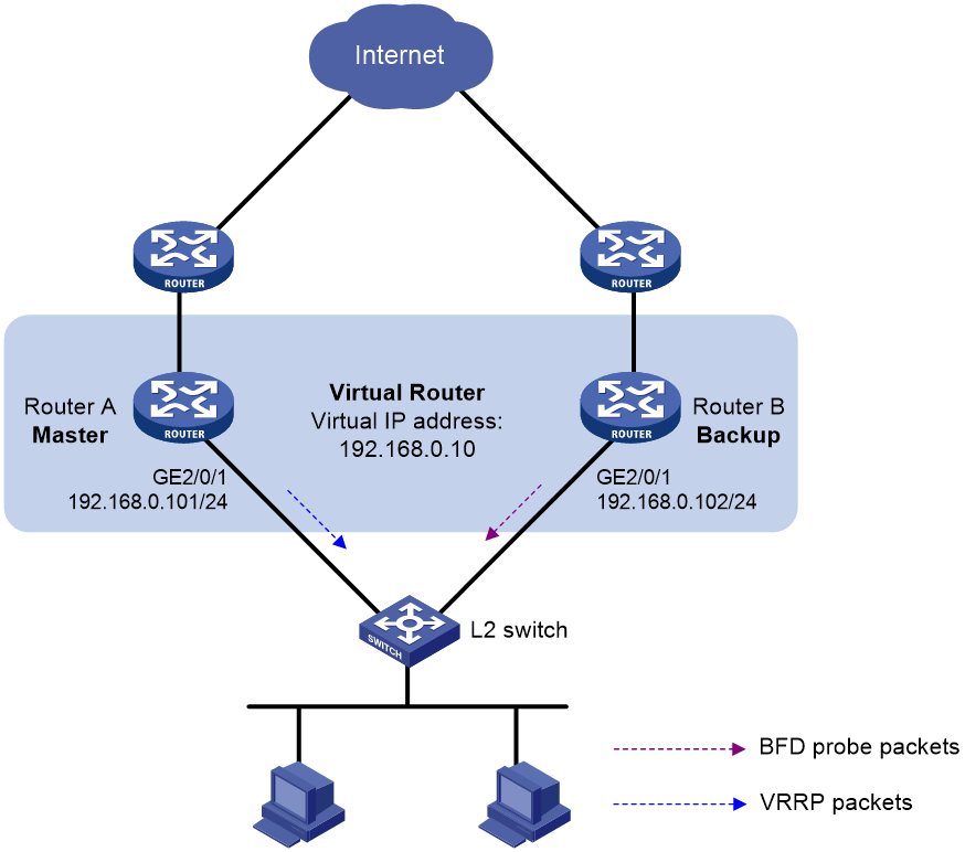

Example: Configuring BFD for a VRRP backup to monitor the master
As shown in Figure 3:
·     Router A and Router B belong to VRRP group 1. The virtual IP address of VRRP group 1 is 192.168.0.10.
·     The default gateway of the hosts in the LAN is 192.168.0.10.
Configure VRRP-Track-BFD collaboration to monitor the master on the backup and meet the following requirements:
·     When Router A operates correctly, the hosts in the LAN access the Internet through Router A.
·     When Router A fails, the backup (Router B) can detect the state change of the master through BFD and become the new master. The hosts in the LAN access the Internet through Router B.
Figure 3 Network diagram
1.     Configure Router A:
# Create VRRP group 1, and configure virtual IP address 192.168.0.10 for the group.
[RouterA-GigabitEthernet2/0/1] vrrp vrid 1 virtual-ip 192.168.0.10
[RouterA-GigabitEthernet2/0/1] return
2.     Configure Router B:
# Specify 10.10.10.10 as the source address of BFD echo packets.
[RouterB] bfd echo-source-ip 10.10.10.10
# Create track entry 1, and associate it with the BFD session to verify the reachability of Router A.
[RouterB] track 1 bfd echo interface gigabitethernet 2/0/1 remote ip 192.168.0.101 local ip 192.168.0.102
[RouterB-track-1] quit
[RouterB-GigabitEthernet2/0/1] vrrp vrid 1 virtual-ip 192.168.0.10
# Configure VRRP group 1 to monitor the status of track entry 1.
[RouterB-GigabitEthernet2/0/1] vrrp vrid 1 track 1 switchover
[RouterB-GigabitEthernet2/0/1] return
<RouterA> display vrrp verbose
     VRID             : 1               Adver Timer  : 100
     Preempt Mode     : Yes             Delay Time   : 0
     Auth Type        : None
     Version          : 2
     Virtual IP       : 192.168.0.10
     Master IP        : 192.168.0.101
<RouterB> display vrrp verbose
     Auth Type        : None
     Version          : 2
     Track Object   : 1              State : Positive          Switchover
# Display information about track entry 1 on Router B.
<RouterB> display track 1
Track ID: 1
  State: Positive
  Duration: 0 days 0 hours 0 minutes 32 seconds
  Tracked object type: BFD
  Notification delay: Positive 0, Negative 0 (in seconds)
  Tracked object:
    BFD session mode: Echo
    Outgoing Interface: GigabitEthernet2/0/1
    VPN instance name: --
    Remote IP: 192.168.0.101
    Local IP: 192.168.0.102
The output shows that when the status of the track entry becomes Positive, Router A is the master, and Router B the backup.
# Enable VRRP state debugging and BFD event notification debugging on Router B.
<RouterB> terminal debugging
<RouterB> terminal monitor
<RouterB> debugging vrrp fsm
<RouterB> debugging bfd ntfy
# When Router A fails, the following output is displayed on Router B.
*Dec 17 14:44:34:142 2008 RouterB BFD/7/DEBUG: Notify application:TRACK State:DOWN
*Dec 17 14:44:34:144 2008 RouterB VRRP4/7/FSM
 IPv4 GigabitEthernet2/0/1 | Virtual Router 1 : Backup --> Master   reason: The status of the tracked object changed
# Display detailed information about the VRRP group on Router B.
     Auth Type        : None
     Version          : 2
     Master IP        : 192.168.0.102
     Track Object   : 1              State : Negative          Switchover
The output shows that when BFD detects that Router A fails, the Track module notifies VRRP to change the status of Router B to master. The backup can quickly preempt as the master without waiting for a period three times the advertisement interval plus the Skew_Time.
Example: Configuring BFD for the VRRP master to monitor the uplink
As shown in Figure 4:
Configure VRRP-Track-BFD collaboration to monitor the uplink on the master and meet the following requirements:
·     When Router A operates correctly, hosts in the LAN access the Internet through Router A.
·     When Router A detects that the uplink is down through BFD, Router B can preempt as the master. The hosts in the LAN can access the Internet through Router B.
Figure 4 Network diagram

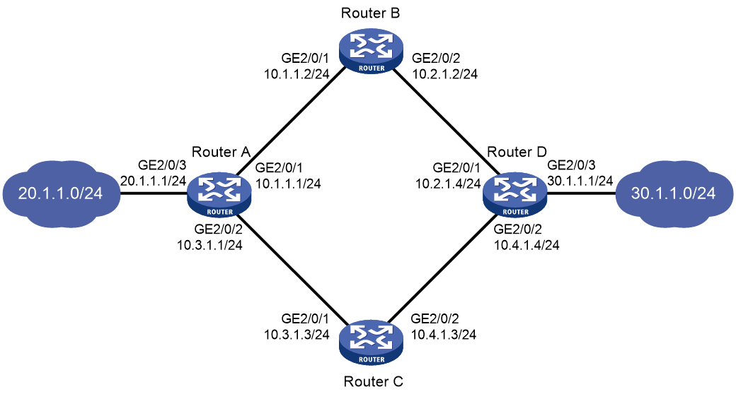

Example: Configuring static routing-Track-NQA collaboration
As shown in Figure 5:
·     Router A is the default gateway of the hosts in network 20.1.1.0/24.
·     Router D is the default gateway of the hosts in network 30.1.1.0/24.
·     Hosts in the two networks communicate with each other through static routes.
To ensure network availability, configure route backup and static routing-Track-NQA collaboration on Router A and Router D as follows:
·     On Router A, assign a higher priority to the static route to 30.1.1.0/24 with next hop Router B. This route is the master route. The static route to 30.1.1.0/24 with the next hop Router C acts as the backup route. When the master route is unavailable, the backup route takes effect.
·     On Router D, assign a higher priority to the static route to 20.1.1.0/24 with next hop Router B. This route is the master route. The static route to 20.1.1.0/24 with next hop Router C acts as the backup route. When the master route is unavailable, the backup route takes effect.
Figure 5 Network diagram

Example: Configuring static routing-Track-BFD collaboration
As shown in Figure 6:
·     Router B is the default gateway of the hosts in network 30.1.1.0/24.
To ensure network availability, configure route backup and static routing-Track-BFD collaboration on Router A and Router B as follows:
·     On Router A, assign a higher priority to the static route to 30.1.1.0/24 with next hop Router B. This route is the master route. The static route to 30.1.1.0/24 with next hop Router C acts as the backup route. When the master route is unavailable, BFD can quickly detect the route failure to make the backup route take effect.
·     On Router B, assign a higher priority to the static route to 20.1.1.0/24 with next hop Router A. This route is the master route. The static route to 20.1.1.0/24 with next hop Router C acts as the backup route. When the master route is unavailable, BFD can quickly detect the route failure to make the backup route take effect.
Figure 6 Network diagram
1.     Configure the IP address of each interface, as shown in Figure 6. (Details not shown.)
2.     Configure Router A:
# Configure a static route to 30.1.1.0/24 with next hop 10.2.1.2 and the default priority (60). Associate this static route with track entry 1.
[RouterA] ip route-static 30.1.1.0 24 10.2.1.2 track 1
# Configure a static route to 30.1.1.0/24 with next hop 10.3.1.3 and priority 80.
[RouterA] ip route-static 30.1.1.0 24 10.3.1.3 preference 80
[RouterA] bfd echo-source-ip 10.10.10.10
# Configure track entry 1, and associate it with the BFD session to verify the connectivity between Router A and Router B.
[RouterA] track 1 bfd echo interface gigabitethernet 2/0/1 remote ip 10.2.1.2 local ip 10.2.1.1
3.     Configure Router B:
# Configure a static route to 20.1.1.0/24 with next hop 10.2.1.1 and default priority (60). Associate this static route with track entry 1.
[RouterB] ip route-static 20.1.1.0 24 10.2.1.1 track 1
# Configure a static route to 20.1.1.0/24 with next hop 10.4.1.3 and the priority 80.
[RouterB] ip route-static 20.1.1.0 24 10.4.1.3 preference 80
# Specify 1.1.1.1 as the source address of BFD echo packets.
[RouterB] bfd echo-source-ip 1.1.1.1
# Configure track entry 1, and associate it with the BFD session to verify the connectivity between Router B and Router A.
[RouterB] track 1 bfd echo interface gigabitethernet 2/0/1 remote ip 10.2.1.1 local ip 10.2.1.2
4.     Configure Router C:
# Configure a static route to 30.1.1.0/24 with next hop 10.4.1.2.
<RouterC> system-view
[RouterC] ip route-static 30.1.1.0 24 10.4.1.2
# Configure a static route to 20.1.1.0/24 with next hop 10.3.1.1.
[RouterC] ip route-static 20.1.1.0 24 10.3.1.1
# Display information about the track entry on Router A.
[RouterA] display track all
Track ID: 1
  State: Positive
  Tracked object:
    Outgoing interface: GigabitEthernet2/0/1
    Remote IP: 10.2.1.2
    Local IP: 10.2.1.1
The output shows that the status of the track entry is Positive, indicating that next hop 10.2.1.2 is reachable.
# Display the routing table of Router A.
[RouterA] display ip routing-table
Destinations : 9        Routes : 9
Destination/Mask    Proto  Pre  Cost         NextHop         Interface
10.2.1.0/24         Direct 0    0            10.2.1.1        GE2/0/1
10.2.1.1/32         Direct 0    0            127.0.0.1       InLoop0
10.3.1.0/24         Direct 0    0            10.3.1.1        GE2/0/2
10.3.1.1/32         Direct 0    0            127.0.0.1       InLoop0
20.1.1.0/24         Direct 0    0            20.1.1.1        GE2/0/3
20.1.1.1/32         Direct 0    0            127.0.0.1       InLoop0
30.1.1.0/24         Static 60   0            10.2.1.2        GE2/0/1
127.0.0.0/8         Direct 0    0            127.0.0.1       InLoop0
127.0.0.1/32        Direct 0    0            127.0.0.1       InLoop0
The output shows that Router A forwards packets to 30.1.1.0/24 through Router B. The master static route has taken effect.
# Remove the IP address of GigabitEthernet 2/0/1 on Router B.
[RouterB-GigabitEthernet2/0/1] undo ip address
Track ID: 1
  State: Negative
  Tracked object:
    Remote IP: 10.2.1.2
    Local IP: 10.2.1.1
The output shows that the status of the track entry is Negative, indicating that next hop 10.2.1.2 is unreachable.
30.1.1.0/24         Static 80   0            10.3.1.3        GE2/0/2
The output shows that Router A forwards packets to 30.1.1.0/24 through Router C. The backup static route has taken effect.
# Verify that the hosts in 20.1.1.0/24 can communicate with the hosts in 30.1.1.0/24 when the master route fails.
[RouterA] ping -a 20.1.1.1 30.1.1.1
Ping 30.1.1.1: 56  data bytes, press CTRL_C to break
Reply from 30.1.1.1: bytes=56 Sequence=1 ttl=254 time=2 ms
Reply from 30.1.1.1: bytes=56 Sequence=2 ttl=254 time=1 ms
Reply from 30.1.1.1: bytes=56 Sequence=3 ttl=254 time=1 ms
Reply from 30.1.1.1: bytes=56 Sequence=4 ttl=254 time=2 ms
Reply from 30.1.1.1: bytes=56 Sequence=5 ttl=254 time=1 ms
--- Ping statistics for 30.1.1.1 ---
5 packet(s) transmitted, 5 packet(s) received, 0.00% packet loss
round-trip min/avg/max/std-dev = 1/1/2/1 ms
# Verify that the hosts in 30.1.1.0/24 can communicate with the hosts in 20.1.1.0/24 when the master route fails.
[RouterB] ping -a 30.1.1.1 20.1.1.1
Ping 20.1.1.1: 56  data bytes, press CTRL_C to break
Reply from 20.1.1.1: bytes=56 Sequence=1 ttl=254 time=2 ms
Reply from 20.1.1.1: bytes=56 Sequence=2 ttl=254 time=1 ms
Reply from 20.1.1.1: bytes=56 Sequence=3 ttl=254 time=1 ms
Reply from 20.1.1.1: bytes=56 Sequence=4 ttl=254 time=1 ms
Reply from 20.1.1.1: bytes=56 Sequence=5 ttl=254 time=1 ms
--- Ping statistics for 20.1.1.1 ---
Example: Configuring VRRP-Track-interface management collaboration
As shown in Figure 7:
Configure VRRP-Track-interface management collaboration to monitor the uplink interface on the master and meet the following requirements:
·     When Router A operates correctly, Router A forwards packets from Host A to Host B.
·     When VRRP detects a fault on the uplink interface of Router A through the interface management module, Router B forwards packets from Host A to Host B.
Figure 7 Network diagram
1.     Configure the IP address of each interface, as shown in Figure 7. (Details not shown.)
# Configure track entry 1, and associate it with the link status of the uplink interface GigabitEthernet 2/0/2.
[RouterA] track 1 interface gigabitethernet 2/0/2
3.     On Router B, create VRRP group 1, and configure virtual IP address 10.1.1.10 for the group.
     Auth Type        : None
     Version          : 2
     Auth Type        : None
     Version          : 2
# Shut down the uplink interface GigabitEthernet 2/0/2 on Router A.
[RouterA-GigabitEthernet2/0/1] interface gigabitethernet 2/0/2
[RouterA-GigabitEthernet2/0/2] shutdown
