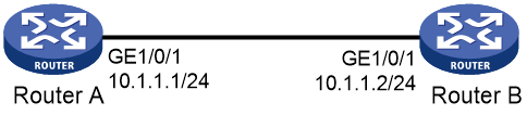

Example: Configuring the Layer 3 connection keepalive feature
As shown in Figure 1, configure the Layer 3 connection keepalive feature on Router A to meet the following requirements:
· Router A sends Layer 3 packets to Router B when Router B works correctly.
· Router A stops sending Layer 3 packets to Router B when Router B becomes abnormal.
1. Assign IP addresses to the interfaces, as shown in Figure 1. (Details not shown.)
2. Configuring the ARP NQA operation.
# Create an ARP operation.
<RouterA> system-view
[RouterA] nqa entry admin test1
[RouterA-nqa-admin-test1] type arp
# Specify 10.1.1.2 as the destination IP address of ARP requests.
[RouterA-nqa-admin-test1-arp] destination ip 10.1.1.2
# Create reaction entry 1. If the number of consecutive probe failures reaches 3, collaboration is triggered.
[RouterA-nqa-admin-test1-arp] reaction 1 checked-element probe-fail threshold-type consecutive 3 action-type trigger-only
[RouterA-nqa-admin-test1-arp] quit
# Start the ARP operation.
[RouterA] nqa schedule admin test1 start-time now lifetime forever
3. Create track entry 1 and associate it with reaction entry 1 of NQA operation admin test1.
[RouterA] track 1 nqa entry admin test1 reaction 1
[RouterA-track-1] quit
4. Enable the Layer 3 connection keepalive feature and associate track entry 1 with the feature on GigabitEthernet 2/0/1.
[RouterA] interface gigabitethernet 2/0/1
[RouterA-GigabitEthernet2/0/1] l3-keepalive track 1
[RouterA-GigabitEthernet2/0/1] quit
# Verify the Layer 3 connection keepalive feature.
[RouterA] display l3-keepalive
Interface Track ID State
GE2/0/1 1 Positive
The output shows that the track entry associated with the feature is in Positive state, which means that Router B works correctly.
# Delete the IP address of GigabitEthernet 2/0/1 on Router B, and execute the display l3-keepalive command after a period of time.
GE2/0/1 1 Negative
The output shows that the track entry associated with the feature is in Negative state, which means that Router B becomes abnormal. In this case, GigabitEthernet 2/0/1 on Switch A stops sending Layer 3 packets to the peer interface.
