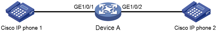

LLDP exchanges packets between neighbor agents and creates and maintains neighbor information for them. Figure 1 shows the neighbor relationships for these LLDP agents.
Figure 1 LLDP neighbor relationships

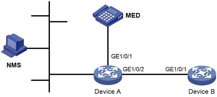

Example: Configuring basic LLDP functions
As shown in Figure 5, enable LLDP globally on Device A and Device B to perform the following tasks:
·     Monitor the link between Device A and Device B on the NMS.
·     Monitor the link between Device A and the MED device on the NMS.
Figure 5 Network diagram
1.     Configure Device A:
# Enable LLDP globally.
<DeviceA> system-view
[DeviceA] lldp global enable
# Enable LLDP on GigabitEthernet 1/0/1. By default, LLDP is enabled on all ports.
[DeviceA-GigabitEthernet1/0/1] lldp enable
# Set the LLDP operating mode to Rx on GigabitEthernet 1/0/1.
[DeviceA-GigabitEthernet1/0/1] lldp admin-status rx
[DeviceA-GigabitEthernet1/0/1] quit
# Enable LLDP on GigabitEthernet 1/0/2. By default, LLDP is enabled on all ports.
[DeviceA] interface gigabitethernet 1/0/2
[DeviceA-GigabitEthernet1/0/2] lldp enable
# Set the LLDP operating mode to Rx on GigabitEthernet 1/0/2.
[DeviceA-GigabitEthernet1/0/2] lldp admin-status rx
[DeviceA-GigabitEthernet1/0/2] quit
2.     Configure Device B:
<DeviceB> system-view
[DeviceB] lldp global enable
[DeviceB-GigabitEthernet1/0/1] lldp enable
# Set the LLDP operating mode to Tx on GigabitEthernet 1/0/1.
[DeviceB-GigabitEthernet1/0/1] lldp admin-status tx
[DeviceB-GigabitEthernet1/0/1] quit
# Verify the following items:
·     GigabitEthernet 1/0/1 of Device A connects to a MED device.
·     GigabitEthernet 1/0/2 of Device A connects to a non-MED device.
·     Both ports operate in Rx mode, and they can receive LLDP frames but cannot send LLDP frames.

Example: Configuring CDP-compatible LLDP
As shown in Figure 6, GigabitEthernet 1/0/1 and GigabitEthernet 1/0/2 of Device A are each connected to a Cisco IP phone, which sends tagged voice traffic.
Configure voice VLAN 2 on Device A. Enable CDP compatibility of LLDP on Device A to allow the Cisco IP phones to automatically configure the voice VLAN. The voice VLAN feature confines the voice traffic to the voice VLAN and isolates the voice traffic from other types of traffic.
Figure 6 Network diagram
1.     Configure a voice VLAN on Device A:
# Create VLAN 2.
[DeviceA] vlan 2
[DeviceA-vlan2] quit
# Set the link type of GigabitEthernet 1/0/1 and GigabitEthernet 1/0/2 to trunk, and enable voice VLAN on them.
[DeviceA-GigabitEthernet1/0/1] port link-type trunk
[DeviceA-GigabitEthernet1/0/1] voice-vlan 2 enable
[DeviceA-GigabitEthernet1/0/2] port link-type trunk
[DeviceA-GigabitEthernet1/0/2] voice-vlan 2 enable
2.     Configure CDP-compatible LLDP on Device A:
# Enable LLDP globally, and enable CDP compatibility globally.
[DeviceA] lldp compliance cdp
# Configure LLDP to operate in TxRx mode on GigabitEthernet 1/0/1.
[DeviceA-GigabitEthernet1/0/1] lldp admin-status txrx
# Configure CDP-compatible LLDP to operate in TxRx mode on GigabitEthernet 1/0/1.
[DeviceA-GigabitEthernet1/0/1] lldp compliance admin-status cdp txrx
# Configure LLDP to operate in TxRx mode on GigabitEthernet 1/0/2.
[DeviceA-GigabitEthernet1/0/2] lldp admin-status txrx
# Configure CDP-compatible LLDP to operate in TxRx mode on GigabitEthernet 1/0/2.
[DeviceA-GigabitEthernet1/0/2] lldp compliance admin-status cdp txrx
# Verify that Device A has completed the following operations:
·     Discovering the IP phones connected to GigabitEthernet 1/0/1 and GigabitEthernet 1/0/2.
·     Obtaining IP phone information.
[DeviceA] display lldp neighbor-information
CDP neighbor-information of port 1[GigabitEthernet1/0/1]:
LLDP agent nearest-bridge:
 CDP neighbor index  : 1
 Chassis ID          : SEP00141CBCDBFE
 Port ID             : Port 1
CDP neighbor-information of port 2[GigabitEthernet1/0/2]:
 CDP neighbor index  : 2
 Chassis ID          : SEP00141CBCDBFF
 Port ID             : Port 1
