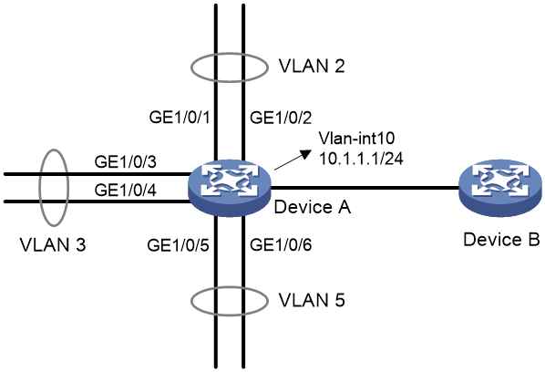

Example: Configuring a super VLAN
As shown in Figure 3:
·     GigabitEthernet 1/0/1 and GigabitEthernet 1/0/2 are in VLAN 2.
·     GigabitEthernet 1/0/3 and GigabitEthernet 1/0/4 are in VLAN 3.
·     GigabitEthernet 1/0/5 and GigabitEthernet 1/0/6 are in VLAN 5.
To save IP addresses and enable sub-VLANs to be isolated at Layer 2 but interoperable at Layer 3, perform the following tasks:
·     Create a super VLAN and assign an IP address to its VLAN interface.
·     Associate the super VLAN with VLANs 2, 3, and 5.
Figure 3 Network diagram

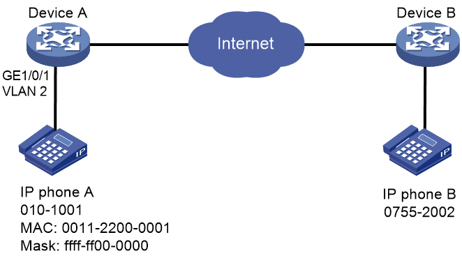

Advertising the voice VLAN information to IP phones
Figure 4 shows the workflow of advertising the voice VLAN information to IP phones.
Figure 4 Workflow of advertising the voice VLAN information to IP phones
IP phone access methods
Connecting the host and the IP phone in series
As shown in Figure 5, the host is connected to the IP phone, and the IP phone is connected to the device. In this scenario, the following requirements must be met:
·     The host and the IP phone use different VLANs.
·     The IP phone is able to send out VLAN-tagged packets, so that the device can differentiate traffic from the host and the IP phone.
·     The port connecting to the IP phone forwards packets from the voice VLAN and the PVID.
Figure 5 Connecting the host and IP phone in series
Connecting the IP phone to the device
As shown in Figure 6, IP phones are connected to the device without the presence of the host. Use this connection method when IP phones sends out untagged voice packets. In this scenario, you must configure the voice VLAN as the PVID of the access port of the IP phone, and configure the port to forward the packets from the PVID.
Figure 6 Connecting the IP phone to the device

As shown in Figure 7, Device A transmits traffic from IP phones and hosts.
For correct voice traffic transmission, perform the following tasks on Device A:
·     Configure voice VLANs 2 and 3 to transmit voice packets from IP phone A and IP phone B, respectively.
·     Configure GigabitEthernet 1/0/1 and GigabitEthernet 1/0/2 to operate in automatic voice VLAN assignment mode.
·     Add MAC addresses of IP phones A and B to the device for voice packet identification. The mask of the two MAC addresses is FFFF-FF00-0000.
·     Set an aging timer for voice VLANs.
Figure 7 Network diagram
1.     Configure voice VLANs:
# Create VLANs 2 and 3.
<DeviceA> system-view
[DeviceA] vlan 2 to 3
# Set the voice VLAN aging timer to 30 minutes.
[DeviceA] voice-vlan aging 30
# Enable security mode for voice VLANs.
[DeviceA] voice-vlan security enable
# Add MAC addresses of IP phones A and B to the device with mask FFFF-FF00-0000.
[DeviceA] voice-vlan mac-address 0011-1100-0001 mask ffff-ff00-0000 description IP phone A
[DeviceA] voice-vlan mac-address 0011-2200-0001 mask ffff-ff00-0000 description IP phone B

Example: Configuring manual voice VLAN assignment mode
As shown in Figure 8, IP phone A send untagged voice traffic.
To enable GigabitEthernet 1/0/1 to transmit only voice packets, perform the following tasks on Device A:
·     Create VLAN 2. This VLAN will be used as a voice VLAN.
·     Configure GigabitEthernet 1/0/1 to operate in manual voice VLAN assignment mode and add it to VLAN 2.
·     Add the OUI address of IP phone A to the OUI list of Device A.
Figure 8 Network diagram
