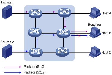

As shown in Figure 2, the network has two multicast sources: Source 1 (S1) and Source 2 (S2). Both of these sources can send multicast data to the multicast group G. Host B wants to receive the multicast data addressed to G from Source 1 but not from Source 2.
Figure 2 Flow paths of source-and-group-specific multicast traffic
In IGMPv1 or IGMPv2, Host B cannot select multicast sources when it joins the multicast group G. The multicast streams from both Source 1 and Source 2 flow to Host B whether or not it needs them.
In IGMPv3, Host B can explicitly express that it needs to receive multicast data destined to the multicast group G from Source 1 but not from Source 2.

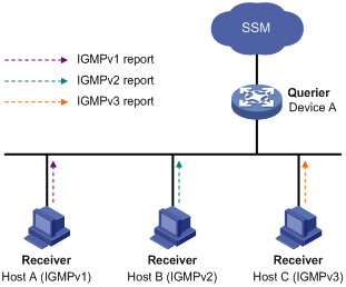

An IGMPv3 host can explicitly specify multicast sources in its IGMPv3 reports. From the reports, the IGMP device can obtain the multicast source addresses and directly provide the SSM service. However, an IGMPv1 or IGMPv2 host cannot specify multicast sources in its IGMPv1 or IGMPv2 reports.
The IGMP SSM mapping feature enables the IGMP device to provide SSM support for IGMPv1 or IGMPv2 hosts. The device translates (*, G) in IGMPv1 or IGMPv2 reports into (G, INCLUDE, (S1, S2...)) based on the configured IGMP SSM mappings.
Figure 3 IGMP SSM mapping
As shown in Figure 3, on an SSM network, Host A, Host B, and Host C run IGMPv1, IGMPv2, and IGMPv3, respectively. To provide the SSM service for Host A and Host B, you must configure the IGMP SSM mapping feature on Device A.
After IGMP SSM mappings are configured, Device A checks the multicast group address G in the received IGMPv1 or IGMPv2 report, and performs the following operations:
·     If G is not in the SSM group range, Device A provides the ASM service.
·     If G is in the SSM group range but does not match any IGMP SSM mapping, Device A drops the report.
·     If G is in the SSM group range and matches IGMP SSM mappings, Device A translates (*, G) in the report into (G, INCLUDE, (S1, S2...)) to provide SSM services.
The IGMP SSM mapping feature does not process IGMPv3 reports.

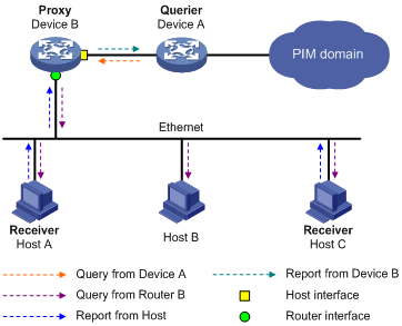

As shown in Figure 4, in a simple tree-shaped topology, it is not necessary to run multicast routing protocols, such as PIM, on edge devices. Instead, you can configure IGMP proxying on these devices. With IGMP proxying configured, the edge device acts as an IGMP proxy:
·     For the upstream IGMP querier, the IGMP proxy device acts as a host.
·     For the downstream receiver hosts, the IGMP proxy device acts as an IGMP querier.
Figure 4 IGMP proxying
The following types of interfaces are defined in IGMP proxying:
·     Host interface—An interface that is in the direction toward the root of the multicast forwarding tree. A host interface acts as a receiver host that is running IGMP. IGMP proxying must be enabled on this interface. This interface is also called the "proxy interface."
·     Router interface—An interface that is in the direction toward the leaf of the multicast forwarding tree. A router interface acts as a router that is running IGMP. IGMP must be configured on this interface.
An IGMP proxy device maintains a group membership database, which stores the group memberships on all the router interfaces. The host interfaces and router interfaces perform actions based on this membership database.
·     The host interfaces respond to queries according to the membership database or send join/leave messages when the database changes.
·     The router interfaces participate in the querier election, send queries, and maintain memberships based on received IGMP reports.

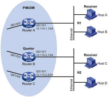

Example: Configuring basic IGMP features
As shown in Figure 5:
·     OSPF and PIM-DM run on the network.
·     VOD streams are sent to receiver hosts in multicast. Receiver hosts of different organizations form stub networks N1 and N2. Host A and Host C are receiver hosts in N1 and N2, respectively.
·     IGMPv2 runs between Router A and N1, and between the other two routers and N2. Router A acts as the IGMP querier in N1. Router B acts as the IGMP querier in N2 because it has a lower IP address.
Configure the routers to meet the following requirements:
·     The hosts in N1 can join only multicast group 224.1.1.1.
·     The hosts in N2 can join any multicast groups.
Figure 5 Network diagram
1.     Assign an IP address and subnet mask to each interface, as shown in Figure 5. (Details not shown.)
2.     Configure OSPF on the routers in the PIM-DM domain. (Details not shown.)
3.     Enable IP multicast routing, and enable IGMP and PIM-DM:
# On Router A, enable IP multicast routing.
<RouterA> system-view
[RouterA] multicast routing
[RouterA-mrib] quit
# Enable IGMP on GigabitEthernet 1/0/1.
[RouterA] interface gigabitethernet 1/0/1
[RouterA-GigabitEthernet1/0/1] igmp enable
[RouterA-GigabitEthernet1/0/1] quit
# Enable PIM-DM on GigabitEthernet 1/0/2.
[RouterA] interface gigabitethernet 1/0/2
[RouterA-GigabitEthernet1/0/2] pim dm
[RouterA-GigabitEthernet1/0/2] quit
# On Router B, enable IP multicast routing.
<RouterB> system-view
[RouterB] multicast routing
[RouterB-mrib] quit
[RouterB-GigabitEthernet1/0/1] igmp enable
[RouterB-GigabitEthernet1/0/1] quit
[RouterB] interface gigabitethernet 1/0/2
[RouterB-GigabitEthernet1/0/2] pim dm
[RouterB-GigabitEthernet1/0/2] quit
# On Router C, enable IP multicast routing.
<RouterC> system-view
[RouterC] multicast routing
[RouterC-mrib] quit
[RouterC] interface gigabitethernet 1/0/1
[RouterC-GigabitEthernet1/0/1] igmp enable
[RouterC-GigabitEthernet1/0/1] quit
[RouterC] interface gigabitethernet 1/0/2
[RouterC-GigabitEthernet1/0/2] pim dm
[RouterC-GigabitEthernet1/0/2] quit
4.     Configure a multicast group policy on Router A so that the hosts connected to GigabitEthernet 1/0/1 can join only multicast group 224.1.1.1.
[RouterA] acl basic 2001
[RouterA-acl-ipv4-basic-2001] rule permit source 224.1.1.1 0
[RouterA-acl-ipv4-basic-2001] quit
[RouterA-GigabitEthernet1/0/1] igmp group-policy 2001
# Display IGMP information for GigabitEthernet 1/0/1 on Router B.
[RouterB] display igmp interface gigabitethernet 1/0/1
 GigabitEthernet1/0/1(10.110.2.1):
   IGMP is enabled.
   IGMP version: 2
   Query interval for IGMP: 125s
   Other querier present time for IGMP: 255s
   Maximum query response time for IGMP: 10s
   Querier for IGMP: 10.110.2.1 (This router)
  IGMP groups reported in total: 1

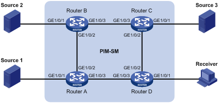

Example: Configuring IGMP SSM mapping
As shown in Figure 6:
·     OSPF runs on the network.
·     The PIM-SM domain uses the SSM model for multicast delivery. The SSM group range is 232.1.1.0/24.
·     IGMPv3 runs on GigabitEthernet 1/0/1 on Router D. The receiver host runs IGMPv2, and does not support IGMPv3. The receiver host cannot specify multicast sources in its membership reports.
·     Source 1, Source 2, and Source 3 send multicast packets to multicast groups in the SSM group range 232.1.1.0/24.
Configure the IGMP SSM mapping feature on Router D so that the receiver host can receive multicast data only from Source 1 and Source 3.
Figure 6 Network diagram
Device
Interface
IP address
Device
Interface
IP address
Source 1
133.133.1.1/24
Source 3
133.133.3.1/24
Source 2
133.133.2.1/24
Receiver
133.133.4.1/24
Router A
GE1/0/1
133.133.1.2/24
Router C
GE1/0/1
133.133.3.2/24
Router A
GE1/0/2
192.168.1.1/24
Router C
GE1/0/2
192.168.3.1/24
Router A
GE1/0/3
192.168.4.2/24
Router C
GE1/0/3
192.168.2.2/24
Router B
GE1/0/1
133.133.2.2/24
Router D
GE1/0/1
133.133.4.2/24
Router B
GE1/0/2
192.168.1.2/24
Router D
GE1/0/2
192.168.3.2/24
Router B
GE1/0/3
192.168.2.1/24
Router D
GE1/0/3
192.168.4.1/24
1.     Assign an IP address and subnet mask to each interface, as shown in Figure 6. (Details not shown.)
2.     Configure OSPF on the routers in the PIM-SM domain. (Details not shown.)
3.     Enable IP multicast routing, PIM-SM, and IGMP:
# On Router D, enable IP multicast routing.
<RouterD> system-view
[RouterD] multicast routing
[RouterD-mrib] quit
# Enable IGMPv3 on the receiver-side interface (GigabitEthernet 1/0/1).
[RouterA-mrib] quit
# Enable PIM-SM on each interface.
[RouterA-GigabitEthernet1/0/1] pim sm
[RouterA-GigabitEthernet1/0/2] pim sm
[RouterA] interface gigabitethernet 1/0/3
[RouterA-GigabitEthernet1/0/3] pim sm
[RouterA-GigabitEthernet1/0/3] quit
# Configure Router B and Router C in the same way Router A is configured. (Details not shown.)
4.     Configure the SSM group range:
# On Router D, specify 232.1.1.0/24 as the SSM group range.
[RouterD] acl basic 2000
[RouterD-acl-ipv4-basic-2000] rule permit source 232.1.1.0 0.0.0.255
[RouterD-acl-ipv4-basic-2000] quit
[RouterD] pim
[RouterD-pim] ssm-policy 2000
[RouterD-pim] quit
# Configure the SSM group range on Router A, Router B, and Router C in the same way Router D is configured. (Details not shown.)
5.     Configure IGMP SSM mappings on Router D.
[RouterD] igmp
[RouterD-igmp] ssm-mapping 133.133.1.1 2000
[RouterD-igmp] ssm-mapping 133.133.3.1 2000
[RouterD-igmp] quit
# Display IGMP SSM mappings for multicast group 232.1.1.1 on Router D.
[RouterD] display igmp ssm-mapping 232.1.1.1
 Group: 232.1.1.1
 Source list:
        133.133.1.1
        133.133.3.1
# On Router D, display information about IGMP multicast groups that hosts have dynamically joined.
[RouterD] display igmp group
IGMP groups in total: 1
 GigabitEthernet1/0/1(133.133.4.2):
   Group address   Last reporter   Uptime      Expires
   232.1.1.1       133.133.4.1     00:02:04    off
# Display PIM routing entries on Router D.
[RouterD] display pim routing-table
 Total 0 (*, G) entry; 2 (S, G) entry
 (133.133.1.1, 232.1.1.1)
     Protocol: pim-ssm, Flag:
     UpTime: 00:13:25
     Upstream interface: GigabitEthernet1/0/3
         Upstream neighbor: 192.168.4.2
         RPF prime neighbor: 192.168.4.2
     Downstream interface(s) information:
     Total number of downstreams: 1
         1: GigabitEthernet1/0/1
             Protocol: igmp, UpTime: 00:13:25, Expires: -
 (133.133.3.1, 232.1.1.1)
     UpTime: 00:13:25
     Upstream interface: GigabitEthernet1/0/2
         Upstream neighbor: 192.168.3.1
         RPF prime neighbor: 192.168.3.1

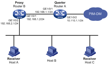

Example: Configuring IGMP proxying
As shown in Figure 7:
·     PIM-DM runs on the core network.
·     Host A and Host C on the stub network receive VOD information sent to multicast group 224.1.1.1.
Configure the IGMP proxying feature on Router B so that Router B can maintain group memberships and forward multicast traffic without running PIM-DM.
Figure 7 Network diagram
1.     Assign an IP address and subnet mask to each interface, as shown in Figure 7. (Details not shown.)
2.     Enable IP multicast routing, PIM-DM, IGMP, and IGMP proxying:
[RouterA-mrib] quit
[RouterB-mrib] quit
# Enable IGMP proxying on GigabitEthernet 1/0/1.
[RouterB-GigabitEthernet1/0/1] igmp proxy enable
# Enable IGMP on GigabitEthernet 1/0/2.
[RouterB-GigabitEthernet1/0/2] igmp enable
# Display multicast group membership information maintained by the IGMP proxy on Router B.
[RouterB] display igmp proxy group
IGMP proxy group records in total: 1
 GigabitEthernet1/0/1(192.168.1.2):
   Group address      Member state      Expires
   224.1.1.1          Delay             00:00:02
