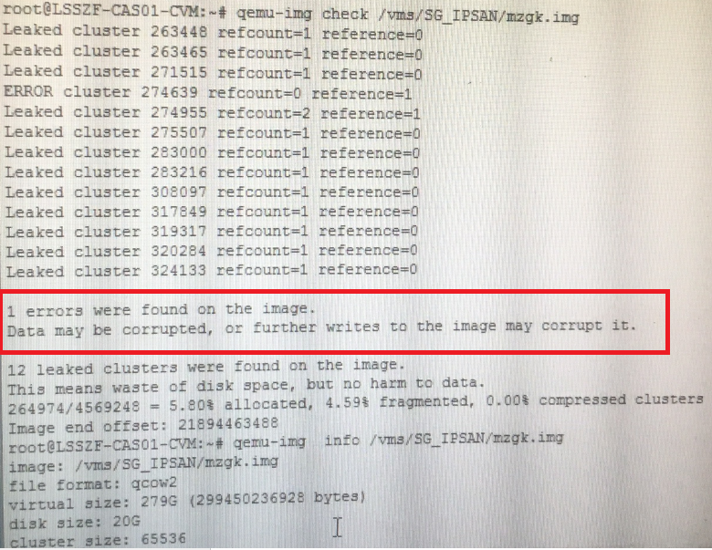

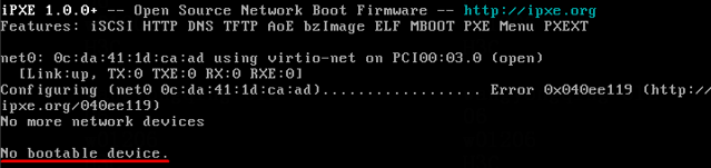

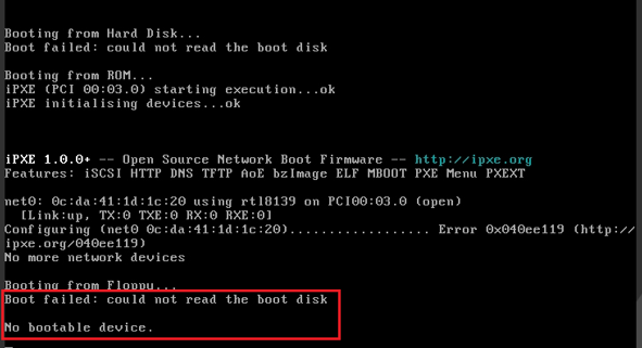

No boot disk can be found when a VM restarts
Symptom
No boot disk can be found when a VM restarts.
Impact
User services will be affected.
Analysis
The VM log contains the following information:
qcow2: Preventing invalid write on metadata (overlaps with snapshot table); image marked as corrupt.
Use the qemu-img check XXX command (where XXX represents the disk image) to check the VM disk image for errors.
Solution
Execute the qemu-img check -r all xxx command (where xxx represents the disk image) to restore the image file. Once the restoration is successful, the VM can start.
Before you resolve the issue, back up the image file in case you encounter this issue again in the future.

VM deployment partially succeeded
Symptom
The deployment result shows that the deployment partially succeeded with an error code of 7501.
Impact
The VM cannot run correctly.
Analysis
Error code 7501 typically results from the failure to run castools.py. Check the failure reason in the log /var/log/castools.log.
Common reasons include:
· The VM disk is damaged. libguestfs will check for disk partition information. If the disk is damaged, it cannot be mounted.
· CAStools is not installed on the VM correctly, and the qemu-ga service in the VM is abnormal.
Solution
· Execute the qemu-img check -r all xxx command (where xxx represents the disk image) to restore the image file.
· Reinstall CAStools.

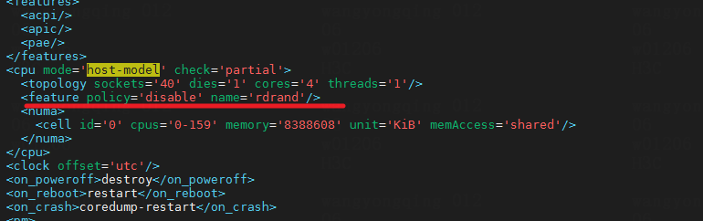

Soft lockup error displayed when a Centos 6.5/6.8 VM on a host that uses Hygon C86 7280 32-core CPUs starts
Symptom
When a Centos 6.5/6.8 VM on a host that uses Hygon C86 7280 32-core CPUs starts, a soft lockup error is displayed.
Impact
The VM fails to start.
Analysis
The get_random_bytes() function uses CPU instruction rdrand to obtain random numbers. When a VM is running in host matching mode or passthrough mode, there might be issues with the rdrand flag. This is primarily due to the instability of the rdrand instruction on AMD CPUs. In addition, the CentOS 6.8 kernel version used by the VM is outdated (version 2.6.32), and the Linux community has discontinued use of the rdrand feature in this kernel version.
PID: 1208 TASK: ffff8802374ff540 CPU: 0 COMMAND: "modprobe"
[exception RIP: get_random_bytes+41]
RIP: ffffffff81331419 RSP: ffff880236b6fcf8 RFLAGS: 00000203
RAX: ffffffffffffffff RBX: ffff880237f79cf0 RCX: 000000000000000a
RDX: 00000000000000ff RSI: 0000000000000008 RDI: ffff880237f79cf0
RBP: ffff880236b6fd38 R8: 0000000000000000 R9: 0000000000000180
R10: 0000000000000000 R11: 0000000000000000 R12: 0000000000000008
R13: ffff880237f79ce4 R14: ffff880237f79df0 R15: 0000000000000001
CS: 0010 SS: 0018
#0 [ffff880236b6fd40] __ipv6_regen_rndid at ffffffffa01559ed [ipv6]
#1 [ffff880236b6fd60] ipv6_regen_rndid at ffffffffa0157240 [ipv6]
#2 [ffff880236b6fd80] ipv6_add_dev at ffffffffa015753e [ipv6]
#3 [ffff880236b6fdb0] addrconf_notify at ffffffffa015a8e9 [ipv6]
#4 [ffff880236b6fe90] register_netdevice_notifier at ffffffff8145d9bf
#5 [ffff880236b6fee0] addrconf_init at ffffffffa019e3be [ipv6]
#6 [ffff880236b6ff00] init_module at ffffffffa019e198 [ipv6]
#7 [ffff880236b6ff20] do_one_initcall at ffffffff8100204c
#8 [ffff880236b6ff50] sys_init_module at ffffffff810bc291
#9 [ffff880236b6ff80] system_call_fastpath at ffffffff8100b072
RIP: 00007efef7b33eda RSP: 00007ffeffffb808 RFLAGS: 00010287
RAX: 00000000000000af RBX: ffffffff8100b072 RCX: 0000000000000030
RDX: 000000000261e6e0 RSI: 000000000008ad20 RDI: 00007efef7e12010
RBP: 00007ffeffffbb00 R8: 00007efef7e9cd30 R9: 00007efef7ff7700
R10: 00007ffeffffb770 R11: 0000000000000206 R12: 000000000261e6e0
R13: 0000000002625250 R14: 000000000261d550 R15: 000000000261e6e0
ORIG_RAX: 00000000000000af CS: 0033 SS: 002b
Solution
To resolve this issue, edit the CPU section in the VM's XML document to disable the rdrand feature.

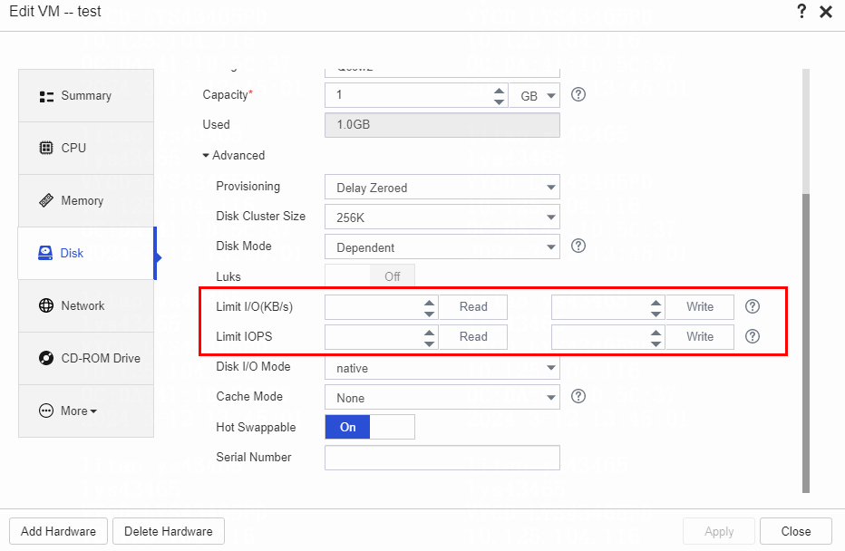

Solution
1. To resolve this issue, migrate the VMs to another storage pool and limit I/Os if required.
2. On the top navigation bar, click VMs. If multiple clusters exist in the system, you must also select a cluster from the left navigation pane.
3. Select a VM, click More in the VM card, and then select Edit. Alternatively, select the VM in the navigation pane, and then click Edit on the Summary tab.
4. On the Disk panel, set the I/O read and write rate limits and the IOPS read and write limits as needed.

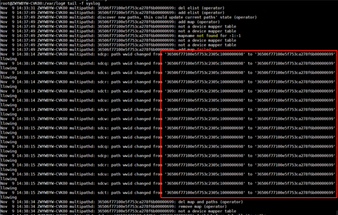

A multipath configuration failure is prompted when adding shared storage on the Web interface
Symptom
When you add a storage pool on the Web interface, the system prompts that multipath configuration failed and that please check or contact the administrator (Error code: 5106).
Impact
New storage pools cannot be added, affecting the deployment of user services.
Analysis
Check the system logs to identify whether the shared storage volume WWID recognized by UIS is consistent with the WWID set on the storage side. If they are inconsistent, it indicates that the volume is edited on the storage side after being mapped to UIS. As shown in the following figure, the WWID recognized by UIS ends with 698 while that on the storage side ends with 699.
Solution
Perform a forcible scan for storage on each host to re-recognize the configuration on the storage side.

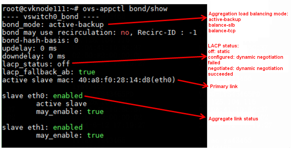

· Identify whether the vSwitch aggregation operates correctly.
As shown in the figure above, execute the ovs-appctl bond/show command to view the aggregation configuration of the vSwitch.
¡ If the vSwitch uses static active-backup aggregation, the physical switch does not require any aggregation group.
¡ If the vSwitch uses static load balancing aggregation, you must also configure a static aggregation group on the physical switch. If the aggregation configuration on the switch is inconsistent with that on the server, network forwarding failures occur.
¡ If the vSwitch uses dynamic aggregation, check the lacp_status field. If the field displays configured, it indicates that dynamic aggregation negotiation has failed. In this case, check the configuration of the physical switch's aggregation group, including the type of aggregation group, the correctness of the aggregation group's port members, and whether the ports are in select state.

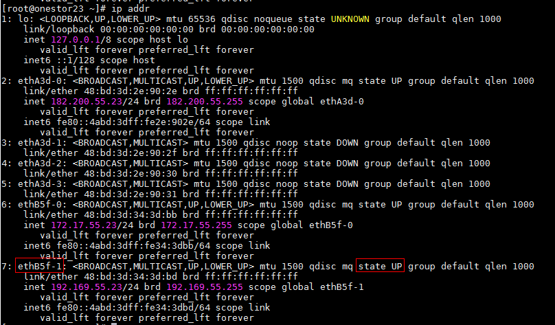

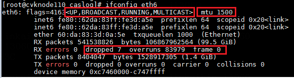

· Identify whether the physical NIC state of the vSwitch is correct. After identifying the physical NIC used by the vSwitch from the interface, execute the ifconfig ethx command to view the state of the NIC. For example:
In the output:
¡ <UP, BROADCAST, RUNNING, MULTICAST>—The NIC is in up state and can send and receive packages correctly.
¡ <UP,BROADCAST,MULTICAST>—The NIC is in up state at the software level but in down state at the link layer. In this case, execute the ip link show dev ethx command. If the NIC state displays NO-CARRIER, it indicates that the physical link of the NIC is down. Check the network cable connections. If it is a fiber optic card, replace the fiber optic cable or the transceiver.
¡ <BROADCAST,MULTICAST>—The NIC is in down state at the software level. Execute the ifup ethx or ip link set dev ethx up command to bring up the NIC at the software level.
· Identify whether the MTU of the NIC is correct. If the MTU configuration is incorrect, edit it on the vSwitch interface.
· Identify whether the NIC drops or misdirects packets. If yes, execute the ifconfig ethx, sleep 10, and ifconfig ethx commands to identify whether the number of dropped packets or that of error packets increases. If no, ignore the issue. If yes, perform further tasks to troubleshoot the issue.
¡ dropped—The package has entered the ring buffer but has been discarded due to insufficient memory or other system reasons when being copied to memory. Use the ethtool -G ethx rx xxx command to increase the NIC's ring buffer size. Note: Changing the NIC's ring buffer might temporarily disrupt the NIC. As a best practice, change it when no service is running.
¡ overruns—The ring buffer is full, causing the physical NIC to discard packets before they reach the ring buffer, usually due to the CPU's inability to timely process NIC interrupts. To resolve this issue, edit the interrupt affinity of the NIC to process interrupts on an idle CPU.
¡ frame—Number of received packets with CRC errors and being non-integer bytes long. As a best practice, replace the network cables or fiber optic cables and transceivers.
¡ errors—Total number of all received error packets, including ring buffer overflow, too-long-frames error s, CRC errors, and overruns.

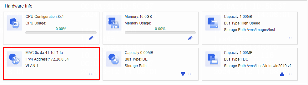

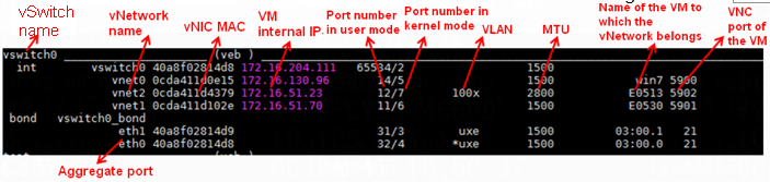

· Identify whether vNIC network configuration is correct. Execute the /opt/bin/ovs_dbg_listports command at the CLI on the CVK host to view the current network topology information, which is of significant importance for troubleshooting.
¡ Identify whether the VLAN configuration is correct. In the UIS virtualization network topology, locate the corresponding vnetx device using the VM's MAC address (obtainable through the management platform interface). Then, check the vNIC's VLAN configuration to ensure it meets the current network's service requirements.

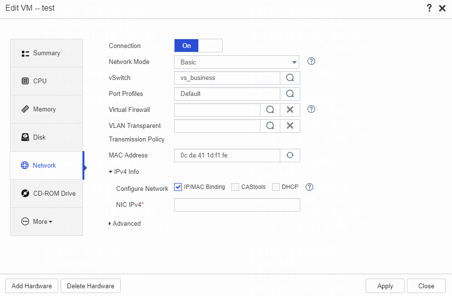

¡ Identify whether the IP/MAC binding is correct. On the Edit VM page of the management platform, enter the vNIC IP address to identify whether IP/MAC binding is configured for the vNIC.
Once a vNIC binds to an IP address, it can only transmit data packets using the bound IP. If it transmits data packets through another IP, the OVS flow table will intercept them.
As a best practice in scenarios where a VM has multiple IPs, remove the IP/MAC binding configuration. Also, verify that the bound IP address is consistent with the internal IP of the VM.

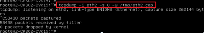

· If the issue persists after the above troubleshooting steps, capture packets to locate the packet loss issue.
The check_network script is a general packet capture script for UIS. To use it, follow these restrictions and guidelines:
check_network.sh
[--vswitch=xxx]//Specify the vSwitch for packet capture. By default, the script automatically captures packets from the vSwitch and its bound physical ports.
[--iface="vnet0,vnet1,vnet2,..."]//Specify the vnet device for packet capture.
[--iface_mac="0c:da:41:1d:f6:4b,0c:da:41:1d:1d:7d,..."]//Specify the VM NIC for packet capture by its MAC address.
[--ping=x.x.x.x]//Initiate a ping task on the device executing the script. You can specify only one IP address in the ping command.
[xxxxxxxxxxx]//Specify the packet capture filters to prevent the PCAP file from taking up too much space. Supported conditions are as shown in the following example. All the parameters mentioned above are optional. You can configure the parameters as needed.
Dump example:
ARP: arp and host x.x.x.x
ICMP: icmp and host x.x.x.x
ICMP6: icmp6 and host x:x::x:x
DNS: port domain
DHCP: udp and port 67 and port 68
SSH: port 22 and host x.x.x.x
LLDP: ether proto 0x88cc
LACP: ether proto 0x8809
Examples of how to use a script:
¡ Issue 1: Intermittent fault alarms on vswitch0. Perform the following tasks to capture packets:
- Execute the /home/test/check_network.sh --vswitch=vswitch0 --ping=172.23.51.112 "icmp and host 172.23.51.112” command on the problematic CVK host.
--vswitch=vswitch0: Specifies vSwitch vswitch0 to capture packets.
--ping=172.23.51.112: Enables the script to automatically initiate a ping task targeting 172.23.51.112. In practice, specify the IP address of the CVM host.
"icmp and host 172.23.51.112”: Specifies packet capture filters. In practice, specify the IP address of the CVM host.
- Execute the /home/test/check_network.sh --vswitch=vswitch0 "icmp and host 172.23.51.114” command on the CVM host.
No need for the --ping parameter, because a ping task has already been initiated on the CVK host.
--vswitch= vswitch0: Same as above.
"icmp and host 172.23.51.112": Specifies packet capture filters. In practice, specify the IP address of the CVK host.
¡ Issue 2: The VM experiences a significant surge in I/O in the early morning hours. Capture packets to identify which main services are running on the VM during the I/O surge.
- Execute the /home/check_network/check_network.sh --iface_mac="0c:da:41:1d:f6:4b,0c:da:41:1d:1d:7d” command on the CVK host where the VM resides.
-- iface_mac: Specifies the MAC address of the VM's NIC. If you specify multiple MAC addresses, separate them by commas. To view the MAC addresses of the VM's NICs, access the VM summary page in the management platform.
- Descriptions of script-generated files:
At directory /root/tcpdump/, related logs and packet capture files are generated:
-rw-r----- 1 root root 37 Jun 7 10:37 20230607103752-check_network.pid—Process PID numbers for tcpdump and ping tasks generated by running the check_network script.
-rw-r----- 1 root root 3313 Jun 7 10:37 20230607103752-ovs_dbg_listports—Network topology information when the check_network script runs.
-rw-r----- 1 root root 1412 Jun 7 10:38 20230607103752-ping.log—Log of the ping task.
-rw-r----- 1 root root 287 Jun 7 10:37 check_network.log—Operation log of the check_network script.
drwxr-x--- 2 root root 4096 Jun 7 10:37 eth2—Capture file for the physical NIC bound to vswitch0.
drwxr-x--- 2 root root 4096 Jun 7 10:37 vnet0—Capture file for the specified vNIC.
drwxr-x--- 2 root root 4096 Jun 7 10:37 vnet1, rwxr-x--- 2 root root 4096 Jun 7 10:37 vnet3, and wxr-x--- 2 root root 4096 Jun 7 10:37 vswitch0—Capture files for vswitch0.
¡ Ending the script task.
Check the .pid files in the check_network operation log and pay attention to the timestamp information.
cat /root/tcpdump/20230518100318-check_network.pid
2403 2405 2407 2408
Execute the kill commands to terminate the processes with pids listed in the above pid file. In this example, execute the kill 2403, kill 2405, kill 2407, and kill 2408 commands.
CAUTION: If you run the check_network.sh script multiple times, the system generates multiple .pid files. After capturing packets, manually kill the pids recorded in these .pid files. · After capturing packets, promptly end the capture task to prevent ongoing packet capture from occupying system space. · After capturing packets, please package the /root/tcpdump directory and send it to the technical support for analysis. |

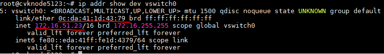

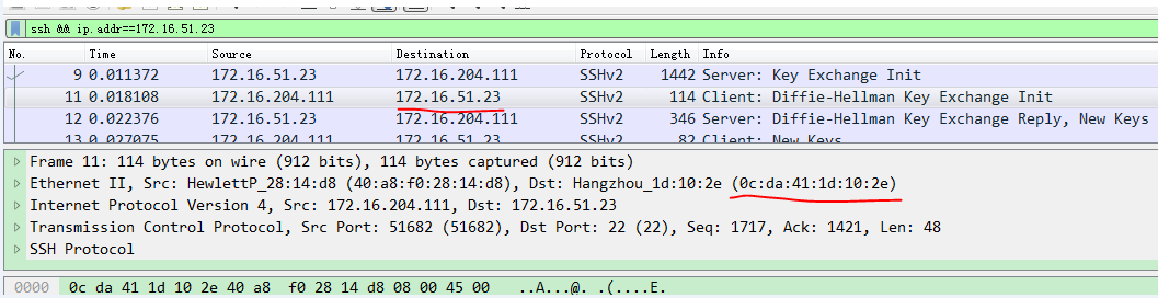

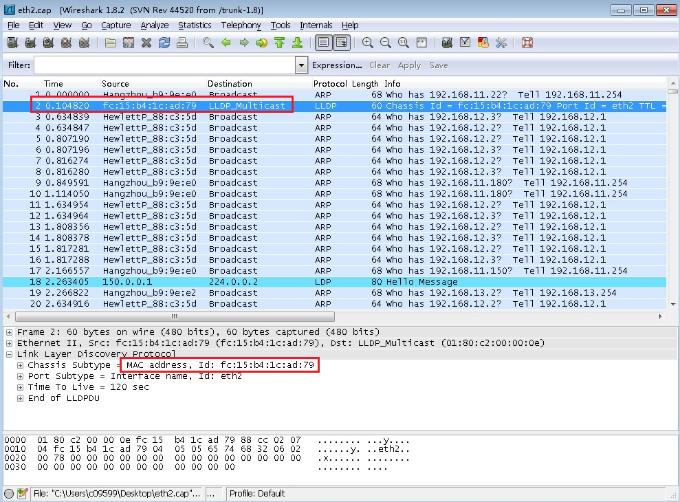

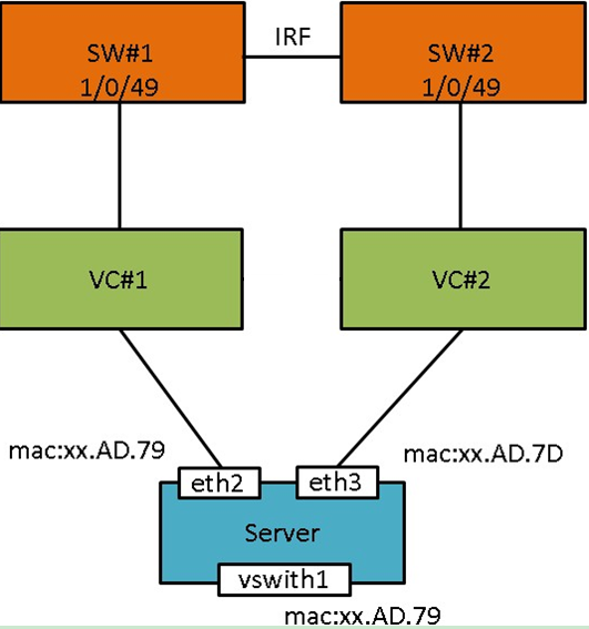

VM IP address conflict occurs
Symptom
The host (for example, 172.16.51.23) is in an abnormal connection state, yet all services on the host are displayed normal. The logs show failed connection attempts to the host. When you SSH the host with the correct password, the SSH connection fails, prompting incorrect password.
Impact
You cannot access the host.
Analysis
Capture packets on both the local PC's NIC and on the host's vSwitch 0 simultaneously. Then, initiate an SSH request from the PC and analyze the captured packets. An example is as follows:
· The request packet on the local PC shows that the MAC address corresponding to IP address 172.16.51.23 is 0c:da:41:1d:10:2e.
· No request is captured on the host. Check the MAC address of vSwitch 0 in the CVK, which is 0c:da:41:1d:43:79, and the IP address is 172.16.51.23.
· Output shows that two devices within the LAN are configured with IP address 172.16.51.23, causing IP address conflict.
Solution
Replace the conflicted IP address with another one.

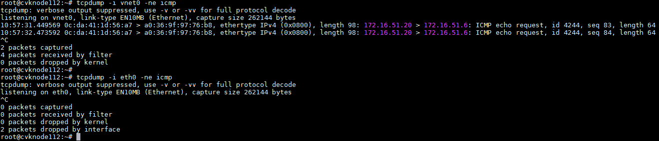

The packet forwarding path is VM NIC -> vNetwork -> host NIC -> physical switch. Capture packets on the vNetwork and host NIC eth0. The results are as follows:
The vNetwork has received the ICMP request, but it was not captured on the Ethernet interface.

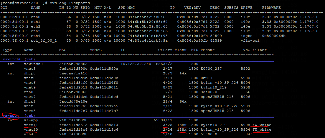

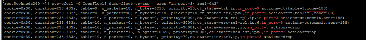

SSH connection cannot be established due to the vFirewall
Symptom
Both VMs are configured with a vFirewall, and the policies do not contain any rules of blocking SSH. The VMs are also configured with the same VLAN, but they cannot SSH each other.
Impact
VMs cannot SSH each other, affecting users' network services.
Analysis

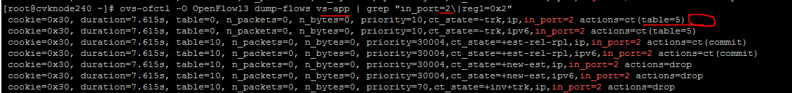

Both VM NICs are bound to vs-app, and the VMs are configured with the same VLAN 188 and vFirewall FW_white, as shown in the following figure:
The user-space flow tables for the two VMs are as follows:
The output shows that the zone values in the flow tables are inconsistent, with one being 188 and the other 0. Both should be 188. The inconsistency causes SSH operations to fail.
Solution
Use scripts set_cvm_port_flow.sh and set_cvk_port_flow.sh to resolve the issue.

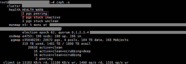

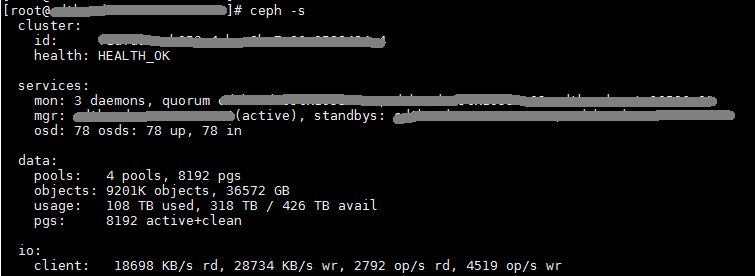

Identify whether the data health of the cluster is 100%, and then troubleshoot the exception accordingly:
If the data health of the cluster is 100%:
You can view the data health of the cluster by using one of the following methods:
· Access the dashboard of the Web cluster management interface, and then identify whether the data health of the cluster is 100%.
· Execute the ceph -s command at the backend of any node, and then identify whether the command output displays HEALTH_OK.
Figure 4 Viewing the data health of the cluster at backend

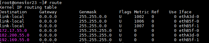

1. Identify whether the faulty client can communicate with all tgt nodes in the storage cluster over the service network. If the client cannot communicate with a tgt node over the service network, check for incorrect link and network configurations (including network port, gateway, and route settings) between the client and the tgt node, and restore the network connection to normal.
Figure 5 Pinging the service-network IP address of a tgt node
Figure 6 Checking for incorrect routing information

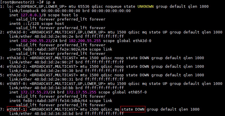

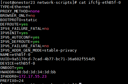

Figure 7 Check for abnormal network ports
Figure 8 Check for incorrect NIC configurations

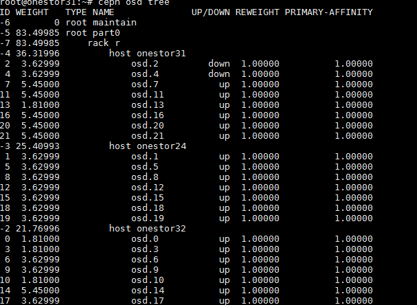

1. Execute the ceph osd tree command to identify whether more than one cluster node has OSDs in down state. If so, log in to each of the faulty nodes, and then execute the ceph-disk activate-all command to activate the down OSDs. If some OSDs cannot be activated on a node, contact Technical Support.
Figure 11 Checking the cluster for OSDs in down state
Figure 12 Bringing up OSDs
2. If the number of nodes with down OSDs does not exceed one, but the output of the ceph -s command displays pg peering/stale/inactive/down:

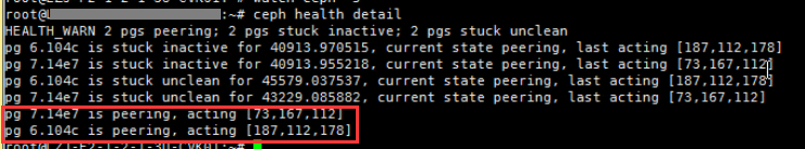

a. Execute the ceph -s command on a random node of the cluster. The command output shows that two PGs are constantly in peering state.
Figure 13 Viewing PG status
a. Execute the ceph health detail to locate the abnormal PGs. As shown in the following figure, the two PGs in peering state are 7.14e7 and 6.104c. PG 7.14e7 resides on osd.73, osd.167, and osd.112. PG 6.104c resides on osd.187, osd.112, and osd.178. Since osd.112 is hosting both of the PGs, restart osd.112 preferentially as a best practice.
Figure 14 Viewing the OSDs hosting a PG

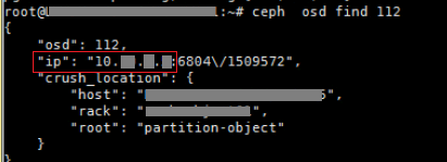

a. Execute the ceph osd find 112 (OSD 112 is used for illustration only. You can substitute 112 with the real OSD ID as needed on a live network) to find the IP address of the host on which osd.112 resides.
Figure 15 Obtaining the IP address of the host on which an OSD resides
a. Log in to the previous host via SSH, and then execute the systemctl restart ceph-osd@112.service command to restart osd.112.
b. After the restarting is completed, execute the ceph -s command to verify that the two abnormal PGs are no longer in peering state. If they are still in peering state, restart the other OSDs found in step b one by one.

After executing the ceph osd tree command at the backend of a random cluster node, you find that more than one cluster node has OSDs in down state.
Solution
· If OSDs on some nodes are all down, identify whether those nodes can communicate with the other nodes in the cluster over either the storage front-end network (also called service network) or the storage back-end network.
a. If a faulty node cannot communicate with the other cluster nodes, log in to the console of the node through either HDM or iLO, and identify whether the node has a black screen or is stuck.
- If the node has a black screen or is stuck, restart the node through HDM.
- If the operating system of the node can operate normally, execute the ip addr command to check for network ports in down state. If a network port is down, identify whether the related physical link is properly connected. If the physical link is properly connected, execute the ifup command to manually start the network port. Then, execute the ip addr command to again to identify whether the network port has come up. If the network port remains down, execute the reboot command to restart the node.
Figure 16 Checking for network ports in down state
Figure 17 Manually starting a network port
Figure 18 Confirming whether a network port is up
a. If the node still cannot communicate with the other cluster nodes after the above actions, contact Technical Support.
b. If the node can communicate with the other cluster nodes after the above actions, log in to the node via SSH, and then execute the ceph-disk activate-all command to activate the down OSDs. If manual OSD activation fails, contact Technical Support.
· If some nodes have a few (not all) OSDs in down state, log in to each of the faulty nodes via SSH, and then execute the ceph-disk activate-all command to activate the down OSDs. If manual OSD activation fails on a node, contact Technical Support.
After completing the above operations, reconnect the client to the faulty storage volumes. If the storage volumes still cannot be connected, contact Technical Support.

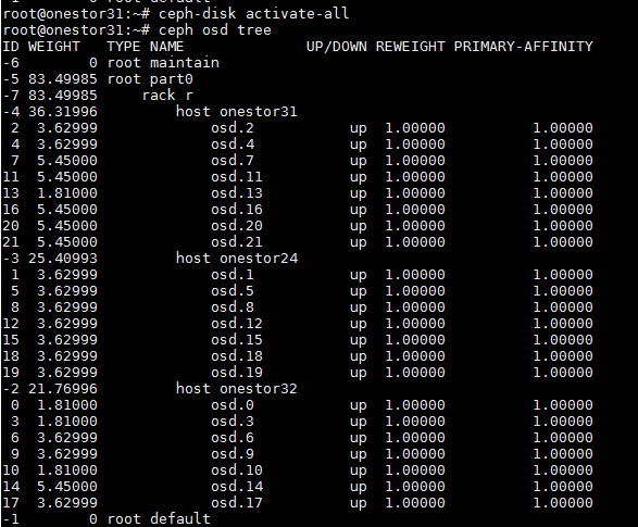

Only one node has OSDs in down state or the cluster does have OSDs in down state
Symptom
After executing the ceph osd tree command at the backend of a random cluster node, you find that only one node has OSDs in down state or the cluster does have OSDs in down state. However, the cluster is still suboptimal. The output of the ceph –s command displays pg peering/stale/inactive/down.
Solution
First, execute the ceph health detail command to find the OSDs hosting the abnormal PGs. Second, log in to the nodes hosting these OSDs, and then restart the OSDs one by one. Third, if the exception persists after the OSDs are restarted, contact Technical Support.
The detailed procedure is as follows:
1. Execute the ceph -s command on a random node of the cluster. The command output shows that two PGs are constantly in peering state.
Figure 19 Viewing PG status
2. Execute the ceph health detail to locate the abnormal PGs. As shown in the following figure, the two PGs in peering state are 7.14e7 and 6.104c. PG 7.14e7 resides on osd.73, osd.167, and osd.112. PG 6.104c resides on osd.187, osd.112, and osd.178. Since osd.112 is hosting both of the PGs, restart osd.112 preferentially as a best practice.
Figure 20 Viewing the OSDs hosting a PG
3. Execute the ceph osd find 112 (OSD 112 is used for illustration only. You can substitute 112 with the real OSD ID as needed on a live network) to find the IP address of the host on which osd.112 resides.
Figure 21 Obtaining the IP address of the host on which an OSD resides
4. Log in to the previous host via SSH, and then execute the systemctl restart ceph-osd@112.service command to restart osd.112.
5. After the restarting is completed, execute the ceph -s command to verify that the two abnormal PGs are no longer in peering state. If they are still in peering state, restart the other OSDs found in step b one by one.
After completing the above steps, reconnect the client to the faulty storage volumes. If the storage volumes still cannot be connected, contact Technical Support.

1. Identify whether all monitor nodes can communicate with non-monitor nodes in the cluster over either the storage front-end network or the storage back-end network.
a. If a monitor node cannot communicate with non-monitor nodes, log in to the console of the node through either HDM or iLO, and identify whether the node has a black screen or is stuck.
- If the operating system of the node can operate normally, execute the ip addr command to check for network ports in down state. If a network port is down, identify whether the related physical link is properly connected. If the physical link is properly connected, execute the ifup command to manually start the network port. If the network port remains down after manual restarting, execute the reboot command to restart the node.
b. If the node still cannot communicate with non-monitor nodes after the above actions, contact Technical Support.
c. If the node can communicate with non-monitor nodes after the above actions, perform the following operations:

Although the iSCSI HA VIP is accessible, if this IP address is used for read/write operations, those operations will fail.
Possible cause
The cluster is busy.
Fault localization
Execute the cat /var/log/messages | grep io error command in the OS command shell of an iSCSI HA node. If error information similar to the following is output, the cause of the exception might be that the cluster is busy. If you cannot determine the cause of the exception, contact Technical Support.
Mar 8 11:39:58 wy-ost209 tgtd: procaioresp(221) io error 0x1f33160 28 -110
Solution
1. Ease the storage service load on the cluster.
2. Limit the IOPS of the cluster. You can achieve this goal either by configuring network devices (such as switches) or by using the related features provided on the Web management interface of the storage system. For more information about how to limit the cluster IOPS through the Web management interface, see the online help for this product.
3. Contact Technical Support to perform hardware or device upgrade for the cluster.

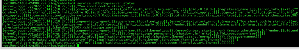

¡ The log reports a rabbitmq initialization failure: The rabbitmq service is running correctly (check with the service rabbitmq-seerver status command), but the system time is incorrect, which is earlier than May 2021. Attempt to change the system time to the current time and restart the host.
¡ The rabbitmq service is experiencing an issue and an error message is displayed that Too short cookie string, as shown in the figure below.
- Identify whether the root directory (/) of the disk is full.
- Delete the /var/lib/rabbitmq/.erlang.cookier file.
¡ Start rabbitmq by executing the service rabbitmq-server start command and verify the permissions of the cloud user.

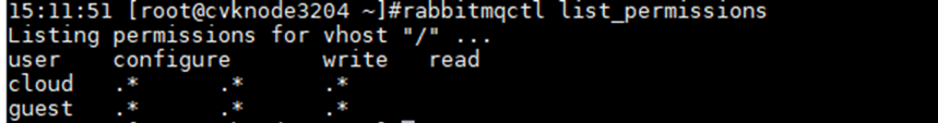

If the cloud user's permissions are incorrect, reinitialize the rabbitmq user permissions by running the rabbitmq-init.sh script in the update package.

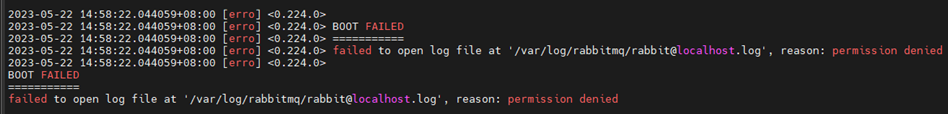

¡ The rabbitmq service is abnormal. When you execute the rabbitmq-server command to start the rabbitmq service, insufficient permissions is reported for the log directory (/var/log/rabbitmq), as shown in the figure below:
Manually create the rabbitmq log directory /var/log/rabbitmq.
If the directory exists, try assigning permissions to the rabbitmq user.
¡ Start the rabbitmq service. The rabbitmq service is abnormal. Try starting it with the rabbitmq-server command. The startup process takes a long time and then times out. See the figure below for more information.
- Troubleshoot the iptables to make sure ports 4369 and 5672 required by rabbitmq are not blocked.
- Examine the iptables rules and permit the ports required by rabbitmq.
- Start the rabbitmq service.

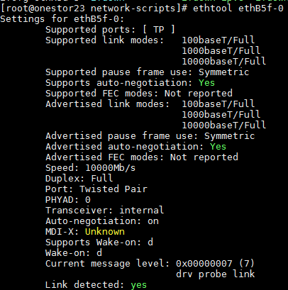

Examine whether the NIC has been manually disabled, whether the link is disconnected, and whether the negotiation is normal. Check if any NIC-related error logs exist in syslog.
Solution
Based on the corresponding situation, try to restore the issue by enabling the NIC, resolving connection and negotiation issues, upgrading the NIC firmware, or replacing hardware components.

Packet loss on an aggregate link
Symptom
At a specific deployment site, you can ping from the server (for example, 192.168.12.19) to a physical switch (for example, 192.168.12.254), but might fail to ping from the physical switch (192.168.12.254) to the server (192.168.12.19) occasionally.
Impact
Packet loss occurs in the user network, affecting the stability of the virtualization environment.
Analysis
The network diagram is as follows:
In this example, a UIS blade server is deployed at the site, with VC devices in the server chassis as network interconnect modules. The blade server's eth2 and eth3 are connected to VC#1 and VC#2, respectively. VC#1 and VC#2 are connected to switches SW#1 and SW#2, respectively. SW#1 and SW#2 form an IRF fabric.
Install the UIS system on the blade server, bind vSwitch1 to eth2 and eth3, and configure static link aggregation for load sharing. Both eth2 and eth3 have the LLDP feature enabled.
The IP address of vSwitch vswitch1 is 192.168.12.19 and its gateway address is 192.168.12.254 that is configured on a physical switch.
1. You can ping the switch (192.168.12.254) from the server (192.168.12.19), but might fail to ping the server (192.168.12.19) from the switch (192.168.12.254) occasionally.
2. Through further testing, you can see that when eth2 is the primary NIC, the CVK host (192.168.12.19) and the gateway (192.168.12.254) can communicate with each other. When the primary NIC is eth3, pinging the host from the gateway results in packet loss. Therefore, you only need to analyze the packet forwarding process when eth3 is used as the primary link.
¡ Packets from the CVK host (192.168.12.19) to the gateway (192.168.12.254) are forwarded along the path vswitch1-eth3-VC#2-SW#2.
¡ The MAC address FC:15:B4:1C:AD:79 of vswitch1 is recorded on the downlink port of VC#2 and the downlink port of SW#2.
¡ Packets from the gateway (192.168.12.254) to the CVK host (192.168.12.19) are forwarded based on the MAC address table of SW#2 and VC#2, which is the path SW#2-VC#2-eth3-vswitch1.
3. Use the tcpdump command to capture packets on NIC eth2 and save the packets.
4. Save the packets to your local PC and analyze it with Wireshark. You can see that although NIC eth2 is a backup link, it continuously sends LLDP_multicast packets (LLDP is enabled on eth2). The packet information is as follows:
The MAC address for the LLDP_multicast packet is FC:15:B4:1C:AD:79.
5. When eth3 is the primary link, the MAC address of vSwitch vswitch1 (with MAC address FC:15:B4:1C:AD:79) must be learned by SW#2 and VC#2. However, NIC eth2 with the same MAC address sends LLDP_multicast periodically. This affects the MAC address table entries on VC#1, causing the MAC address FC:15:B4:1C:AD:79 to migrate to VC#1 and SW#1. As a result, the ping packets from the gateway to the host are forwarded along the path SW#1-VC#1-eth2. Because eth2 is in standby status and does not process packets, OVS discards the packets, resulting in a ping failure.
Solution
Disable LLDP on physical NICs.

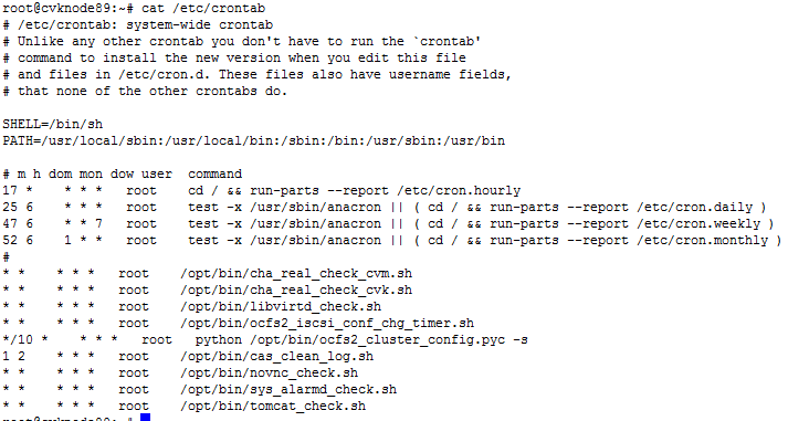

Check the /etc/crontab file for any abnormal scheduled tasks that have been added. In the current software version, certain scheduled tasks are available on the CVK. Any other scheduled tasks can be considered modified.
Solution
· Change the host password.
· Terminate the abnormal process and delete its executable file from the disk.
· Remove the abnormal tasks from /etc/crontab.

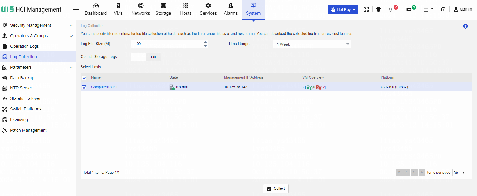

Collecting log files from the management platform
1. On the top navigation bar, click System, and then select Log Collection from the navigation pane.
2. Enter the log file size, select a time range, select the hosts for which the system collects logs, and then click Collect.
Figure 24 Collecting and downloading log files
3. To download the log files, click Download. To collect logs again, click Recollect.
