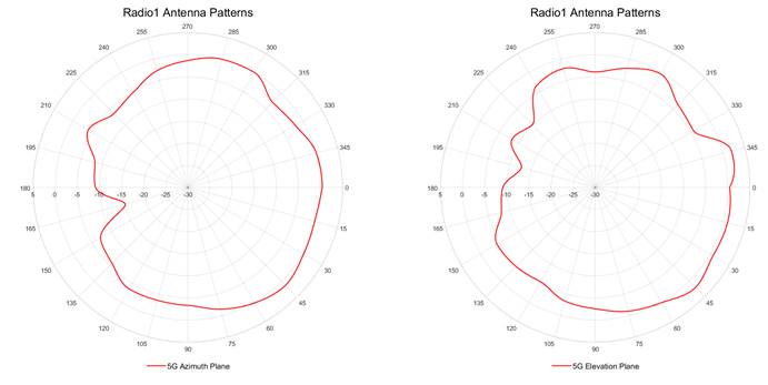

Radio1: 5GHz (AP front facing right)

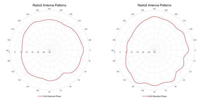

Radio2: 2.4GHz (AP front facing right)
