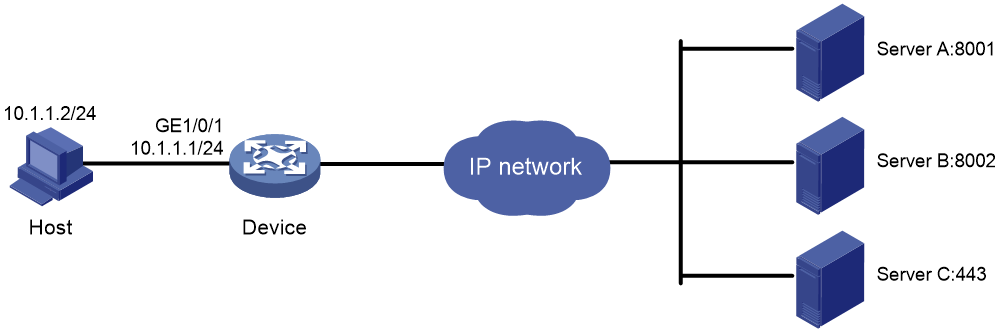

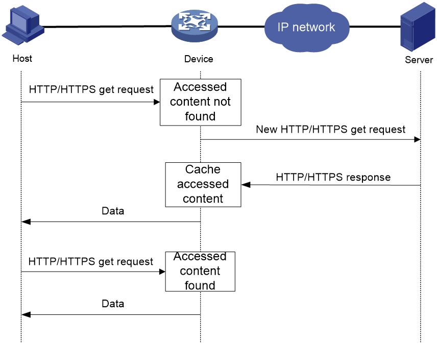

Web caching mechanism
Figure 1 shows the Web caching mechanism.
Figure 1 Web caching mechanism
1.     The host sends an HTTP or HTTPS GET request to the device.
2.     The device identifies whether the destination port number in the request is the same as the listening port number used by the Web server. If yes, the device replaces the destination port number with the listening port number specified for Web caching to trigger the Web caching process.
3.     The Web caching process obtains the URL of the request and looks up its cache for the requested content.
¡     If the requested content is found in the cache, the device retrieves the content and sends the content to the host. The HTTP or HTTPS GET operation is completed.
¡     If the requested content is not found, the device re-constructs the request and sends the request to the Web server.
4.     The Web server sends the requested content to the device.
5.     The device identifies whether the Web caching feature is configured to cache the content.
¡     If yes, the device uses the Web caching feature to cache the content, re-constructs a response, and sends the response to the host.
¡     If not, the device re-constructs a response and sends the response to the host.
Before sending the response, the device will check whether the source port number is the same as the listening port number used by Web caching. If not, the device will replace the source port number in the response with the listening port number of the Web server.

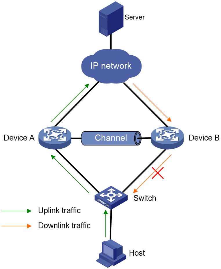

Configuring traffic direction channels for Web cache dual gateways
Perform this task in the Web Cache dual gateways scenario. As shown in Figure 2, gateways Device A and Device B provide the Web Cache service for the user through the switch, and equal cost paths exist on both the uplink and downlink for Web cache. If the uplink and downlink traffic forwarding paths are not the same, the uplink traffic and downlink traffic will be forwarded to different gateways for processing, for example, the user uplink traffic passes Device A and the downlink traffic for the user passes Device B. Device B does not have a record for the user and therefore cannot forward the downlink traffic to the user and the user cannot access the requested Web resources as a result.
In the Web cache dual gateway scenario, the uplink traffic refers to the HTTP/HTTPS requests sent from user hosts to Web servers, and the downlink traffic refers to the HTTP/HTTP responses sent from Web servers to user hosts. The traffic direction channel between the gateway devices is a direct physical link or a GRE tunnel, which ensures the IP connectivity between the gateways.
Figure 2 User failure to access Web resources
As shown in Figure 3, on Device B, you can configure a traffic direction channel with the peer gateway (Device A). If Device B receives Web cache downlink traffic for a user that it cannot find, it forwards the downlink traffic to the peer gateway through the specified channel interface, so the peer gateway can provide Web resources for the user correctly.
Figure 3 Traffic direction channel between gateways
When you execute the dual-gateway-channel command, make sure the specified IPv4 address of the peer gateway is reachable, and in the routing table, the outgoing interface for this IPv4 address is the channel interface specified in this command.
You can use the dual-gateway-channel command to configure multiple traffic direction channels in multiple VPN instances. If you execute this command for the same VPN instance or for the public network multiple times, the most recent configuration takes effect.
Before you configure a channel for traffic direction with the peer gateway, complete the following tasks:
·     Establish the channel between the gateways to ensure that the downlink traffic can be sent to the peer gateway through the channel.
·     Disable the Web cache feature.
After you configure the channel, enable the Web cache feature again.

Configuring Web caching backup
Make sure the storage medium where the Web cache directory resides has sufficient storage space. The Web caching feature saves its operation data and the Web content to be cached to files in the directory. The directory typically needs a storage space of over 1 GB.
The backup Web cache directory for a Web cache view must reside on the backup slot.
Before specifying a Web cache directory, make sure all files in the upper-level directory are using a different name than the Web cache directory or have a file extension.
2.     Enter Web cache view.
In standalone mode:
web-cache
In IRF mode:
web-cache slot slot-number
3.     Specify a backup Web caching slot.
In IRF mode:
backup slot slot-number
By default, the backup Web caching slot is not set.

Example: Configuring HTTP-based Web caching
As shown in Figure 4, Servers A, B, and C are HTTP servers and they listen for HTTP packets on port numbers 8001, 8002, and 80, respectively. Configure HTTP-based Web caching on the device to cache Web content from the HTTP servers.
Figure 4 Network diagram
# Configure IP addresses for interfaces and make sure the device can reach the HTTP servers. (Details not shown.)
1.     Create and enter Web cache view.
<Device> system-view
[Device] web-cache
2.     Configure Web caching parameters:
# Set the Web cache directory to #flash:/webcache.
[Device-web-cache] file-directory flash:/webcache
# Set the port number to 4001 for Web caching to listen for HTTP packets destined for Web server A that uses listening port number 8001.
[Device-web-cache] listen-port 4001 server-port 8001
# Set the port number to 4002 for Web caching to listen for HTTP packets destined for Web server B that uses listening port number 8002.
[Device-web-cache] listen-port 4002 server-port 8002
# Set the port number to 4003 for Web caching to listen for HTTP packets destined for Web server C that uses the listening port number 80.
[Device-web-cache] listen-port 4003
# Set the maximum total size for Web cache files to 10 GB.
[Device-web-cache] cache-limit 10
# Specify the types of the files on webpages to be cached.
[Device-web-cache] cached-data doc docx
# Specify an extension of the webpage files to be cached.
[Device-web-cache] cached-extension-name cab
3.     Enable HTTP-based Web caching.
[Device-web-cache] http enable
# Display Web caching information after the host sends the first HTTP request to the Web servers.
[Device-web-cache] display web-cache

# Display Web caching information after the host sends the second HTTP request for the same content to the Web servers.
Capability information
  Cache path: flash:/webcache/proxy/cache
  Max connections: 1022
  Max cache size: 10GB
Current state information
  Cache memory: 25.0MB
  Cache count: 3
Statistics for past 1 minute
  ConnectTop: 3
  CacheTop: 25.0MB
  Bandwidth saved:                      3.3Mbps
  Cached data transmission speed:       3.3Mbps
  Cached data transmitted:              25.0MB
  Download speed:                       0
  Download size:                        0
  CacheHitRate: 100%
Hit count: 3                     Miss count: 0
Statistics for past 365 days
  ConnectTop: 3
  CacheTop: 25.0MB
  Cached data transmitted:              50.0MB
  Download speed:                       3.3Mbps
  Download size:                        25.0MB
  CacheHitRate: 100%
    Hit count: 3                     Miss count: 3
The Web caching statistics for the most recent one minute in the command output show the Web caching feature is operating correctly.
·     The value of the Miss count field in the command output from the first display command is 3. The value of the Hit count field in the command output from the second display command is 3. The second HTTP request hits the Web cache.
·     The value of the Download size field in the command output from the second display command is 0. The value of the Bandwidth saved field in the command output from the second display command is 3.3 Mbps. This indicates that no Web data was downloaded from the Web servers to the device after the device sent the second HTTP request.

Example: Configuring HTTPS-based Web caching
As shown in Figure 7, Servers A, B, and C are HTTPS servers and they listen for HTTPS packets on port numbers 8001, 8002, and 443, respectively. Configure HTTPS-based Web caching and Web caching backup on the device to cache Web content from the HTTPS servers.
Figure 7 Network diagram
# Configure IP addresses for interfaces and make sure the device can reach the HTTPS servers. (Details not shown.)
