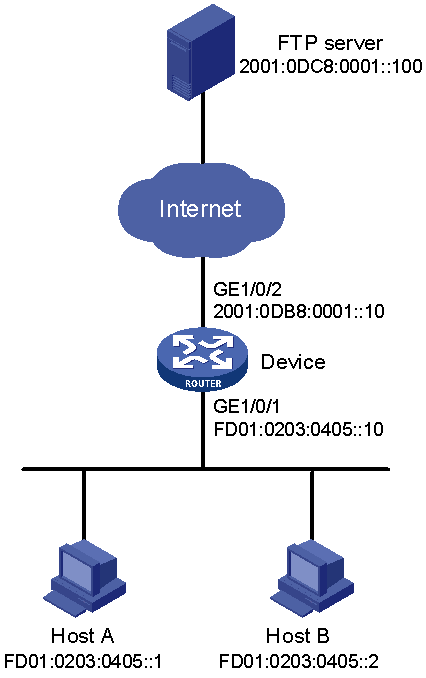

Example: Configuring IPv6 source prefix translation
As shown in Figure 1, internal users use IPv6 prefix FD01:0203:0405::/48 and the internal IPv6 addresses are not routable on the Internet. For internal users to access the FTP server on the Internet, configure IPv6 source prefix translation to translate the internal IPv6 prefix FD01:0203:0405::/48 to external prefix 2001:0DF8:0001::/48.
# Assign IPv6 addresses to interfaces and configure routes. Make sure the network connections are available. (Details not shown.)
# Configure an IPv6 source prefix mapping from FD01:0203:0405::/48 to FD01:0203:0405::/48.
<Device> system-view
[Device] interface gigabitethernet 1/0/2
[Device-GigabitEthernet1/0/2] nat66 prefix source fd01:0203:0405:: 48 2001:0df8:0001:: 48
[Device-GigabitEthernet1/0/2] quit
# Verify that internal hosts can access the FTP server. (Details not shown.)
# Verify NAT66 configurations.
[Device] display nat66 all
NAT66 source information:
Totally 1 source rules.
Interface(outbound): GigabitEthernet1/0/2
Original prefix/prefix-length: FD01:203:405::/48
Translated prefix/prefix-length: 2001:DF8:1::/48
# Verify that NAT66 sessions are established.
<Device> display nat66 session verbose
Slot 1:
Initiator:
Source IP/port: FD01:203:405::1/56002
Destination IP/port: 2001:DC8:1::100/21
VPN instance/VLAN ID/Inline ID: -/-/-
Protocol: TCP(6)
Inbound interface: GigabitEthernet1/0/1
Responder:
Source IP/port: 2001:DC8:1::100/21
Destination IP/port: 2001:DF8:1:D50F::1/56002
Protocol: TCP(6)
Inbound interface: GigabitEthernet1/0/2
State: TCP_ESTABLISHED
Application: FTP
Rule ID: 1
Rule name: 1
Start time: 2018-12-06 14:48:31 TTL: 3597s
Initiator->Responder: 0 packets 0 bytes
Responder->Initiator: 0 packets 0 bytes
Total sessions found: 1

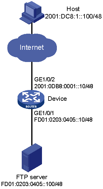

Example: Configuring IPv6 destination prefix translation
As shown in Figure 2, the internal IPv6 address of FTP server is FD01:0203:0405::100/48. The internal prefix is FD01:0203:0405::/48. Configure destination IPv6 prefix translation to allow the FTP server to use IPv6 address 2001:AB01:0001::1 to provide services for external users.
# Configure an IPv6 destination prefix mapping from 2001:AB01:0001::1/128 to FD01:0203:0405::100/128.
[Device-GigabitEthernet1/0/2] nat66 prefix destination 2001:ab01:1::1 128 fd01:203:405::100 128
# Verify that external hosts can access the FTP server. (Details not shown.)
NAT66 destination information:
Totally 1 destination rules.
Interface(inbound): GigabitEthernet1/0/2
Original prefix/prefix-length: 2001:AB01:1::1/128
Translated prefix/prefix-length: FD01:203:405::100/128
[Device] display nat66 session verbose
Slot 1:
Initiator:
Source IP/port: 2001:DC8:1::100/9025
Destination IP/port: 2001:AB01:1::1/21
Protocol: TCP(6)
Responder:
Source IP/port: FD01:203:405::100/21
Destination IP/port: 2001:DC8:1::100/9025
Protocol: TCP(6)
Application: FTP
Rule ID: 1
Rule name: 1
Start time: 2018-12-06 14:56:03 TTL: 3579s
