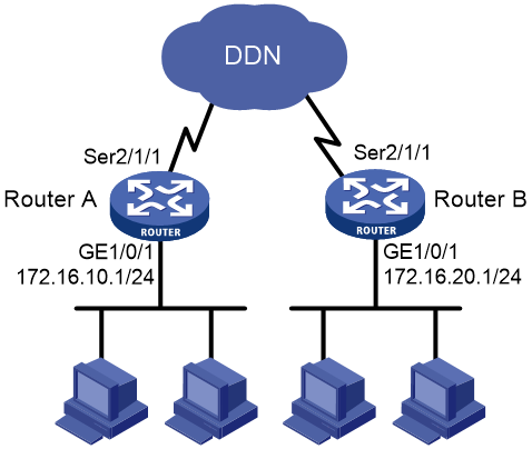

Example: Configuring IP unnumbered
As shown in Figure 4, two routers on an intranet are connected to each other through serial interfaces across a Digital Data Network. Each router connects to a LAN through an Ethernet interface.
To save IP addresses, configure the serial interfaces to borrow IP addresses from the Ethernet interfaces.
procedure
1. Configure Router A:
# Assign a primary IP address to GigabitEthernet 1/0/1.
<RouterA> system-view
[RouterA] interface gigabitethernet 1/0/1
[RouterA-GigabitEthernet1/0/1] ip address 172.16.10.1 255.255.255.0
[RouterA-GigabitEthernet1/0/1] quit
# Configure Serial 2/1/1 to borrow an IP address from GigabitEthernet 1/0/1.
[RouterA] interface serial 2/1/1
[RouterA-Serial2/1/1] ip address unnumbered interface gigabitethernet 1/0/1
[RouterA-Serial2/1/1] quit
# Configure a static route to the subnet attached to Router B, specifying Serial 2/1/1 as the outgoing interface.
[RouterA] ip route-static 172.16.20.0 255.255.255.0 serial 2/1/1
2. Configure Router B:
<RouterB> system-view
[RouterB-GigabitEthernet1/0/1] ip address 172.16.20.1 255.255.255.0
[RouterB-GigabitEthernet1/0/1] quit
# Configure interface Serial 2/1/1 to borrow an IP address from GigabitEthernet 1/0/1.
[RouterB] interface serial 2/1/1
[RouterB-Serial2/1/1] ip address unnumbered interface gigabitethernet 1/0/1
[RouterB-Serial2/1/1] quit
# Configure a static route to the subnet attached to Router A, specifying Serial 2/1/1 as the outgoing interface.
[RouterB] ip route-static 172.16.10.0 255.255.255.0 serial 2/1/1
# Verify that a host attached to Router B can be pinged from Router A.
[RouterA] ping 172.16.20.2
Ping 172.16.20.2 (172.16.20.2): 56 data bytes, press CTRL_C to break
56 bytes from 172.16.20.2: icmp_seq=0 ttl=128 time=7.000 ms
56 bytes from 172.16.20.2: icmp_seq=1 ttl=128 time=2.000 ms
56 bytes from 172.16.20.2: icmp_seq=2 ttl=128 time=1.000 ms
56 bytes from 172.16.20.2: icmp_seq=3 ttl=128 time=1.000 ms
56 bytes from 172.16.20.2: icmp_seq=4 ttl=128 time=2.000 ms
--- Ping statistics for 172.16.20.2 ---
