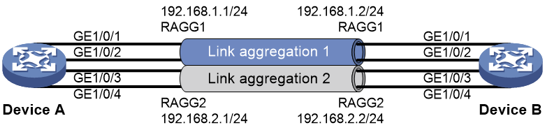

As shown in Figure 1, Device A and Device B are connected by three physical Ethernet links. These physical Ethernet links are combined into an aggregate link called link aggregation 1. The bandwidth of this aggregate link can reach up to the total bandwidth of the three physical Ethernet links. At the same time, the three Ethernet links back up one another. When a physical Ethernet link fails, the traffic transmitted on the failed link is switched to the other two links.
Figure 1 Ethernet link aggregation diagram

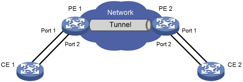

Enabling transparent LACPDU transmission
To establish a dynamic aggregation between two remote CEs in an L2VPN network, use transparent LACPDU transmission on the PEs to which the CEs are attached, as shown in Figure 4.
This feature enables the PEs to forward LACPDUs for the CEs to establish a dynamic aggregation.
If this feature is disabled, the PEs terminate the LACPDUs. The remote CEs cannot establish dynamic aggregations.
Figure 4 Application scenario of transparent LACPDU transmission
Perform the following tasks on PEs:
1.     Configure the untagged or default frame match criterion for the Ethernet service instances on the interfaces connected to CEs.
2.     Map the Ethernet service instances to different VSIs and set the access mode to Ethernet for the VSIs.
For more information about L2VPN and Ethernet service instances, see L2VPN configuration in MPLS Configuration Guide.
When you use this feature on the PEs, follow these guidelines:
·     Enable transparent LACPDU transmission on the interfaces that transmit traffic between CEs and PEs and between PEs.
·     Do not use an interface for dynamic link aggregation if you enable transparent LACPDU transmission on that interface. With transparent LACPDU transmission enabled, an interface cannot be selected for aggregation.
2.     Enter interface view.
3.     Enable transparent LACPDU transmission.
lacp transparent enable
By default, transparent LACPDU transmission is disabled.

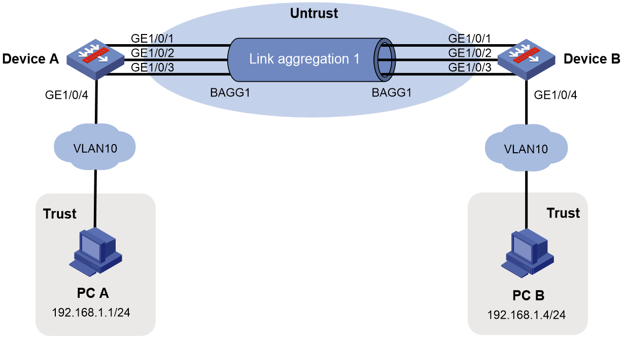

Ethernet link aggregation configuration examples
Example: Configuring a Layer 2 static aggregation group
On the network shown in Figure 6, perform the following tasks:
·     Configure a Layer 2 static aggregation group on both Device A and Device B.
·     Enable VLAN 10 at one end of the aggregate link to communicate with VLAN 10 at the other end.
·     Enable VLAN 20 at one end of the aggregate link to communicate with VLAN 20 at the other end.
Figure 6 Network diagram
1.     Configure Device A:
# Create VLAN 10, and assign port GigabitEthernet 1/0/4 to VLAN 10.
<DeviceA> system-view
[DeviceA] vlan 10
[DeviceA-vlan10] port gigabitethernet 1/0/4
[DeviceA-vlan10] quit
# Create VLAN 20, and assign port GigabitEthernet 1/0/5 to VLAN 20.
[DeviceA] vlan 20
[DeviceA-vlan20] port gigabitethernet 1/0/5
[DeviceA-vlan20] quit
# Create Layer 2 aggregate interface Bridge-Aggregation 1.
[DeviceA] interface bridge-aggregation 1
[DeviceA-Bridge-Aggregation1] quit
# Assign ports GigabitEthernet 1/0/1 through GigabitEthernet 1/0/3 to link aggregation group 1.
[DeviceA-GigabitEthernet1/0/1] port link-aggregation group 1
[DeviceA-GigabitEthernet1/0/1] quit
[DeviceA] interface gigabitethernet 1/0/2
[DeviceA-GigabitEthernet1/0/2] port link-aggregation group 1
[DeviceA-GigabitEthernet1/0/2] quit
[DeviceA] interface gigabitethernet 1/0/3
[DeviceA-GigabitEthernet1/0/3] port link-aggregation group 1
[DeviceA-GigabitEthernet1/0/3] quit
# Configure Layer 2 aggregate interface Bridge-Aggregation 1 as a trunk port and assign it to VLANs 10 and 20.
[DeviceA-Bridge-Aggregation1] port link-type trunk
[DeviceA-Bridge-Aggregation1] port trunk permit vlan 10 20
2.     Configure Device B in the same way Device A is configured. (Details not shown.)
# Display detailed information about all aggregation groups on Device A.
[DeviceA] display link-aggregation verbose
Loadsharing Type: Shar -- Loadsharing, NonS -- Non-Loadsharing
Port Status: S -- Selected, U -- Unselected, I -- Individual
Port: A -- Auto port
Flags:  A -- LACP_Activity, B -- LACP_Timeout, C -- Aggregation,
        G -- Defaulted, H -- Expired
Aggregate Interface: Bridge-Aggregation1
Aggregation Mode: Static
  Port             Status  Priority Oper-Key
  GE1/0/1          S       32768    1
  GE1/0/2          S       32768    1
  GE1/0/3          S       32768    1

Example: Configuring a Layer 2 dynamic aggregation group
On the network shown in Figure 7, perform the following tasks:
·     Configure a Layer 2 dynamic aggregation group on both Device A and Device B.
Figure 7 Network diagram
# Create VLAN 10, and assign the port GigabitEthernet 1/0/4 to VLAN 10.
[DeviceA] vlan 10
# Create VLAN 20, and assign the port GigabitEthernet 1/0/5 to VLAN 20.
[DeviceA] vlan 20
# Create Layer 2 aggregate interface Bridge-Aggregation 1, and set the link aggregation mode to dynamic.
[DeviceA-Bridge-Aggregation1] link-aggregation mode dynamic
Creation Mode: Manual
Aggregation Mode: Dynamic
System ID: 0x8000, 000f-e267-6c6a
Local:
  Port             Status  Priority Oper-Key  Flag
  GE1/0/1          S       32768    1         {ACDEF}
  GE1/0/2          S       32768    1         {ACDEF}
  GE1/0/3          S       32768    1         {ACDEF}
Remote:
  Actor            Partner Priority Oper-Key  SystemID               Flag
  GE1/0/1          1       32768    1         0x8000, 000f-e267-57ad {ACDEF}
  GE1/0/2          2       32768    1         0x8000, 000f-e267-57ad {ACDEF}
  GE1/0/3          3       32768    1         0x8000, 000f-e267-57ad {ACDEF}
The output shows that link aggregation group 1 is a Layer 2 dynamic aggregation group that contains three Selected ports.

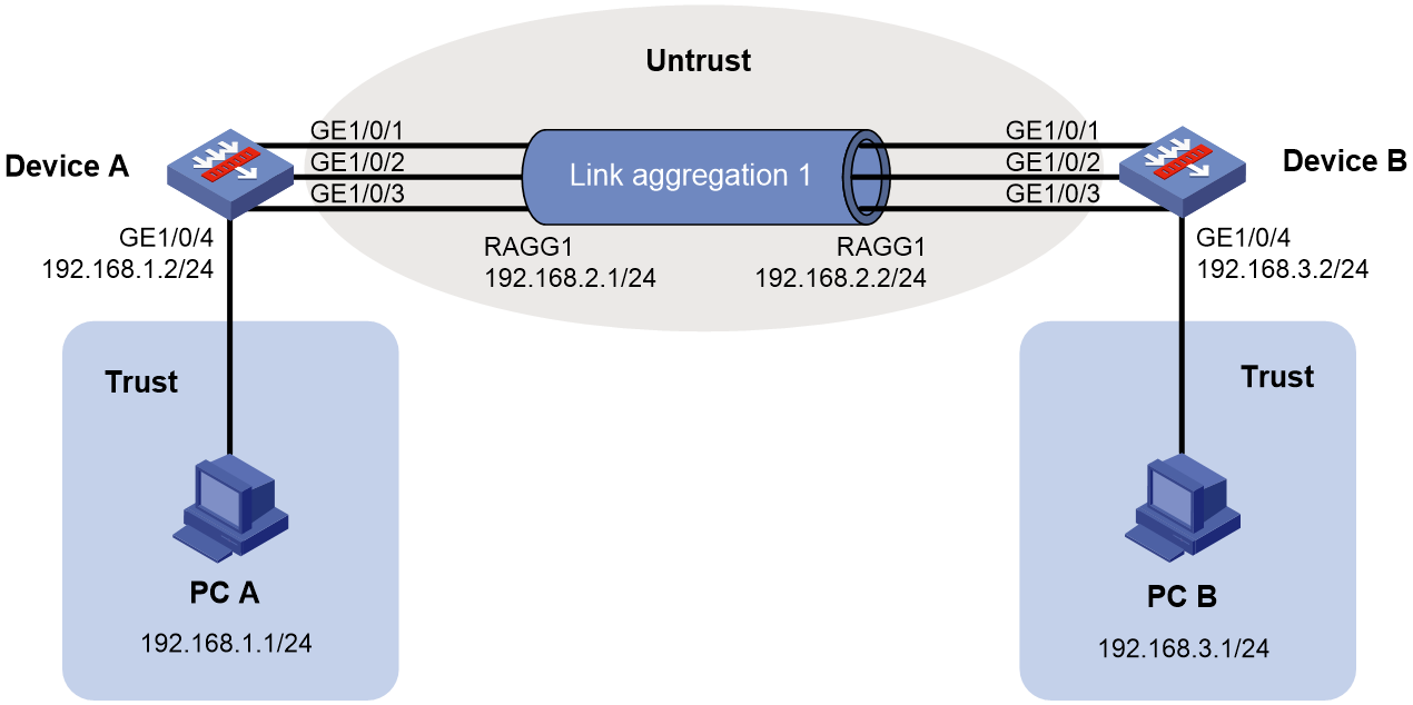

As shown in Figure 12, configure a Layer 2 static aggregation group on both Device A and Device B to aggregate the links between them.
Figure 12 Network diagram
1.     Configure interfaces GigabitEthernet 1/0/1 through GigabitEthernet 1/0/4 to operate in Layer 2 mode.
[DeviceA] interface range gigabitethernet 1/0/1 to gigabitethernet 1/0/4
[DeviceA-if-range] port link-mode bridge
[DeviceA-if-range] quit
2.     Create VLAN 10, and assign interface GigabitEthernet 1/0/4 to VLAN 10.
[DeviceA] vlan 10
3.     Configure a Layer 2 static aggregation group:
# Configure Layer 2 aggregate interface Bridge-Aggregation 1 as a trunk port and assign it to VLANs 1 and 10.
[DeviceA-Bridge-Aggregation1] port trunk permit vlan 1 10
# Assign interfaces GigabitEthernet 1/0/1 through GigabitEthernet 1/0/3 to link aggregation group 1.
[DeviceA] interface range gigabitethernet 1/0/1 to gigabitethernet 1/0/3
[DeviceA-if-range] port link-aggregation group 1
4.     Configure interfaces GigabitEthernet 1/0/1 through GigabitEthernet 1/0/3 as trunk ports and assign them to VLANs 1 and 10.
[DeviceA-if-range] port link-type trunk
[DeviceA-if-range] port trunk permit vlan 1 10
5.     Add interfaces to security zones.
[DeviceA] security-zone name trust
[Device-security-zone-Trust] import interface gigabitethernet 1/0/4 vlan 10
[Device-security-zone-Trust] quit
[DeviceA] security-zone name untrust
[Device-security-zone-Untrust] import interface bridge-aggregation 1 vlan 1 10
[Device-security-zone-Untrust] quit
6.     Configure a security policy:
Configure rules to permit traffic between the Trust and Untrust security zones, so the devices can communicate with each other:
# Configure a rule named trust-untrust to permit the packets sent from the Trust security zone to the Untrust security zone.
[DeviceA] security-policy ip
[DeviceA-security-policy-ip] rule name trust-untrust
[DeviceA-security-policy-ip-0-trust-untrust] action pass
[DeviceA-security-policy-ip-0-trust-untrust] source-zone trust
[DeviceA-security-policy-ip-0-trust-untrust] destination-zone untrust
[DeviceA-security-policy-ip-0-trust-untrust] quit
[DeviceA-security-policy-ip] quit
# Configure a rule named untrust-trust to permit the packets sent from the Untrust security zone to the Trust security zone.
[DeviceA-security-policy-ip] rule name untrust-trust
[DeviceA-security-policy-ip-1-untrust-trust] action pass
[DeviceA-security-policy-ip-1-untrust-trust] source-zone untrust
[DeviceA-security-policy-ip-1-untrust-trust] destination-zone trust
[DeviceA-security-policy-ip-1-untrust-trust] quit
7.     Configure Device B in the same way Device A is configured. (Details not shown.)
  GE1/0/1          S       32768    1
  GE1/0/2          S       32768    1
  GE1/0/3          S       32768    1
The output shows that link aggregation group 1 is a Layer 2 static aggregation group that contains three Selected ports.
As shown in Figure 13, configure a Layer 2 dynamic aggregation group on both Device A and Device B to aggregate the links between them.
Figure 13 Network diagram
[DeviceA] vlan 10
3.     Configure a Layer 2 dynamic aggregation group:
# Configure Layer 2 aggregate interface Bridge-Aggregation 1 as a trunk port, assign it to VLANs 1 and 10, and set the link aggregation mode to dynamic.
Local:
Remote:

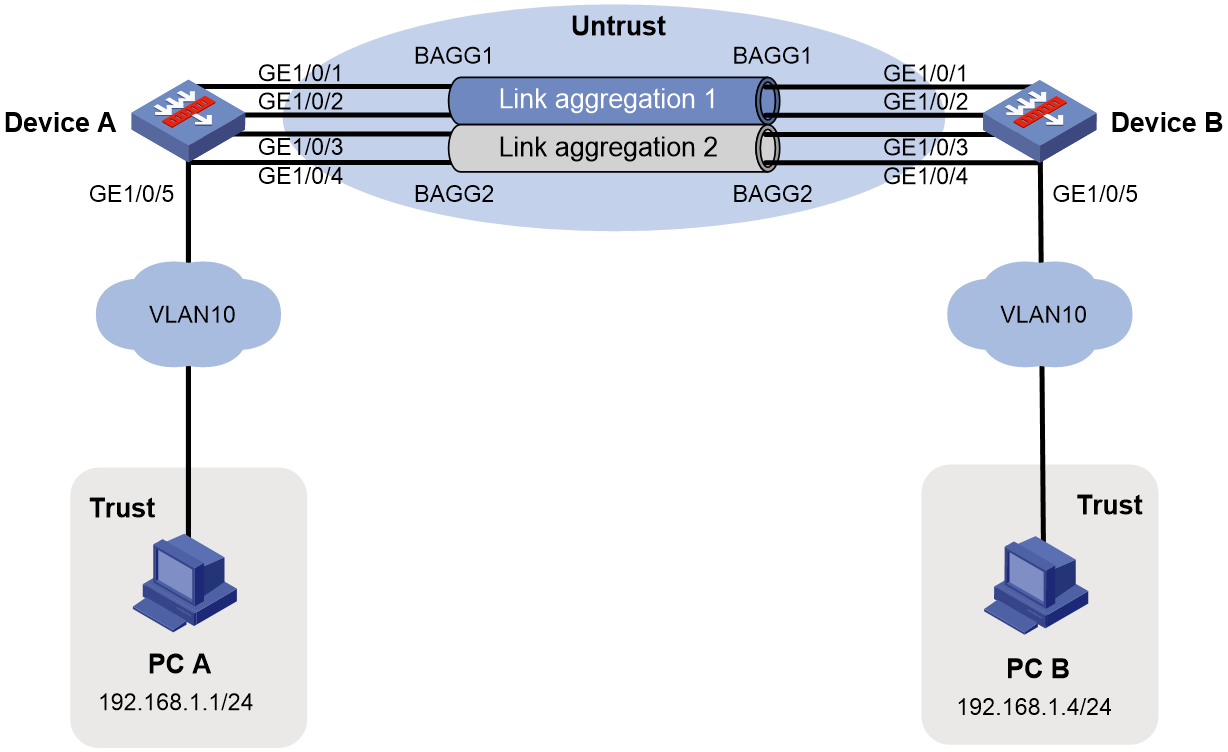

Example: Configuring Layer 2 aggregation load sharing
As shown in Figure 14, perform the following tasks:
·     Configure Layer 2 static aggregation groups 1 and 2 on Device A and Device B, respectively.
·     Configure link aggregation groups 1 and 2 to load share traffic across aggregation group member ports.
¡     Configure link aggregation group 1 to load share packets based on source MAC addresses.
¡     Configure link aggregation group 2 to load share packets based on destination MAC addresses.
Figure 14 Network diagram
1.     Configure interfaces GigabitEthernet 1/0/1 through GigabitEthernet 1/0/5 to operate in Layer 2 mode.
[DeviceA] interface range gigabitethernet 1/0/1 to gigabitethernet 1/0/5
2.     Create VLAN 10, and assign interface GigabitEthernet 1/0/5 to VLAN 10.
[DeviceA] vlan 10
[DeviceA-vlan10] port gigabitethernet 1/0/5
3.     Configure Layer 2 aggregation groups:
# Configure Layer 2 aggregate interface Bridge-Aggregation 1 as a trunk port and assign it to VLANs 1 and 10, and configure it to load share packets based on source MAC addresses..
[DeviceA-Bridge-Aggregation1] link-aggregation load-sharing mode source-mac
# Assign interfaces GigabitEthernet 1/0/1 and GigabitEthernet 1/0/2 to link aggregation group 1.
[DeviceA] interface range GigabitEthernet1/0/1 to GigabitEthernet1/0/2
# Configure Layer 2 aggregate interface Bridge-Aggregation 2 as a trunk port and assign it to VLANs 1 and 10, and configure it to load share packets based on destination MAC addresses..
[DeviceA] interface bridge-aggregation 2
[DeviceA-Bridge-Aggregation1] link-aggregation load-sharing mode destination-mac
# Assign interfaces GigabitEthernet 1/0/3 and GigabitEthernet 1/0/4 to link aggregation group 2.
[DeviceA] interface range gigabitethernet 1/0/3 to gigabitethernet 1/0/4
[DeviceA-if-range] port link-aggregation group 2
4.     Configure interfaces GigabitEthernet 1/0/1 through GigabitEthernet 1/0/4 as trunk ports and assign them to VLANs 1 and 10.
[Device-security-zone-Trust] import interface gigabitethernet 1/0/5 vlan 10
[Device-security-zone-Untrust] import interface bridge-aggregation 2 vlan 1 10
  GE1/0/1          S       32768    1
  GE1/0/2          S       32768    1
Aggregate Interface: Bridge-Aggregation2
  GE1/0/3          S       32768    2
  GE1/0/4          S       32768    2
The output shows that:
·     Link aggregation groups 1 and 2 are both load-shared Layer 2 static aggregation groups.
·     Each aggregation group contains two Selected ports.
# Display all the group-specific load sharing modes on Device A.
[DeviceA] display link-aggregation load-sharing mode interface
Bridge-Aggregation1 Load-Sharing Mode:
source-mac address
Bridge-Aggregation2 Load-Sharing Mode:
destination-mac address
·     Link aggregation group 1 distributes packets based on source MAC addresses.
·     Link aggregation group 2 distributes packets based on destination MAC addresses.
Example: Configuring a Layer 3 static aggregation group
As shown in Figure 15, configure a Layer 3 static aggregation group on both Device A and Device B to aggregate the links between them.
Figure 15 Network diagram
1.     Configure a Layer 3 static aggregation group:

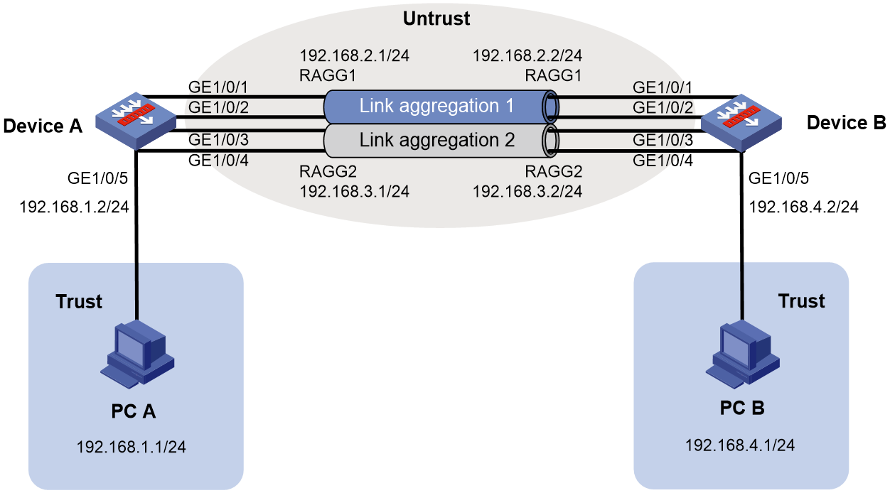

Example: Configuring Layer 3 aggregation load sharing
As shown in Figure 17, perform the following tasks:
·     Configure Layer 3 static aggregation groups 1 and 2 on Device A and Device B, respectively.
¡     Configure link aggregation group 1 to load share packets based on source IP addresses.
¡     Configure link aggregation group 2 to load share packets based on destination IP addresses.
Figure 17 Network diagram
1.     Configure Layer 3 aggregation groups:

·     Link aggregation group 1 distributes packets based on source IP addresses.
·     Link aggregation group 2 distributes packets based on destination IP addresses.
