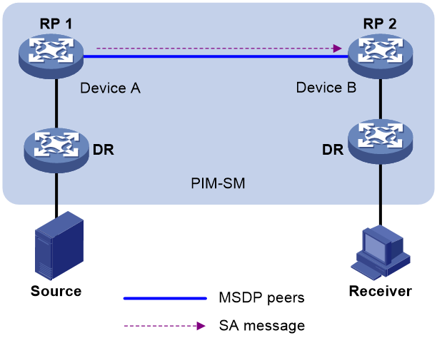

As shown in Figure 1, an MSDP peer can be created on any PIM-SM device. MSDP peers created on PIM-SM devices that assume different roles function differently.
·     MSDP peers created on RPs:
¡     Source-side MSDP peer—MSDP peer closest to the multicast source, such as RP 1. The source-side RP creates and sends SA messages to its remote MSDP peer to notify the MSDP peer of the locally registered multicast source information.
A source-side MSDP peer must be created on the source-side RP. Otherwise, it cannot advertise the multicast source information out of the PIM-SM domain.
¡     Receiver-side MSDP peer—MSDP peer closest to the receivers, typically the receiver-side RP, such as RP 3. After receiving an SA message, the receiver-side MSDP peer resolves the multicast source information carried in the message. Then, it joins the SPT rooted at the multicast source across the PIM-SM domains. When multicast data from the multicast source arrives, the receiver-side MSDP peer forwards the data to the receivers along the RPT.
¡     Intermediate MSDP peer—MSDP peer with multiple remote MSDP peers, such as RP 2. An intermediate MSDP peer forwards SA messages received from one remote MSDP peer to other remote MSDP peers. It acts as a relay for forwarding multicast source information.
·     MSDP peers created on PIM-SM devices that are not RPs:
Device A and Device B are MSDP peers on multicast devices that are not RPs. Such MSDP peers only forward SA messages.
In a PIM-SM network using the BSR mechanism, the RP is dynamically elected from C-RPs. A PIM-SM network typically has multiple C-RPs to ensure network robustness. Because the RP election result is unpredictable, MSDP peering relationships must be built between all C-RPs to always keep the winning C-RP on the MSDP interconnection map. Losing C-RPs assume the role of common PIM-SM devices on this map.

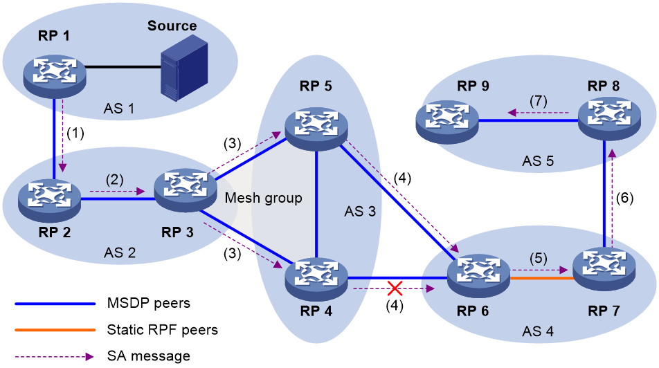

As shown in Figure 3:
·     There are five ASs on the network. IGP runs within each AS, and BGP or MBGP runs between these ASs.
·     Each AS contains a minimum of one PIM-SM domain, and each PIM-SM domain contains a minimum of one RP.
·     MSDP peering relationship has been established among these RPs.
RP 3, RP 4, and RP 5 are in the same MSDP mesh group.
RP 6 is configured as the static RPF peer of RP 7.
Figure 3 MSDP peer-RPF forwarding
The process of peer-RPF forwarding is as follows:
1.     RP 1 creates an SA message and forwards it to its peer RP 2.
2.     RP 2 determines that RP 1 is the RP that creates the SA message because the RP address in the SA message is the same as that of RP 1. Then, RP 2 accepts and forwards the SA message.
3.     RP 3 accepts and forwards the SA message, because RP 2 and RP 3 reside in the same AS and RP 2 is the next hop of RP 3 to RP 1.
4.     RP 4 and RP 5 accept the SA message, because RP 3 is in the same mesh group with them. Then, RP 4 and RP 5 forward the SA message to their peer RP 6 rather than other members of the mesh group.
5.     RP 4 and RP 5 reside in the closest AS in the route to RP 1. However, RP 6 accepts and forwards only the SA message from RP 5, because the IP address of RP 5 is higher than that of RP 4.
6.     RP 7 accepts and forwards the SA message, because RP 6 is its static RPF peer.
7.     RP 8 accepts and forwards the SA message, because RP 7 is the EBGP or MBGP next hop of the peer-RPF route to RP 1.
8.     RP 9 accepts the SA message, because RP 8 is the only RP of RP 9.

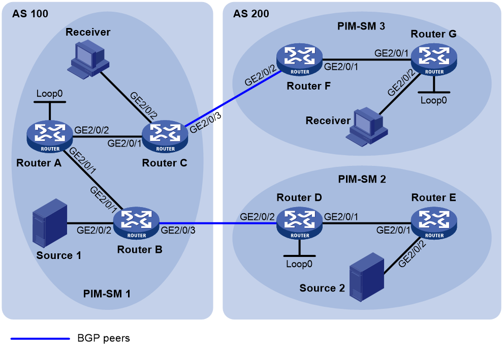

MSDP configuration examples
Example: Configuring PIM-SM inter-domain multicast
As shown in Figure 5:
·     OSPF runs within AS 100 and AS 200. BGP runs between the two ASs.
·     Each PIM-SM domain has a minimum of one multicast source or receiver.
Set up MSDP peering relationships between the RPs in the PIM-SM domains to share multicast source information among the PIM-SM domains.
Figure 5 Network diagram

Example: Configuring inter-AS multicast by leveraging static RPF peers
As shown in Figure 6:
·     The network has two ASs: AS 100 and AS 200. OSPF runs within each AS. BGP runs between the two ASs.
·     PIM-SM 1 belongs to AS 100, and PIM-SM 2 and PIM-SM 3 belong to AS 200. Each PIM-SM domain has a minimum of one multicast source or receiver.
Configure inter-AS multicast as follows:
·     Configure Loopback 0 as the C-BSR and C-RP of the related PIM-SM domain on Router A, Router D and Router G.
·     According to the peer-RPF forwarding rule, the routers accept SA messages that pass the filtering policy from its static RPF peers. To share multicast source information among PIM-SM domains without changing the unicast topology structure, configure MSDP peering relationships for the RPs of the PIM-SM domains and configure the static RPF peering relationships.
Figure 6 Network diagram
Device
Interface
IP address
Device
Interface
IP address
Source 1
192.168.1.100/24
Router D
GE2/0/1
10.110.5.1/24
Source 2
192.168.3.100/24
Router D
GE2/0/2
10.110.3.2/24
Router A
GE2/0/1
10.110.1.1/24
Router D
Loop0
2.2.2.2/32
Router A
GE2/0/2
10.110.2.1/24
Router E
GE2/0/1
10.110.5.2/24
Router A
Loop0
1.1.1.1/32
Router E
GE2/0/2
192.168.3.1/24
Router B
GE2/0/1
10.110.1.2/24
Router F
GE2/0/1
10.110.6.1/24
Router B
GE2/0/2
192.168.1.1/24
Router F
GE2/0/2
10.110.4.2/24
Router B
GE2/0/3
10.110.3.1/24
Router G
GE2/0/1
10.110.6.2/24
Router C
GE2/0/1
10.110.2.2/24
Router G
GE2/0/2
192.168.4.1/24
Router C
GE2/0/2
192.168.2.1/24
Router G
Loop0
3.3.3.3/32
Router C
GE2/0/3
10.110.4.1/24
1.     Assign an IP address and subnet mask to each interface according to Table 2. (Details not shown.)
2.     Configure OSPF on the routers in the ASs. (Details not shown.)
3.     Enable IP multicast routing, PIM-SM, and IGMP, and configure PIM-SM domain borders:

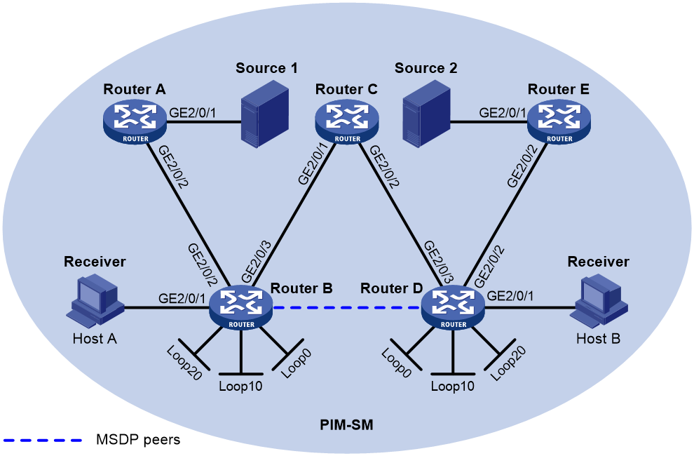

Example: Configuring Anycast RP
As shown in Figure 7, OSPF runs within the domain to provide unicast routes.
Configure the Anycast RP application so that the receiver-side DRs and the source-side DRs can initiate a join process to their respective RPs that are topologically closest to them.
Configure the router IDs of Router B and Router D as 1.1.1.1 and 2.2.2.2, respectively. Set up an MSDP peering relationship between Router B and Router D.
Figure 7 Network diagram
Table 3 Interface and IP address assignment
Device
Interface
IP address
Device
Interface
IP address
Source 1
10.110.5.100/24
Router C
GE2/0/1
192.168.1.2/24
Source 2
10.110.6.100/24
Router C
GE2/0/2
192.168.2.2/24
Router A
GE2/0/1
10.110.5.1/24
Router D
GE2/0/1
10.110.3.1/24
Router A
GE2/0/2
10.110.2.2/24
Router D
GE2/0/2
10.110.4.1/24
Router B
GE2/0/1
10.110.1.1/24
Router D
GE2/0/3
192.168.2.1/24
Router B
GE2/0/2
10.110.2.1/24
Router D
Loop0
2.2.2.2/32
Router B
GE2/0/3
192.168.1.1/24
Router D
Loop10
4.4.4.4/32
Router B
Loop0
1.1.1.1/32
Router D
Loop20
10.1.1.1/32
Router B
Loop10
3.3.3.3/32
Router E
GE2/0/1
10.110.6.1/24
Router B
Loop20
10.1.1.1/32
Router E
GE2/0/2
10.110.4.2/24
1.     Assign an IP address and subnet mask to each interface according to Figure 7. (Details not shown.)
2.     Configure OSPF on the routers in the PIM-SM domain. (Details not shown.)
3.     Enable IP multicast routing, IGMP, and PIM-SM:

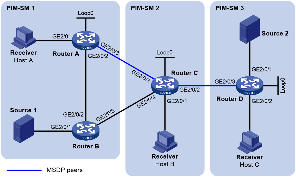

Example: Configuring SA message filtering
As shown in Figure 8:
·     OSPF runs within and among the PIM-SM domains to provide unicast routing.
·     Set up an MSDP peering relationship between Router A and Router C and between Router C and Router D.
·     Source 1 sends multicast data to multicast groups 225.1.1.0/30 and 226.1.1.0/30. Source 2 sends multicast data to the multicast group 227.1.1.0/30.
Configure SA message policies to meet the following requirements:
·     Host A and Host B receive the multicast data only addressed to multicast groups 225.1.1.0/30 and 226.1.1.0/30.
·     Host C receives the multicast data only addressed to multicast groups 226.1.1.0/30 and 227.1.1.0/30.
Figure 8 Network diagram
Table 4 Interface and IP address assignment
Device
Interface
IP address
Device
Interface
IP address
Source 1
10.110.3.100/24
Router C
GE2/0/1
10.110.4.1/24
Source 2
10.110.6.100/24
Router C
GE2/0/2
10.110.5.1/24
Router A
GE2/0/1
10.110.1.1/24
Router C
GE2/0/3
192.168.1.2/24
Router A
GE2/0/2
10.110.2.1/24
Router C
GE2/0/4
192.168.2.2/24
Router A
GE2/0/3
192.168.1.1/24
Router C
Loop0
2.2.2.2/32
Router A
Loop0
1.1.1.1/32
Router D
GE2/0/1
10.110.6.1/24
Router B
GE2/0/1
10.110.3.1/24
Router D
GE2/0/2
10.110.7.1/24
Router B
GE2/0/2
10.110.2.2/24
Router D
GE2/0/3
10.110.5.2/24
Router B
GE2/0/3
192.168.2.1/24
Router D
Loop0
3.3.3.3/32
1.     Assign an IP address and subnet mask to each interface according to Figure 8. (Details not shown.)
2.     Configure OSPF on the routers in the PIM-SM domains. (Details not shown.)
3.     Enable IP multicast routing, IGMP, and PIM-SM, and configure a PIM domain border:
# On Router A, enable IP multicast routing.
<RouterA> system-view
[RouterA] multicast routing
[RouterA-mrib] quit
# Enable IGMP on the receiver-side interface (GigabitEthernet 2/0/1).
[RouterA] interface gigabitethernet 2/0/1
[RouterA-GigabitEthernet2/0/1] igmp enable
[RouterA-GigabitEthernet2/0/1] quit
# Enable PIM-SM on the other interfaces.
[RouterA] interface gigabitethernet 2/0/2
[RouterA-GigabitEthernet2/0/2] pim sm
[RouterA-GigabitEthernet2/0/2] quit
[RouterA] interface gigabitethernet 2/0/3
[RouterA-GigabitEthernet2/0/3] pim sm
[RouterA-GigabitEthernet2/0/3] quit
[RouterA] interface loopback 0
[RouterA-LoopBack0] pim sm
[RouterA-LoopBack0] quit
# Enable IP multicast routing, IGMP, and PIM-SM on Router B, Router C, and Router D in the same way Router A is configured. (Details not shown.)
# Configure PIM domain borders on Router C.
[RouterC] interface gigabitethernet 2/0/2
[RouterC-GigabitEthernet2/0/2] pim bsr-boundary
[RouterC-GigabitEthernet2/0/2] quit
[RouterC] interface gigabitethernet 2/0/3
[RouterC-GigabitEthernet2/0/3] pim bsr-boundary
[RouterC-GigabitEthernet2/0/3] quit
[RouterC] interface gigabitethernet 2/0/4
[RouterC-GigabitEthernet2/0/4] pim bsr-boundary
[RouterC-GigabitEthernet2/0/4] quit
# Configure PIM domain borders on Router A, Router B, and Router D in the same way Router C is configured. (Details not shown.)
4.     Configure C-BSRs and C-RPs:
# Configure Loopback 0 on Router A as a C-BSR and a C-RP.
[RouterA] pim
[RouterA-pim] c-bsr 1.1.1.1
[RouterA-pim] c-rp 1.1.1.1
[RouterA-pim] quit
# Configure C-BSRs and C-RPs on Router C and Router D in the same way Router A is configured. (Details not shown.)
5.     Configure MSDP peers:
# Configure an MSDP peer on Router A.
[RouterA] msdp
[RouterA-msdp] peer 192.168.1.2 connect-interface gigabitethernet 2/0/3
[RouterA-msdp] quit
# Configure MSDP peers on Router C.
[RouterC] msdp
[RouterC-msdp] peer 192.168.1.1 connect-interface gigabitethernet 2/0/3
[RouterC-msdp] peer 10.110.5.2 connect-interface gigabitethernet 2/0/2
[RouterC-msdp] quit
# Configure an MSDP peer on Router D.
[RouterD] msdp
[RouterD-msdp] peer 10.110.5.1 connect-interface gigabitethernet 2/0/3
[RouterD-msdp] quit
6.     Configure SA message policies:
# Configure an SA accepting and forwarding policy on Router C so that Router C will not forward SA messages for (Source 1, 225.1.1.0/30) to Router D.
[RouterC] acl advanced 3001
[RouterC-acl-ipv4-adv-3001] rule deny ip source 10.110.3.100 0 destination 225.1.1.0 0.0.0.3
[RouterC-acl-ipv4-adv-3001] rule permit ip source any destination any
[RouterC-acl-ipv4-adv-3001] quit
[RouterC] msdp
[RouterC-msdp] peer 10.110.5.2 sa-policy export acl 3001
[RouterC-msdp] quit
# Configure an SA creation policy on Router D so that Router D will not create SA messages for Source 2.
[RouterD] acl basic 2001
[RouterD-acl-ipv4-basic-2001] rule deny source 10.110.6.100 0
[RouterD-acl-ipv4-basic-2001] quit
[RouterD] msdp
[RouterD-msdp] import-source acl 2001
[RouterD-msdp] quit
# Display the (S, G) entries in the SA message cache on Router C.
[RouterC] display msdp sa-cache
 MSDP Total Source-Active Cache - 8 entries
 Matched 8 entries
Source          Group           Origin RP       Pro  AS     Uptime   Expires
10.110.3.100    225.1.1.0       1.1.1.1         ?    ?      02:03:30 00:05:31
10.110.3.100    225.1.1.1       1.1.1.1         ?    ?      02:03:30 00:05:31
10.110.3.100    225.1.1.2       1.1.1.1         ?    ?      02:03:30 00:05:31
10.110.3.100    225.1.1.3       1.1.1.1         ?    ?      02:03:30 00:05:31
10.110.3.100    226.1.1.0       1.1.1.1         ?    ?      02:03:30 00:05:31
10.110.3.100    226.1.1.1       1.1.1.1         ?    ?      02:03:30 00:05:31
10.110.3.100    226.1.1.2       1.1.1.1         ?    ?      02:03:30 00:05:31
10.110.3.100    226.1.1.3       1.1.1.1         ?    ?      02:03:30 00:05:31
# Display the (S, G) entries in the SA message cache on Router D.
[RouterD] display msdp sa-cache
 MSDP Total Source-Active Cache - 4 entries
 Matched 4 entries
10.110.3.100    226.1.1.0       1.1.1.1         ?    ?      00:32:53 00:05:07
10.110.3.100    226.1.1.1       1.1.1.1         ?    ?      00:32:53 00:05:07
10.110.3.100    226.1.1.2       1.1.1.1         ?    ?      00:32:53 00:05:07
10.110.3.100    226.1.1.3       1.1.1.1         ?    ?      00:32:53 00:05:07
