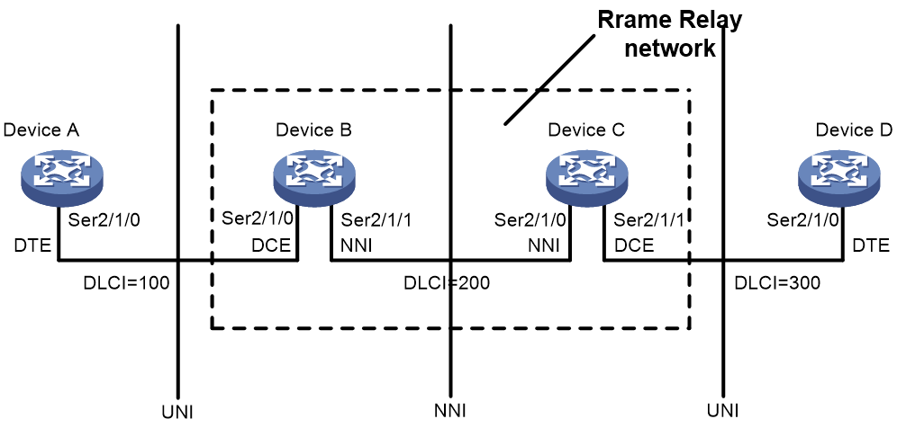

As shown in Figure 1:
·     A Frame Relay network provides data communications between user devices such as routers and hosts. The user devices are also called data terminal equipment (DTE).
·     The devices that provide access to the Frame Relay network for DTEs are called data circuit-terminating equipment (DCE).
Frame Relay interfaces include the following types:
·     User-to-network interface (UNI)—A DCE is connected to a DTE through UNI interfaces. UNI interfaces include the following types:
?     DTE interface—The UNI interface on the DTE side.
?     DCE interface—The UNI interface on the DCE side.
·     Network-to-network interface (NNI)—A DCE is connected to a Frame Relay switch in the Frame Relay network through an NNI interface. The switches in the Frame Relay network are interconnected with NNI interfaces.
A DTE interface can connect only to a DCE interface, and an NNI interface can connect only to an NNI interface. On a Frame Relay switch, the Frame Relay interface type must be NNI or DCE.
·     Device B and Device C form a simple Frame Relay network.
·     DTE devices Device A and Device D are attached to the network.
The interface type DTE or DCE is identified only for the UNI interfaces. A virtual circuit between two DTE devices can be assigned different DLCIs on different segments.
Figure 1 Frame Relay network

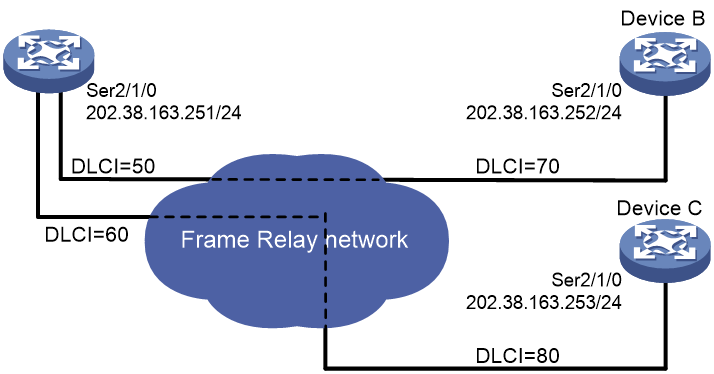

With Frame Relay, you can construct a public or private network as shown in Figure 2 and construct direct connections between data devices as shown in Figure 3.
Figure 2 Interconnecting LANs through a Frame Relay network

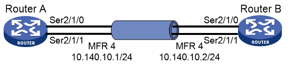

Figure 3 Interconnecting LANs through a dedicated line

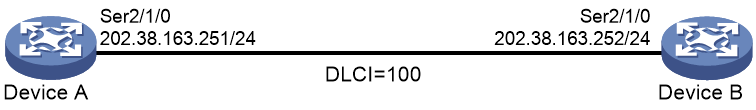

As shown in Figure 4, configure Frame Relay so that Router A and Router B can communicate.
Figure 4 Network diagram
(Method 1) Using main interfaces:
1.     Configure Router A:
# Assign an IP address to Serial 2/1/0.
<RouterA> system-view
[RouterA] interface serial 2/1/0
[RouterA-Serial2/1/0] ip address 202.38.163.251 255.255.255.0
# Enable Frame Relay encapsulation on the interface.
[RouterA-Serial2/1/0] link-protocol fr
# Set the type of the interface to DCE.
[RouterA-Serial2/1/0] fr interface-type dce
# Configure a local virtual circuit.
[RouterA-Serial2/1/0] fr dlci 100
2.     Configure Router B:
<RouterB> system-view
[RouterB] interface serial 2/1/0
[RouterB-Serial2/1/0] ip address 202.38.163.252 255.255.255.0
[RouterB-Serial2/1/0] link-protocol fr
# Set the type of the interface to DTE.
[RouterB-Serial2/1/0] fr interface-type dte
[RouterB-Serial2/1/0] quit
(Method 2) Using subinterfaces:
# Enable Frame Relay encapsulation on Serial 2/1/0.
# Set the type of Serial 2/1/0 to DCE.
[RouterA-Serial2/1/0] quit
# Create a subinterface named Serial 2/1/0.1.
[RouterA] interface serial 2/1/0.1 p2p
# Configure the IP address and create a virtual circuit for Serial 2/1/0.1.
[RouterA-Serial2/1/0.1] ip address 202.38.163.251 255.255.255.0
[RouterA-Serial2/1/0.1] fr dlci 100
# Set the type of Serial 2/1/0 to DTE.
[RouterB] interface serial 2/1/0.1 p2p
[RouterB-Serial2/1/0.1] ip address 202.38.163.252 255.255.255.0
[RouterB-Serial2/1/0.1] fr dlci 100
[RouterB-Serial2/1/0.1] quit
This section verifies the configuration used in method 1.
# On Router B, verify that the PVC is active.
[RouterB] display fr pvc
PVC information for interface Serial2/1/0 (DTE, physically up)
? DLCI: 100? Type: Dynamic? Interface: Serial2/1/0
? ??Encapsulation: IETF? Broadcast
? ??Creation time: 2014/02/19 01:38:00? Status: Active

Example: Configuring MFR
As shown in Figure 6, use MFR to bind the physical links between Router A and Router B into a logical link with higher bandwidth than each physical link.
Figure 6 Network diagram
# Create an interface named MFR 4, and assign an IP address to the interface.
[RouterA] interface mfr 4
[RouterA-MFR4] ip address 10.140.10.1 255.255.255.0
[RouterA-MFR4] fr interface-type dte
# Configure a static Frame Relay address-to-DLCI mapping for the interface.
[RouterA-MFR4] fr map ip 10.140.10.2 100
[RouterA-MFR4] quit
# Bind Serial 2/1/0 and Serial 2/1/1 to MFR 4.
[RouterA-Serial2/1/0] link-protocol mfr
[RouterA-Serial2/1/0] fr mfr mfr4
[RouterA] interface serial 2/1/1
[RouterA-Serial2/1/1] link-protocol mfr
[RouterA-Serial2/1/1] fr mfr mfr4
[RouterA-Serial2/1/1] quit
[RouterB] interface mfr 4
[RouterB-MFR4] ip address 10.140.10.2 255.255.255.0
[RouterB-MFR4] fr interface-type dce
# Create a virtual circuit for the interface.
[RouterB-MFR4] fr dlci 100
[RouterB-MFR4-fr-dlci-100] quit
[RouterB-MFR4] fr map ip 10.140.10.1 100
[RouterB-MFR4] quit
[RouterB-Serial2/1/0] link-protocol mfr
[RouterB-Serial2/1/0] fr mfr mfr4
[RouterB] interface serial 2/1/1
[RouterB-Serial2/1/1] link-protocol mfr
[RouterB-Serial2/1/1] fr mfr mfr4
[RouterB-Serial2/1/1] quit
# On Router A, verify that the PVC is active.
[RouterA] display fr pvc
PVC information for interface MFR4 (DTE, physically up)
??DLCI: 100? Type: Static ?Interface: MFR4
?? ?Encapsulation: IETF
?? ?Creation time: 2014/08/18 06:38:00? Status: Active
?? ?Input: 0 packets, 0 bytes, 0 dropped
?? ?Output: 0 packets, 0 bytes, 0 dropped
# Verify that Router A and Router B can ping each other.
[RouterA] ping 10.140.10.2
Ping 10.140.10.2 (10.140.10.2): 56 data bytes, press CTRL_C to break
56 bytes from 10.140.10.2: icmp_seq=0 ttl=255 time=76.007 ms
56 bytes from 10.140.10.2: icmp_seq=1 ttl=255 time=8.790 ms
56 bytes from 10.140.10.2: icmp_seq=2 ttl=255 time=1.630 ms
56 bytes from 10.140.10.2: icmp_seq=3 ttl=255 time=0.841 ms
56 bytes from 10.140.10.2: icmp_seq=4 ttl=255 time=1.012 ms
--- Ping statistics for 10.140.10.2 ---
5 packets transmitted, 5 packets received, 0.0% packet loss
round-trip min/avg/max/std-dev = 0.841/17.656/76.007/29.326 ms
