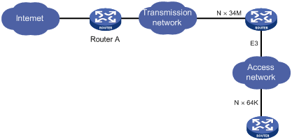

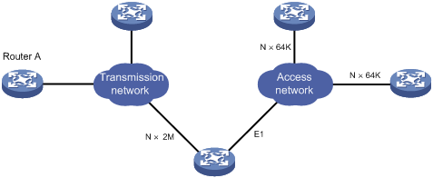

CPOS E1/T1 interfaces are typically used to aggregate E1 and T1 lines, as shown in Figure 1.
High-speed CPOS interfaces are typically used to aggregate E3 or T3 lines, as shown in Figure 2.
In actual applications, the connection between low-end devices and the CPOS interfaces might span more than one transmission network and might require relay. This is similar to the scenario where low-end devices are connected to a high-end device through one or multiple leased lines.
Figure 1 CPOS E1/T1 interface application scenario
Figure 2 High-speed CPOS interface application scenario

CPOS-E1 interface configuration example
Network requirements
As shown in Figure 3, branch nodes Router B through Router H are uplinked to the central node Router A through E1 links. Router A aggregates these E1 links by using a CPOS interface.
Add one additional E1 link on Router B to expand its capacity, and use an MP-group interface to bind the two E1 links.
Figure 3 Network diagram
Configuration procedure
IMPORTANT
IMPORTANT:
For correct network synchronization, make sure the master clock mode is configured on the SONET/SDH devices connected to the routers.
