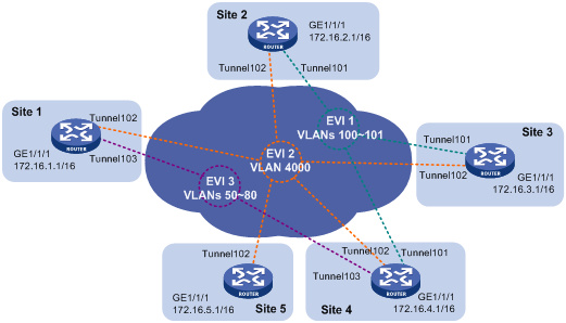

Single EVI network configuration example
Multiple-EVI-networks configuration example

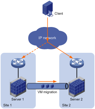

Ethernet Virtual Interconnect (EVI) is a MAC-in-IP technology that provides Layer 2 connectivity between distant Layer 2 network sites across an IP routed network. It is used for connecting geographically dispersed sites of a virtualized large-scale data center that requires Layer 2 adjacency (see Figure 1).
EVI enables long-distance virtual machine workload mobility and data mobility, disaster recovery, and business continuity. For example, virtual machines can move between data center sites without changing their IP addresses, so their movements are transparent to users and do not disrupt traffic.

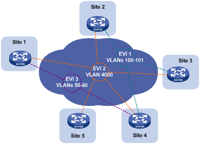

EVI supports multiple EVI networks on an edge device for extending different VLANs across the Layer 3 network. One EVI network can convey multiple VLANs, but one VLAN can map to only one EVI network. Each EVI network has separate network parameters and independently forwards traffic.
As shown in Figure 3, EVI network 1 extends VLAN 100 and VLAN 101 to Site 2, Site 3, and Site 4 for Web access traffic. EVI network 2 extends VLAN 4000 (the management VLAN) to all sites, and EVI network 3 extends VLANs 50 to 80 between Site 1 and Site 4 for database traffic.

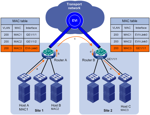

For intra-site unicast flows, an edge device performs the typical MAC address table lookup, as shown in Figure 4.
Figure 4 Layer 2 forwarding in a site
The following forwarding process (see Figure 5) takes place for unicast flows between sites:
1. The source edge device learns the source MAC address of the incoming Ethernet frame, and looks up the destination MAC address in its MAC table for the outgoing interface.
2. If the outgoing interface is an EVI-Link interface instead of a physical port, the source edge device encapsulates the frame in a GRE header, and then adds an IP header and a link layer protocol header.
In the outer IP header, the source IP address is the source edge device's tunnel source IP address, and the destination IP address is the destination edge device's tunnel source IP address.
3. The source edge device forwards the encapsulated packet out of the EVI link to the destination edge device across the IP transport network.
4. The destination edge device removes the headers of the original Ethernet frame, looks up the destination MAC address in the MAC address table, and sends the frame out of the matching outgoing interface.
Network requirements
As shown in Figure 7.
· Use EVI to extend VLANs 21 through 100 across site 1, site 2, and site 3 over an IPv4 network.
· Use network ID 1 to identify the EVI network.
· Use Router A as an ENDS and all other edge routers as ENDCs for neighbor discovery.
· Configure a routing policy on Router A to advertise MAC addresses in VLANs 21 to 90 to the remote sites.
Configuration procedure
1. Configure routes for the sites to reach each other. (Details not shown.)
Use EVI to connect the sites of the data center in Figure 8. To isolate different types of traffic and extend their VLANs to different sites, set up EVI networks as shown in Table 2.
Traffic type |
Network ID |
Extended VLANs |
Sites |
Database |
1 |
100, 101 |
2, 3, 4 |
Network management |
2 |
4000 |
All sites |
Web |
3 |
50, 80 |
1, 4 |
In each EVI network, use the edge device at site 4 as an ENDS and all other edge devices as its ENDCs.
2. Configure site 4:
# Configure the site ID.
<Site4> system-view
[Site4] evi site-id 4
# Assign an IP address to GigabitEthernet 1/1/1.
[Site4] interface gigabitethernet 1/1/1
[Site4-GigabitEthernet1/1/1] ip address 172.16.4.1 16
[Site4-GigabitEthernet1/1/1] quit
# Configure the database EVI network.
[Site4] interface tunnel 101 mode evi
[Site4-Tunnel101] source 172.16.4.1
[Site4-Tunnel101] evi network-id 1
[Site4-Tunnel101] evi extend-vlan 100 101
[Site4-Tunnel101] evi neighbor-discovery server enable
[Site4-Tunnel101] quit
# Configure the network management EVI network.
[Site4] interface tunnel 102 mode evi
[Site4-Tunnel102] source 172.16.4.1
[Site4-Tunnel102] evi network-id 2
[Site4-Tunnel102] evi extend-vlan 4000
[Site4-Tunnel102] evi neighbor-discovery server enable
[Site4-Tunnel102] quit
# Configure the Web service EVI network.
[Site4] interface tunnel 103 mode evi
[Site4-Tunnel103] source 172.16.4.1
[Site4-Tunnel103] evi network-id 3
[Site4-Tunnel103] evi extend-vlan 50 to 80
[Site4-Tunnel103] evi neighbor-discovery server enable
[Site4-Tunnel103] quit
# Enable EVI on GigabitEthernet 1/1/1.
[Site4-GigabitEthernet1/1/1] evi enable
3. Configure site 1:
<Site1> system-view
[Site1] evi site-id 1
[Site1] interface gigabitethernet 1/1/1
[Site1-GigabitEthernet1/1/1] ip address 172.16.1.1 16
[Site1-GigabitEthernet1/1/1] quit
[Site1] interface tunnel 102 mode evi
[Site1-Tunnel102] source 172.16.1.1
[Site1-Tunnel102] evi network-id 2
[Site1-Tunnel102] evi extend-vlan 4000
[Site1-Tunnel102] evi neighbor-discovery client enable 172.16.4.1
[Site1-Tunnel102] quit
[Site1] interface tunnel 103 mode evi
[Site1-Tunnel103] source 172.16.1.1
[Site1-Tunnel103] evi network-id 3
[Site1-Tunnel103] evi extend-vlan 50 to 80
[Site1-Tunnel103] evi neighbor-discovery client enable 172.16.4.1
[Site1-Tunnel103] quit
[Site1-GigabitEthernet1/1/1] evi enable
4. Configure all the other sites in the same way that site 1 is configured. Make sure extended VLANs are correctly configured at each site.
