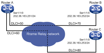

As shown in Figure 1:
·     Router B and Router C form a simple Frame Relay network.
·     DTE devices Router A and Router D are attached to the network.
The interface type DTE or DCE is identified only for the UNI interfaces. A virtual circuit between two DTE devices can be assigned different DLCIs on different segments.
Figure 1 Frame Relay network

Frame Relay configuration example
Network requirements
As shown in Figure 4, configure Frame Relay so that Router A and Router B can communicate.
Figure 4 Network diagram
Configuration procedure
(Method 1) Using main interfaces
1.     Configure Router A:
# Assign an IP address to interface Serial 1/1/0.
<RouterA> system-view
[RouterA] interface serial 1/1/0
[RouterA-Serial1/1/0] ip address 202.38.163.251 255.255.255.0
# Enable Frame Relay encapsulation on the interface.
[RouterA-Serial1/1/0] link-protocol fr
# Set the type of the interface to DCE.
[RouterA-Serial1/1/0] fr interface-type dce
# Configure a local virtual circuit.
[RouterA-Serial1/1/0] fr dlci 100
2.     Configure Router B:
<RouterB> system-view
[RouterB] interface serial 1/1/0
[RouterB-Serial1/1/0] ip address 202.38.163.252 255.255.255.0
[RouterB-Serial1/1/0] link-protocol fr
# Set the type of the interface to DTE.
[RouterB-Serial1/1/0] fr interface-type dte
[RouterB-Serial1/1/0] quit
(Method 2) Using subinterfaces
# Enable Frame Relay encapsulation on the interface Serial 1/1/0.
# Set the type of the interface Serial 1/1/0 to DCE.
[RouterA-Serial1/1/0] quit
# Create a subinterface Serial 1/1/0.1.
[RouterA] interface serial 1/1/0.1 p2p
# Configure the IP address and create a virtual circuit for the subinterface Serial 1/1/0.1.
[RouterA-Serial1/1/0.1] ip address 202.38.163.251 255.255.255.0
[RouterA-Serial1/1/0.1] fr dlci 100
# Enable Frame Relay encapsulation on interface Serial 1/1/0.
# Set the type of the interface Serial 1/1/0 to DTE.
[RouterB] interface serial 1/1/0.1 p2p
[RouterB-Serial1/1/0.1] ip address 202.38.163.252 255.255.255.0
[RouterB-Serial1/1/0.1] fr dlci 100
[RouterB-Serial1/1/0.1] quit
This section verifies the configuration used in method 1.
# On Router B, verify that the PVC is active.
[RouterB] display fr pvc
PVC information for interface Serial1/1/0 (DTE, physically up)
  DLCI: 100  Type: Dynamic  Interface: Serial1/1/0

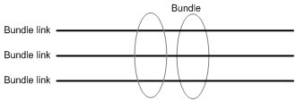

Multilink Frame Relay (MFR) is a cost-effective bandwidth solution that is based on Frame Relay Forum Multilink Frame Relay UNI/NNI Implementation Agreement (FRF.16.1). This feature increases bandwidth by bundling multiple physical links into a logical link.
MFR uses the following concepts:
·     Bundle—A virtual interface formed by combining multiple physical interfaces. A bundle corresponds to an MFR interface. A bundle is visible to the data link layer.
·     Bundle link—Corresponds to a physical interface. A bundle contains and manages multiple bundle links, as shown in Figure 5. Bundle links are visible to the physical layer.
Figure 5 Bundle and bundle links
MFR interfaces support DTE and DCE interface types and QoS queuing mechanisms. Physical interfaces bundled into an MFR interface use the data link and network parameter settings of the MFR interface. Their original parameters settings do not work.
