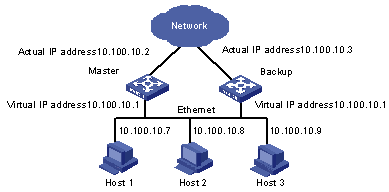

The Virtual Router Redundancy Protocol (VRRP) is a fault-tolerant protocol. In general, a default route (for example, 10.100.10.1 as shown in the following internetworking diagram) is configured for every host on the network, so that the packets destined to some other network segment from the hosts will go through the default route to the Layer 3 Switch. If Switch is down, all the hosts taking Switch as the next-hop will be disconnected from the external network.
Figure 1-1 Network diagram for LAN
VRRP, designed for LANs with multicast and broadcast capabilities (such as Ethernet) settles the above problem. VRRP integrates a group of LAN switches (including a Master and several Backups) into a virtual router. The diagram below is taken as an example to explain how VRRP works.
Figure 1-2 Network diagram for virtual router
This virtual router has its own IP address: 10.100.10.1 (which can be the interface address of a switch within the virtual router). The switches within the virtual router have their own IP addresses (such as 10.100.10.2 for the Master switch and 10.100.10.3 for the Backup switch). The hosts on the LAN only know the IP address of this virtual router 10.100.10.1 (usually called as virtual IP address of the virtual router), but not the specific IP addresses 10.100.10.2 of the Master switch and 10.100.10.3 of the Backup switch. A default route with the next hop 10.100.10.1 is configured on the hosts. Therefore, hosts within the network will communicate with the external network through this virtual router. If the Master switch in the virtual group breaks down, another Backup switch will function as the new Master switch to continue serving the hosts without any interruption.

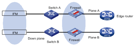

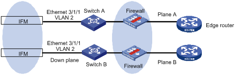

1.2.11  Configuring IFM Tracking
As a special card on softswitch devices, the IP forwarding module (IFM) is the portal of softswitch, which is used to distribute IP signals. The disconnection with the IFM means the termination of softswitch; therefore, the reliability of IFM has great importance.
Figure 1-3 Network diagram for IFM devices
As shown in Figure 1-3, the two Layer 3 switches form a VRRP group. Each switch is enabled to track the status of the corresponding IFM device through the OAM module. When receiving signals from the IFM device, the priority of the corresponding interface on a switch will increase by the value specified by value-increased. The switch with a higher priority becomes the master. When the link of the master is down, the priority will decrease by a specified value. As a result, the backup will have a higher priority and become the master switch. Thus, the cooperation between IFM and VRRP through OAM is implemented.
Perform the following configuration in VLAN interface view to enable/disable IFM tracking:

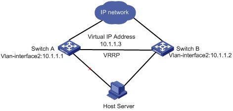

1.4.3  VRRP Link Monitoring Configuration Example
I. Network requirements
As shown in the figure below:
l           No physical loops exist between Switch A, Switch B and Host Server, and STP is not enabled.
l           Switch A is the master while Switch B is the backup. No physical link is available between Switch A and Host Server.
Normally, Switch A acts as the gateway. The traffic sent from Host Server is forwarded at Layer 2 through Switch B to Switch A which then forwards the traffic at Layer 3 to the IP network.
It is required to configure Switch B to monitor the link to Switch A. If Switch A fails or the link between Switch A and Switch B fails, Switch B becomes the master and acts as the gateway instead of Switch A. Then, the traffic from Host Server is forwarded to the IP network directly through Switch B. The state switching delay should be in milliseconds.
II. Network diagram
Figure 1-5 Network diagram for VRRP configuration
III. Configuration procedure
1)         Configure Switch A
# Configure VLAN 2.
<LSW-A> system-view
[LSW-A] vlan 2
[LSW-A-vlan2] interface vlan 2
[LSW-A-vlan-interface2] ip address 10.1.1.1 255.255.255.0
[LSW-A-vlan-interface2] quit
# Enable pinging the virtual IP address of the virtual router.
[LSW-A ] vrrp ping-enable
# Create virtual router 1.
[LSW-A] interface vlan 2
[LSW-A-vlan-interface2] vrrp vrid 1 virtual-ip 10.1.1.3
# Set the VRRP priority for Switch A.
[LSW-A-vlan-interface2] vrrp vrid 1 priority 110
2)         Configure Switch B
# Configure VLAN 2.
<LSW-B> system-view
[LSW-B] vlan 2
[LSW-B-vlan2] interface vlan 2
[LSW-B-vlan-interface2] ip address 10.1.1.2 255.255.255.0
[LSW-B-vlan-interface2] quit
[LSW-B] vrrp ping-enable
[LSW-B] interface vlan 2
[LSW-B-vlan-interface2] vrrp vrid 1 virtual-ip 10.1.1.3
# Enable Switch B to monitor interface Ethernet 2/1/1.
[LSW-B-vlan-interface2] vrrp vrid 1 monitor interface Ethernet 2/1/1
# Configure the global link state holdtime.
[LSW-B] link-status hold 0
1.4.4  IFM Tracking Configuration Example
As shown in the following figure, an IFM softswitch device is attached to a switch.
It is required to configure the two switches as a VRRP group and configure IFM tracking to track the IFM devices through OAM. A switch that can receive signals from the corresponding IFM device increases its priority with a specified value to influence master switch election.
II. Network diagram
Figure 1-6 Network diagram for IFM tracking
# Configure VLAN 2.
[Switch A] vlan 2
[Switch A-vlan2] interface vlan-interface 2
[Switch A-Vlan-interface2] ip address 202.38.160.1 255.255.255.0
[Switch A-Vlan-interface2] quit
# Enable OAM.
[Switch A] Ethernet3/1/1
[Switch A-Ethernet3/1/1] oam ethernet mode passive
[Switch A-Ethernet3/1/1] oam ethernet enable
[Switch A-Ethernet3/1/1] quit
# Enable the function of pinging the virtual IP address of the virtual router.
[Switch A] vrrp ping-enable
# Configure the virtual router.
[Switch A] interface vlan-interface 2
[Switch A-Vlan-interface2] vrrp vrid 1 virtual-ip 202.38.160.111
# Set the priority of the virtual router.
[Switch A-Vlan-interface2] vrrp vrid 1 priority 105
# Set the authentication mode and authentication key for the virtual router.
[Switch A-Vlan-interface2] vrrp vrid 1 authentication-mode md5 switch
# Configure IFM tracking, and set the increased value to 10.
[Switch A-Vlan-interface2] vrrp vrid 1 track ifm increased 10
# Configure VLAN2.
[Switch B] vlan 2
[Switch B-vlan2] interface vlan-interface 2
[Switch B-Vlan-interface2] ip address 202.38.160.2 255.255.255.0
[Switch B-Vlan-interface2] quit
# Enable OAM.
[Switch B] Ethernet3/1/1
[Switch B-Ethernet3/1/1] oam ethernet mode passive
[Switch B-Ethernet3/1/1] oam ethernet enable
[Switch B-Ethernet3/1/1] quit
# Enable the function to ping the virtual IP address of the virtual router.
[Switch B] vrrp ping-enable
# Create the virtual router.
[Switch B] interface vlan 2
[Switch B-Vlan-interface2] vrrp vrid 1 virtual-ip 202.38.160.111
[Switch B-Vlan-interface2] vrrp vrid 1 authentication-mode md5 switch
[Switch B-Vlan-interface2] vrrp vrid 1 track ifm increased 10
&  Note:
Switch A acts as the gateway in normal cases. When Switch B tracks the state of the IFM device being Master through OAM, the priority of Switch B will be increased by 10, greater than that of Switch A (105), and Switch B will turn the Master and act as the gateway.
