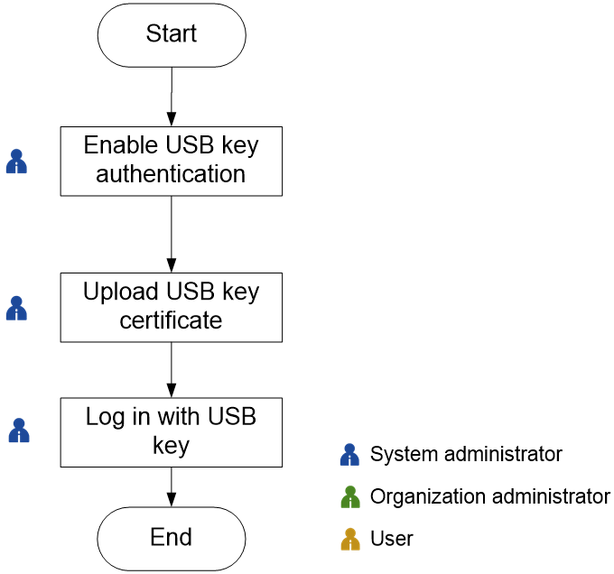

To configure USB key authentication, perform the following tasks:
Task |
Description |
With USB key authentication enabled, USB key login option will appears on the login page. |
The USB key certificates are issued by the Certification Authority (CA) and correspond to the USB key hardware devices one by one. The USB key certificates need to be uploaded to corresponding users in the system in advance. |
USB key users log in to the system. |
Figure-1 Configuring USB key authentication
