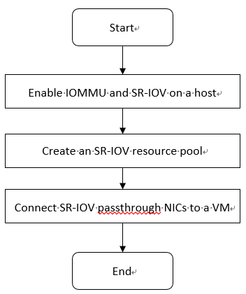

Figure-1 Configuration flow chart for SR-IOV resource pools
Table-1 SR-IOV resource pool configuration workflow
Procedure |
Remarks |
Required. You must enable IOMMU on a host before configuring SR-IOV NIC passthrough on the host. For the configuration to take effect, you must restart the host. |
Required. Perform this task to assign physical SR-IOV passthrough NICs on different hosts in the same cluster to an SR-IOV resource pool. |
Required. Perform this task to connect SR-IOV passthrough NICs to a VM. |
