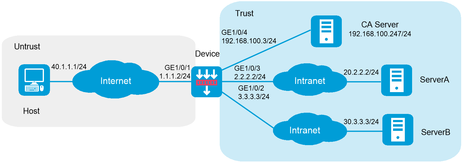

As shown in Figure 1, the device acts as the SSL VPN gateway that connects the public network and the private network. A Windows Server 2008 R2 CA server is deployed on the private network. Users need to access resources on internal Web servers Server A and Server B. Both Web servers use HTTP over port 80.
Configure the SSL VPN Web access service on the device to allow users to access Server A and Server B in Web access mode.
Configure the device to perform local authentication and authorization for Web access users. Require users to pass both password and certificate authentication for Web access. To enhance security, request an SSL server certificate for the device from the CA server rather than use the default certificate.
Figure 1 Network diagram

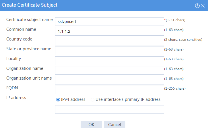

  1. Create a certificate subject:
# On the top navigation bar, click Objects.
# From the navigation pane, select PKI > Certificate Subject.
# Click Create.
# Create a certificate subject as shown in Figure 2, and the click OK.
Figure 2 Creating a certificate subject

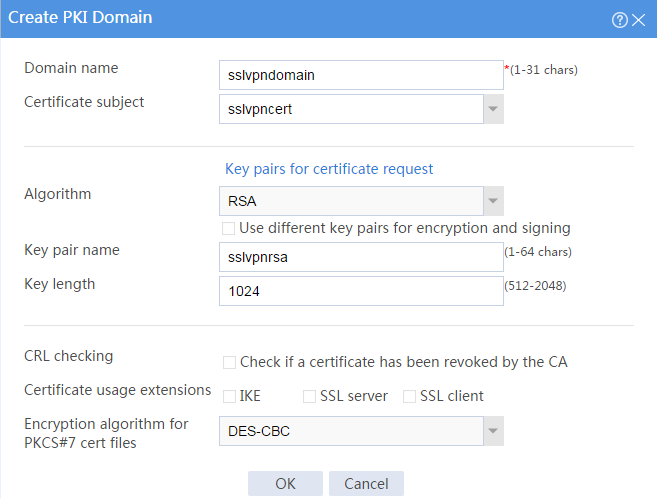

  1. Create a PKI domain:
# On the Certificate page, click Create PKI domain.
# Create a PKI domain as shown in Figure 3, and then click OK.
Figure 3 Creating a PKI domain

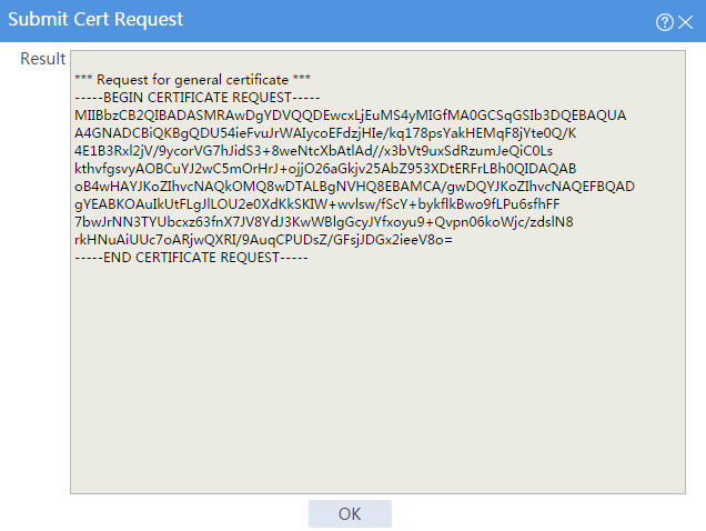

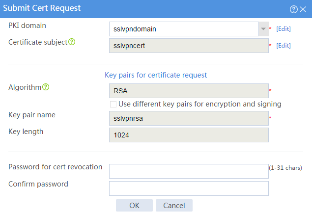

  1. Create a certificate request:
# On the Certificate page, click Submit Cert Request.
# Configure the certificate request settings as shown in Figure 4.
Figure 4 Creating a certificate request
# Click OK.
The certificate request content will be displayed, as shown in Figure 5.
Figure 5 Certificate request content
# Copy the certificate request content and click OK.

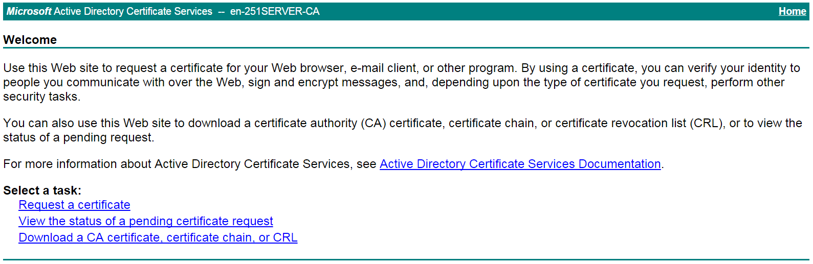

  1. Request a server certificate from the CA:
# Enter http://192.168.100.247/certsrv in the browser address bar.
# On the certificate service home page shown in Figure 6, click Request a certificate.
Figure 6 Certificate service home page

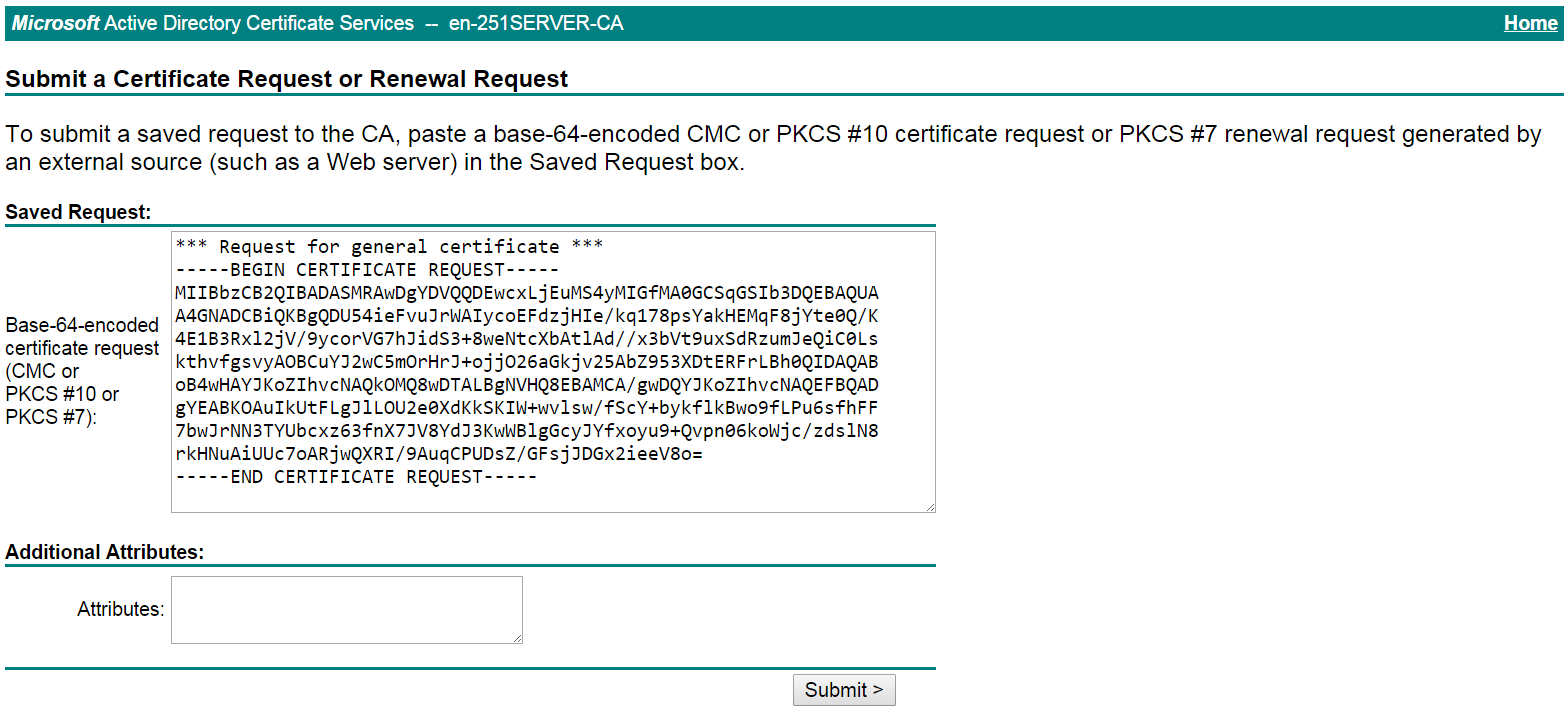

# Paste the previously copied certificate request content in the Base-64-encoded certificate request CMC or PKCS # 10 or PKCS # 7) field, as shown in Figure 8.
Figure 8 Pasting the certificate request content
# Click Submit.

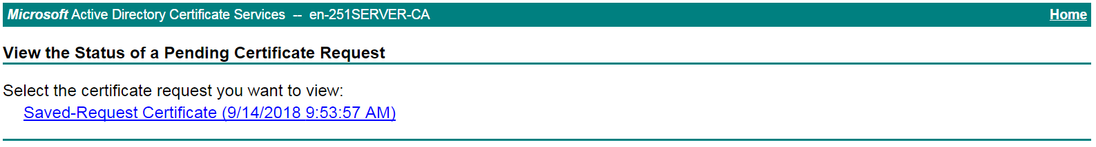

After the certificate request is approved by the CA administrator, enter http://192.168.100.247/certsrv in the browser address bar.
# On the certificate service home page shown in Figure 9, click View the status of a pending certificate request.
Figure 9 Certificate service home page
# Select the certificate request you want to view.
Figure 10 View the Status of a Pending Certificate Request page

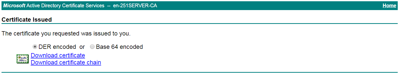

The Certificate Issued page opens, indicating that the requested server certificate has been issued, as shown in Figure 11.
Figure 11 Certificate Issued page
# Click Download certificate to download the server certificate and save it locally.

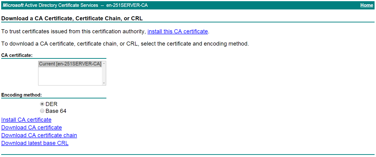

  1. Download the CA certificate:
# On the certificate service home page shown in Figure 12, click Download a CA certificate, certificate chain, or CRL.
Figure 12 Certificate service home page
# On the Download a CA certificate, certificate chain, or CRL page shown in Figure 13, click Download CA certificate.
Figure 13 Download a CA certificate, certificate chain, or CRL page
# Save the downloaded CA certificate locally.

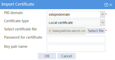

  1. Import the server certificate:
# On the Certificate page, click Import certificate.
# Import the locally saved server certificate, as shown in Figure 15, and then click OK.
Figure 15 Importing the server certificate

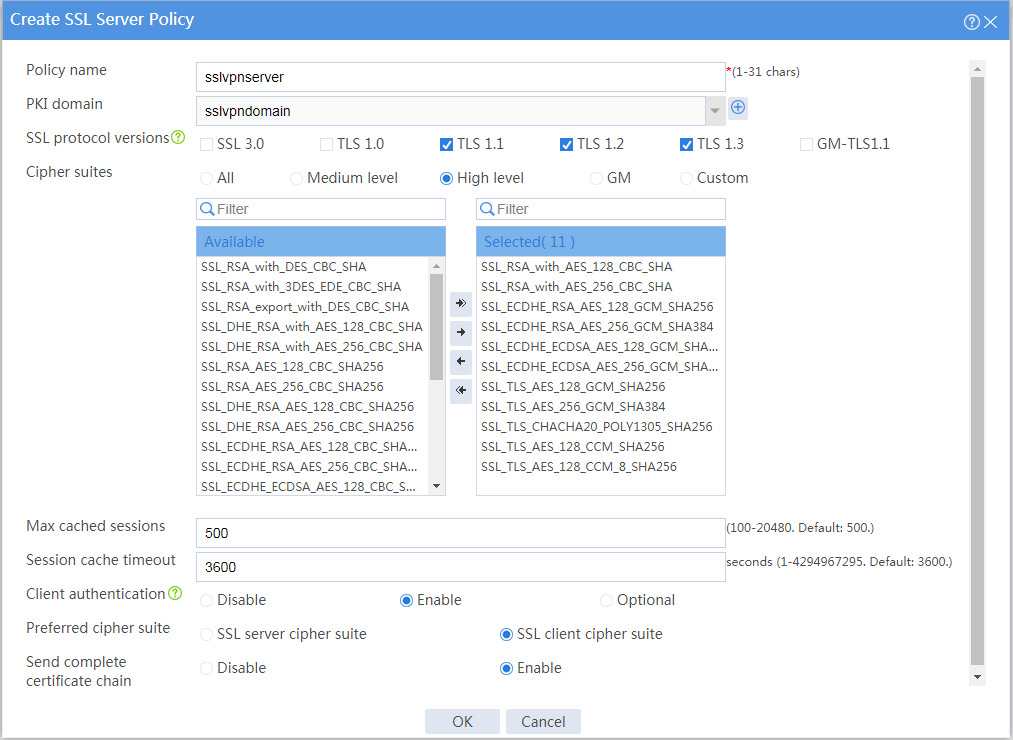

  1. Configure an SSL server policy:
# From the navigation pane, select SSL > SSL Server Policies.
# Click Create.
# Configure an SSL server policy as shown in Figure 16, and then click OK.
Figure 16 Creating an SSL server policy

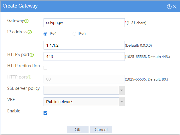

  1. Configure the SSL VPN gateway:
# On the top navigation bar, click Network.
# From the navigation pane, select SSL VPN > SSL VPN Gateways.
# Click Create.
# Create an SSL VPN gateway as shown in Figure 17, and then click OK.
Figure 17 Creating an SSL VPN gateway

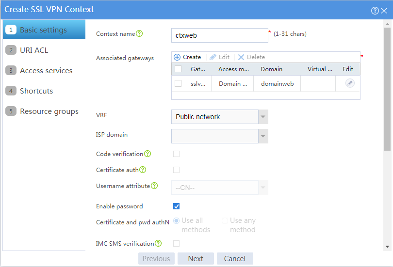

# Configure the basic settings for the SSL VPN context as shown in Figure 3, and then click Next.
Figure 18 Configuring basic settings for an SSL VPN context

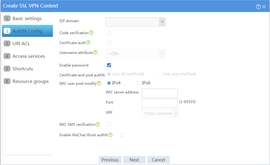

# Click Next to configure authentication settings, as shown in Figure 19.
Figure 19 Configuring authentication settings

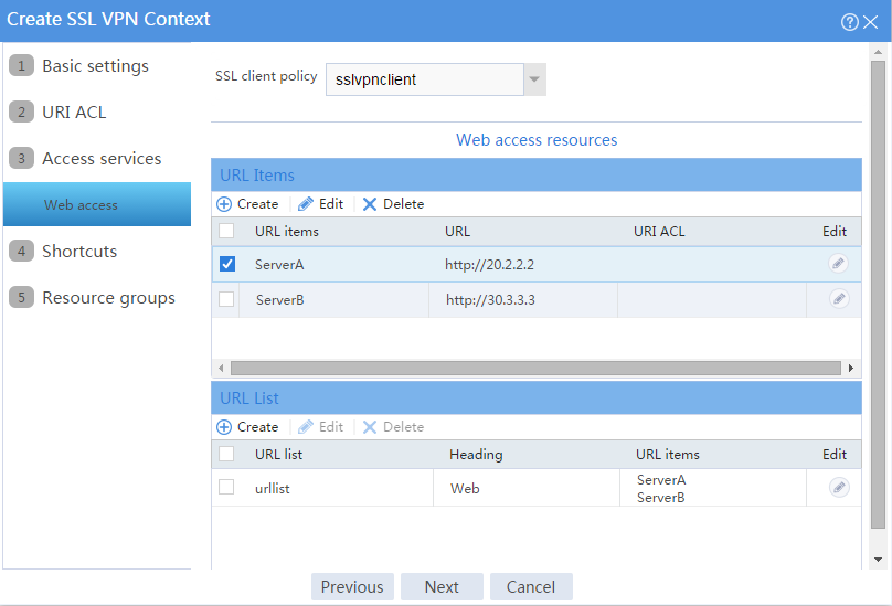

# On the Web access page, configure the Web access service as follows:
  1. Select sslvpnclient from the SSL client policy list.
  1. Configure two URL items pointing to Server A and Server B, respectively.
  1. Add the two URL items to URL list urllist.
  1. Click Next.
Figure 20 Configuring the Web access service

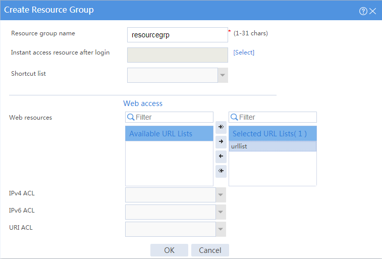

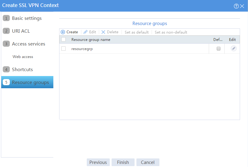

# On the Resource groups page, click Create.
# Create a resource group named resourcegrp and select URL list urllist as the accessible Web resources, as shown in Figure 21.
# Click OK.
Figure 21 Creating an SSL VPN resource group
The newly created resource group is displayed on the Resource groups page, as shown in Figure 22.
Figure 22 Resource groups configuration page

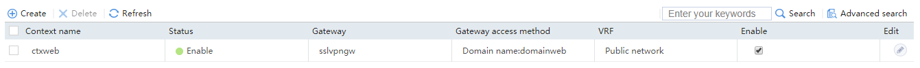

# Click Finish.
# Select the Enable check box to enable the SSL VPN context, as shown in Figure 23.
Figure 23 Enabling the SSL VPN context

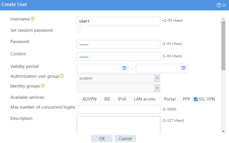

  1. Create an SSL VPN user:
# From the navigation pane, select User > User Management > Local Users.
# Click Create.
# Create an SSL VPN user:
  1. Set the username to user1 and password to 123456, and select SSL VPN as the available service, as shown in Figure 24.
Figure 24 Creating an SSL VPN user

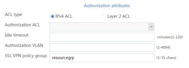

  1. In the Authorization Attributes area, authorize the user to use SSL VPN resource group resourcegrp, as shown in Figure 25.
Figure 25 Setting the authorization attributes for the SSL VPN user

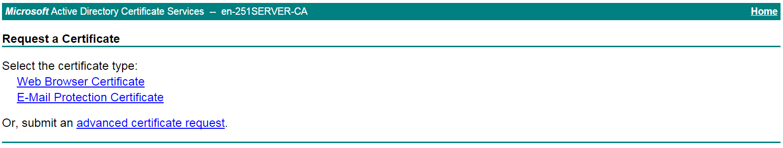

  1. On the certificate service home page shown in Figure 26, click Request a certificate.
Figure 26 Certificate service home page
  1. On the Request a Certificate page shown in Figure 27, click advanced certificate request.
Figure 27 Request a Certificate page

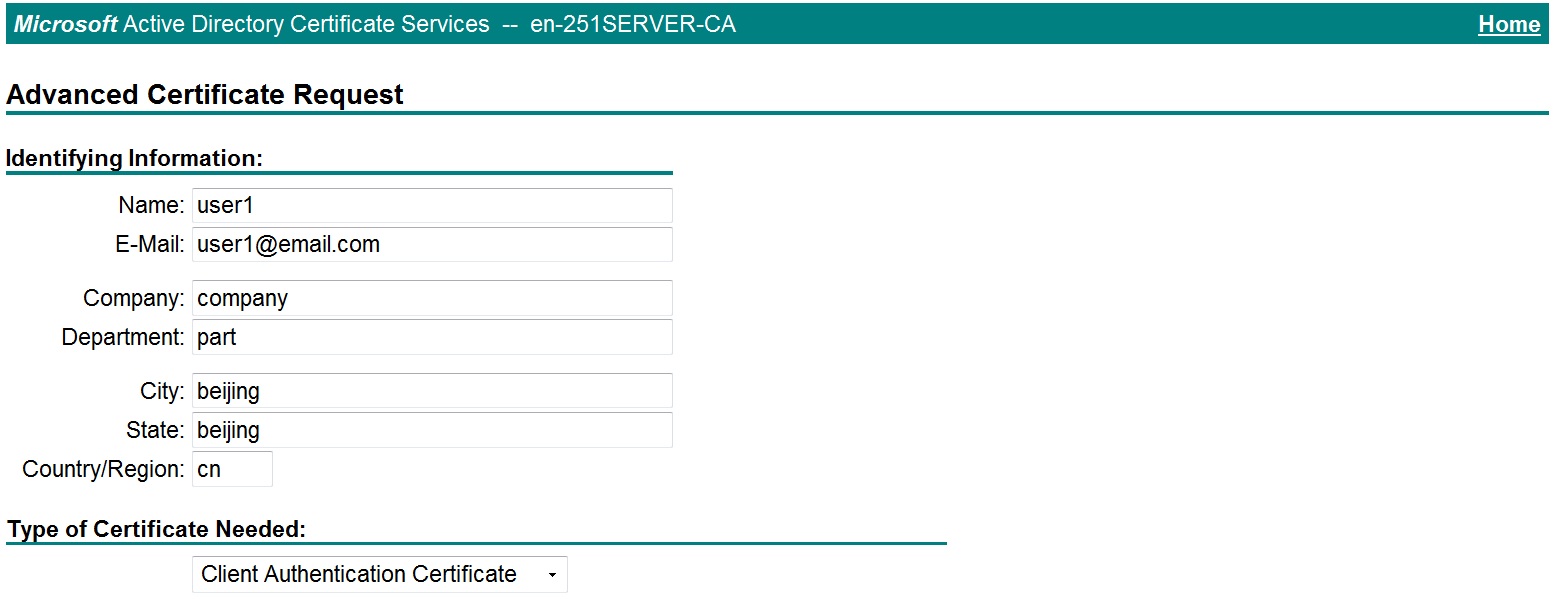

  1. Create a client certificate request, as shown in Figure 28.
Figure 28 Creating a client certificate request
  1. Click Submit.

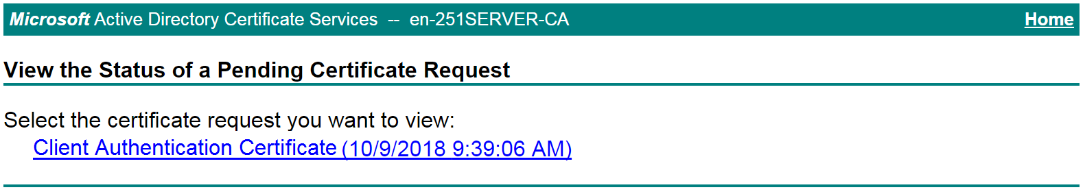

  1. After the certificate request is approved by the CA administrator, enter http://192.168.100.247/certsrv in the browser address bar.
  1. On the certificate service home page shown in Figure 29, click View the status of a pending certificate request.
Figure 29 Certificate service home page
The View the Status of a Pending Certificate Request page opens, as shown in Figure 30.
Figure 30 View the Status of a Pending Certificate Request page

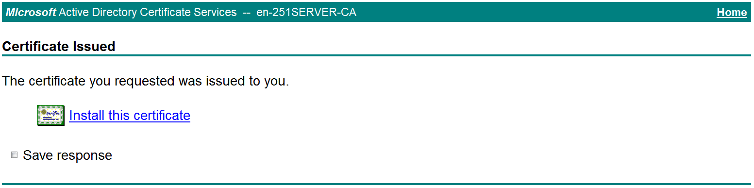

  1. Click the client certificate whose status you want to view.

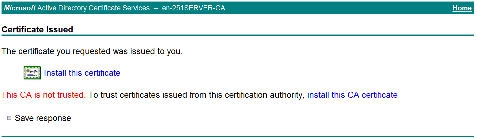

  1. On the Certificate Issued page shown in Figure 31, click Install this certificate to install the client certificate.
Figure 31 Installing the client certificate
If the host does not have a CA certificate, the page shown in Figure 32 opens. You must install the CA certificate first.
  1. Click install this CA certificate to install the CA certificate. Then, click Install this certificate to install the client certificate.
Figure 32 Installing the CA certificate and then the client certificate

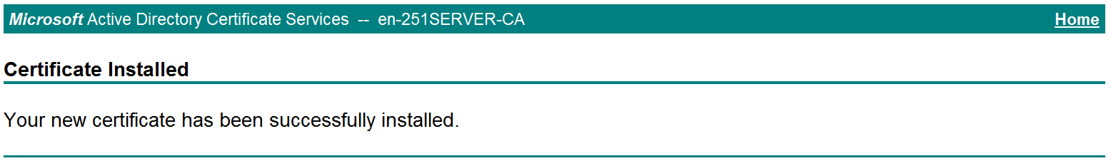

After the client certificate is installed, the Certificate Installed page shown in Figure 33 opens.
Figure 33 Certificate Installed page

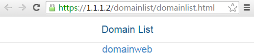

  1. On the Domain List page shown in Figure 35, click domainweb.
Figure 35 Domain List page

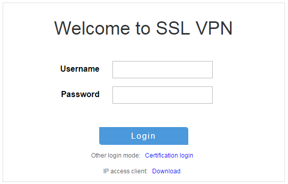

  1. On the SSL VPN login page shown in Figure 36, enter username user1 and password and 123456, and then click Login
Figure 36 SSL VPN login page

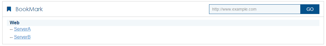

The SSL VPN home page opens, displaying the Web resources the user can access in the BookMark area, as shown in Figure 37.
Figure 37 Accessible Web resources
